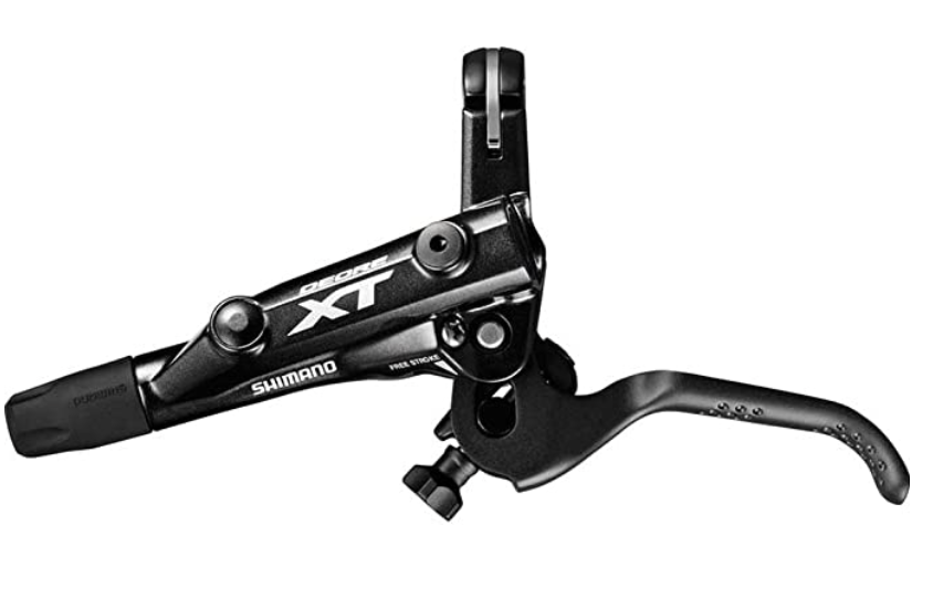

Awhile back I upgraded the brakes on my wife's bike from SRAM's to Shimano M-8125s, which have Shimano's compound action lever and 4-piston design. Unfortunately, the brake lever has an attachment point that isn't at the end, but is in the middle, like this:
It's kind of hard to see here, but at the far end is a protrusion that rests against the handlebars. So your grips go to the outside of that protrusion, which is just perfect position for braking. However, since the handlebar attachment is a couple inches further away, other things you might want to mount to the handlebars are new a couple inches further away. This isn't so bad for the PAS selector, but if you're also running a throttle then it becomes a reach.
I ordered and installed the M8100 brake lever. Has the same travel and level resting position adjustments, but the attachment point is at the fat end, like this:
This means that I could install the throttle closer to the handgrip, which makes it a lot easier to reach, and then the keypad isn't too far away. Before I had to install the keypad first since the throttle body was so thick.
Anyway, just a minor point for people considering upgrading to Shimano's XT 4-piston brakes to consider the brake levers as well as the calipers.

Both versions of the XT levers have that adjustment capability. The difference is in what other items you mount on the handlebars and how close to the grips they can be. The second lever has a handlebar clamp that ends up right next to your grips and you can "tuck" the throttle or PAS keypad just after it, so that those items are actually between the brake cylinder and the handlebar, meaning you don't have to reach as far to get to the throttle or keypad.

I'm confused. When I went down this path with M6xxx and M7xxxx levers older 6000 and 7000 had clamp at end as per 2nd photo. The newer 6100 and 7100 have clamp partway down as per first photo.
If running Bosch Purion display really need the older left side x000 levers as newer x100 ones clamp interfers with display mount. Result is display is more horizontal than 45degrees I prefer.
I was lucky and found older levers on Aliexpress but they are becoming hard to come by. NB only need left brake lever, right can be newer version.
ML 501 is has clamp at end and I suspect its old M6000 rebadged.
