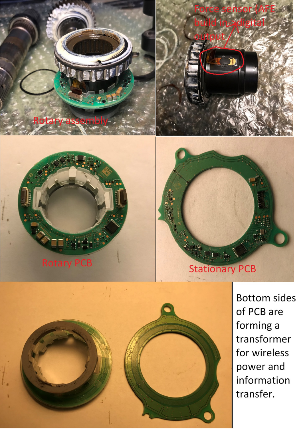

My best guess is that the torque sensors on these motors can only take so many pedal strikes, heavy downpours, deep puddle splashes, etc. If I'm right, I hope Shimano's latest off-road-intended motor, the EP8, has more robust torque sensors - here's a pic of the e8000's.

More details quoted from someone with far more technical expertise than me in the Fb group, "Shimano E Steps Motor Users":
The upper right photo (below) shows the part that fails (within Shimano Steps' torque sensor).
The main problem is the connections of the chip underside the black resin to the rotary pcb.
Either the flex cable will fail or the connections inside the resin.
That posting goes on with an opinion that jibes with my first-post statement about the sensor's lack of robustness...
The complexity of this system and the super fragile nature of flex cables + epoxy coated chips make the application inappropriate in an... MTB riding scenario... not for a long service, at least.
