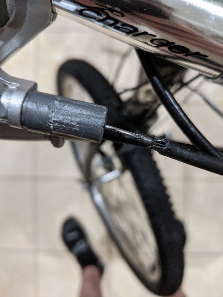

hello all, i finally got my old electric bike up and running and im dealing with a problem. I was trying to adjust the alignment and it was VERY hard to turn to adjust. I seemed to have adjusted it too far one direction, and now the whole barrel adjuster is stuck and i can not pull it out to adjust it. It just wiggles a few cm's left or right, but i can't pull it out. I tried small pliers and my hands hurt from trying. I was really frustrated and didn't know what to do, i was pulling on the cable, pushing it in, and it just broke off.
What are my options here? I noticed the housing for the cable that broke off is very long. I'm hoping i can still use that housing, and won't have to replace it. I happen to have a 7 speed shifter, brand new, from amazon when i purchased a 21 speed mountain bike shifter for another bike. I can use that if needed i believe, but i would prefer saving the shifter because it's nicer but i think the barrel adjuster is broken.
I would have tried lubricating it before I applied too much force. However, if it is broken, you will have to replace it. Shifters are not that expensive. What is the make/model of your rear derailleur?

hmmm looks like i was able to jam the cable back in and forced it counter clockwise.. i fixed it! the cable is holding and i was able to adjust it!! i got lucky.. i was just about to place the order too!

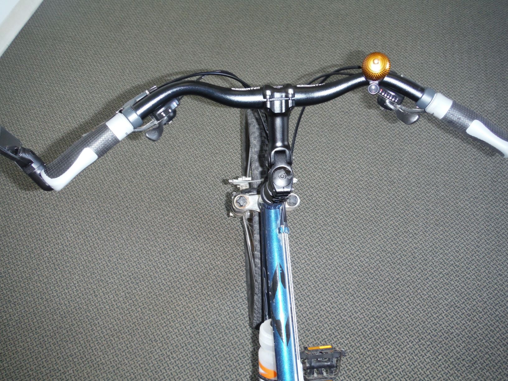

Post a photo of the "stem". There are a bunch of different standards for them. Many mountain bikes are 31.8, 31.8 on the threadless steer tube and the handlebar clamp. I ordered one yesterday for a bike that is 1-1/8 inches on the steer tube and 25.4mm on the clamp. Search for riser stem. Or just stem. Some articulate. They typically range from 60mm long to 130mm. Also look at moustache bars. These make for a much better hand position by bringing your thumbs forward slightly and pinkies down.
Here is on example of a Dutch Style bar. I am not advocating this particular site. Just the hand position. Paste into your browser.
UPANBIKE Bike Handlebar Urban Road Bike Retro Handlebar Moustache Shape Extra Wide Dutch M Shape (25.4mm 600mm)
You can trim 3/4 of an inch from each end. 600mm is big. The bike in the photo had an uncomfortable flat bar.
I had to, as part of my job today, take 1/3 of the battery down on a 1,000 watt Ultra bike with a flat bar by riding it. Now my wrists hurt. The guy is going to Germany for joint replacement surgery tomorrow. He will be gone 4-months and the battery should not be stored that long on a full charge. I put this bar on another of his bikes, an HD, and he loves it. Everyone does.
