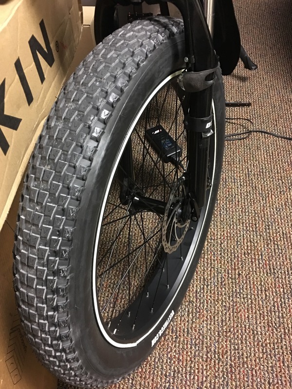

I've updated to Vee8 26X4 120 tpi tires and that cut my flats way down because this tire has 10X more knobs for a thicker tire overall. I still use Mr. Tuffy and 2 bottles of Stans in the tube per tire. I also have a rear rack and pack tools, flat kit, pump, and spare tube if I can't repair the tube on the road. I work commute at 5:30am and a few times I ran over road debris that resulted in slits or holes large enough in my tires Mr. Tuffy+Stans couldn't stop. Replacing the tube was the only way to get me back on the road.
Vee8 Tires on my 2016 Radrover, way less "killer bees" knobby paved road noise compared to Kenda tires:
Thanks very much for the tire recommendation. I did a little research last night and read about the Kenda tires having thin rubber, etc. I live in SoCal and those pesky goat heads were the cause of all 3 flats. A tire replacement is in my immediate future. I'll check out those Vee8's and like the idea of sticking with Mr Tuffy's plus some decent sealant. This is the price to pay for a gnarly fat tire ebike, I suppose. BTW, I've actually grown fond of the sound of buzzing bees, but will happily give that up if it means less flats!! Thanks again! Bzzzzzz....

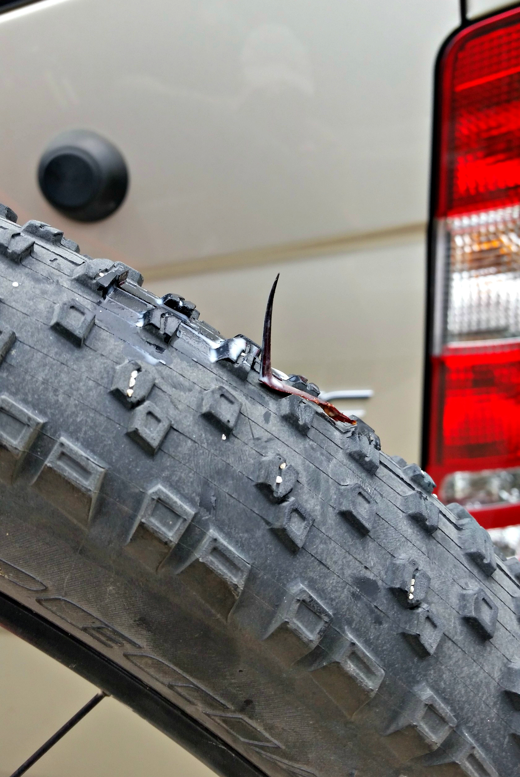

Mr Gold-Apologize for my ignorance, but I do not believe I have seen or know what a goat head actually is?? It sounds like it is like the killer bees attacking your tires. Are they that rampant that you need to take extreme measures in protecting your bikes from flats? What does one even look like? Sounds like they resemble a broken thorn from a rose bush if I've got that right. Here in the Midwest, I get very few flats perhaps one every 4-5 years if that. What a terrible nuisance to say the least. Sounds like you need bulletproof tires just to ride peacefully without having puncture anxiety. Ride safe!
I don't know the actual name of the plant; but, everyone calls them "goatheads" or "goathead thorns". Not the same as those pin cushion looking "sticker" thorns that always get stuck on your socks or shoe lace. Bike tires, pet paws, or walking and you can end up have a lot of them stuck to the bottom of your shoe. Most of the time the goatheads are not long enough to reach all the way to the tube (Mr. Tuffy helps add an extra layer of protection). So far; Stans tire sealant in my tubes has worked every time to plug goathead leaks after 4000 miles of riding. Learned to never remove the goathead on the road. I wait until I get home, remove, listen for the hissing sound, rotate the tire down, and wait a few second for Stans to work.

Goathead pods are very small, but they're sharp and they puncture many tires of unknowing cyclist here in CA too. I think the weed grows in western states but isn't indigenios. I also used a sealant called Gup for one of my flats. Seemed to work well. New tires are going on tomorrow, along with sealant. Decided on Maxxis Minion FBF / FBR. Wish me luck! Pics and review to follow.
Agree with mrgold35 about Stan's sealant for tubeless tires. Most punctures seal right up, and the few flats I've had over several years could be sealed by rotating the tire and pumping it back up. Here in the Southern Calif. desert the cactus always seem to be out to get you!

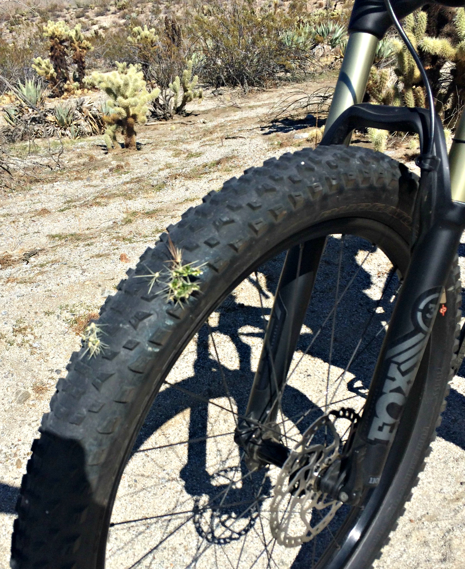

I carry a small pair of vice grip pliers for removing Cholla cactus tuberculate thorn clusters. The tire shown didn't leak air thanks to Stans.
Here's a thorn from an Ocotillo that I noticed and pulled from my tire after a ride. The Stans had sealed around it in place and even filled an sealed the hole after removing it.
Mr. Gold-Thanks for clarifying with your photos. I counted approx 50 heads on that side of the tire alone. Are you saying that you have to get perhaps a needle nose pliers after each ride and pluck those little buggers out of your tires?? If so, that sounds insane and time consuming to have to do so. Thank god for products like Stan's that does the job. Looks like some genius will have to develop a tire that can be more resistant to these nasty thorns. Can one of them perhaps stick to the tire then break off and sling into your legs, arms face etc? Just curious how much of a threat these are to the entire riding experience.
