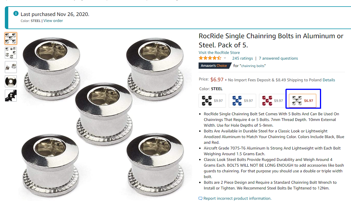

Yes, I did. There was some confusion related to tensioning torque of aluminium MTB chainring bolts. I guess it is only 5-7 Nm. I was recommended a higher value (10 Nm) and damaged two bolts in row... It had irritated me so much I ordered steel chainring bolts afterwards.Great advice. I also have a torque wrench, so perhaps I will make sure it is all to spec when finished. Did you have to use one on them after re-tensioning?
Thanks for sharing the info. Sorry to hear about that nonsense. Delicate material indeed. I'll make a note of it.Yes, I did. There was some confusion related to tensioning torque of aluminium MTB chainring bolts. I guess it is only 5-7 Nm. I was recommended a higher value (10 Nm) and damaged two bolts in row... It had irritated me so much I ordered steel chainring bolts afterwards.
It has to specify the material. It is rare to get steel chainring bolts.When ordering steel chainring bolts, does the description specify steel?

Aluminium or STEEL chainring bolts for MTB offer
Take a note: Of four colours specified in the Amazon offer, only the "metallic" set is made of steel! (I bought bolts from precisely that offer):
