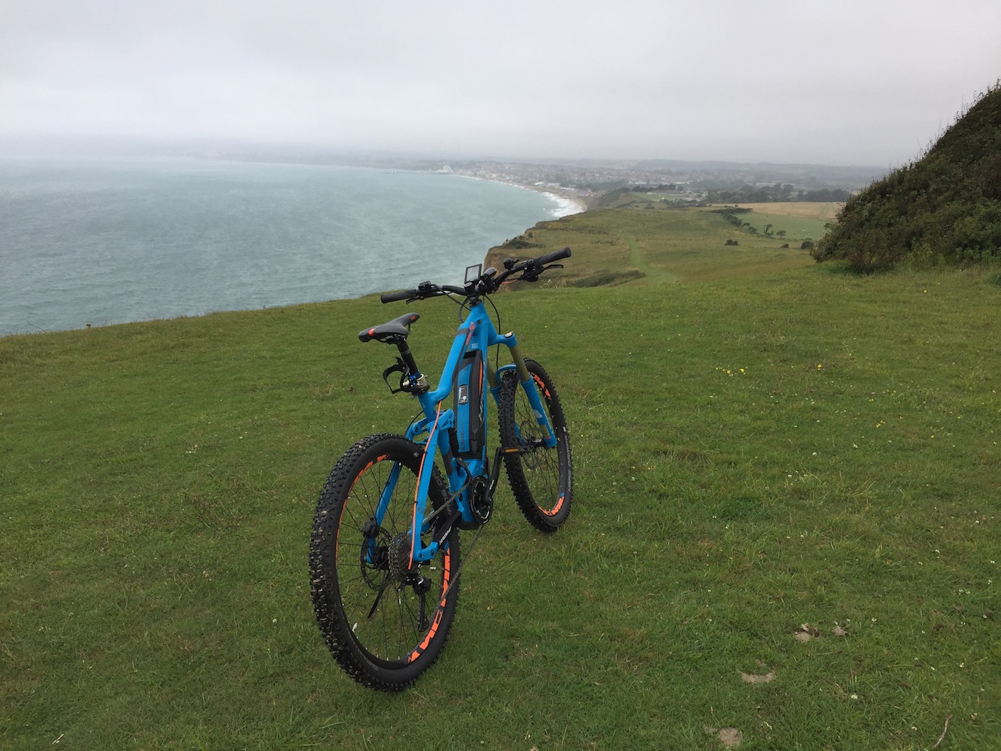

So I am absolutely loving my Allmtn. But I'm after a bit of advice. I had the chain repaired today as the gears were slipping after about 4-5 pedal revolutions. Bike shop Al said one of the links was stiff / jamming and has replaced it with a split link. Sorted. I need to learn to do this myself.
Anyway, he recommended upgrading the chain when I need to replace this one. All fair enough, I tackled a bitumised but very steep climb yesterday in the rain. Then I came off in a slide on the wet grass. The ride down is over chalk, grass and mud. I've read the suggestions about easing off changing gears, especially on a climb. I had a hoot but I’m still getting used to the power.
Have any of you upgraded your chains and if so what do you recommend to replace a KMC X10e?
The Kmc x10e is a chain designed for pedelec and spedelec with central engine.
http://www.kmcchain.eu/chain-e_bike-multispeed-10_speed
The mising links or Quick link :http://www.kmcchain.eu/chain-KMC_X10e_Silver-trekking-10_speed
http://www.kmcchain.eu/chain-KMC_X10e_EPT-trekking-10_speed
http://www.kmcchain.eu/chain-KMC_X10e_Gold-trekking-10_speed.
With chain trunks and quick links it solves many problems.
Maintenance.
With wet weather "chain oil", with dry weather "Teflon oil", the biggest enemy of your chain is salt water, water and air ..... do not use machine under pressure of water / air, this removes the oil inside the Link or chain and replace it with water causing it to rust even though,
The new oil will not enter the link because it is full of water ......

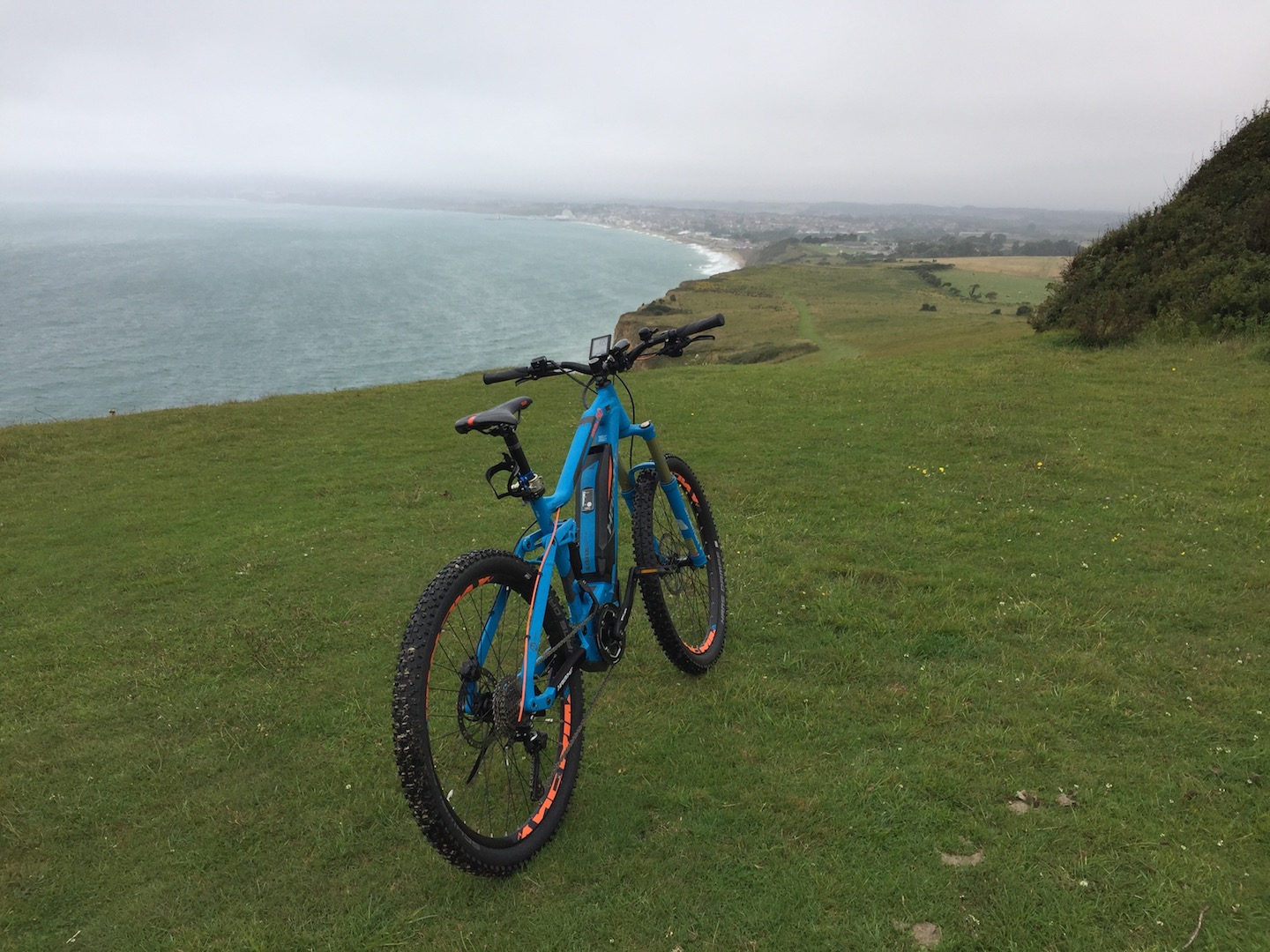

Have any of you upgraded your chains and if so what do you recommend to replace a KMC X10e?View attachment 17604
I also just got the allmtn 5.0 insane bike :) that said i hear something from the chain every 5 pedals? Should i have that looked up? Im a total bike n00b so i dont know.
