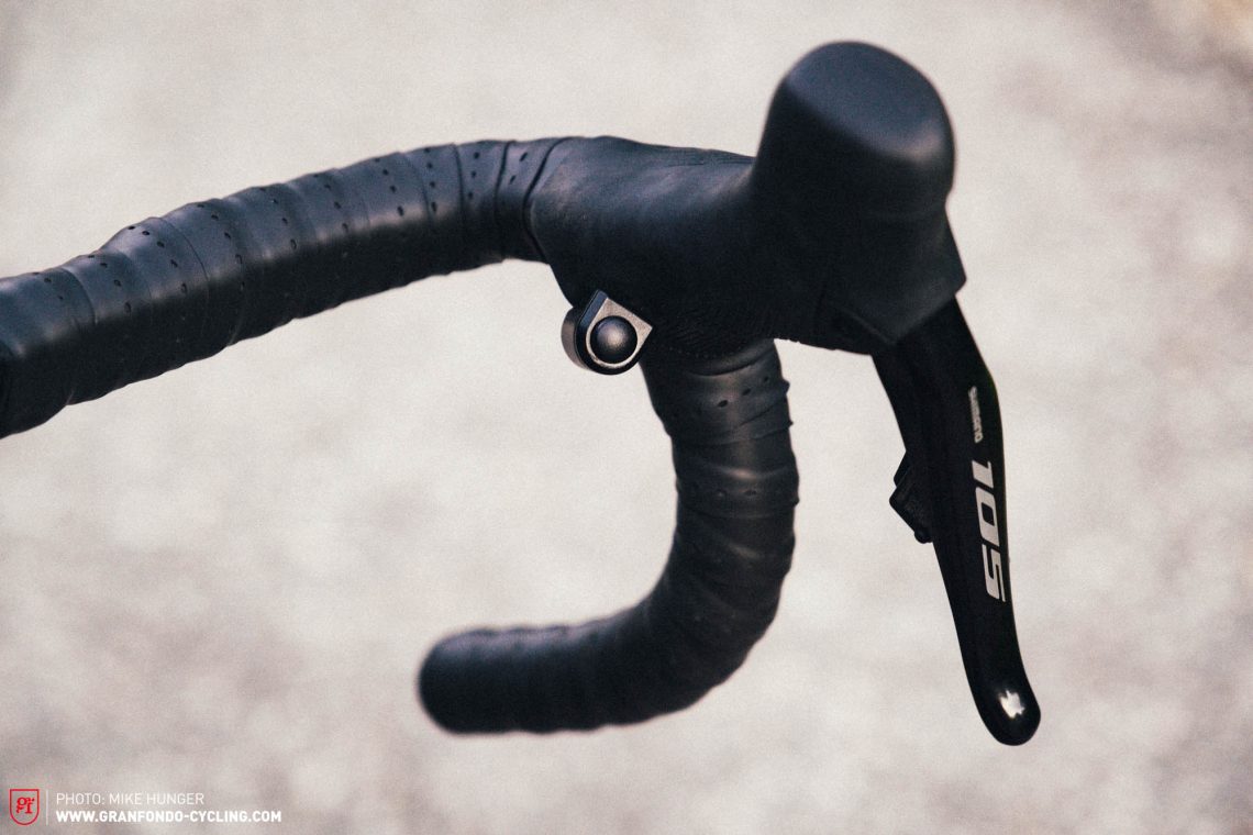

Do you have any developments for the remote. Is it possible to use a Trek Domane+ Handlebar Remote on the Solace?
I've now have the mountain bike remote but have not tried to install it. I did hook it up and it does work, just can't connect it to the handlebars. Too small. It's designed to fit on skinny straight mountain bike bars.
Not sure if the Trek Domane handlebar remote will work but if I had to guess, yes. But, you would likely need their display. The motor is no different. Just my thoughts.
Is it connected directly to the motor or to the display?
Icône de traduction vérifiée par la communauté
The unit I have connects to the display only and why I think you need both. I've watched videos of the Trek version and I believe they have done their own adaptation and software development.

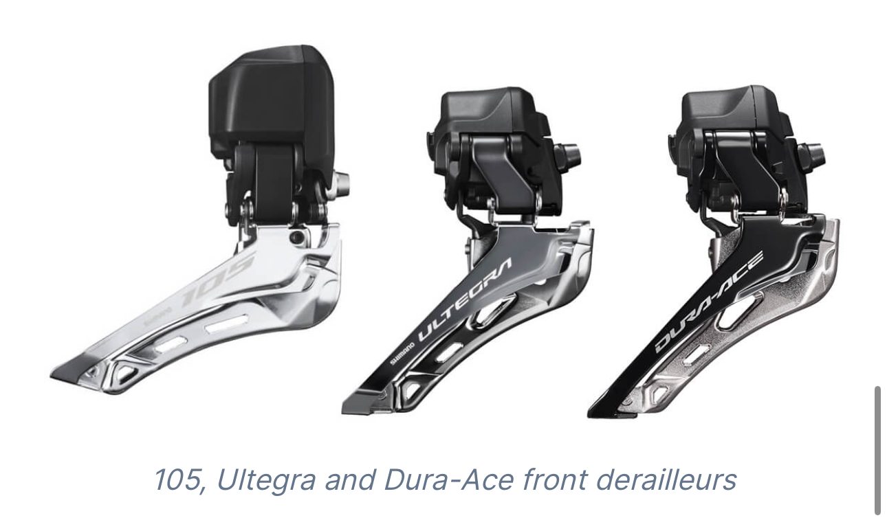

it’s an interesting problem. while the 12 speed di2 dura ace and ultra derailleurs are a new design, identical to each other, the 105 version is actually more or less the same as the previous version. it does shift slower but i doubt that’s the reason, i’m guessing it’s the geometry. not sure what the chain line on the solace looks like, but maybe the TQ is still a little too wide for 2x?
It is strange that both the Scott and the Trek might have this issue. Scott uses a Shimano crankset, while Trek uses a Praxis. The bottom bracket axle on the TQ motor is 135mm, which should leave plenty of room for a 2x. The early Creos, even though they were 1x, had problems with the chain kicking off, frequent enough that Specialized added a chain guard. Maybe it’s from shifting while too much pedaling power is being applied.

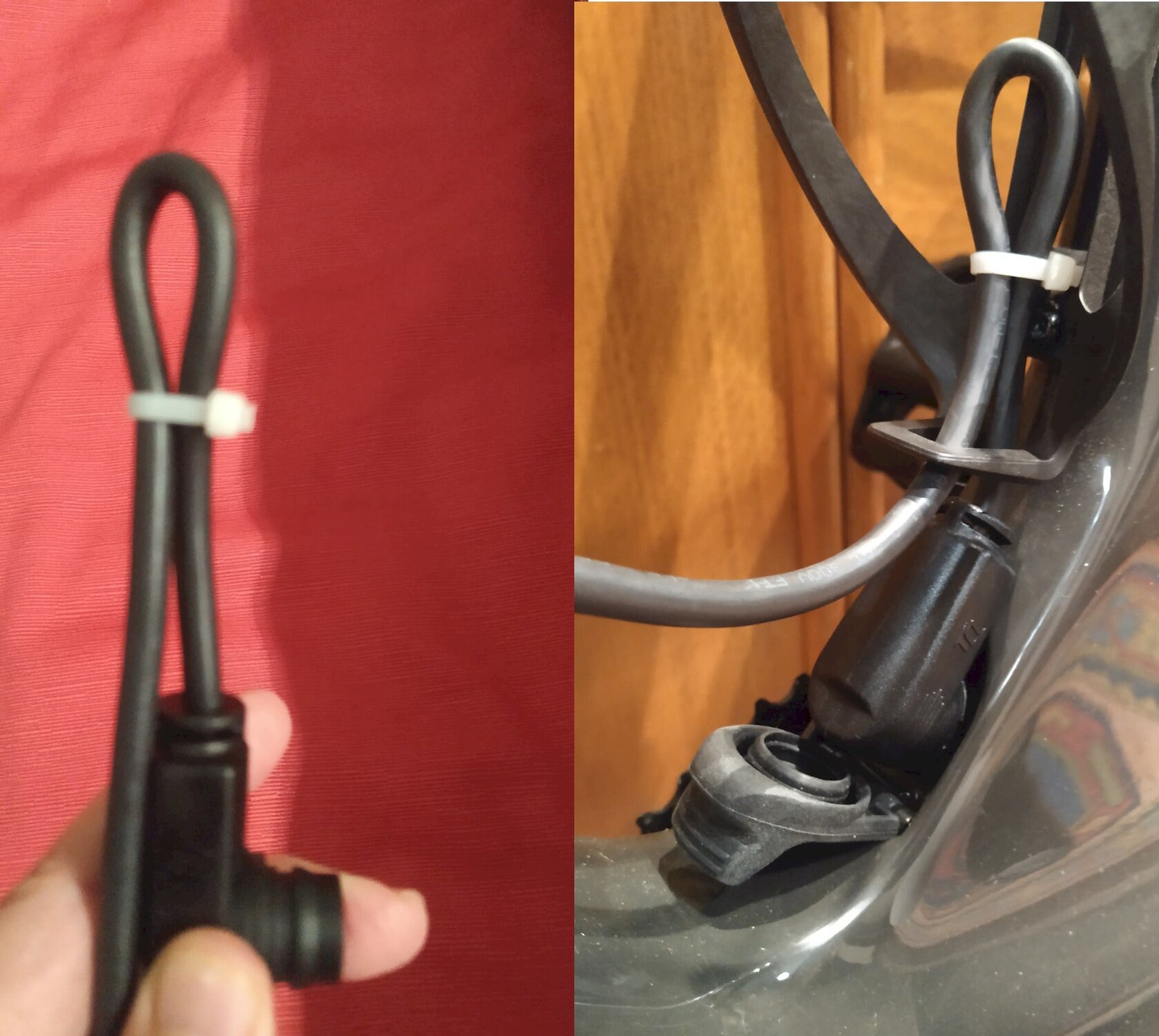

Hello: I just bought a new Scott Solace Eride 20. I've also had this problem happen to me: "The bottle cage on the seat tube blocks the electric charging port" I solved it with a clamp. I attach the image

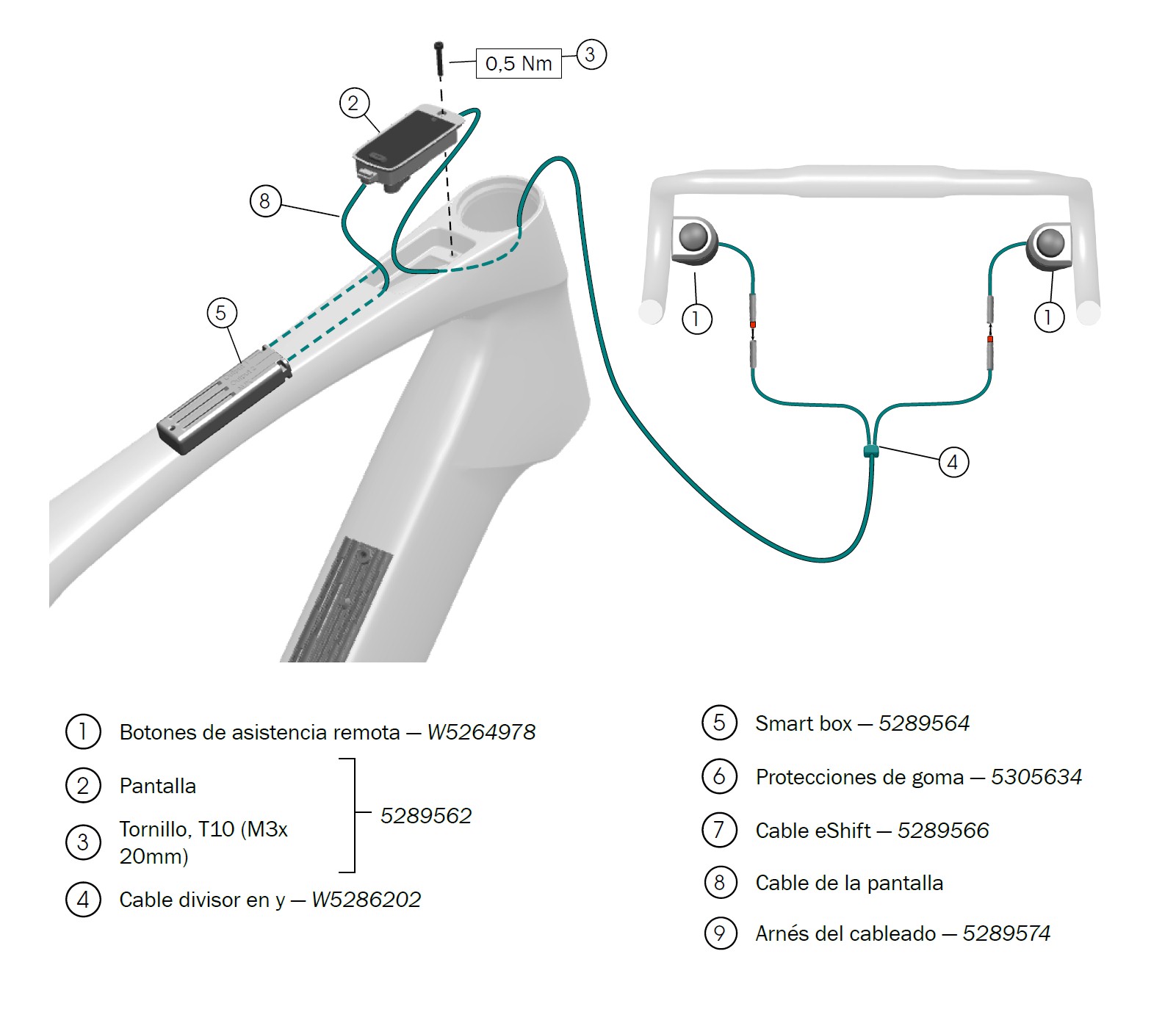

For greater safety I need the controls for the TQ motor on the handlebars. I have sent an email to TQ to find out if I can install them on the Scott bicycle and they literally answered me this: "This remote was developed by Trek and is manufactured and sold by Trek. However, this remote is compatible with any HPR50 system, so it can also be connected to your Scott Solace."
I have ordered them, they will take at least a month. When I have them installed I will let you know. I attach an image of the Trek maintenance manual where you can see what to buy: 1 Botones de asistencia remota — W5264978 and Cable divisor en y — W5286202
I'm sorry for my English

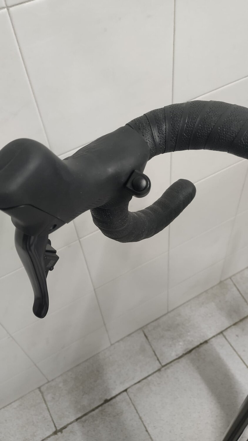

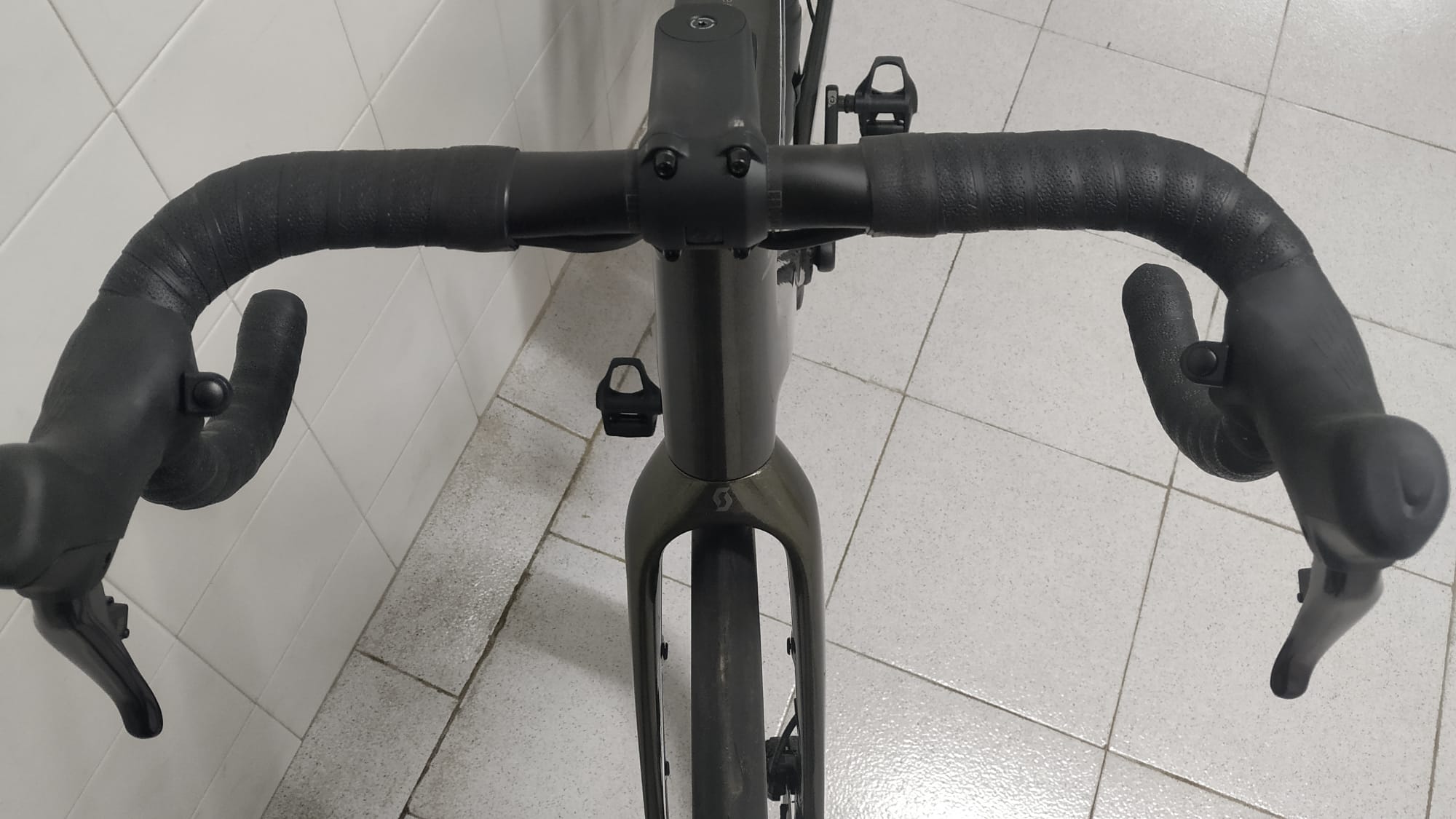

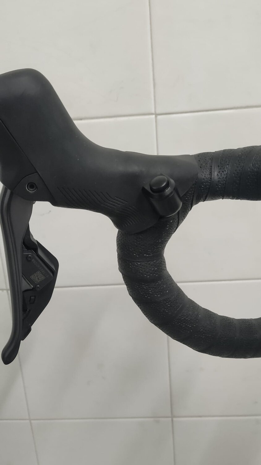

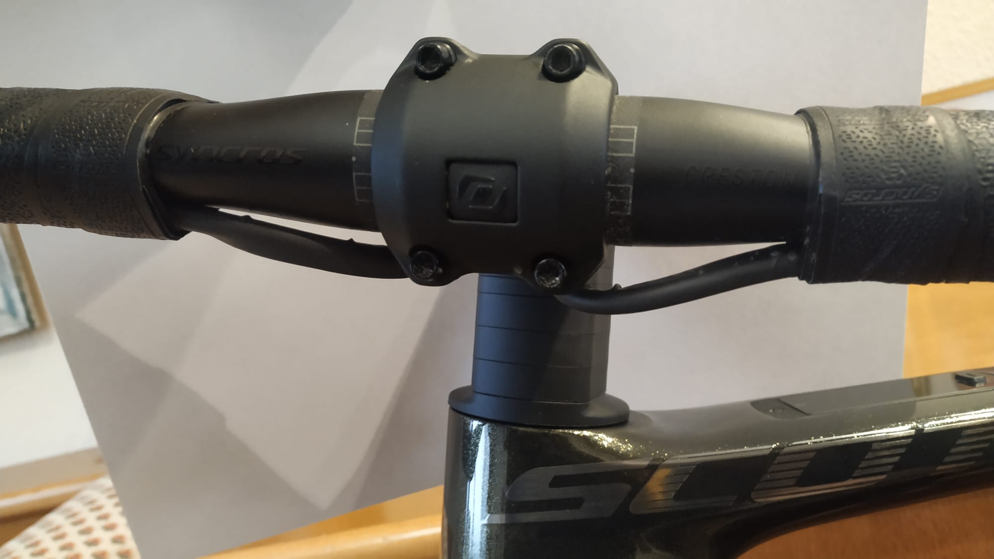

Hoy recogí la bicicleta del taller. He instalado el control remoto del manillar Trek. Funcionan perfectamente en mi SCOTT SOLACE eRIDE 20
Today I picked up the bike from the workshop. I have installed the Trek Handlebar Remote. They work perfectly on my SCOTT SOLACE eRIDE 20

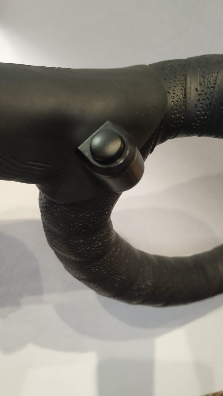

I just got the Trek handlebar remotes that J.A.S. mentioned. I still need to mount them on the bars, but I can confirm they work and it's a plug-n-play affair.

They installed it in the shop where I bought the bike. No program is needed, just connect the cables to the control panel as I put in the diagram previously, it's a plug-n-play affair. Despite being a product manufactured by Trek, it can be installed for all TQ HPR50 engines. For better aesthetics the brake and switch cables are joined with a heat-shrinkable tube.
