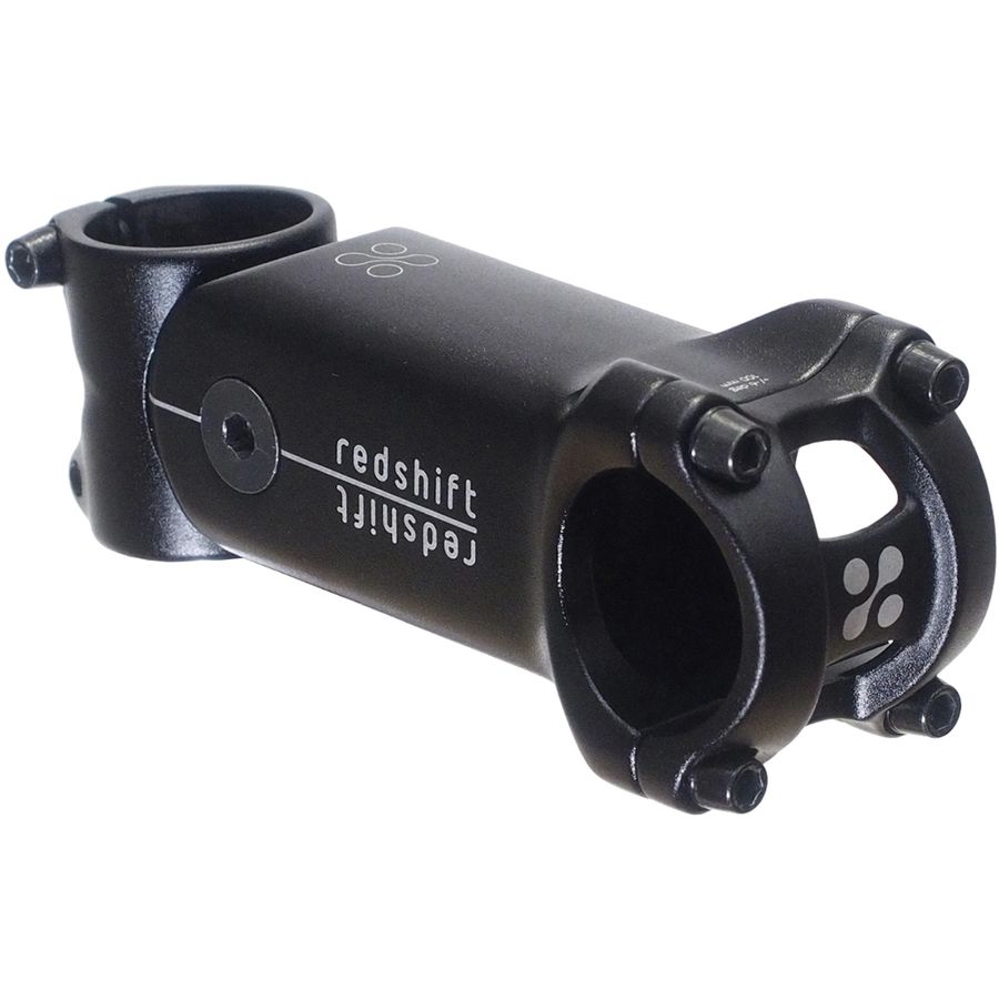

You can also look at this product from Redshift:
On my bike, even with front suspension & Kinekt seatpost, the shockstop helped with wrist discomfort and also offered a bit of butt relief as well. It allows me to put more pressure on the handlebars and take some weight off the saddle.

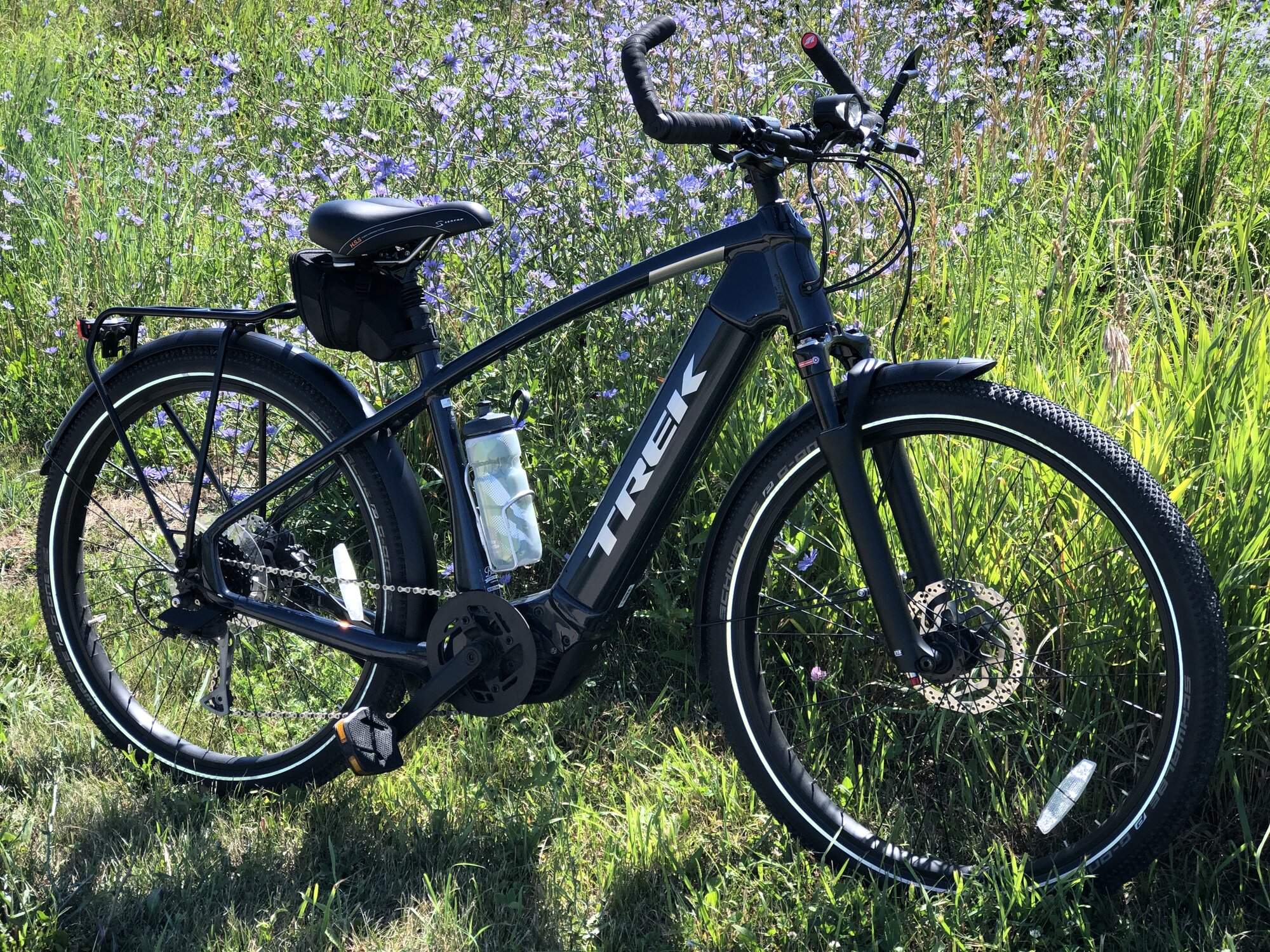

Puncture resistant is my single most important priority. Changing a rear flat is not an option for me. One of my bikes is a Trek XM700 commuter
which came with that goofy little spring at the top of the fork. I found the spring nearly useless . Couldn't tell if your Gazelle Ultimate has the same spring ?
I changed the standard Trex fork with the (goofy spring) for a Rock Shox Gold RL and it made a bid difference. I love everything about how the
bike now handles. Should you consider this choice please check with your LBS for technical guidance. I also have the same Kinekt seatpost
