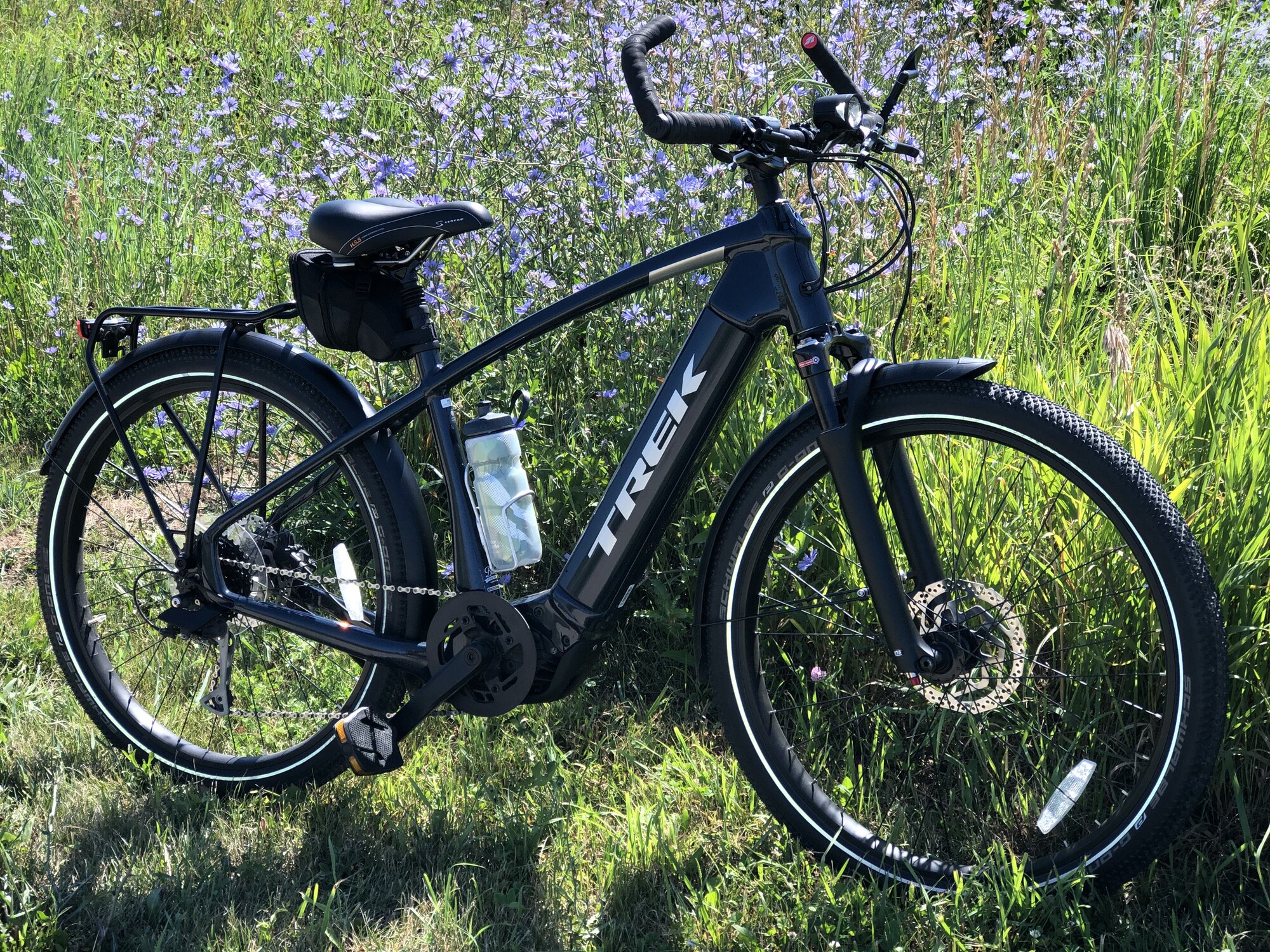

Yeah the SCHWALBE reflective sidewalk and logo on my G-Ones are basically stickers. My sidewall stripe is good and evenly applied but the logo stickers are getting pretty torn up already. That’s ok by me as long as the reflective sideway stays good and visible. I used the flash on my phone to take this picture which shows how well the reflective tape shows up, even in full daylight!View attachment 69468

I'm interested in your experience with those Schwalbe G-One's. Were those the original tires on your Trek? I have a Gazelle T10+ that came with Schwalbe Marathons. I'm finding that they don't have great cornering traction in dirt and gravel. Having experienced one broken collarbone already (not on this bike), I'm a little skittish about that. I'd like to replace them with something like the G-One's. There's an 'Ultrabite' version -- not sure about the difference. My bike has fenders like yours. They APPEAR to have enough clearance (see pic) to MAYBE fit the G-Ones in there. If necessary, I could remove the fenders. I'm hoping to hear that you went through a similar replacement... :)
Regarding the reflective stripe -- On my Marathons, it doesn't appear to be a sticker. If you look closely at the photo, you might be able to make out the ridges of the sidewall pattern running right through the reflective stripe and the lettering. On my wife's bike, which has Schwalbe Big Apples, the stripe is smooth - not showing the sidewall pattern. If it's a sticker, it's stuck on there very well.

Yes they were the originals, at 27.5 X 2.25”. I replaced the rear one with the same tire. I am pleased with their performance but really haven’t cornered real hard/tight in dirt or gravel but would guess the G-Ones would corner better than the ones you showed. Best of luck.
