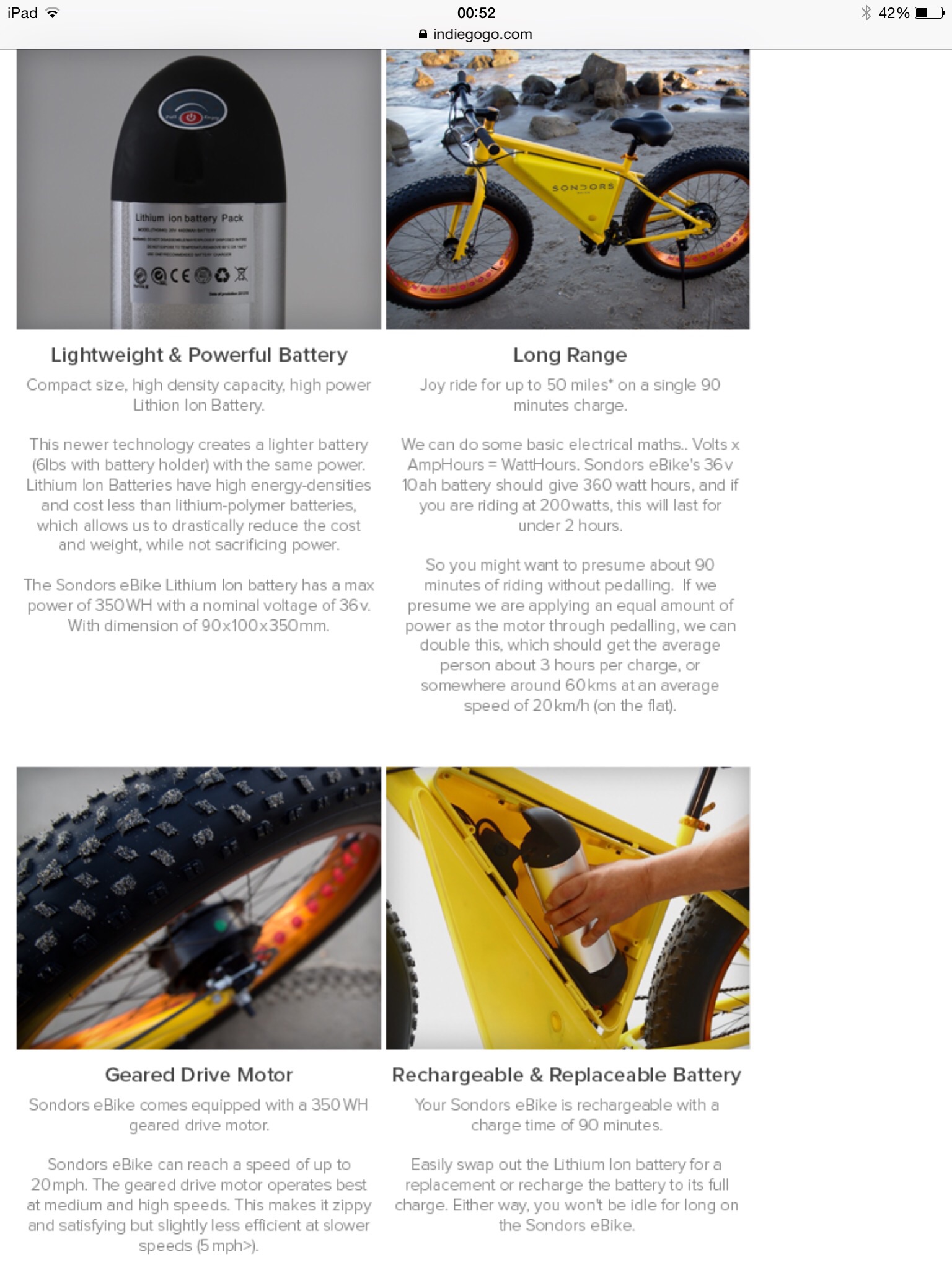

Lol, the charge time depends on how much the battery is depleted PMSL - are you serious? So when it says it will take 90 mins for a full charge, Philips' explanation it it might take longer if the battery has less charge.... Stunning logic...... Just the same as the bike has a 50 mile range if you peddle the first 40 miles........ How can you keep a straight face, so the stated charge time of 90 minutes to full charge is only accurate if the battery has a 50% charge (for example?). This car does 40 miles per gallon only if you put an extra two litres in the tank at the beginning......
Th discussion this morning did not become heated or contentious on my part, it became pitiful and embarrassing for those trying to quash free speech and to claim the questions had been dealt with elsewhere but they did not have the time to point to specific links.... Managed to read Hugh that they had implored Sondors to join the Page and he had ignored it - things don't bode well unfortunstfly
There is no way that little laptop charger will charge full battery in 90 minutes. I had something similar for Specialized Turbo...they called it a travel charger and it took over 5 hours to charge my battery.

6) your photo bucket contained a web flyer from when the campaign started of a 380w motor and a 50 mile range, the basis on which millions of dollars was pledged - now they were deliberate lies.
Just because you have an ebike doesn't mean anyone should listen to your BS about the charge time being dependent on how depleted the battery is before you charge it.
To charge a battery in 2 hours you need a bigger, heavier unit with heat and power control to push the juice safely. Not that thingy you posted. Even Stromer's charger which is flimsier than my big Turbo charger has an actual cooling fan built inside.

I had the Turbo travel charger and get rid of it and posted about it here saying it was catch 22. Charger is smaller and lighter but you'll need to sit half a day at a coffee shop to get any meaningful charge when speed and time savings is what you are gaining from riding an ebike.
So 90 minutes without peddling.......... Hmmmmmmm

Interesting math used to calculate range.
Pedago claims that the average watt usage per mile is 18 for a 36v battery (they claim it's higher, more like 22 to 24 for a 48v battery), therefore if one were using the Pedago math, the Storm would get approximately 360 / 18 = 20 miles range on average. This might not be accurate, but that's the formula Pedago uses to provide estimates to consumers trying to decide which battery to order. Or, if it's a 350w motor, then it would be a range of 18 miles (I'm assuming using only the throttle, with no assistance in pedaling).

That's believable to me. Most of the productions bikes I know of get about 20 miles, but of course you have to put an * by any mileage claim for an eBike. There's many different ways to extend your range. Slowing down, pedal more, tailwind, downhill, ect. I know that bike will never throttle 50 miles, but that doesn't mean anyone will never go 50 miles on a charge. Storm himself said on camera you could expect 20 to 25 miles range. That's a pretty honest estimate, I'm pretty sure I can do that. I'm not going to be riding it wfo the whole charge.
