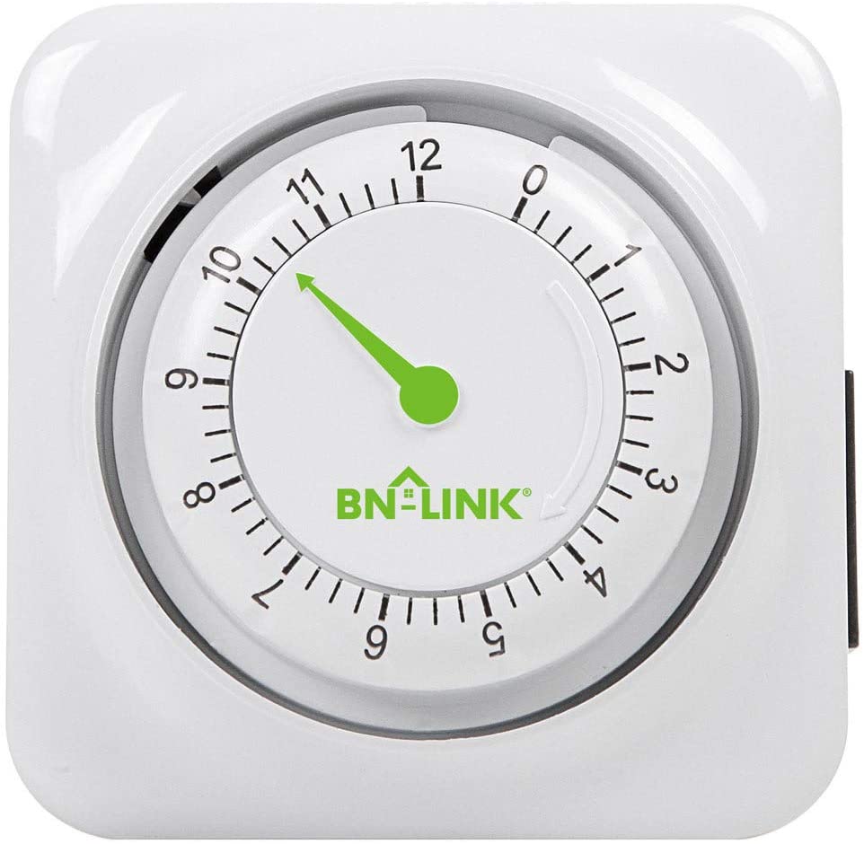

Spend $9.99 and use a cutoff timer.
Learn the charge rate per hour and set the timer accordingly. You want to use a rate-per-hour so you can work your way forward from any starting voltage.
A timer like this also serves as a safety cutoff to cut power to the unit.
On a Specialized battery do you find the charge rate per hour to be consistent up to 80%? Surely over 80% it slows way down.

I may just end up using a smart plug with timer capabilities
The best and safest option.

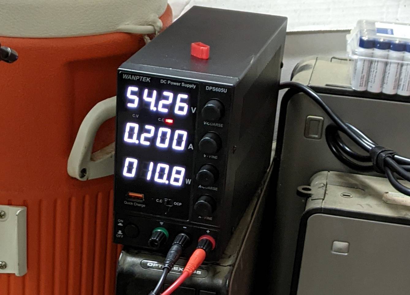

All CC/CV chargers will do that. You have to put in some some time getting a feel for charging to know how to handle both this and your cutoff timer (which you should be using as a fail-safe). BTW I use Mean Well LED power supplies as do many DIY builders as an alternative to a Satiator. Arguably the Mean Wells are a better choice given their using pots instead of a software interface thats a little clunky and limits you to specific profiles. Since they are genuinely IP65 I mount them onto some of my bikes as a permanently attached onboard charger.
I also have a 60v lab power supply at my office that does the same job. It lacks the incredible MTBF of the fanless, weatherproof Mean Wells, but it can be set down to a charge rate of around 0.20 amps (Satiator bottoms out at about 0.50a) and has nice dials to quickly set from one voltage or current rate to another, with a nice 3-digit-accurate display. When I am at work, if I am making a trip to the bank during the day, or taking an extended trip across town to Costco after work, I can benefit from a quick, convenient change to voltage and current levels. Its a small convenience but when you're riding daily for utility not recreation little stuff like this counts.
On that 0.2a charge rate, I charge only to a level needed to finish to my target by end of the current day. Typically 0.20a is sufficient, 0.50a or even a whopping 1.0a if I want to throw caution to the winds and just pour on the juice willy-nilly.
