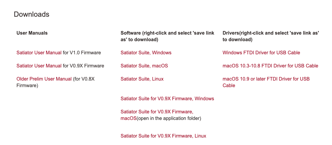

P.S. Tom: What diagnostic information information can you extract from a typical battery you're using?
You can find your answer here. Download and review the software settings.

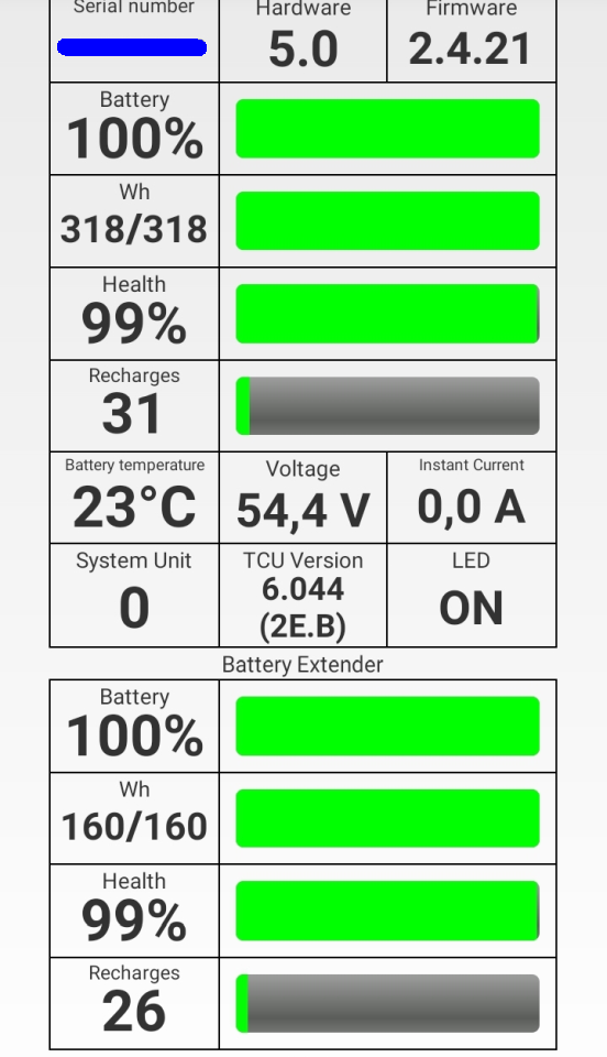

@tomjasz: It looks you are trying to avoid answering.
Here is the information for Specialized SL main battery and optional SL Range Extender that can be extracted from the e-bike:
Does Satiator work at this level with Specialized batteries? Can it charge the SL batteries in Y layout? Does the Satiator know you shall charge and balance both batteries at the rate proper for the smaller Range Extender? And finally, why use the Satiator in the first place? To shorten the lifetime of Specialized batteries with excessive current?

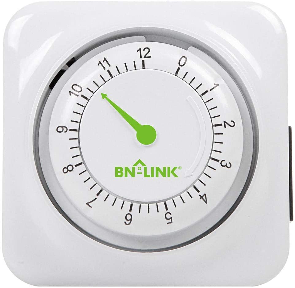

Lets all ignore the (never-ending) arrogance on display here and shift to a simpler approach. There's a way to do limited charging (80% etc.) that is much simpler and uses the unfortunately restricted Specialized hardware.
Spend $9.99 and use a cutoff timer.
Learn the charge rate per hour and set the timer accordingly. You want to use a rate-per-hour so you can work your way forward from any starting voltage.
A timer like this also serves as a safety cutoff to cut power to the unit.

@tomjasz:
I'm not following you. That information has absolutely nothing to do with the Specialized charger. If you charged your bike with the Satiator you would have access to the exact same information. I assume you have access to the Specialized dealer software. Mission Control shows battery health and charge cycle count.
