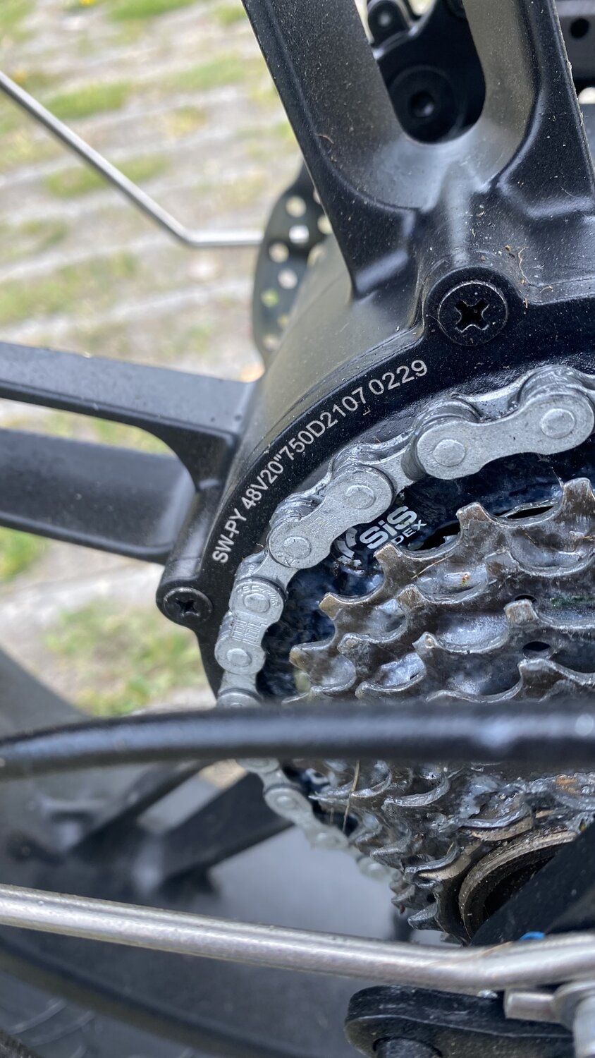

- Motor: sw-py 48v20”750d2107 0229
I found out this is the “real” 750w bafang motor, which as this forum states.. is being the only good thing about the bike :)

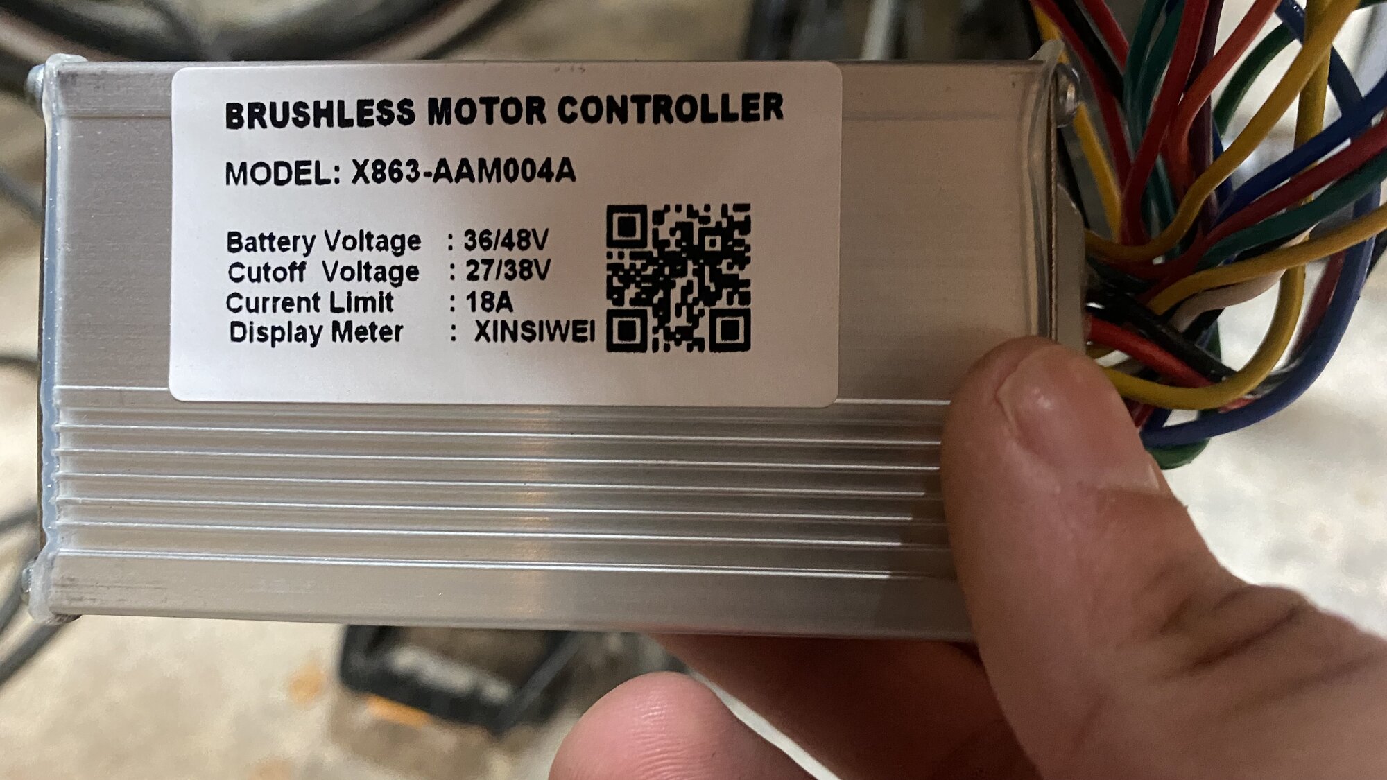

- Controller: x863-AAM004A, 18A brushless
nothing on Google, Chinese websites what brand this is or type. it’s a custom OEM controller, which cant talk to/with a bafang (750C) and KT (lcd8h) displays… and must have a male connector. (5-pin, green)

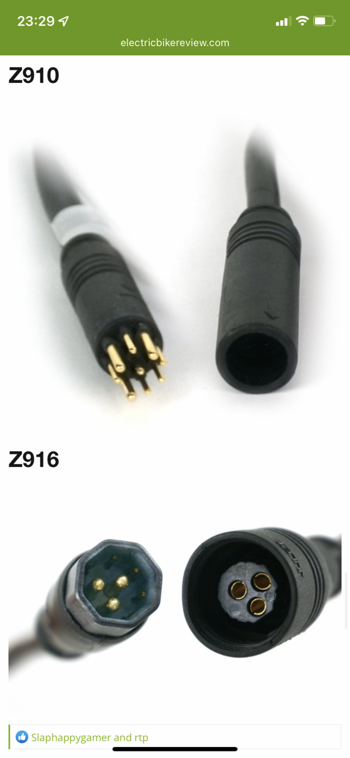

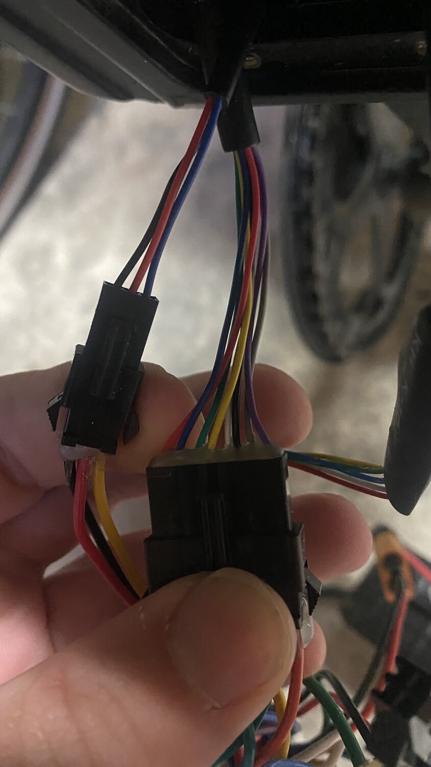

  • Motor uses the thicker plug then 350/500w variant (to controller)
  • Best is a KT variant type with same brand display
I don’t want to buy something and hope for the best. I want to buy something that’s sort off.. compatible with the motor (wires) the controller can, if required) go on frame with a box.

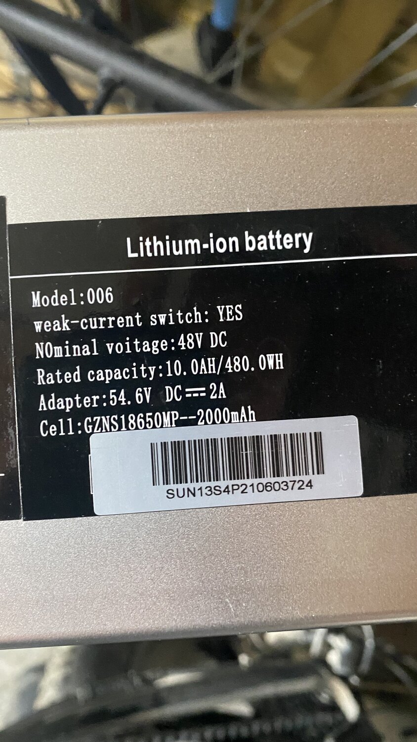

The battery:
See picture

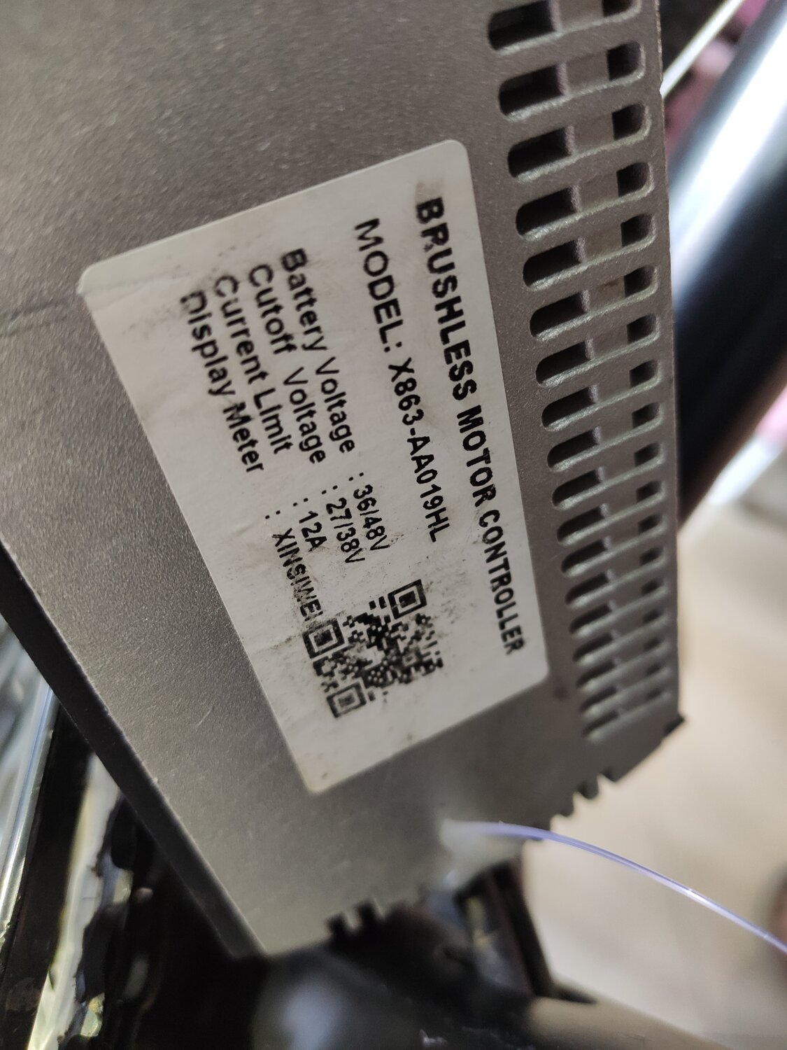

I am now basically on the same boat, except I have the Samebike MY-SM26. Of course, it came with the locked-down S830, so I am seeking ways to overcome this and tweak the settings a bit (I live in a hilly area).
I've already bought (kinda stupidly!) the SW900 display, thinking it would work with the X863 controller (the "hidden" variant which sits underneath the Hailong battery), but no luck, obviously. So now I'm basically looking at 3 options:

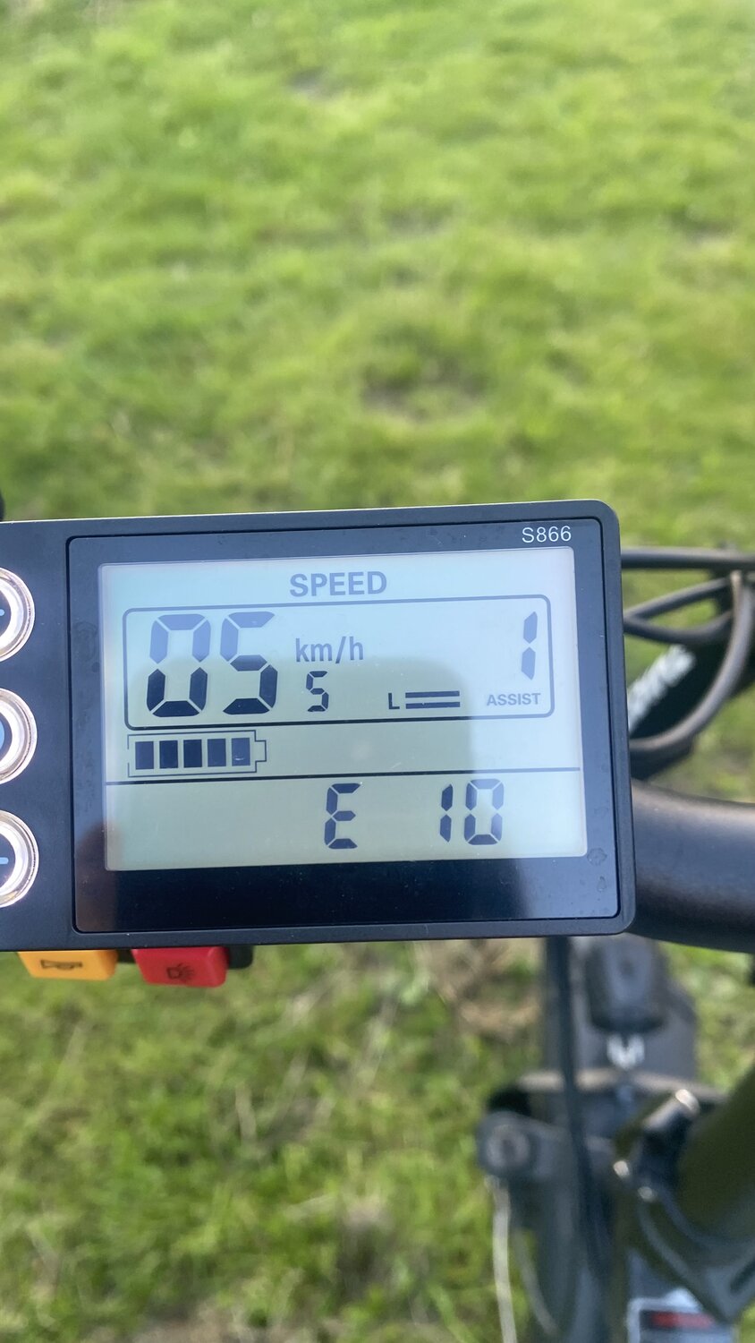

Hi,
Seems it’s a difficult question as no one else replays. I’ve bought a s866 display, with protocol #2, which works but it gives a e10 error.. “communication error” with the controller after riding 10km. So I returned it duo lack of compatibly.
I’ve contacted several AliExpress guys and they cannot guarantee that the s830 display is unlocked and contacted their factory and said “new protocol says that the display must be factory locked” same as what “samebike” relied via mail.
Next option is just to replace the controller and display by a KT variant, I’ve got a 750w motor and should handle easy between 22-30a controller.. so that’s my search now :) to find a most compatible controller due the wires and that suits inside the frame. It will cost mostly between 80-200€ Depending on what kind of display you choose. Most kits come include brakes, pas etc.. but I don’t need that all i think 🤔
