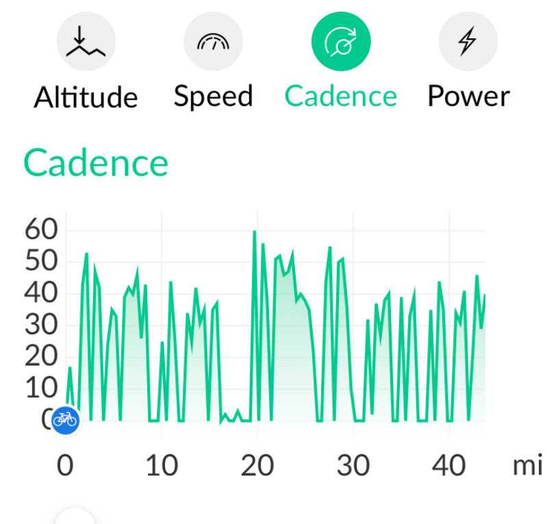

i did find the Cadence data. On a 44 mile ride: Avg cadence: 37rpm. Max cadence: 86rpm. 0 Ascent/decent. Avg. user power 61w. Avg speed: 11.2mph. Max speed: 30.8mph. Looks like I have to up-my-game!
