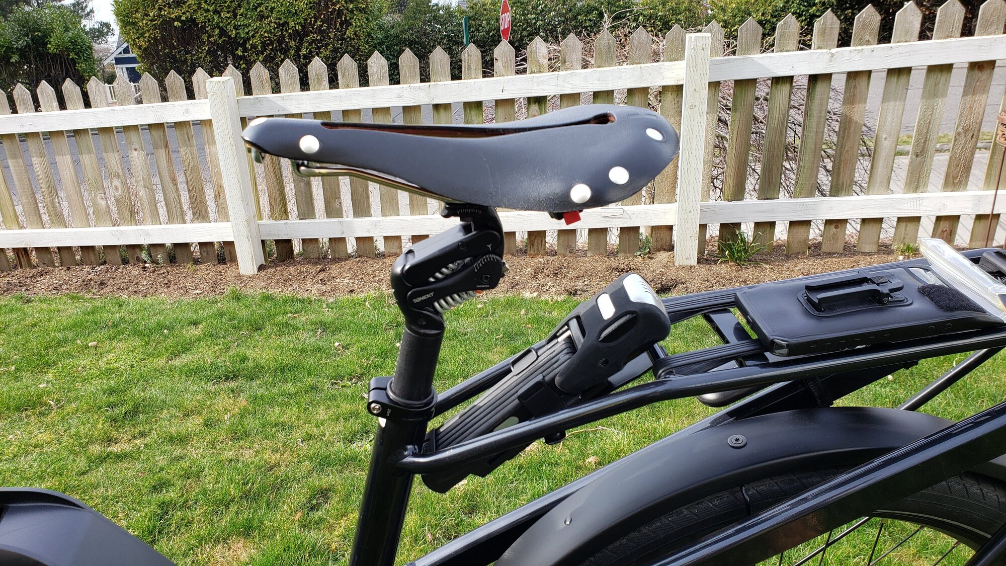

I've tried way too many saddles. Nothing has proven more comfortable over time than my Selle Anatomica H2View attachment 50111
I am thinking of trying one of their saddles. I am roughly 190 pounds fully clothed but once I start cycling more I should drop 5-10 pounds. Would you go with the H2 or X2? X2 is for up to 190 pounds. H2 is for 190+.

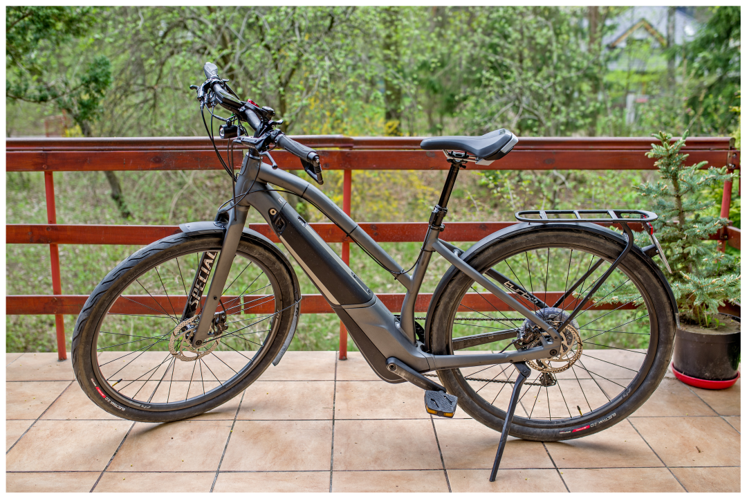

The black battery cover and gray bike create a very nice contrast. It goes well with the rest of the bike.

The H2 is 165mm wide. This is the saddle rated for riders up to 250 lbs. (113.5kg) Their X-Series is for up to 190 lbs. (86kg).

Hi Alaskan. Thank you for posting such extensive information. Based on your recommendation I thought I would give the Selle Anatomica H2 a go for the 2020 Specialized Vado 4.0 I have on order, especially since it was on sale. Since I really like having a Kinekt 2.1 suspension seatpost on my Super Commuter +7, I wanted one for the Vado as well. Was able to get 25% off on both the Selle Anatomica H2 saddle and the Kinekt 2.1 on the Selle Anatomica website.
