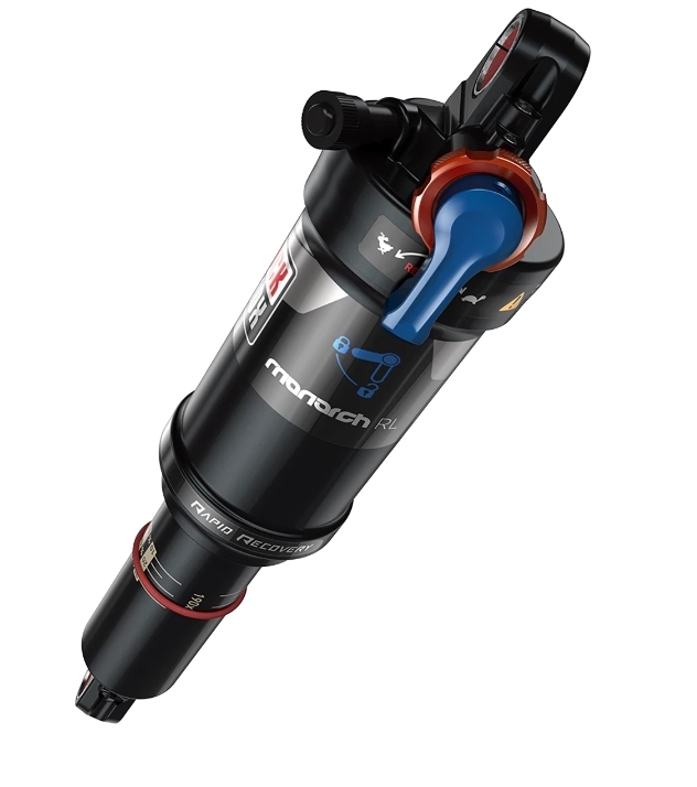

I just noticed this about your shock,..
Rockshox Monarch RL
Yours is an RL and mine is just an R.
Does yours have a lockout?
Maybe that's what the L means??
Maybe I can convert my shock into an RL with a valve replacement?
Maybe I can add an separate air can too??,.. For whatever reason I would want to do that?
Like super charging my air shock so I can do backflips with my 48v compressor and an air can.
I could reroute the lock out lever to work as a launch button to dump 300 PSI from the extra air can into the shock. ๐Ÿ˜‚
I've already got a remote lockout switch for my forks that I didn't bother to install because I have no need to lock them out.
I could hook up the handlebar mounted lever to dump air into the forks to launch the front end.
I could install another lever for the rear shock to launch the rear end.
I'm sure that with some practice, I could do back-flips, forward-flips, or a perfect pronk with no rotation at all. ๐Ÿ˜‚

Yes my shock has a lock out... The blue lever. Red dial is rebound adjustment.

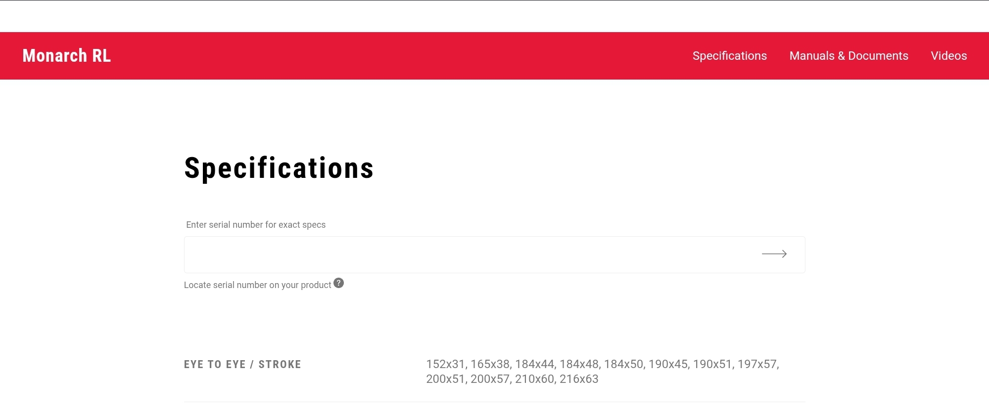

I didn't have much luck with Amazon Canada. It shows some regular 15 wt hydraulic fluid, and the Chinese fork lube that I think I posted a picture of in the thread you linked to.

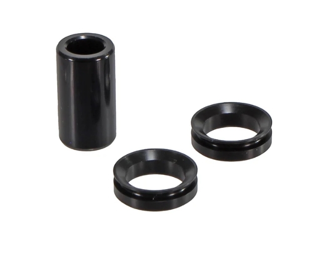

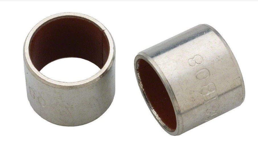

Did you remove your bushings to install them in the replacement shock?
Could I just leave mine installed and still get my shock apart to grease the air can?
@PCeBiker ...yeah the bottom bushing needs to be removed from the eyelet to allow clearance for the main air can removal.

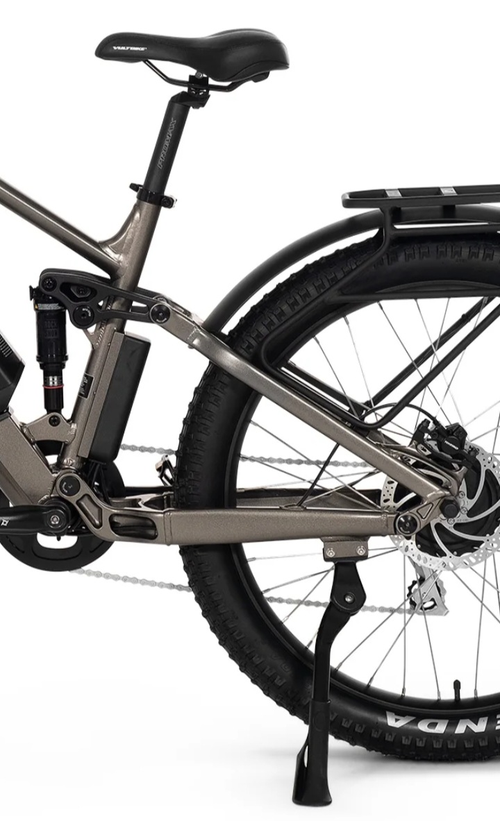

I have that same shock on my H-Bike Full FatSix (110mm travel....not sure what your travel is).

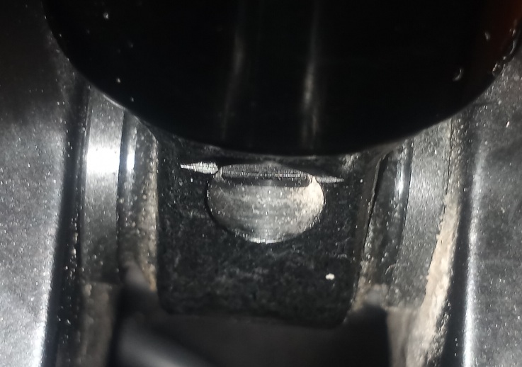

I removed my battery and stuck my phone all up in there and took a picture,...
I'm thinking that I don't have to press the bushing out?
Looks like I've got clearance?
And,.. I'm pretty sure my shock has 190 mm of travel with a 51 mm bore?
And,.. it looks like I can grease the bushing?

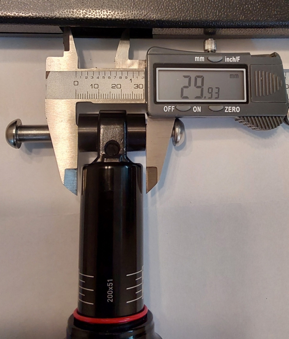

For me it was real close but no. My bushing (mounting hardware portion ) looks a little longer. When I say bushing it's not the first eyelet one (shown in video) it's the next inner piece that sets the legnth of the mount and just under the plastic spacer/covers.

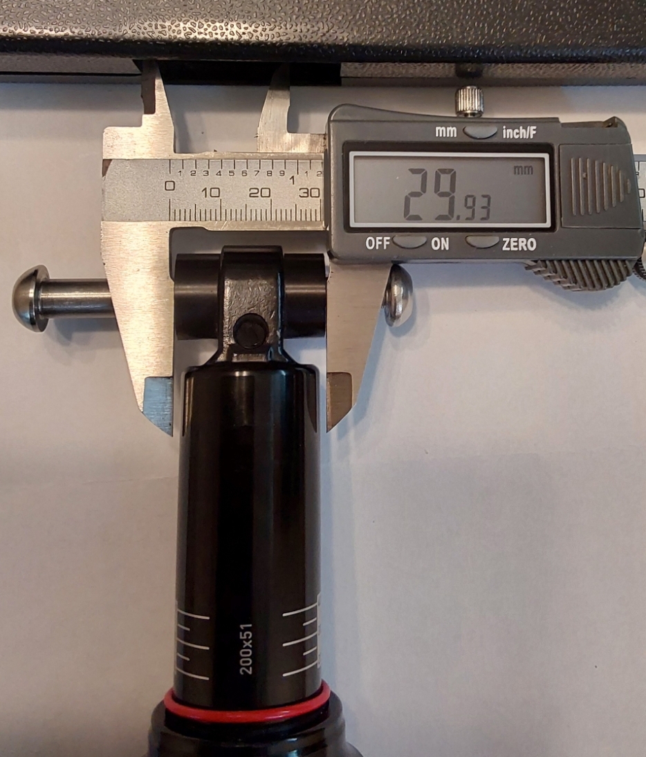

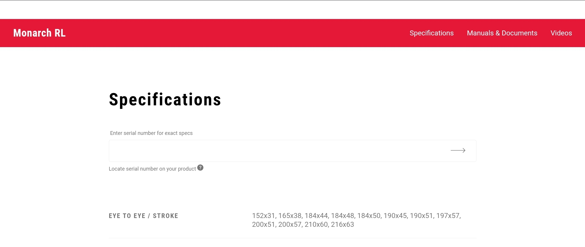

Screenshot_20250331_021058_Chrome.jpg. Screenshot_20250331_022132_Chrome.jpg

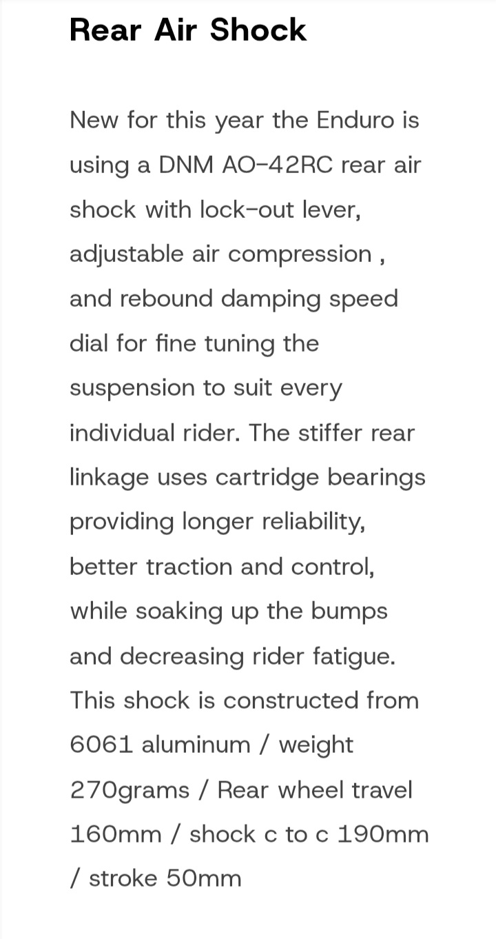

You have that a bit backwards. It's 190mm eyelet to eyelet with 51mm of travel.
Mine is 200x51...Just sayiล„ ๐Ÿคฃ
View attachment 191447. View attachment 191448

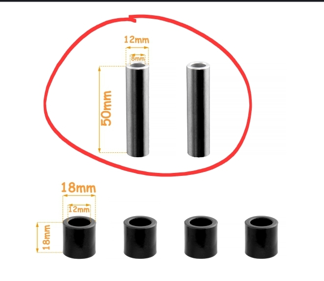

OK, well I'm just going to have to see what's hiding under the plastic spacers.
I might have enough clearance?
Well, there's something wrong with the math??
I'm thinking that @Mike TowpathTraveler is showing the travel of the swing arm itself?
Probably measured at the wheel axle or tire contact patch?
Unless his Monarch shock is over a foot long?? ๐Ÿ˜‚
I've got a 4-point rear swing arm which makes the math more difficult.
I couldn't find the specs on the travel of the swing arm itself?

Well these are the options for the Monarch RL
63mm being the longest stroke.
110mm sounds like fork stroke numbers
Under the spacer is the metal hardware that sets the width to match your bike and slides into the bushing. So on the bike you measure from outside spacer to outside spacer. That's what the air can will need to clear. Mine was a few mm too wide so I had to remove the piece circled in red above.
On a fork, the stroke number is the same as the travel.
A rear shocks stroke number gets multiplied by the swing arm geometry.
My 4-point pivoting swing arm makes the math all complicated.
Even as the the shock is compressing, the math changes because the angle of the shock relative to the frame is changing which changes the compression rate.
The same basis design can be used with any shock length giving the same travel distance at the rear wheel, depending on the geometry of the swing arm.
I'm 98% sure that I've got clearance,..
It's just really hard to take the picture.
Just put it in a vise... You'll be thankful you did.
If you don't have aluminum soft jaws.. Some oak blocks are strong enough.
I'll probably end up having to do that, but I'm going to try and do a 5 minute quick service job like how the professionals do it. ๐Ÿ˜‚

I'm putting a Big Ole Volume Spacer In !!!

Well guys, I had to go out and check on the rear shock after I just ASSumed mine was a 110- Monarch RL......
D'oh...... it's a Monarch RT3......... 190x51!
The Rock Shox Bluto fork is a 110mm stroke. I think....:rolleyes:
D'oh...... it's a Monarch RT3......... 190x51!:rolleyes:
I'll be deflating my shock shortly, so I'll take a rough measurement of the full travel of my rear wheel.
I have no idea what the travel is? But I've never bottomed out.
I'm going to ride it first to get a really good feel for it before I add a Big Ole Air Volume Spacer to see if I can feel any difference.
That way I can procrastinate everything until Spring Fever kicks in and I finally get my ebike put back together.
It's still too cold to think about Spring right now.๐Ÿ˜‚
Apparently the shock isn't good enough anyway, because it only has rebound adjustment and lacks compression adjustment. ๐Ÿ˜‚
I just looked into the mid-drive version of my e-bike,..
I thought it was the same as my e-bike, except for it being a mid-drive, but it's got a different shock,..
And It's Got a Lockout, Rebound Adjustment AND Compression Adjustment !!!??
So I'm not going to bother greasing my shock.
It's a crappy shock. ๐Ÿ˜‚

EDIT:
I'm not sure now?
Adjustable Air Compression could mean adjustable preload?
That doesn't necessarily mean that it's got an Adjustable Commpression Rate?
