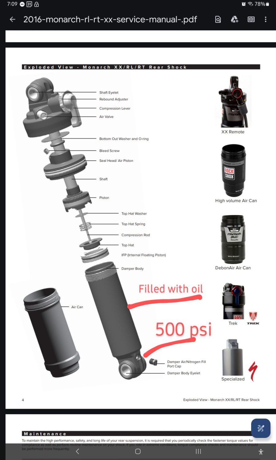

~$60 will buy a new damper.
Thats cheaper than rebuilding it, and you probably won't need the 500 psi to replace it?
No I don't think the grease job fixed it... But just fiddling with it did. It is starting to bind, intermittently at first and is slowly worsening. The grease may have made everything else work a little better masking the issue for a short while.
Those new pieces need to be assembled into the damper body with oil and then charged to 500psi. So just more added cost.
The only way that spending more money fixing it than replacing it would make any sense, would be to learn how to do it so you can rebuild them for $200 a pop for other people.

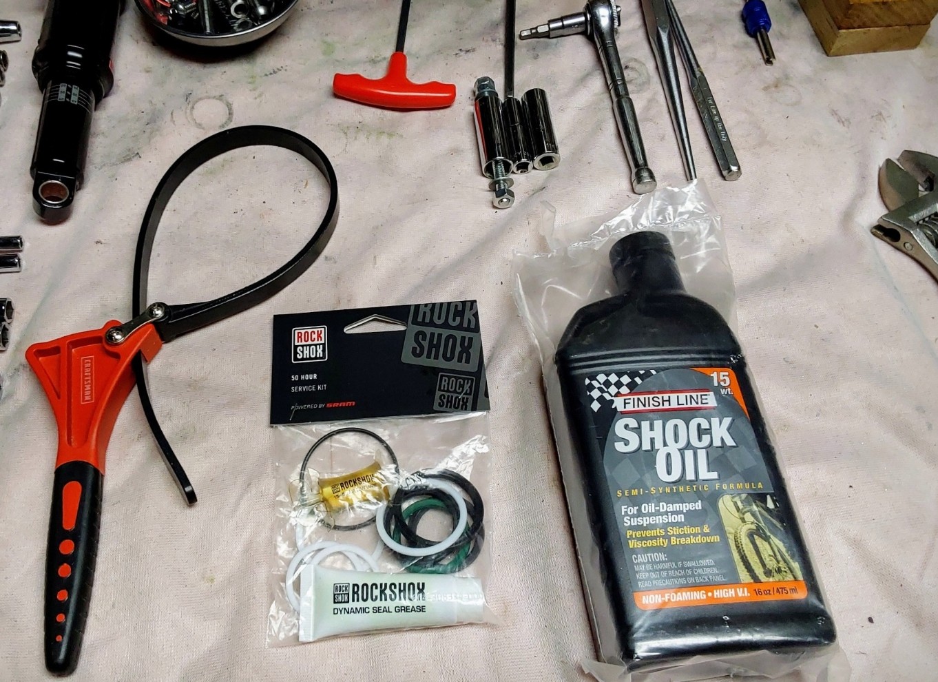

Parts in...
... now in search of ambition.

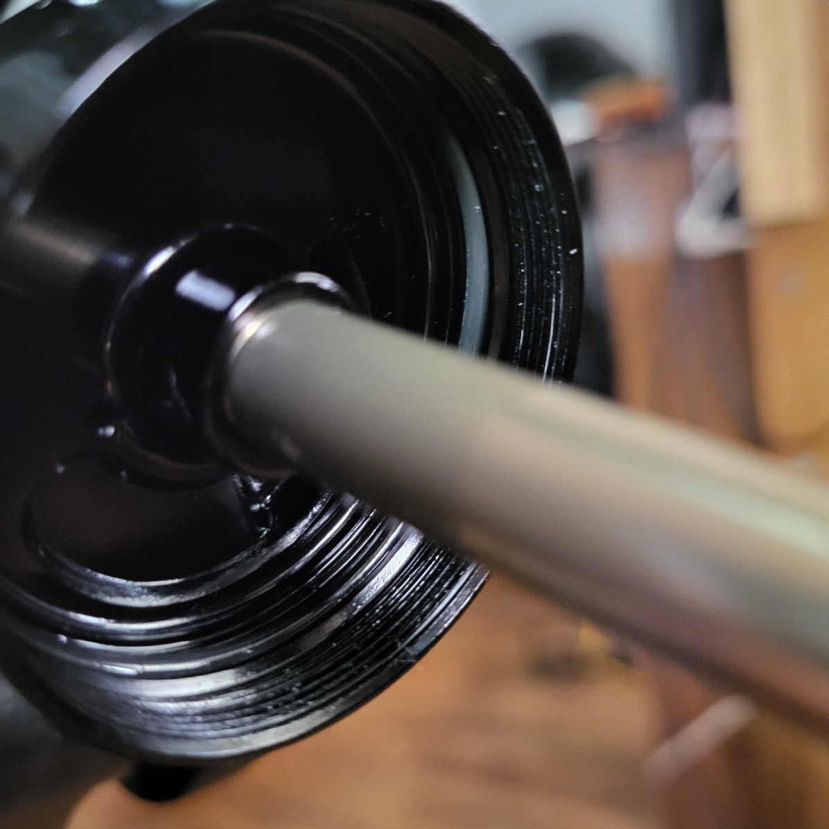

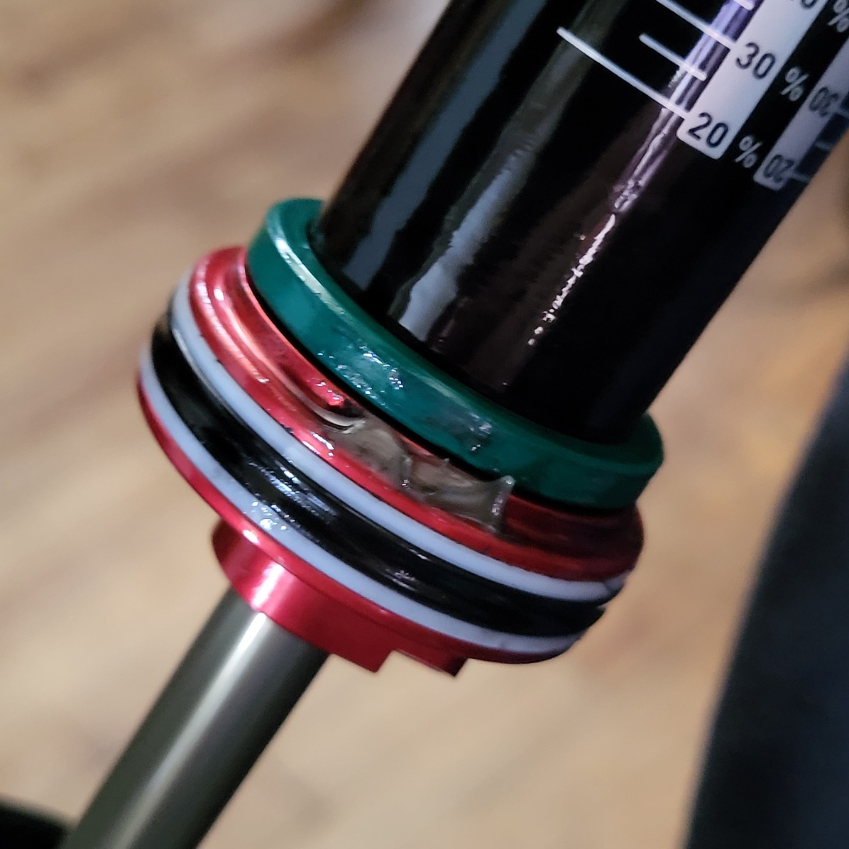

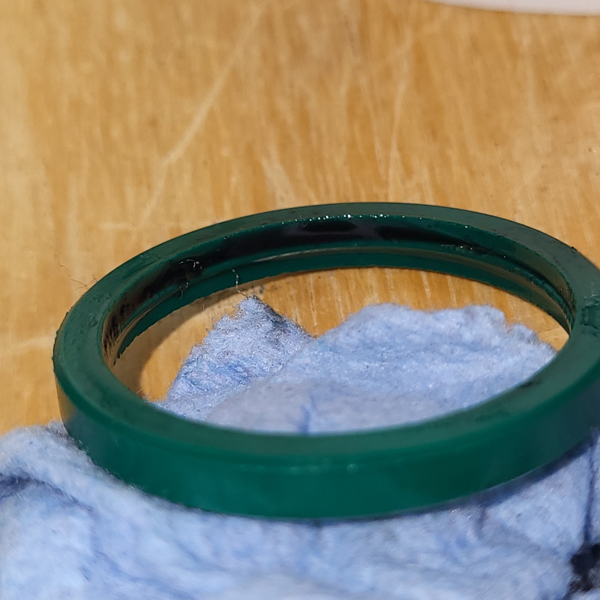

I've had my parts in for months and finally found some ambition. 😀

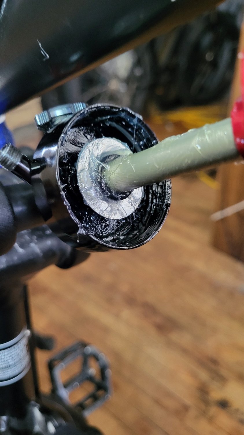

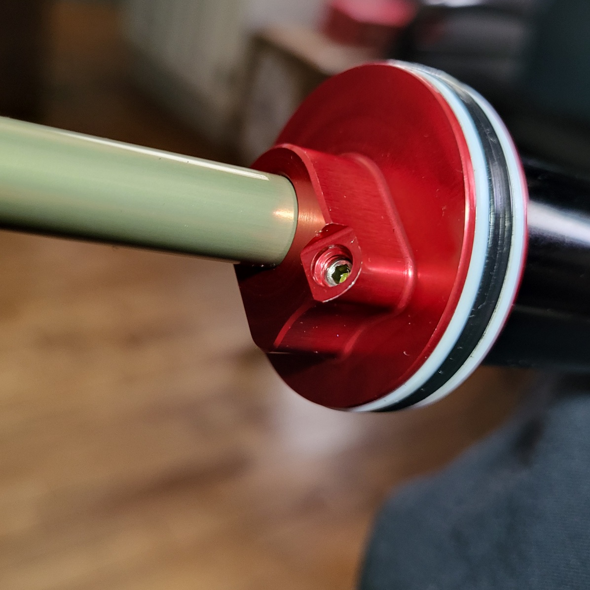

I found more crap leaking out of my shock, so I knew I better Git Er' Done,..
No.
Absolutely No
... and No f'n way.

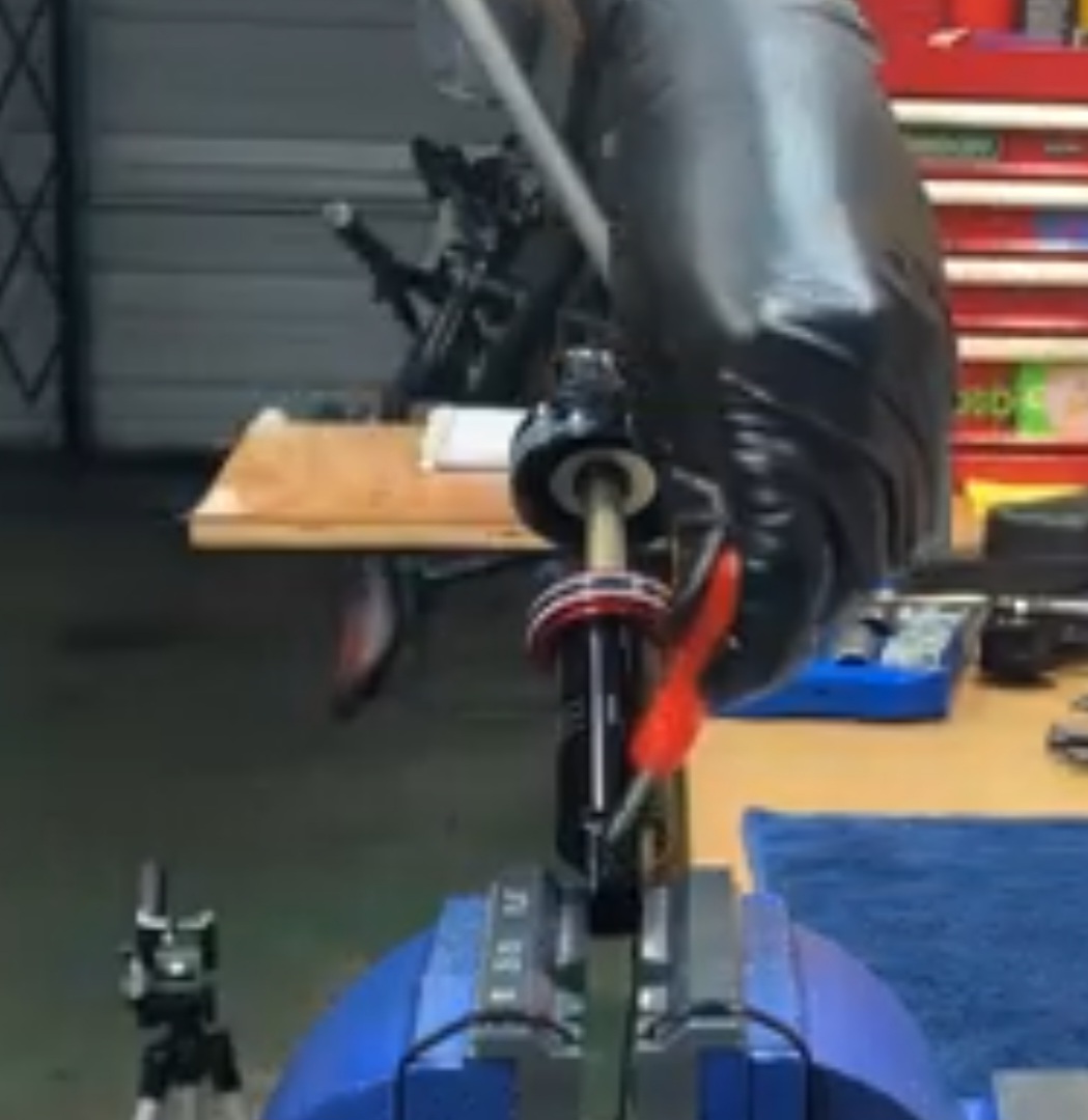

Believe me you don't want to attempt it on the bike for many reasons.

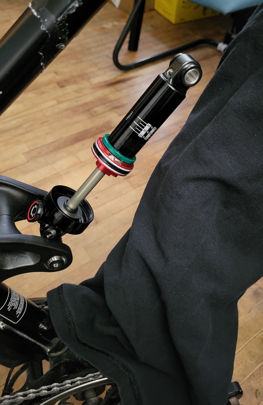

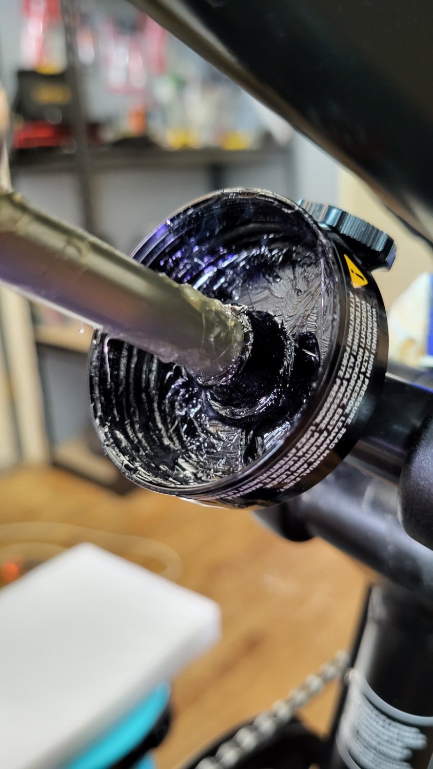

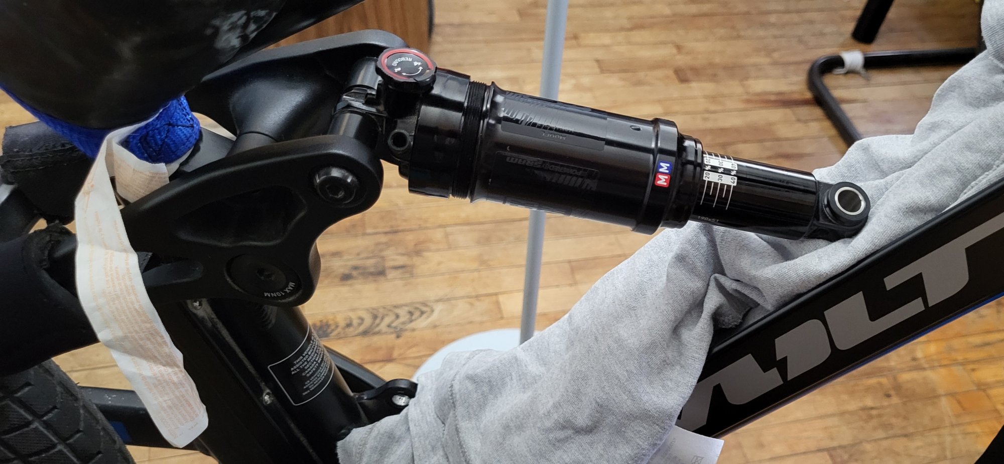

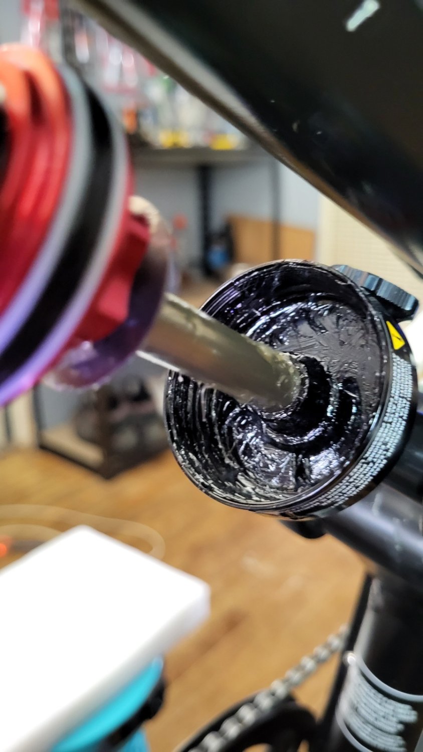

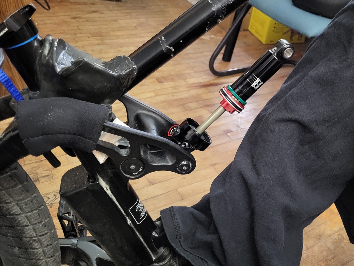

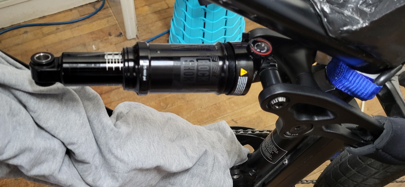

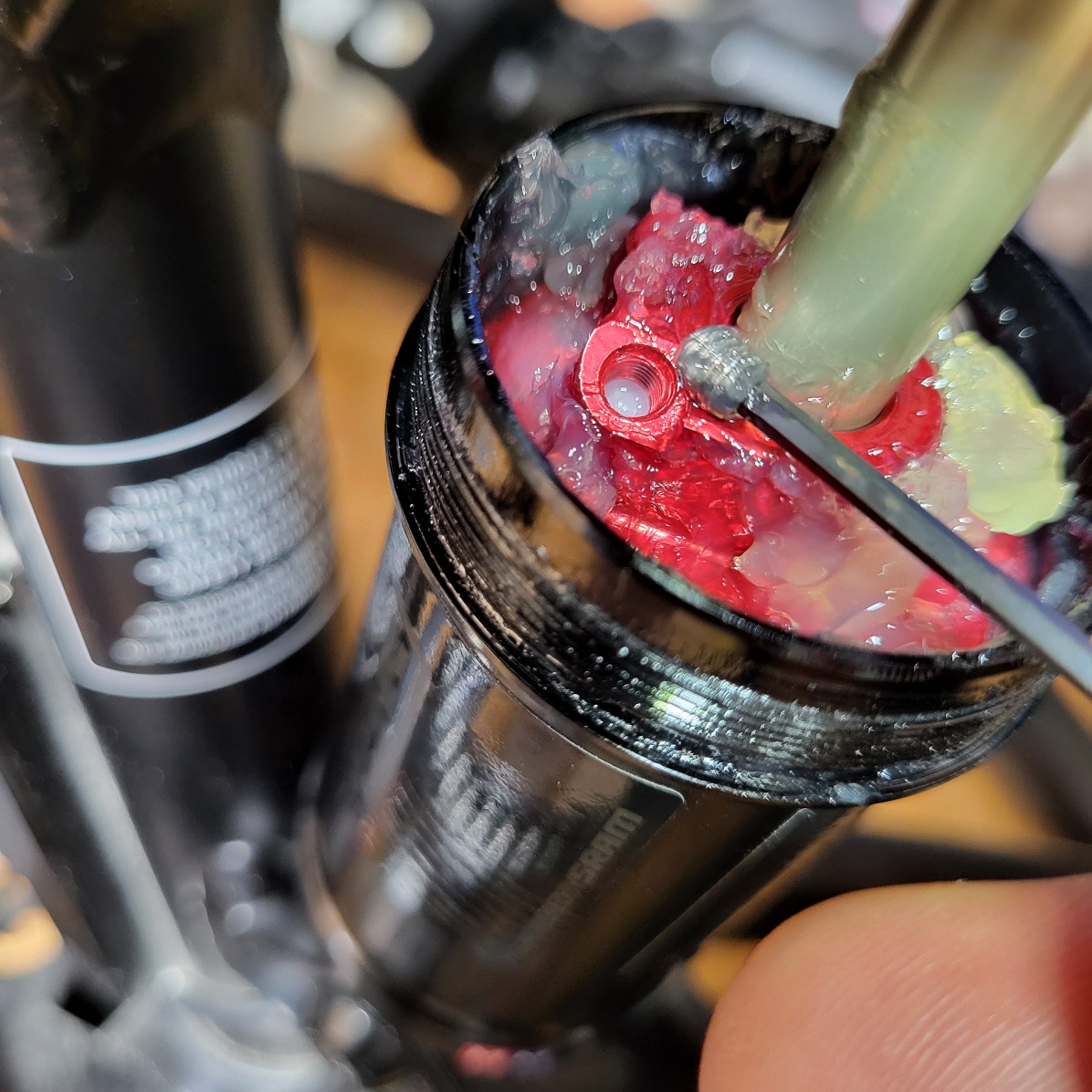

I decided to be reckless and try to service the shock on the bike.
It Worked 👌 👍 !!!
I used the bike like a vice and the air can cleared the bushing,..

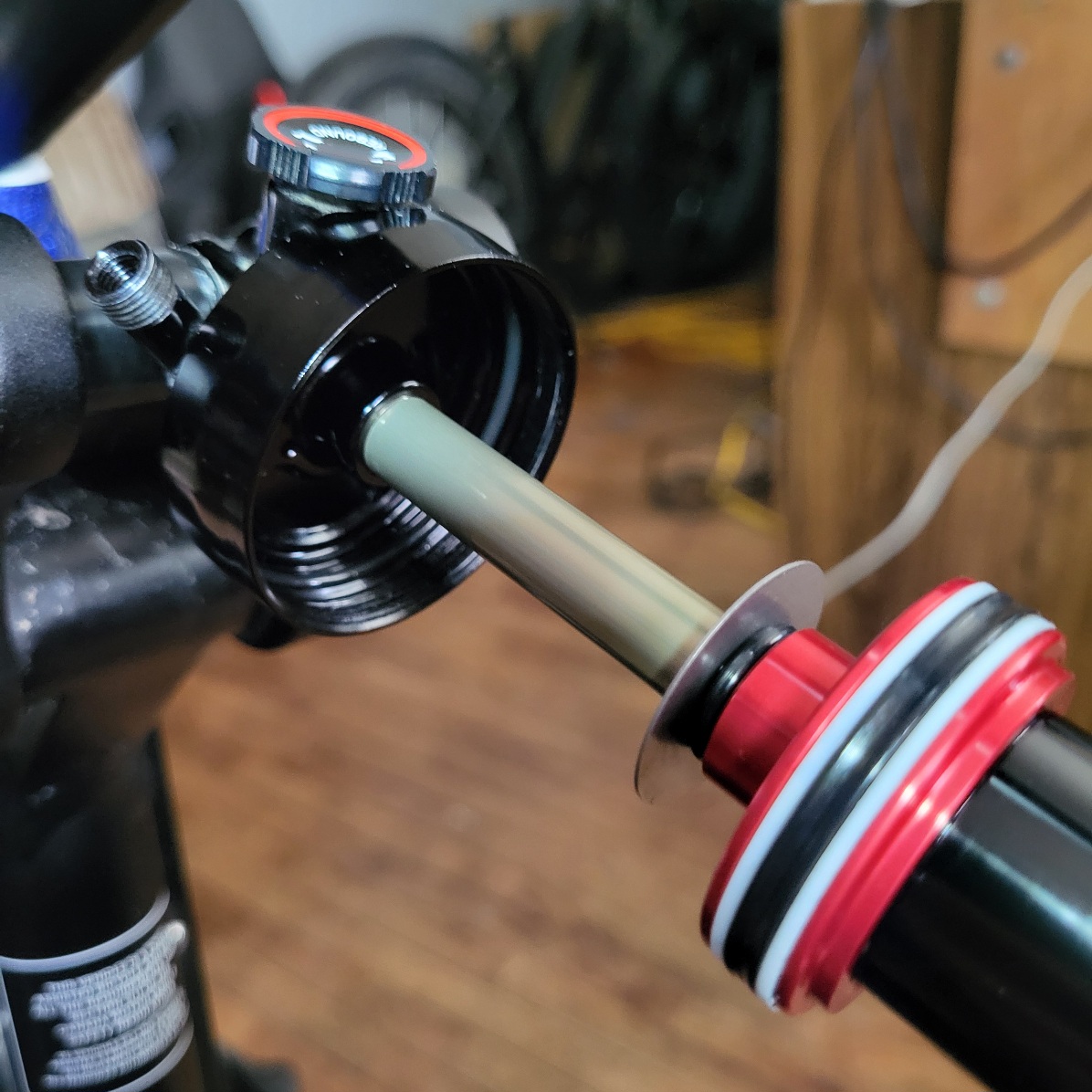

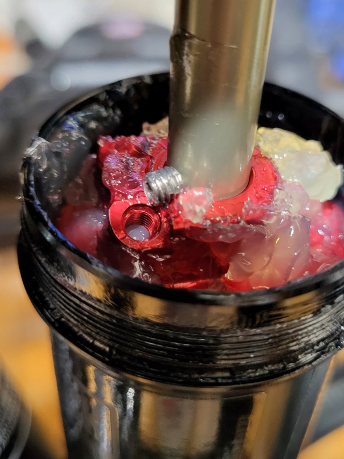

I just grabbed the air can with both hands and unscrewed it.

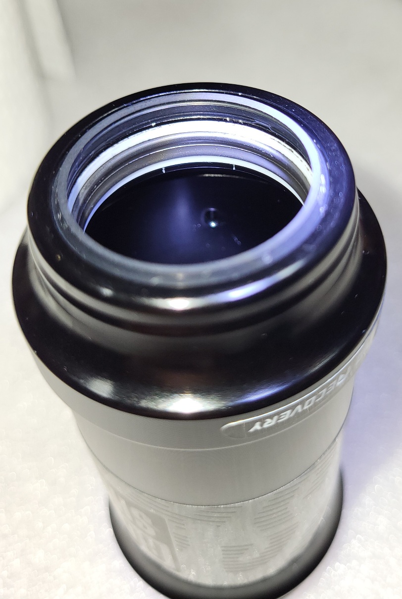

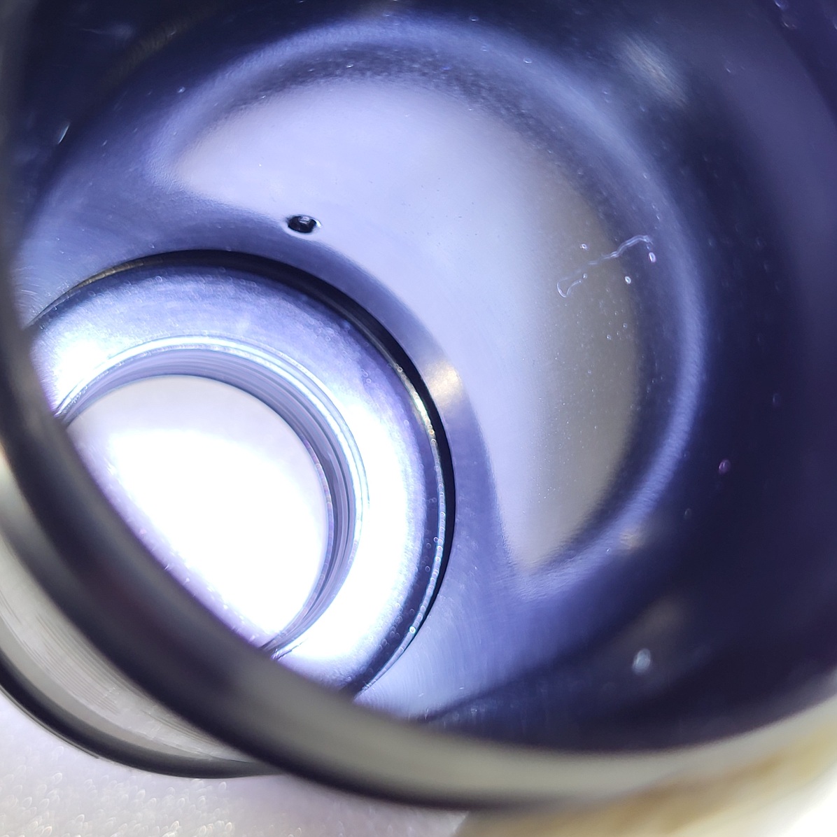

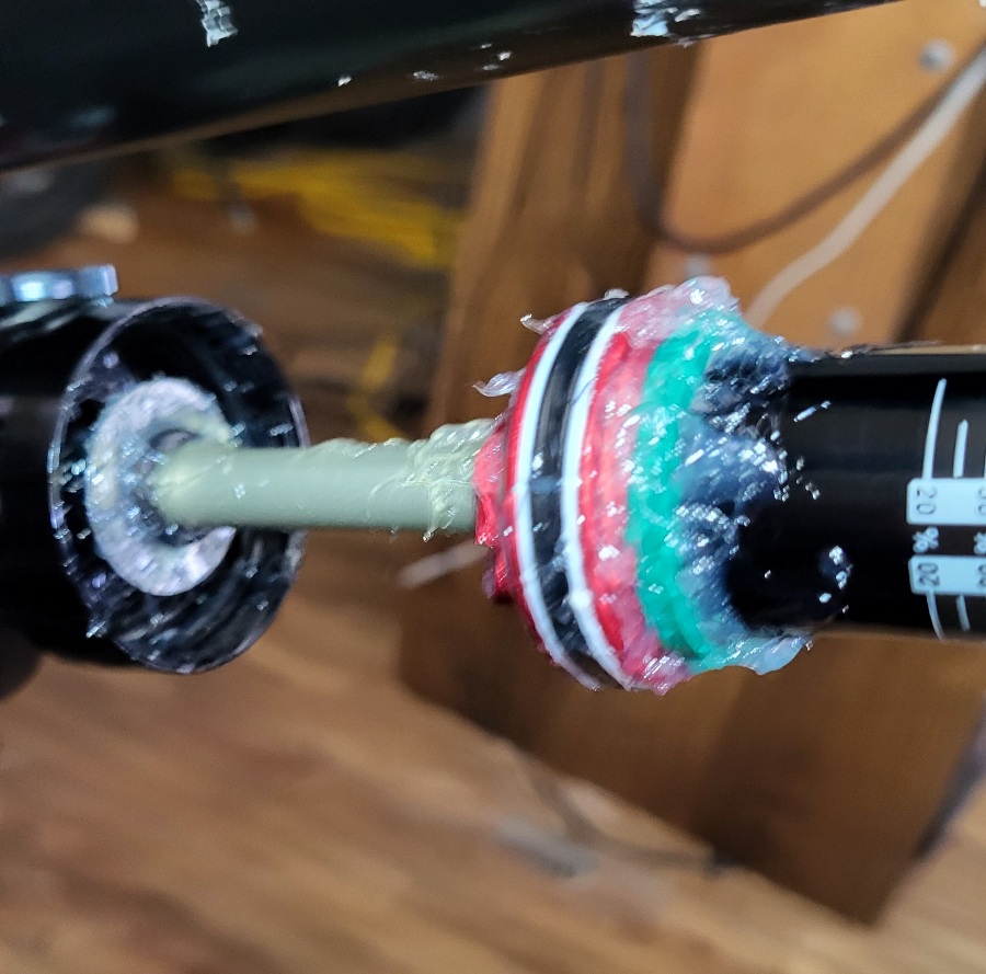

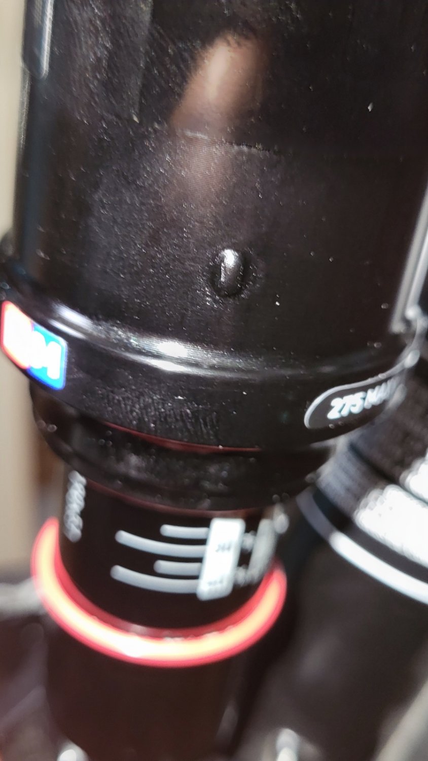

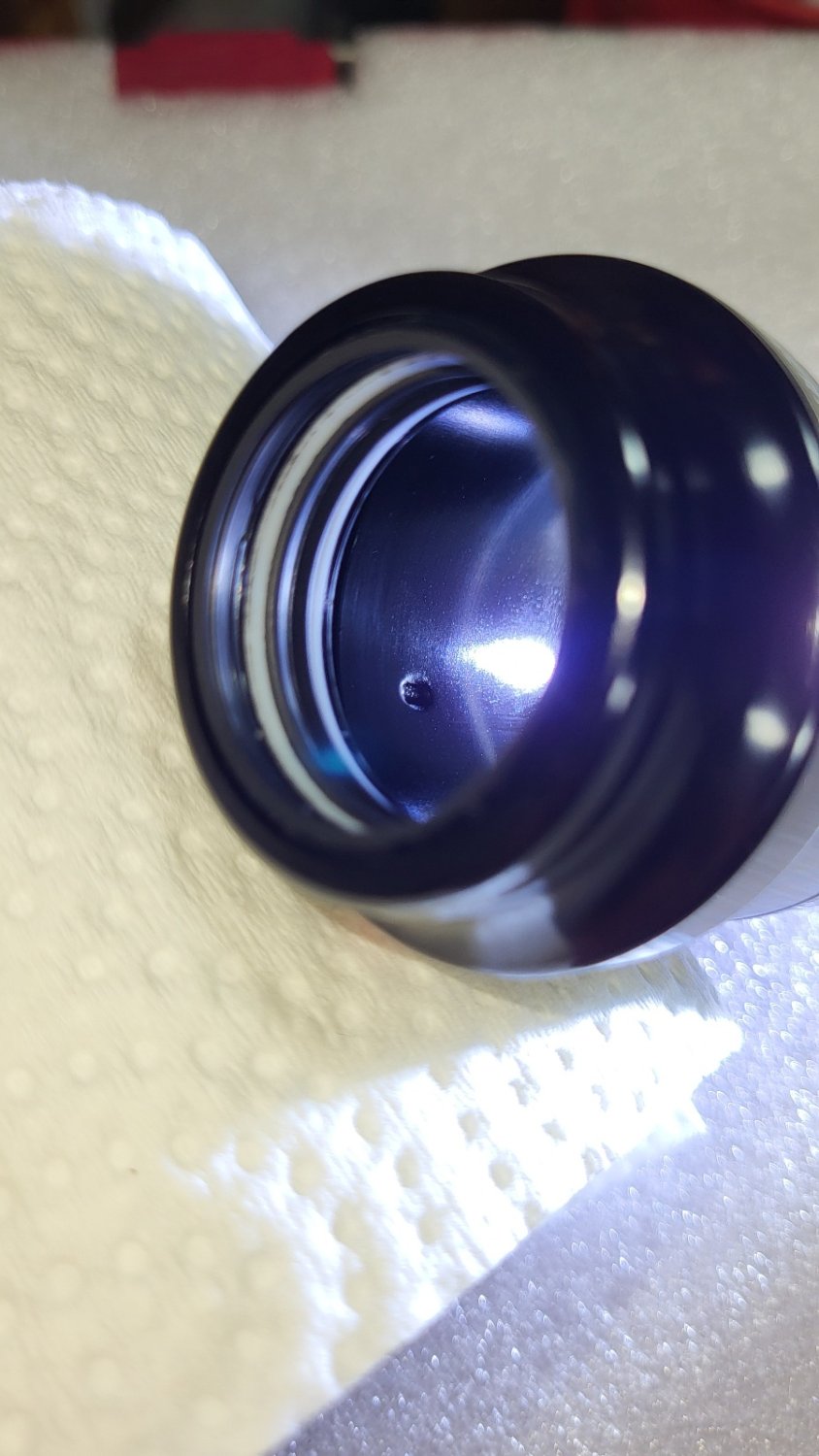

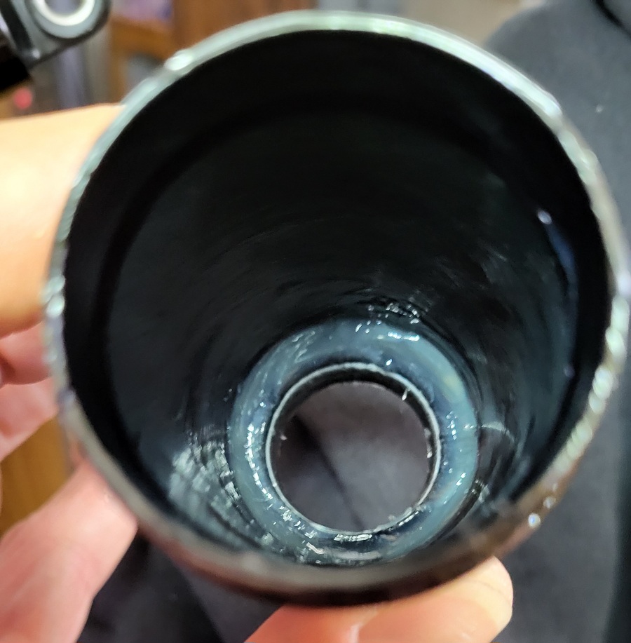

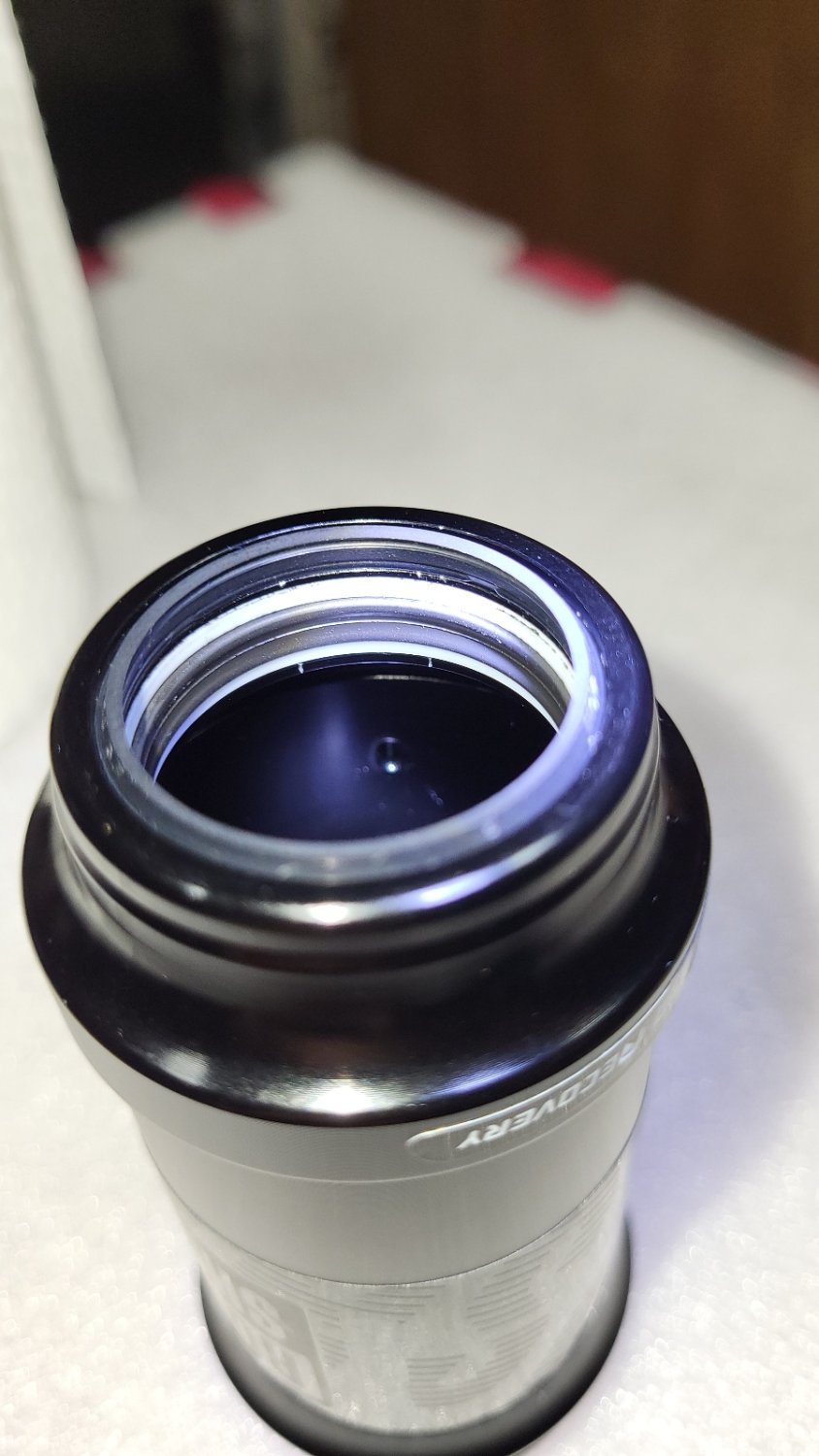

I noticed that the can has a dimple/dedent,..

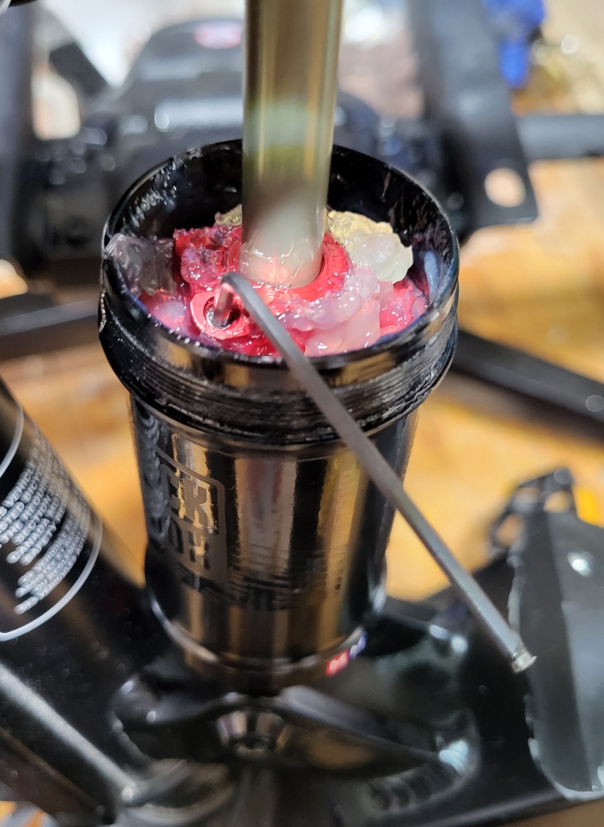

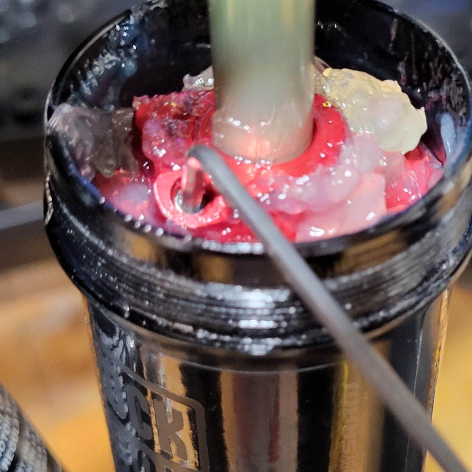

There was No Oil in the can, and this was the Only Grease !!!,..
I Greased Er Up Good !! 😁
I got it back together without too much fuss, but I couldn't push the can back on, so I installed the shock, then compressed it by pushing down on the frame so I could reach the threads when I pushed the can on.

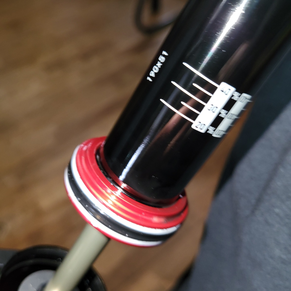

Everything is fine except for one minor detail,.. 🤔😁

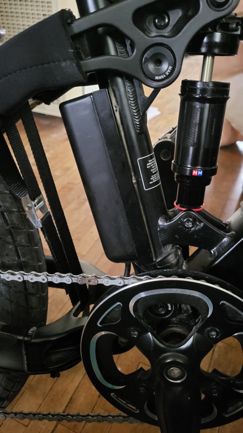

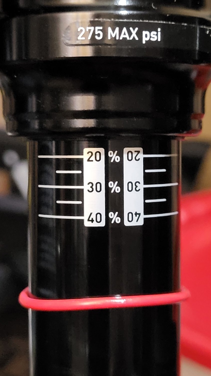

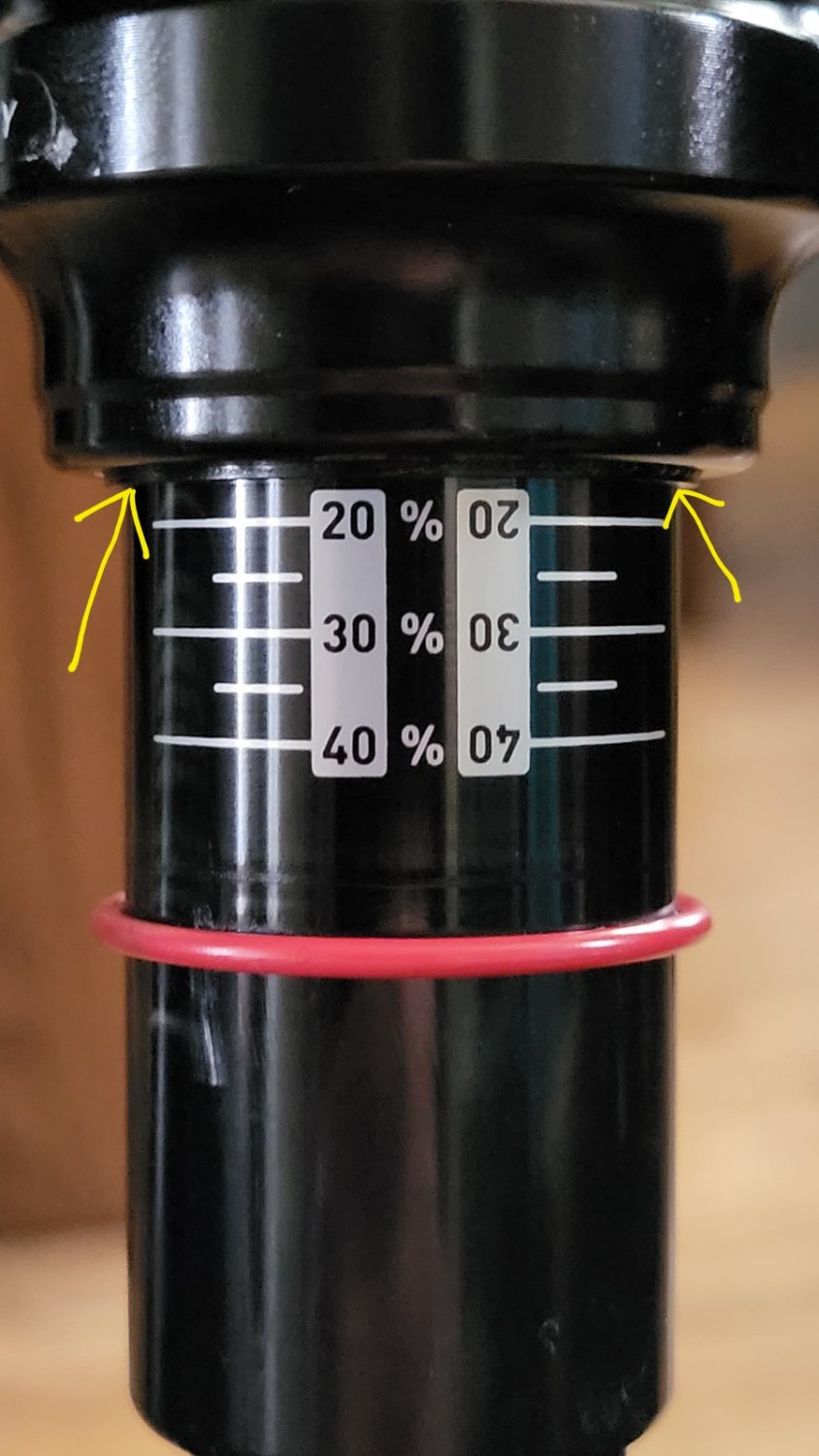

I'm sagging to about 16% with no load, and I can't get it apart further ??

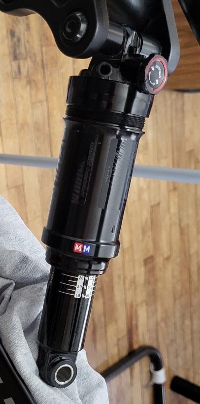

I took it out for a ride and everything felt OK.
It was kinda hard to tell, because I just installed a softer spring in my NCX seatpost, and I swapped back to my original spring seat with a gel seat cover on top. I've got a pretty cushy ride 😀
I did reach down and turn the damping up and down, and I could feel the difference.
I'm not sure about pedal clearance yet, but I assume they're closer to the ground?
I have yet to check my preload with the O-ring, to see where it's at.

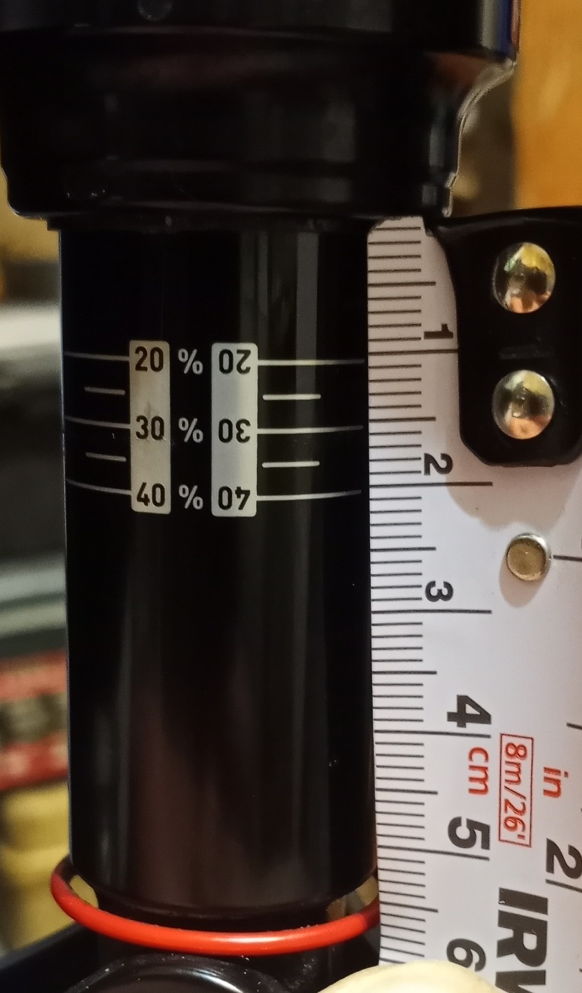

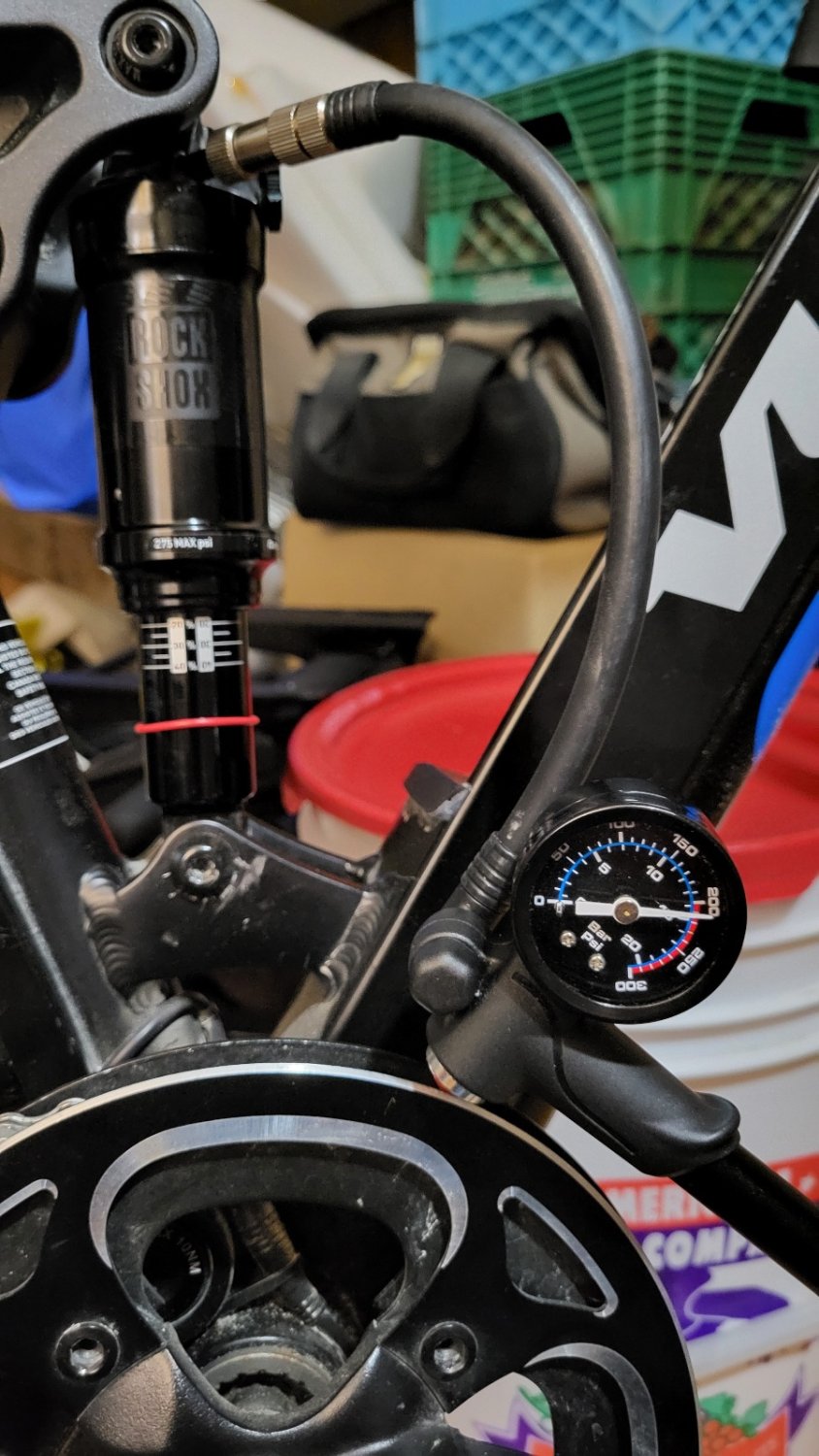

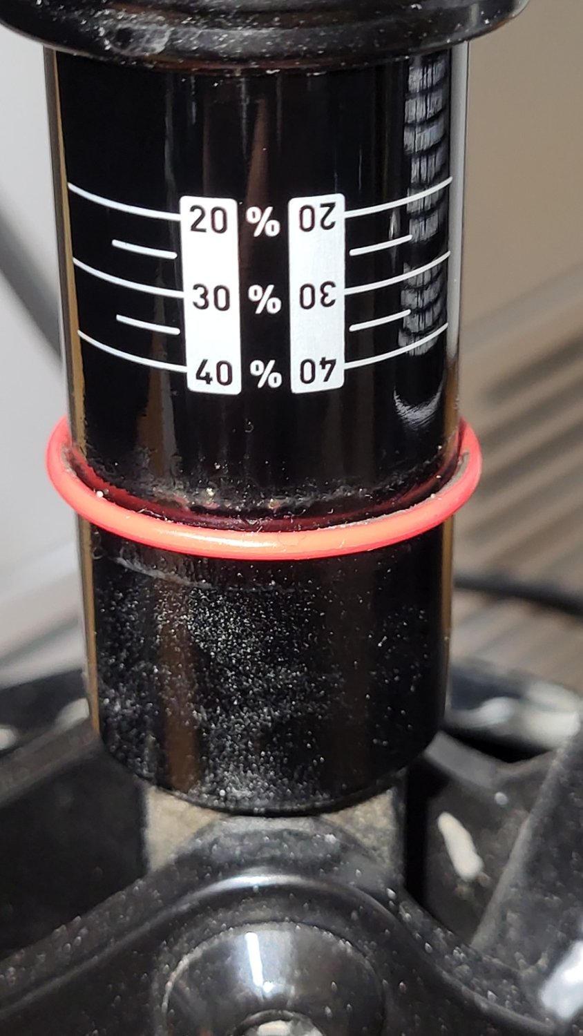

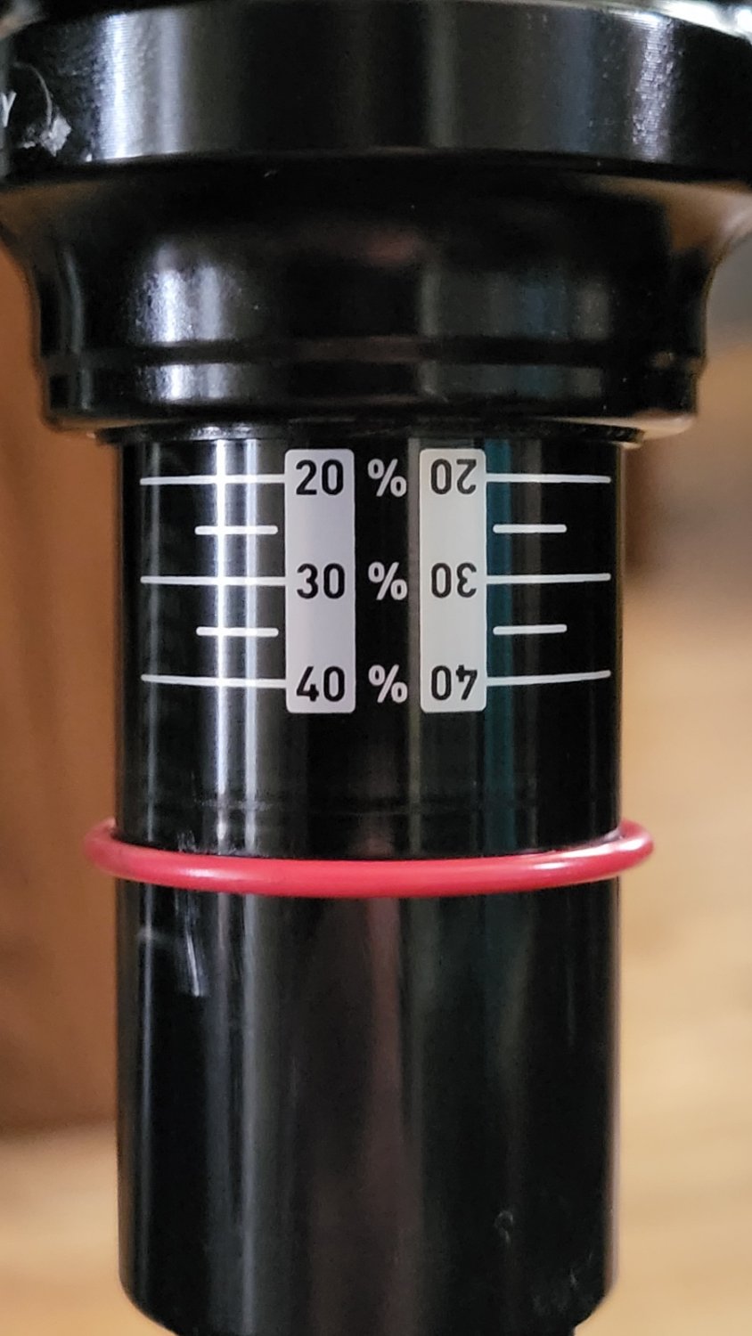

After the ride I pumped it up and got a little more clearance,..
This is the clearance that I used to have,..

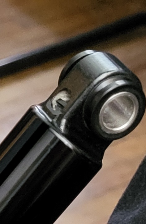

Well that's kinda the issue my shock had and after a few rides it progressively would extend less and less.
Though you were able to do it on the bike... I'm not sure what you saved as it was only one more easily removed bolt to remove. And I wouldn't want to put turning forces on the bushings and linkage when my vice is 2 feet away. But hey.. wtf do I know as I still haven't fixed mine. 🙃

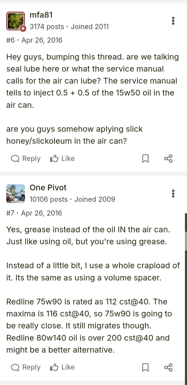

And then there was this,..
Instead of a little bit, I used a whole crap load too. 😀
I didn't buy fork oil. I didn't spend hundreds of hours researching and planning the intricate nuances of micro surgery on a Fricken shock absorber. I didn't get my degree in shock maintenance from a qualified Rock Shok Guru. I didn't buy hundreds of dollars worth of special tools.
I just took the damn thing apart. 😃
I did have twisting force in mind, when I grabbed the can With My Hands, and twisted it.
If I'm actually going to break the bushings or any parts connected to it by simply twisting the can with my bare 👐's, Then I'd rather snap the damn thing off the bike.
If I'm strong enough to break my e-bike with my bare hands, then my ebike isn't strong enough for me.

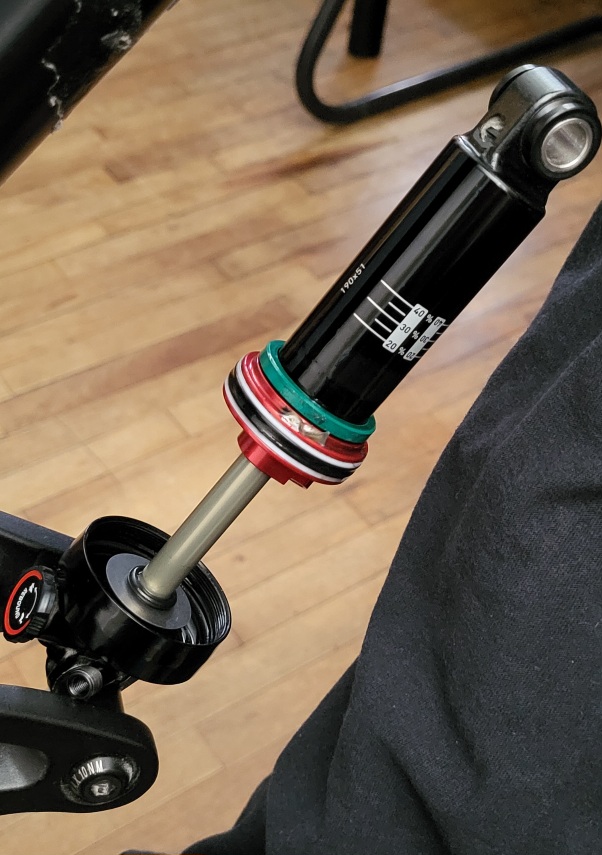

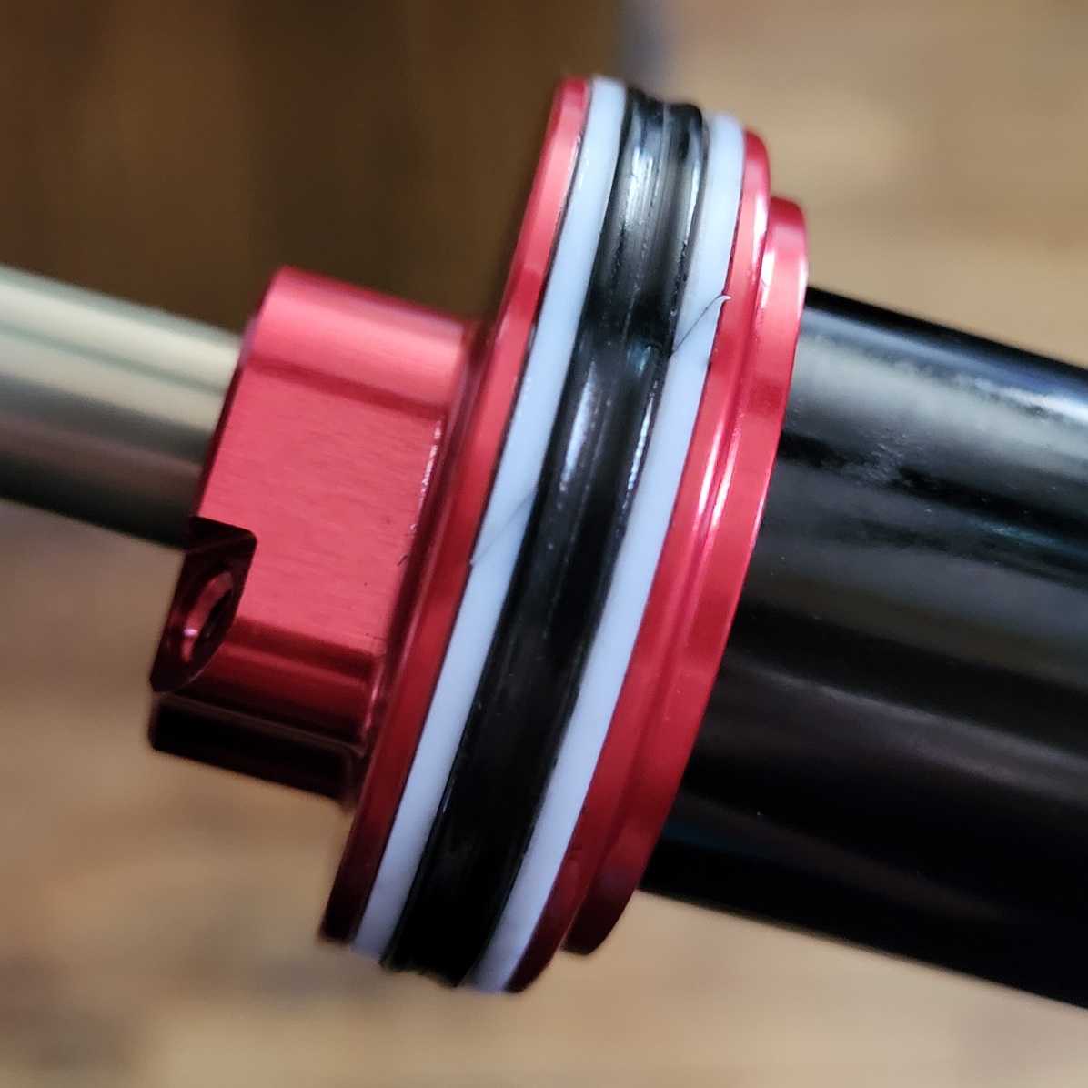

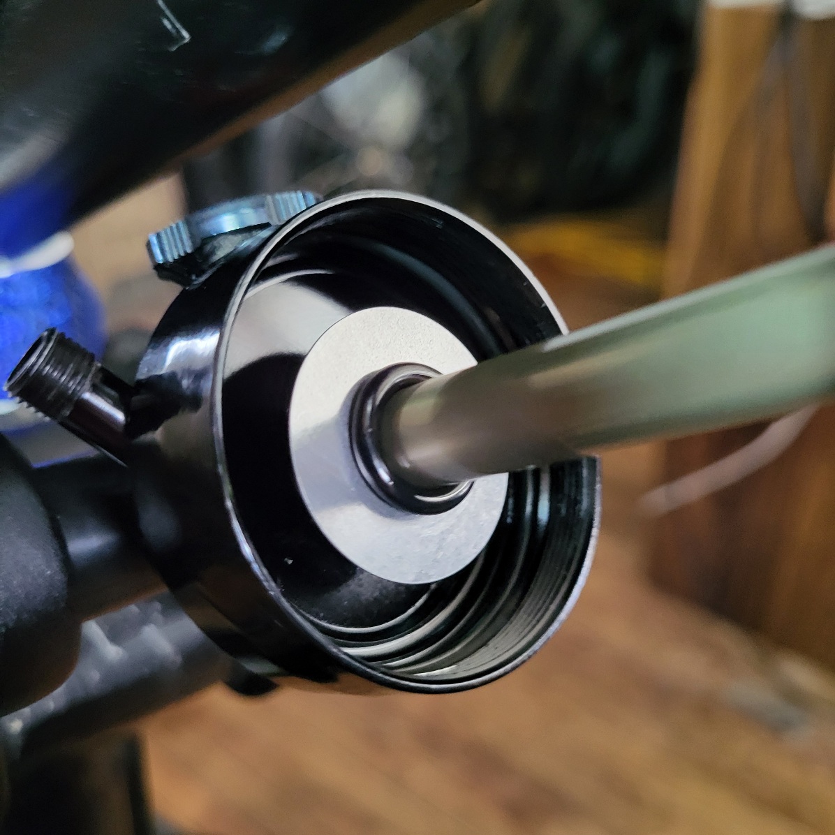

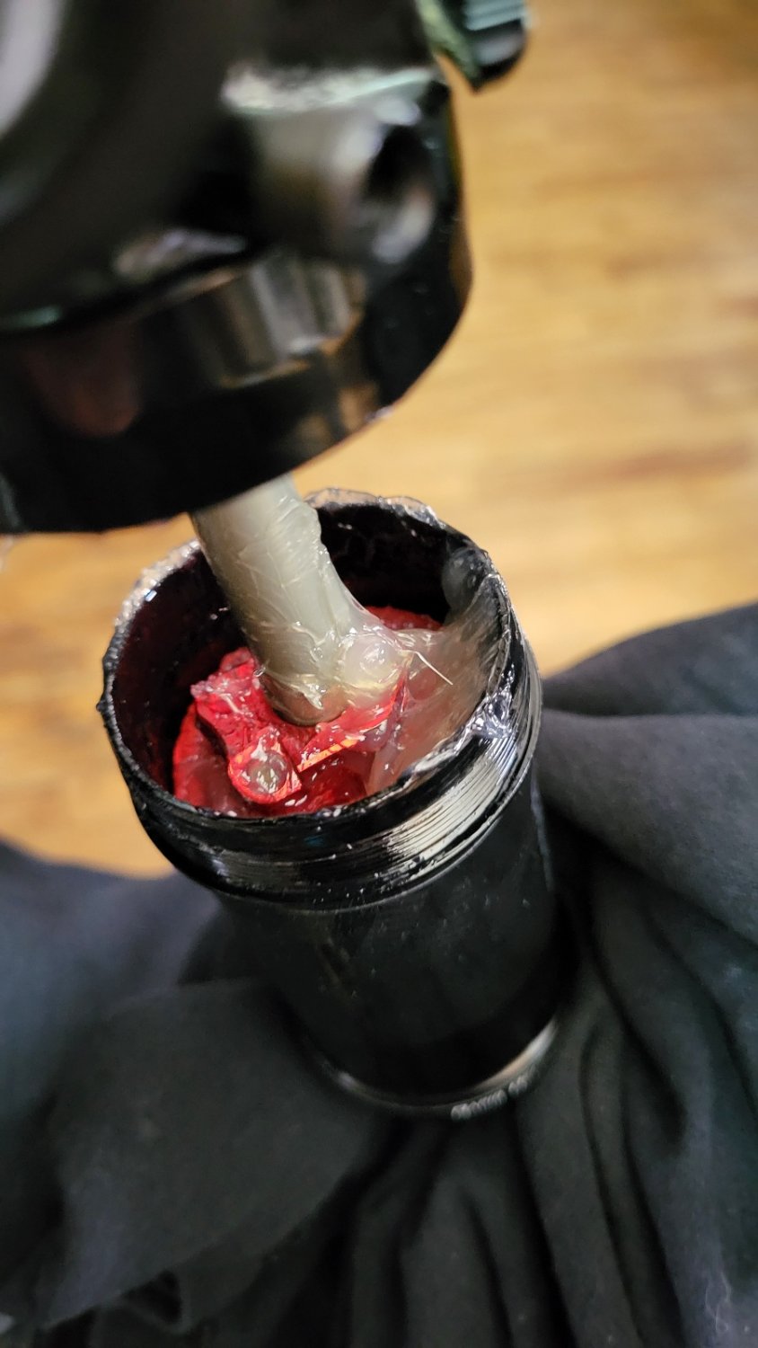

I noticed this about the shock,..
This is where the can was after I unscrewed it,..
It was fully unthreated but it was sitting at about 15%
This is where the can sits now,..
When I push the can up towards the threads to screw it together, I can start lifting the bike off the ground, and this is all I can get,..
When the plunger enters the can, it starts compressing the air, so instead of sliding on, the inner stanchion starts compressing.
I think that I need to find a way to let the pressure out of the can so I can slide it on ??

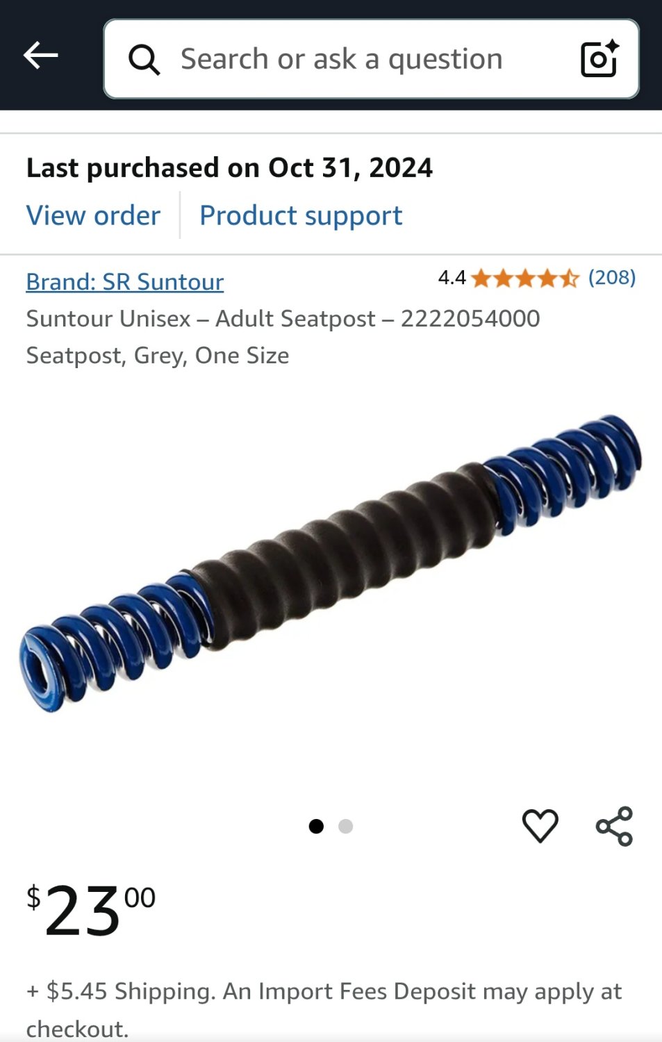

And yeah... The stock spring in the Suntour seat post is way too stiff... no matter what they describe as the weight range for the S - M - F versions
I had the stock spring loosened as far as it would go without hearing it clunk, and it was still too stiff.
I had to crank the snott outta the blue one to not squash it. 😃
PS,.. It's not a blue spring with a black sleeve.
It's a regular black spring with a blue sleeve. 😄
Well I didn't think that you would break anything right off.. But you can easily deform when you apply pressure in directions it's not meant to move in.
That'll cause premature wear.
Then add working at the counter height of a bench vice is just easier in general.. But it's done so c'est la vie.
I may try the 50 hour maintenance kit prior to a full rebuild just because it's only 20 minutes and no special tools.

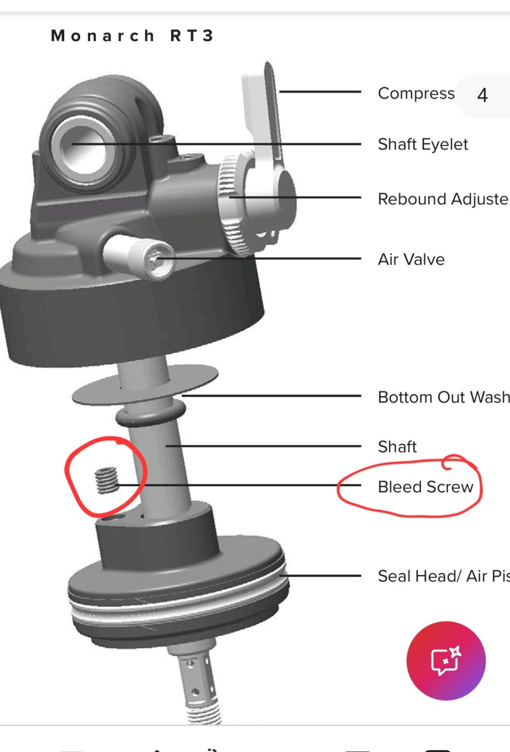

DUDE !!!
Look What I Found,..

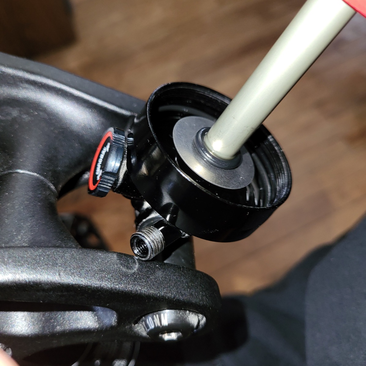

I gotta open the bleeder screw to get the damn can on without pressurizing it.
EDIT: Didn't work.
I still can't push the can on without Huge back pressure.

DUDE !!!
That's an air bleed for trapped air in the oil of the piston... I don't believe it releases any of the pressure which is 250 - 500psi but trapped below the oil by a separator. I think that's called the IFP.

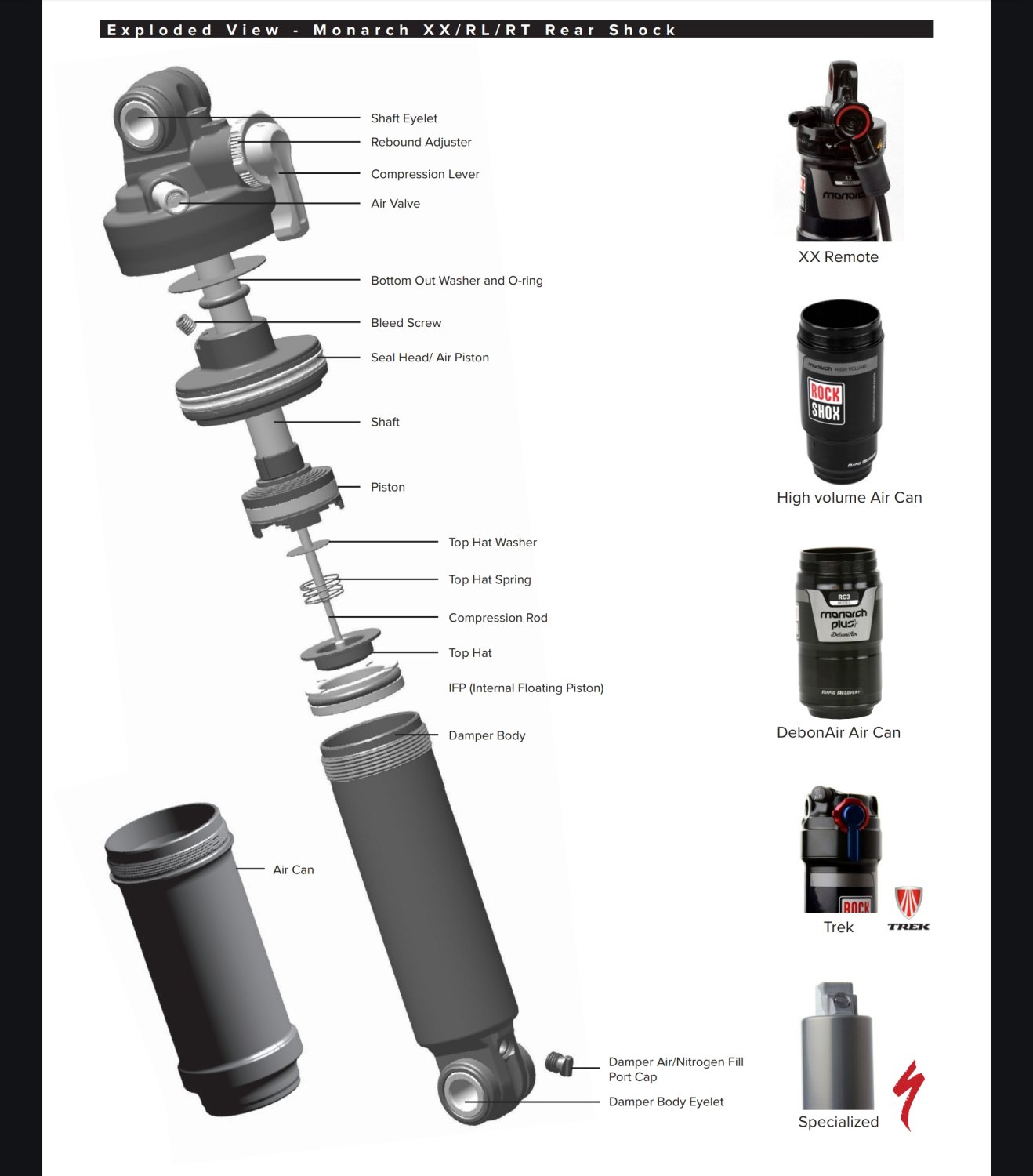

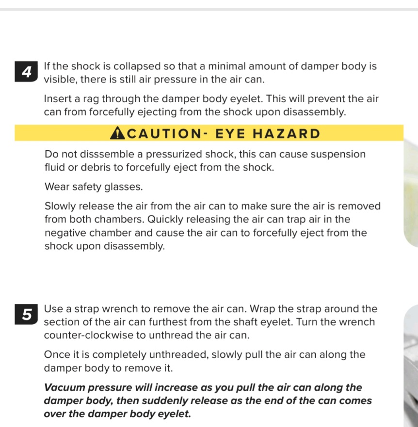

I found some more information,..
When I removed the can I did feel the suction and it popped when it came off.
Now when I try to install the can, I get back pressure as I try to push it on instead of suction to pull it into place.
The only way I could thread it on was to compress the inner damper, but then I lost all kinds of travel.
I need to get the can seated like it was originally with the can threads easily threadable with no compression pressure, like this,..
These two seals pressurize the can to Suck it closed,..
I'm seriously thinking of sticking a blunt nosed needle or something under the can seal to let the air out ??
How do get the damn can on without all that back pressure ??!!@
Oh FFS,.. LOL
I didn't remove the "IFP Valve Cap" and let the air out.
I thought that was the 500 PSI valve for the inner core.
I saw that and didn't think that I should mess with it.
The videos I watched it gets pressurized before the air can is threaded on. So you shouldn't need to let air out.
Becareful if you let the air out... I believe that you need an adapter to put air back in
Make sure the red dial... Rebound is set to fast when assembling
Just found this video... Makes me think the 50hr simple service will fix mine. Air must be bypassing to the Negative side 🤔
