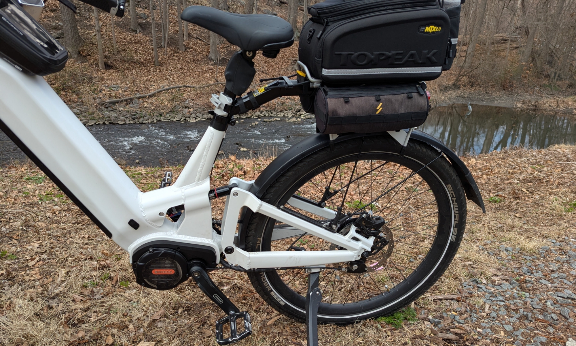

So I got lucky in that rack just clears the suspension seat in the front and the fender in the rear when the suspension swings.. so I'm liking it and the ride better.
Removing the stock rack I lost my fender attachment points so I made up some brackets out of aluminum angle and used the rack mount points to attach them. Got lucky again and everything fits well.
I got the pannier side brackets for the rack but I'll never use panniers and didn't like the hang_low look so I lopped them short just to handle my little side tool bags.

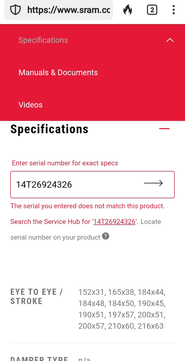

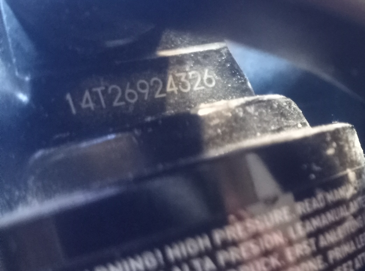

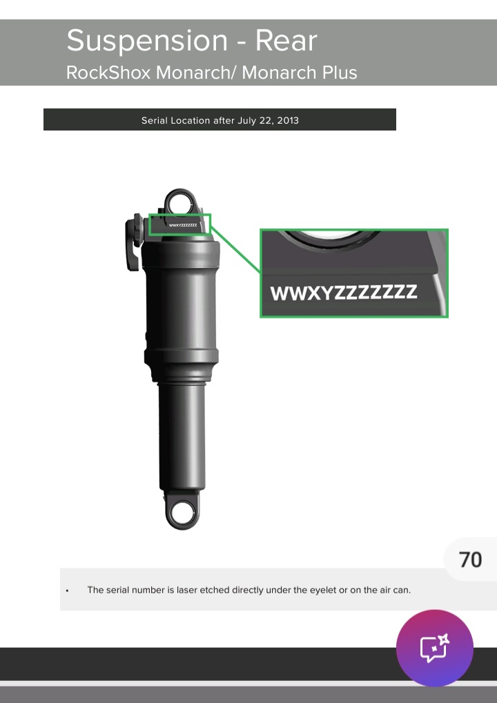

ps... If you enter your serial number on the RockShox service website... It'll give you some specifics on your shock.

I don't know if mine is a solo air or debonair but curious...
I think I figured that out ??,..
I watched the video and there is an outer sleeve that unthreads with the air can underneath that also unthreads.
Then I watched a Syd video where she took a Fox Shock apart, and only had to unscrew the air can to get the shock apart.
So, I'm thinking the Solo Air doesn't have the outer Shell that I guess works as a second air chamber?

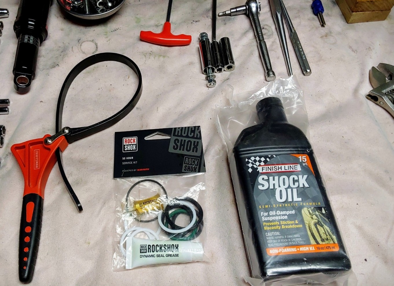

Parts in...
... now in search of ambition.
I noticed that you bought what looks like standard issue 15 weight fork oil?
I assume that I don't need to buy anything "Special"?
The bottle says "For Oil Damped Suspension", but it looks like our Monarch shock is "Air Damped" ?

As for the oil I'm ASSuming suspension oil is suspension oil and selected by weight. When you read the description of the RockShox oil it states for all suspensions shocks and forks... And same goes for the Finish Line brand
The oil going in the Monarch is 0.5ml to 1ml so it's not dampening but just some additional lubrication

Now you have me second guessing the oil... The manual says to use Maxima® Maxum4 Extra 15w 50... which is synthetic motor oil?!?!
I guess for now I can use the oil sample that's in the O_ring kit to be safe.

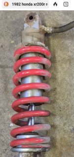

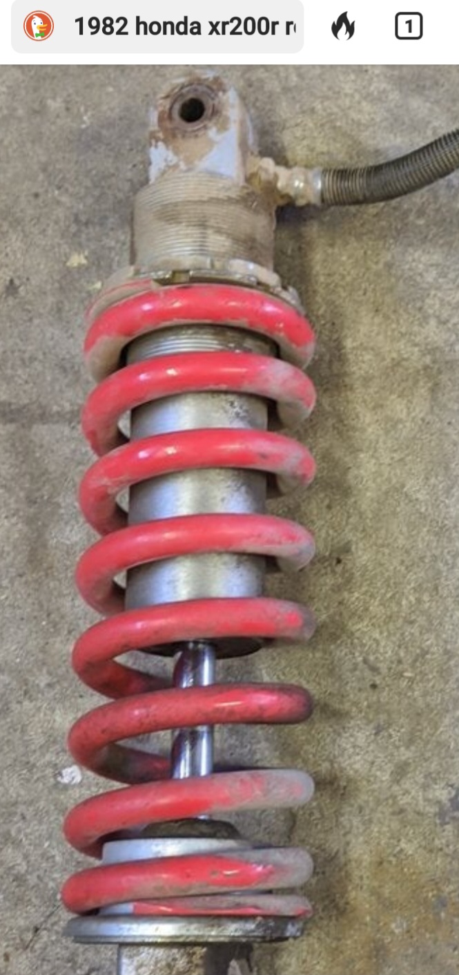

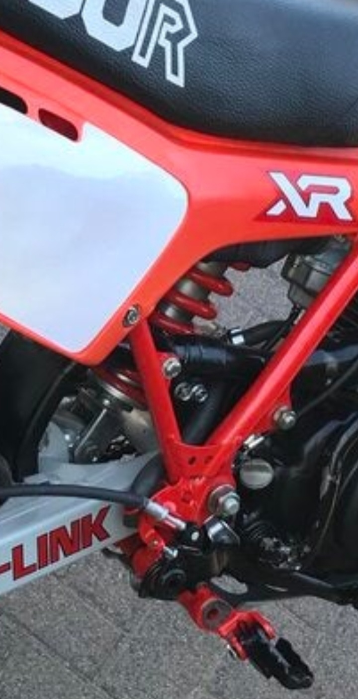

On a kinda related tangent,..
My Honda dirt bike from 1982 required me to remove the rear shock and clamp it in a vice to adjust the preload.
I managed to just reach in, grab the coil and rotate it.
I loosened the big lock ring at the top of the coil and the coil would rotate with some difficulty but would slip on the threaded coil mount, so I cleaned the threads on the shock and rubbed candle wax on the threads (dirt would stick to oil) and put a bit of glue between the coil and the cup, so the cup would rotate with coil.
Then I put wax on the other end of the coil so it would slip easier on that end where it's supposed to slip.
It was so easy to adjust my preload, that I could do it when I was out riding by just loosening the lock ring with the screwdriver that was in the provided tool kit.
Here we go,..
So it looks like Voltbike lied??
It's not a Debonair, it's a Solo Air?
So I should have the Exact Same Shock as you.
