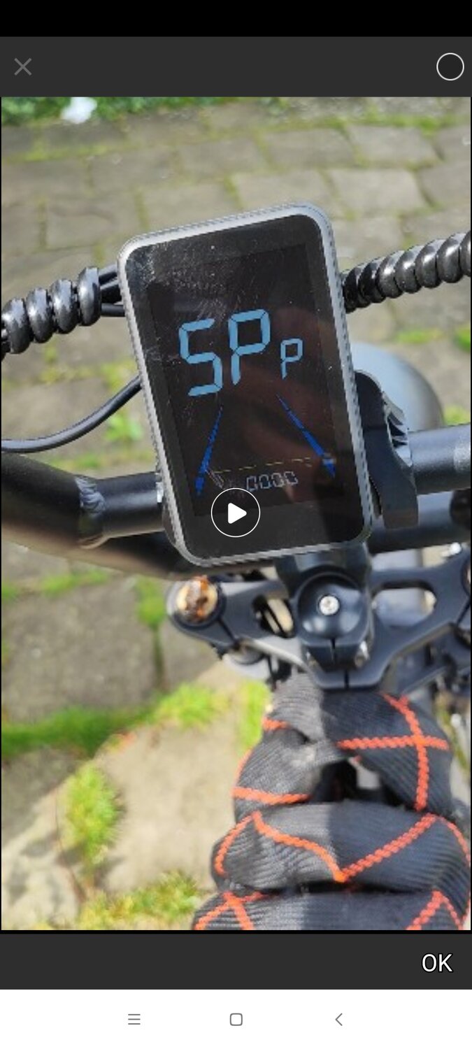

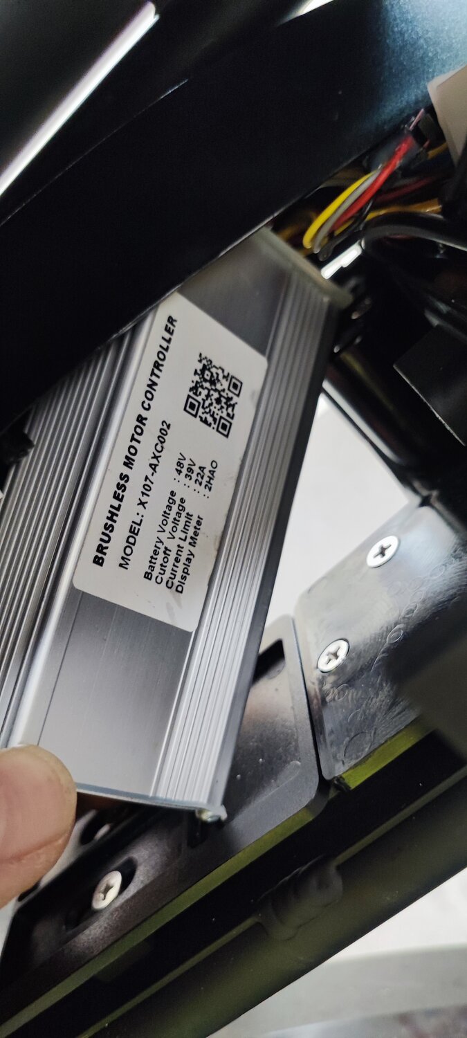

Hi hoping could help me I'm looking for a controller and display to change the pedal assist percentage just like you have,my bike is a 48v 250watt 17.5ah fat bike as seen in the pictures.also this my controller,is there such a kit for my bike please if you know or have an idea it would be great.
Also the display I have I have attached.
