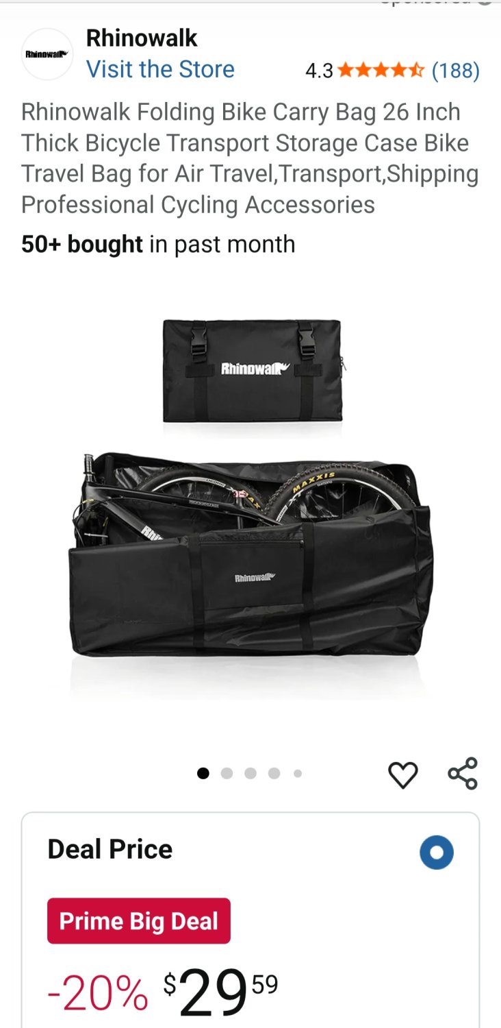

It would be so great if I could just purchase a bike carrier that encloses my bike (unfortunately my vehicle can’t accommodate it without major expensive modifications)

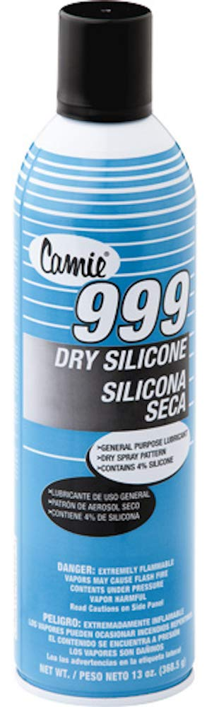

There have been interesting suggestions about spraying the bike & chain with dry silicone (which apparently dust can’t adhere to) And since I live in a dry environment, it might work.
Silicone will just dissolve with water and so it might make cleaning simpler?
I don’t know anyone who has used dry silicone instead of traditional lube but I do know that traditional lube doesn’t just dissolve with a rinse of water.
My favourite kind of cycling is in the great outdoors and so this is a unique problem that you don’t experience travelling on tarred roads
Well you can definitely give the dry silicone spray a try... It's easy enough and not expensive and @6zfshdb that suggested it does a lot of bike transport.

Or, get yourself a tarp, sew it up like a giant bag and put a draw string at one end or wherever. Still gonna get dusty when you take it off, and the chain thing is a lost cause.
