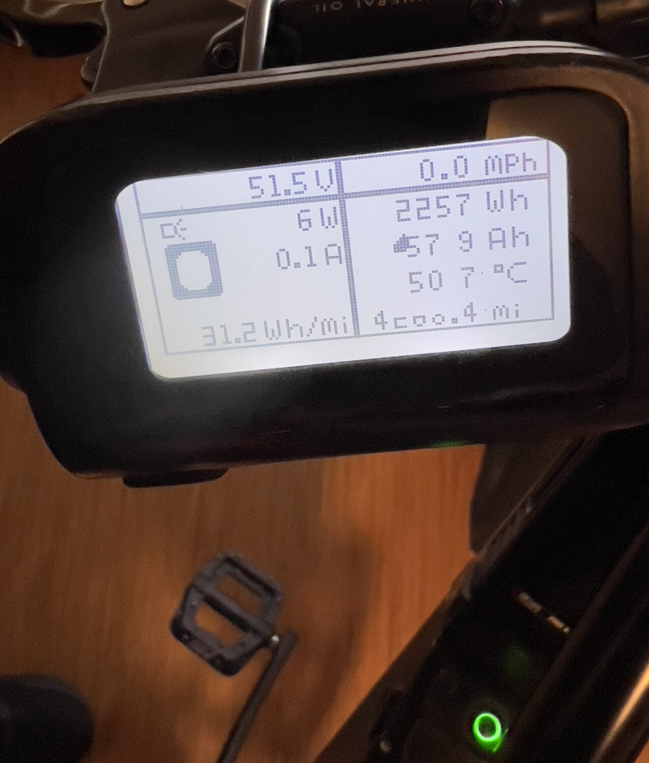

Here is an image of the glitchy display I was mentioning. It’s around this point it starts having issues. It’ll only work if the bike is set the NDW 1, pedal assist 0, disconnect the torque sensor, enable the torque sensor, and I just use the throttle.
