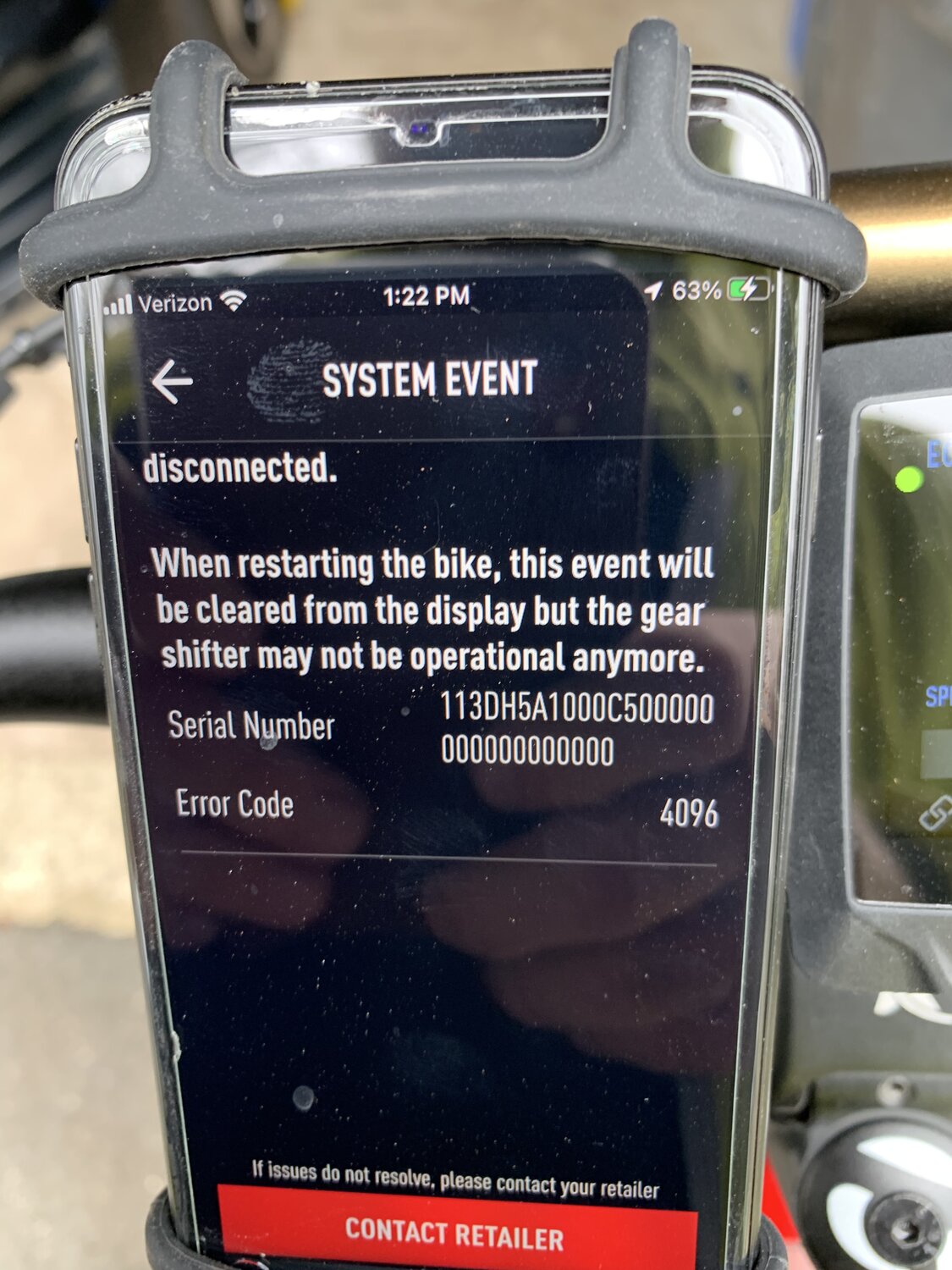

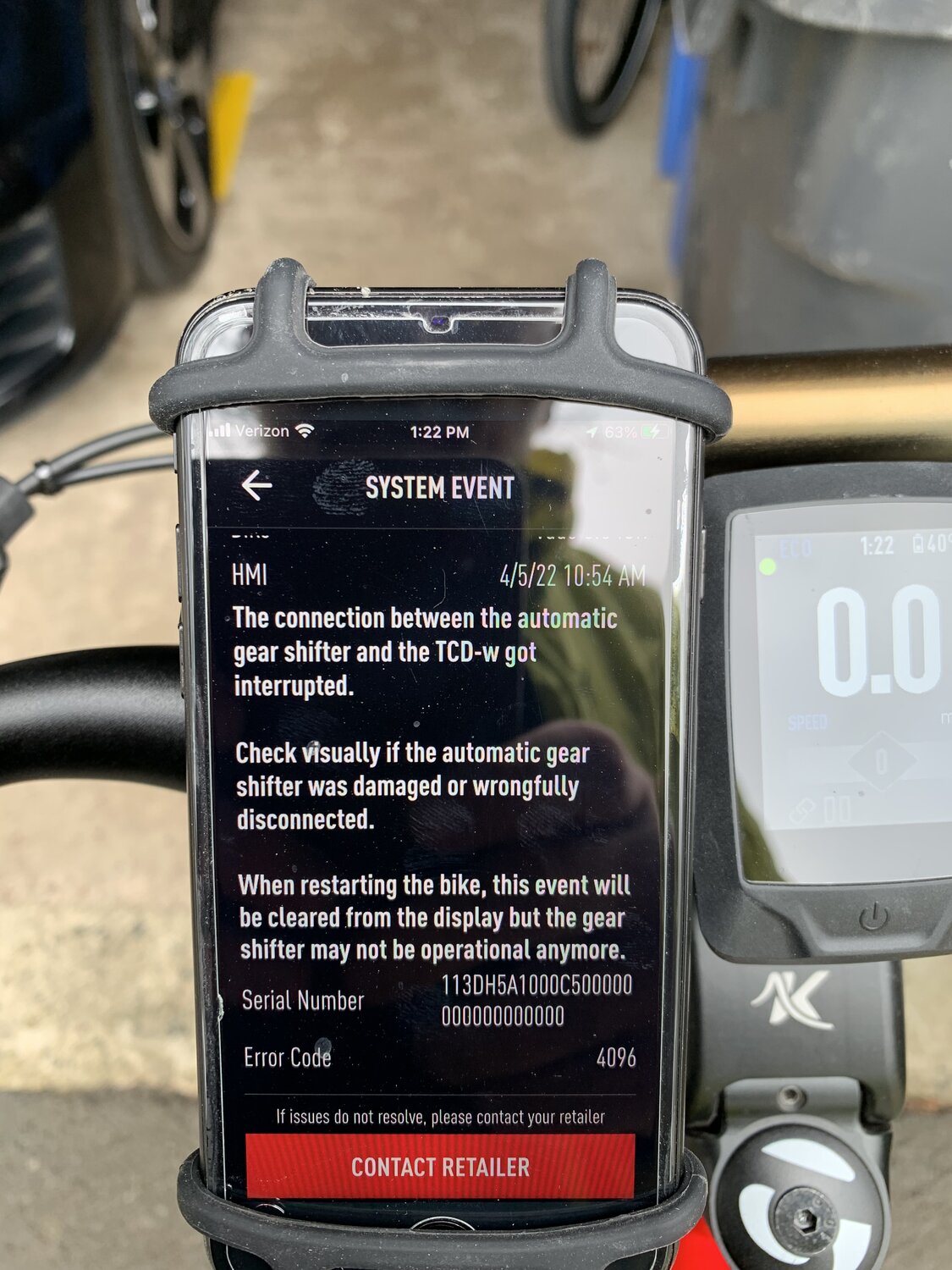

Dropped off at the local LBS, they inform me that the firmware is in need of an update as well as their "master program" is a new version, and there are multiple updates that need to be applied.

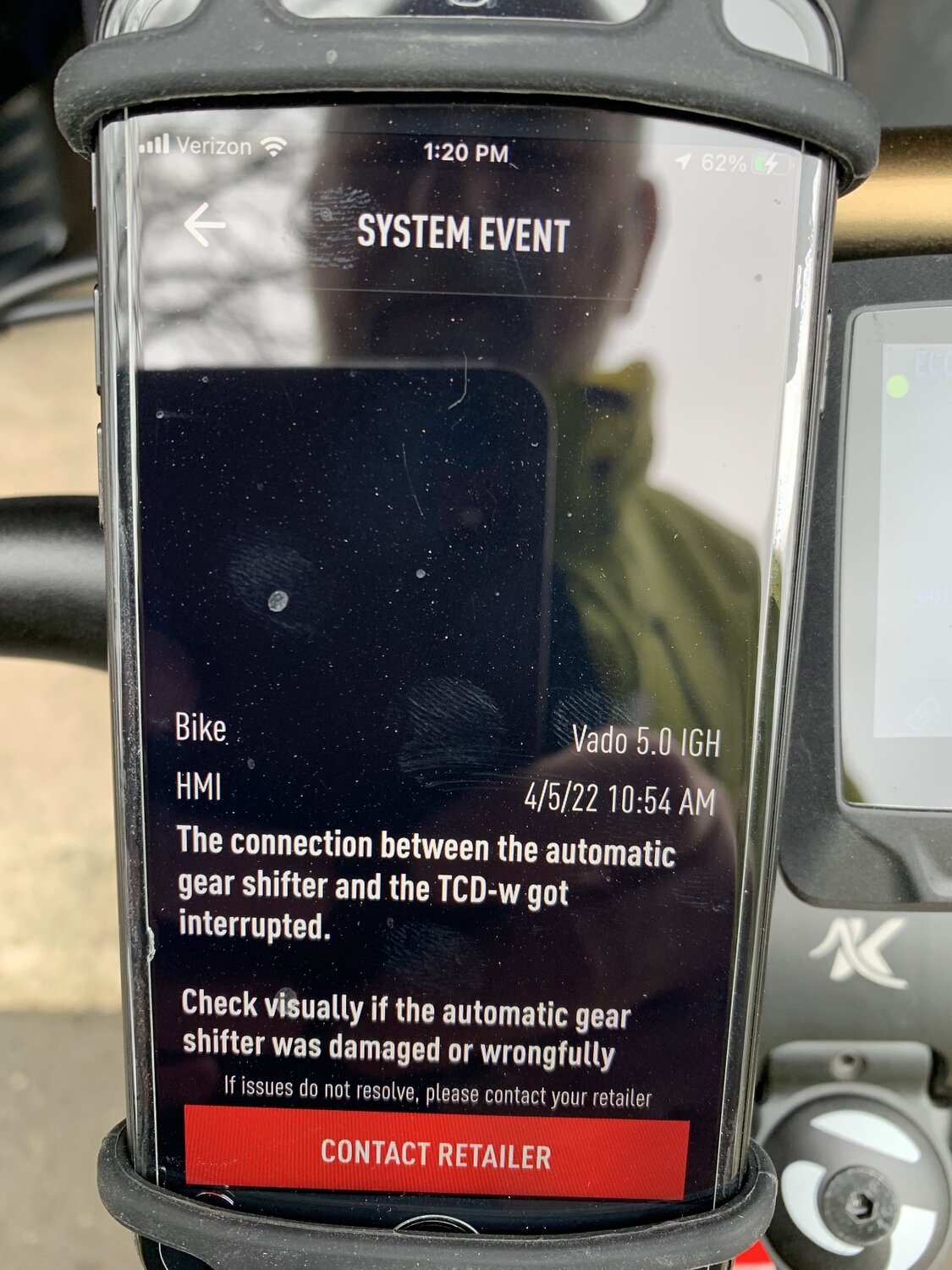

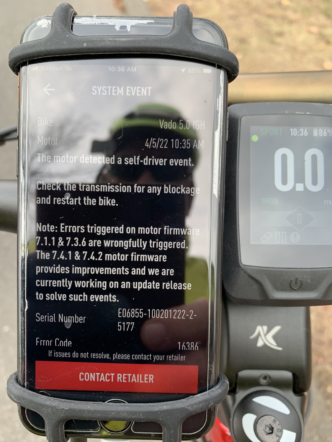

During my 38 mile ride yesterday, at about 1/2 way I get a 'motor error' and lost power. I took screenshots of the error messages and turned off the bike, upon restart, all is well.
Odd occurrences.
Still happy, I do understand that as an early adopter there may be growing pains, just as long as it is not too frequent :(
After all, if it does become frequent, I should be a beta tester and be given a bike for free to test, no?
Other than the "over the air" updates, this is something they say needs to be done at their onsite location.
With the new "B2B", can I ask them to come to me?
---so, the major concern is: "The motor detected a self-driver event"
Check the transmission for any blockage and restart the bike.
NOTE: Errors trigged on motor firmware 7.1.1 & 7.3.6 motor firmware provide improvements and we are currently working on an update release to solve such events. Error code 16386

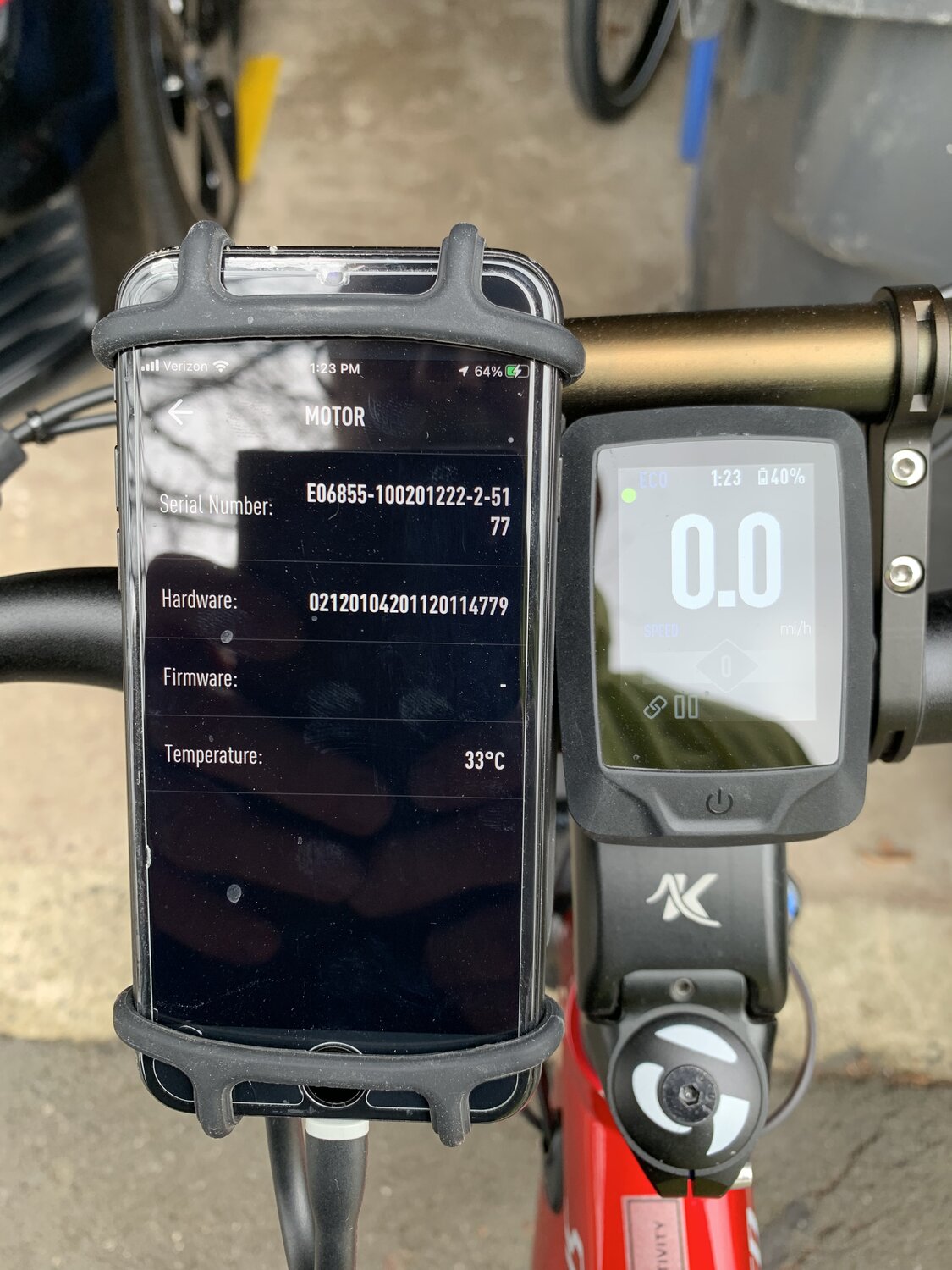

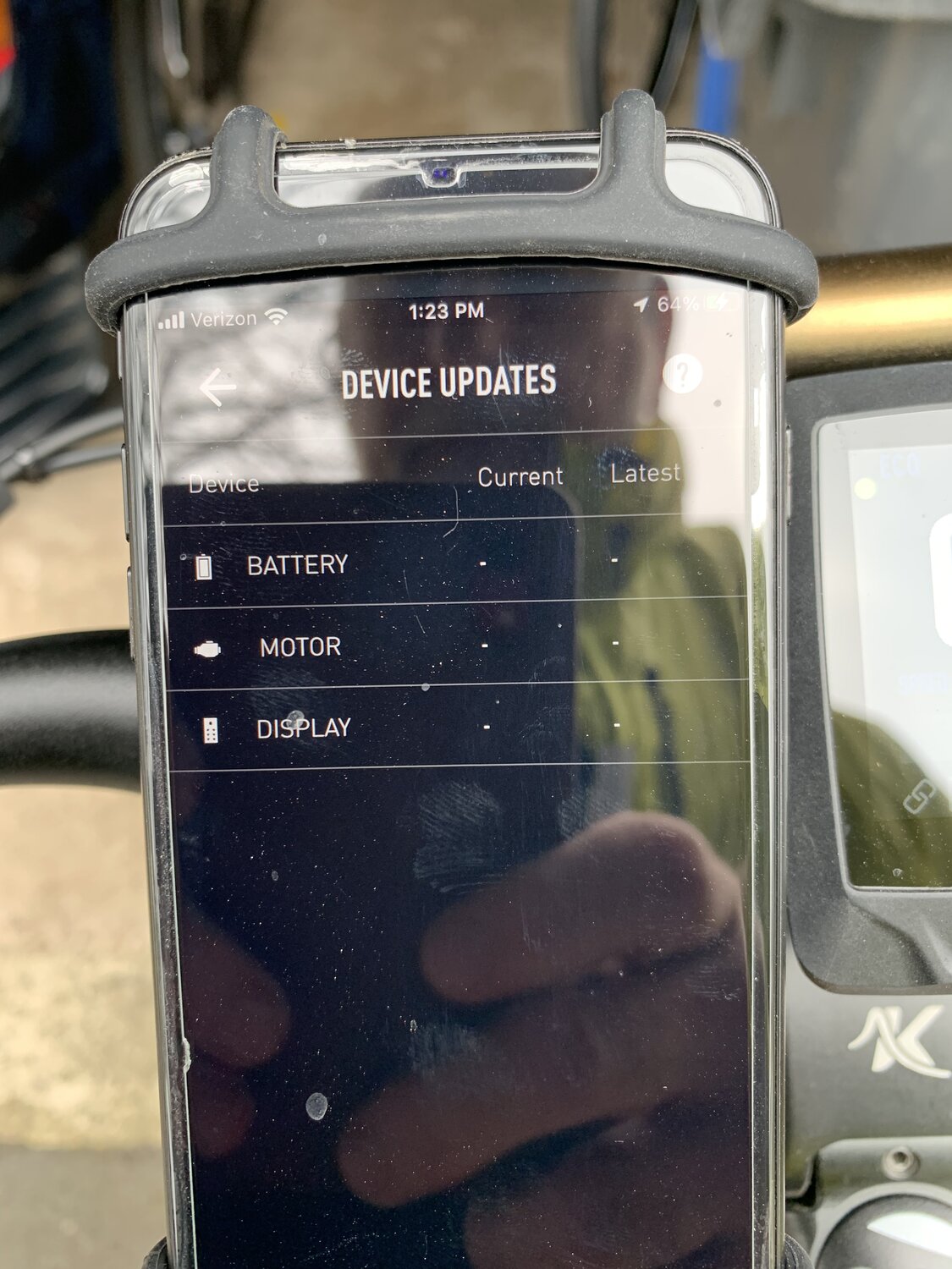

My concern is the automated upload of the report (diagnostic) via the Mission Control app that goes to Specialized. Whether the LBS gets it or not is unknown. Other than me providing screenshots of the incidents as they occurred, it's an unknown. I asked the tech if he wanted copies of the errors, he made it seem like he didn't care (did not want them), and just relied on the results of whatever the diagnostic software provided.
Again, I'll need to dig deeper tomorrow to validate the versions of software/firmware (as the one screen showed nothing as referenced in my original post), so I have no idea what is the current, new, good, replacement firmware or if anything at all was done.

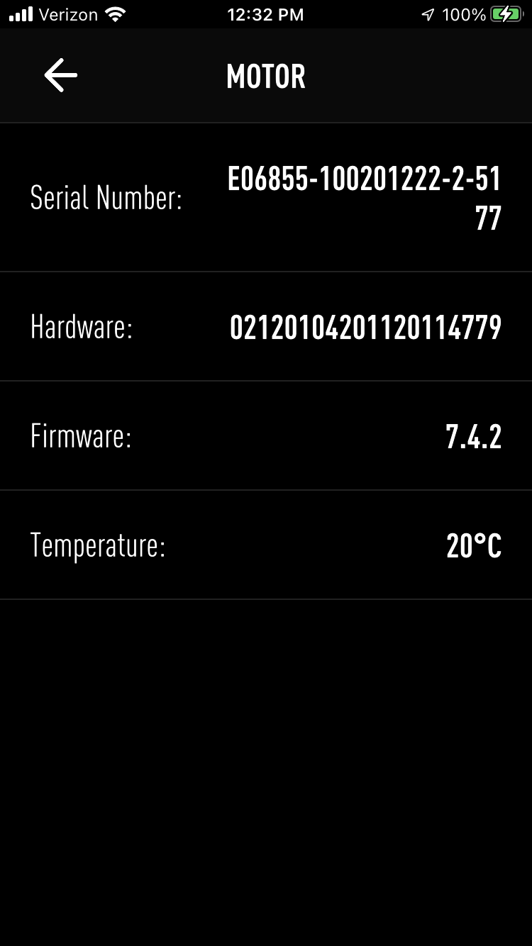

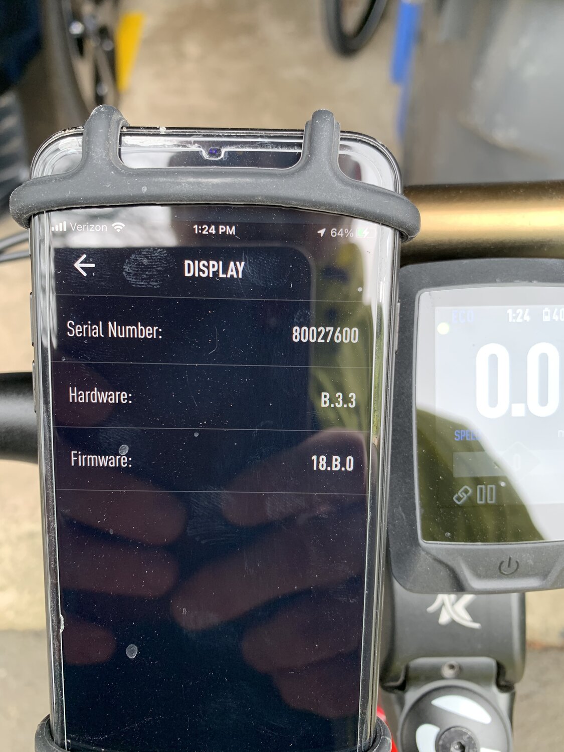

Had a good 11-mile ride today with no issues.

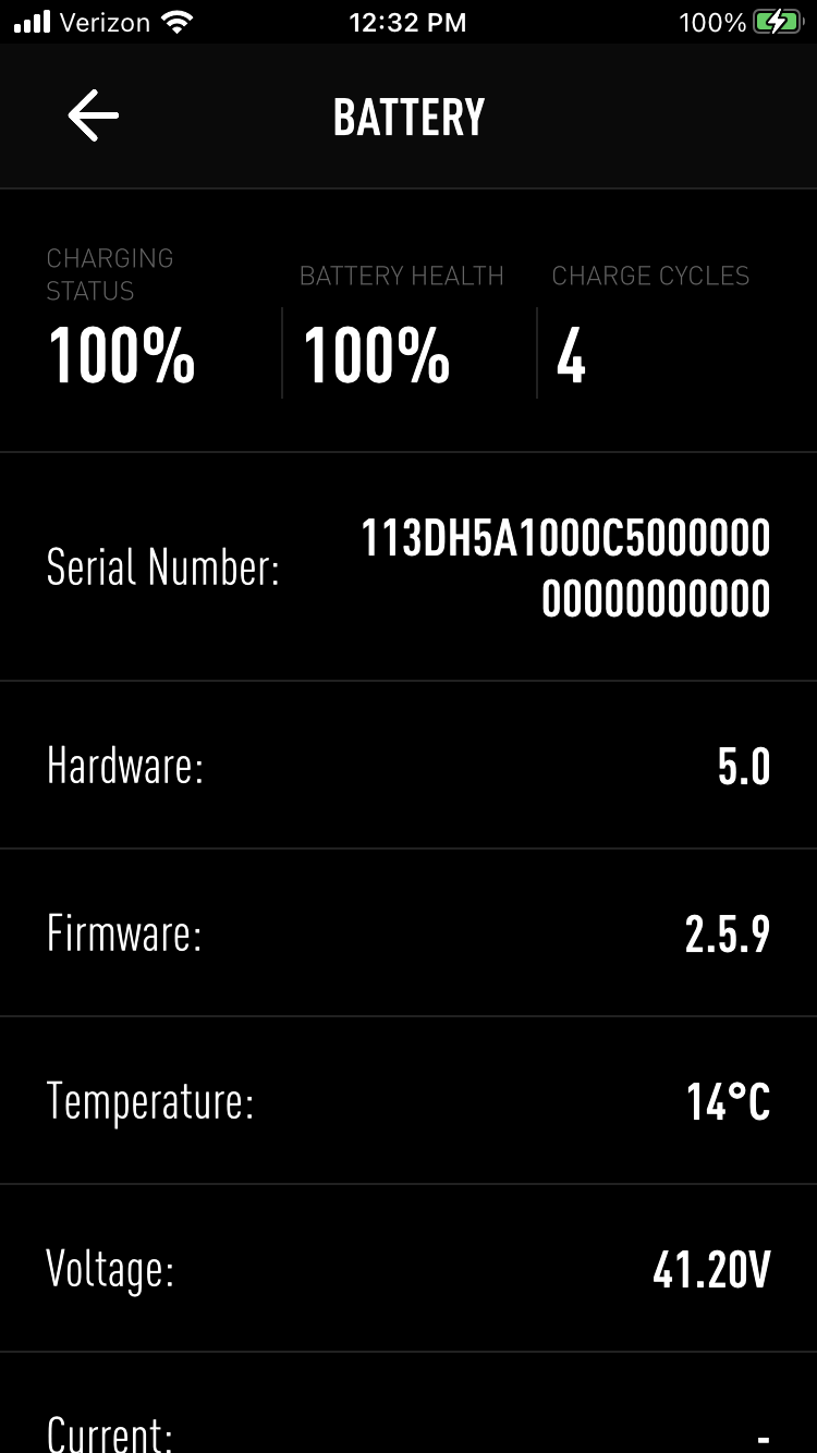

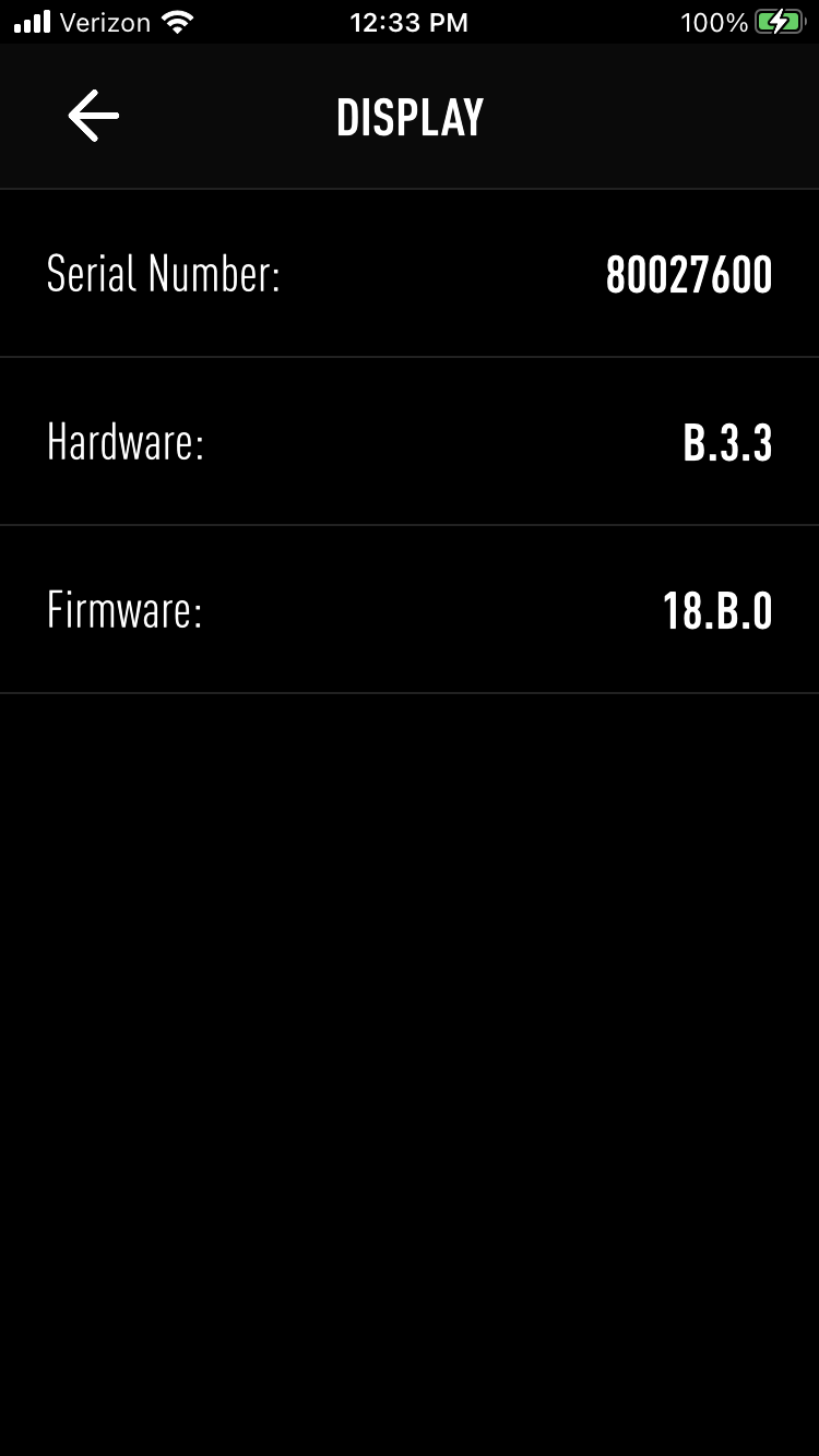

Posting the screenshots of the firmware versions as of the most recent update(s) by the LBS yesterday (I have no idea what it was out of the gate when the bike was acquired).
Battery Firmware 2.5.9
Display Firmware 18.B.0
Motor Firmware 7.4.2
