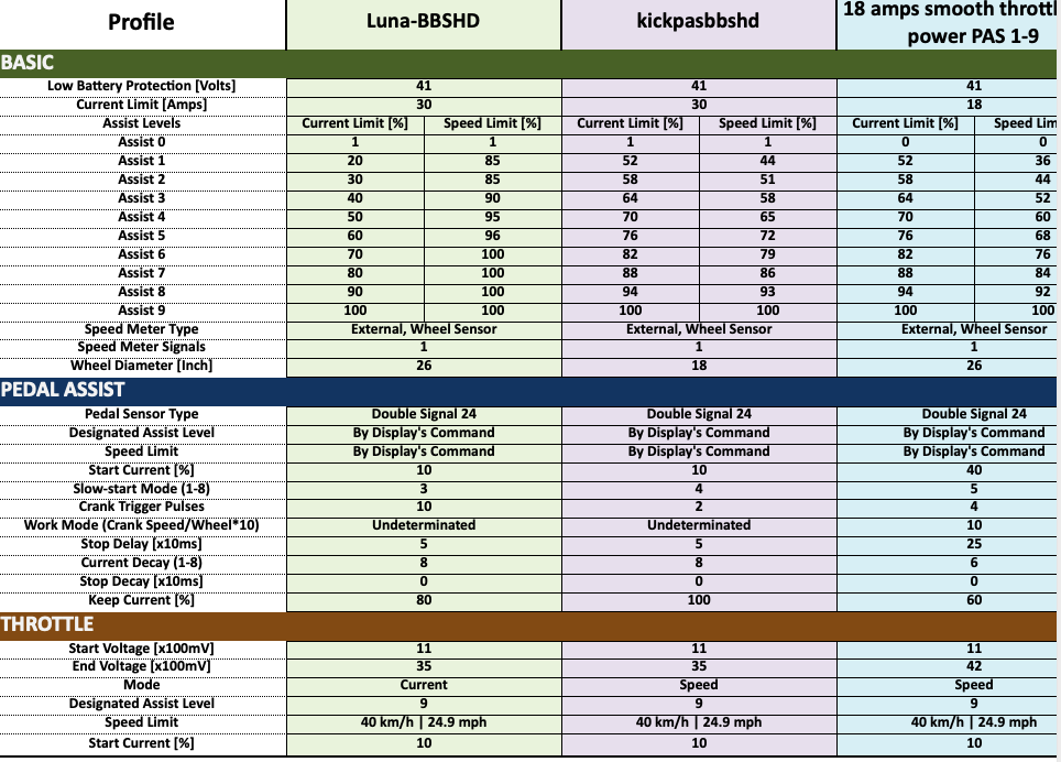

One website recommends limiting the current setting in the firmware to 18 or 20 Amps to eliminate overheating issues if using a 52 v battery.
18-20 amp settings are not necessary if running BBS02B or BBSHD. Some of us do run those motors with lower amps, but there's lots of history of zero issues with factory settings. The reference to overheating with a 52V battery is just silly. Forums can have clueless posters.

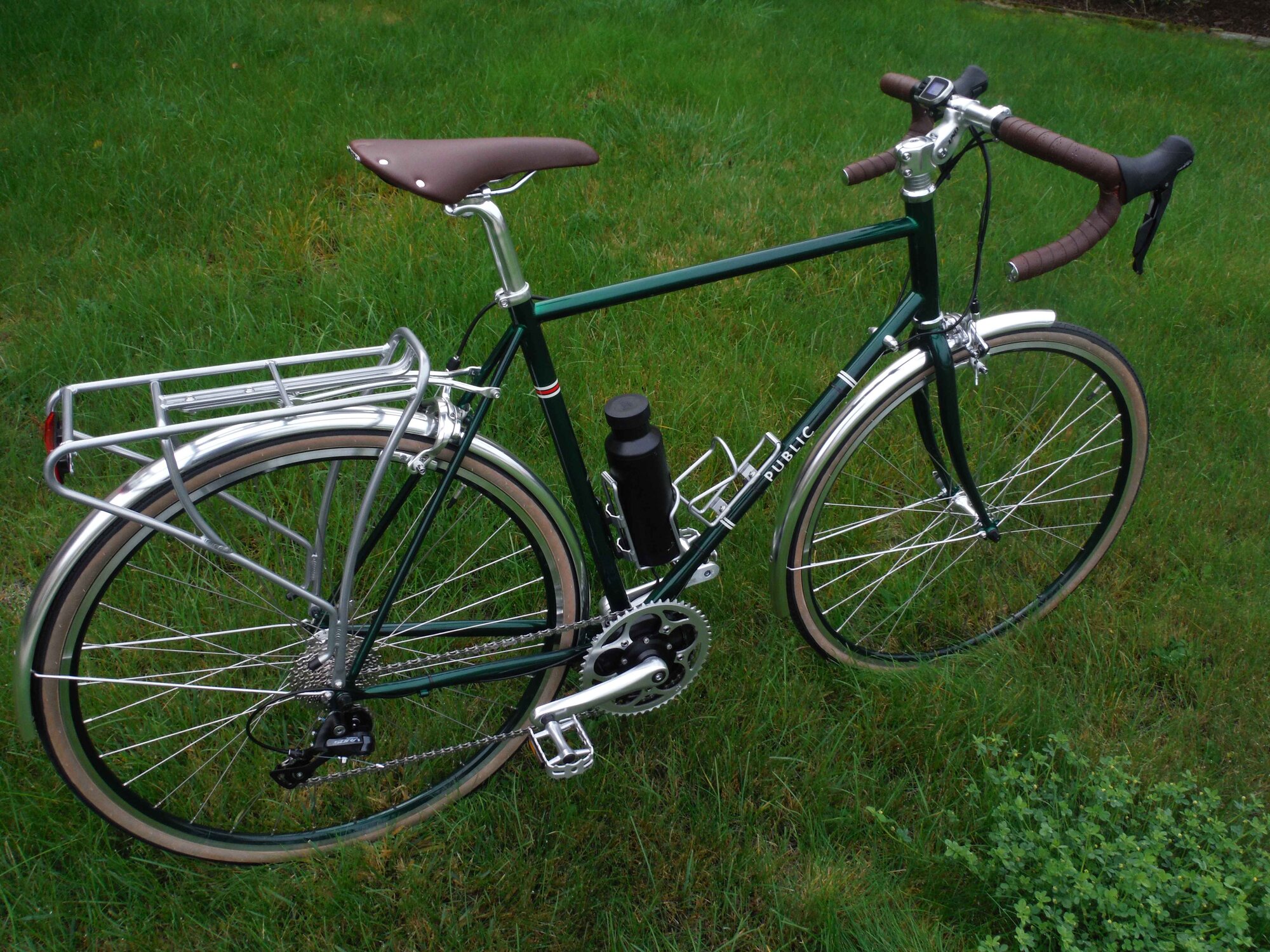

Here is one of my bikes with the 48v version - since then I've been carrying the battery in a triangle bag. Individual preferences vary but I don't see ever wanting to go back to riding with cadence rather than torque sensing.

You can limit an 02 or an HD to lower amps (15a or 20a) again to preserve longevity... but when you dig into the Bafang settings, there are much, much better ways to tame the motor. Leave the amps set to full blast in case you want to lay on the throttle to get home in an emergency or something (it will happen). Set up the bike to be as de-fanged as you want for pedal assist, and let the throttle be the just-in-case override.

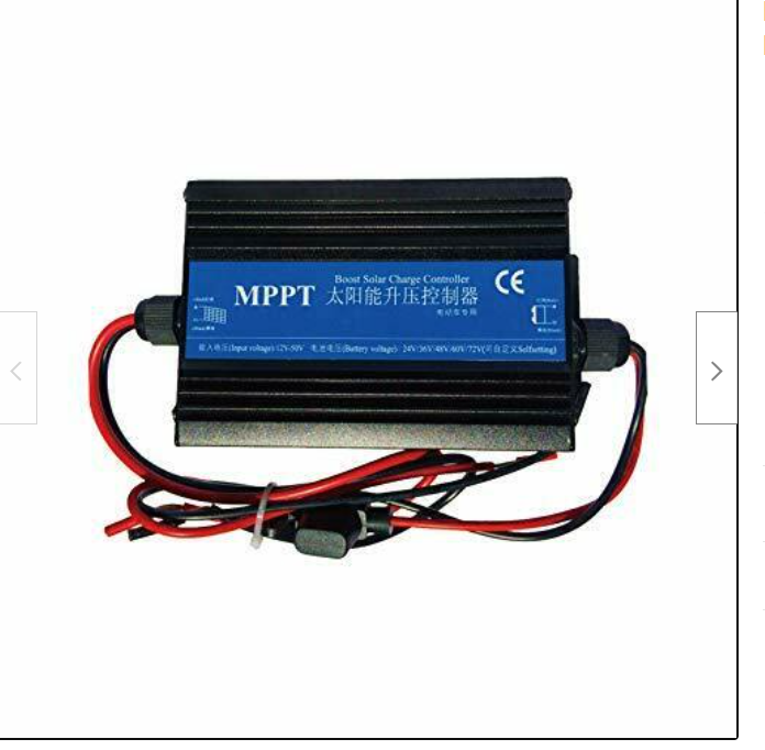

Solar does not seem to have caught on. I use it. Basically, you can buy a 100 watt panel at Home Depot for $75. That's 18v, basically, to charge 12 volt batteries. So, you need to boost the voltage to 54.6 or so to charge a 48v ebike battery. The easy and cheap way to do this is with a boost solar controller designed for ebike batteries. There's one on Ebay, the blue one or the black one with the blue label. It basically takes the output from the panel and boosts it to any normal ebike voltage. Sometimes the presets are too high, maybe for a different chemistry, but you can do a user setting. You may not want a full charge setting.
There are details to learn on charging lith. But basically once the voltage is set up, with the correct connectors for your panel and your pack, it's plug and play. I have 3 of these, for different voltages. They are cheap and they work for me. You can use 2 or 3 100 watt panels. Maybe you can start a trend. It's basically a battery pack that might go 25 miles and you can charge it forever with no CO2 footprint and no cost. Who would want that?

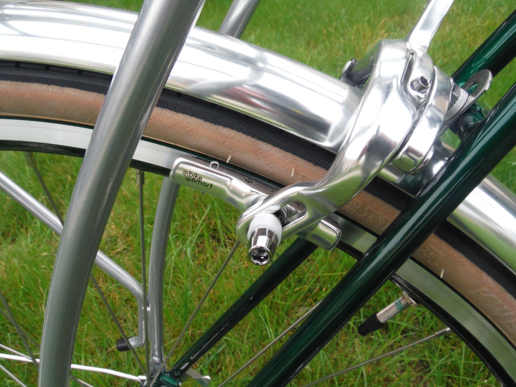

I often build rim brake bikes and use extra-long shoes. It is important to keep the rims clean. Upgraded shoes can lockup and skid. I prefer smaller torque sensing motors and lighter weight batteries. I also like to keep any added weight to the center of a bike and low. This is where you would put ballast on a sailboat. A good build will not look much like an electric bike.

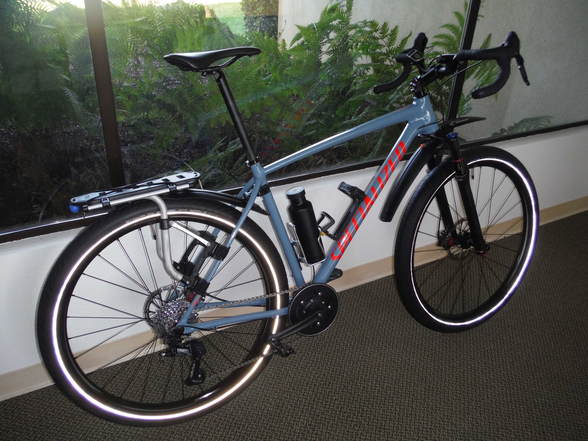

@Popparex, When I was new to electric bikes I thought that bigger is better. I gravitated to the notion that more is better. The HD is huge and heavy. It lacks feel and subtilty. Without sophisticated reprograming the lowest power level is too much. There is surge and lurch. It can be ghost pedaled. That means that if you don't use any pedal pressure, and pedal super slowly you will still go really fast. Now I am into the Zen Garden of less. This takes additional thought and care but is so very worth it. Before you pull the trigger look into some smaller mid-drive torque sensor motors. Also if it is being shipped by air from overseas, for the next four weeks air freight cost are triple their normal cost. Make sure that the seller is covering customs and freight or your kit could be stuck in limbo without recourse. You might consider postponing for a few weeks until after the Christmas rush. Just some thoughts I would share with a brother or a friend. This is what a clean build Zen, looks like. The third bike is an HD where I removed the ugly wires and connectors.
Yeah... that's what i am thinking. Too much power. Again, we're into long and leisurely so i will likely stick with the BBS02B but will give the others a look.

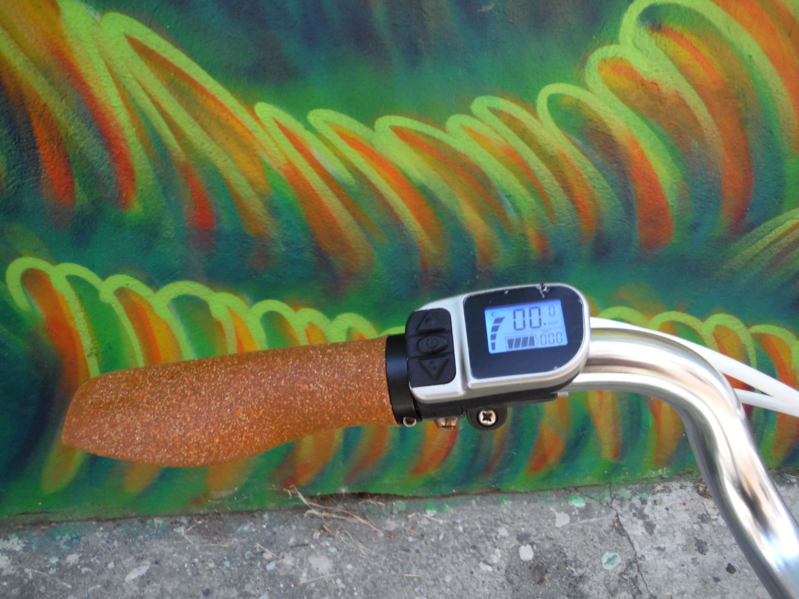

Any recommendations on the displays?

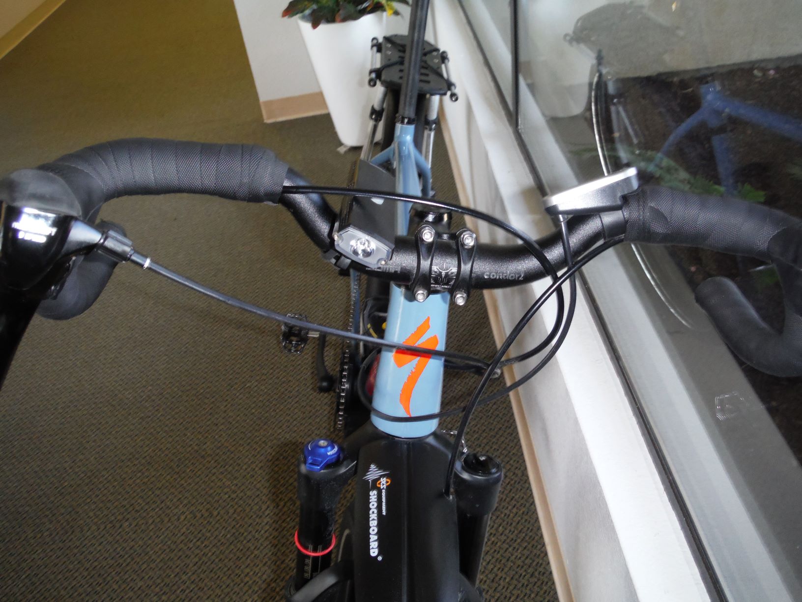

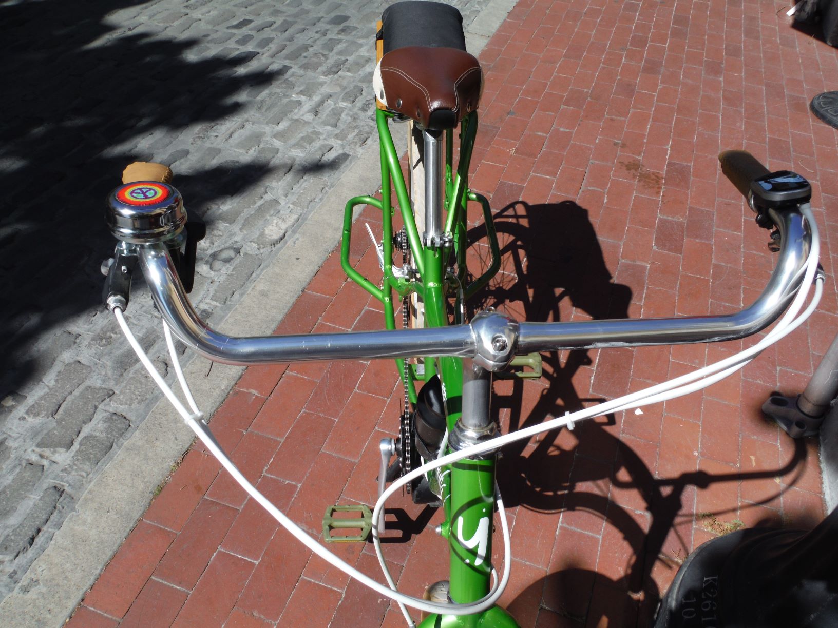

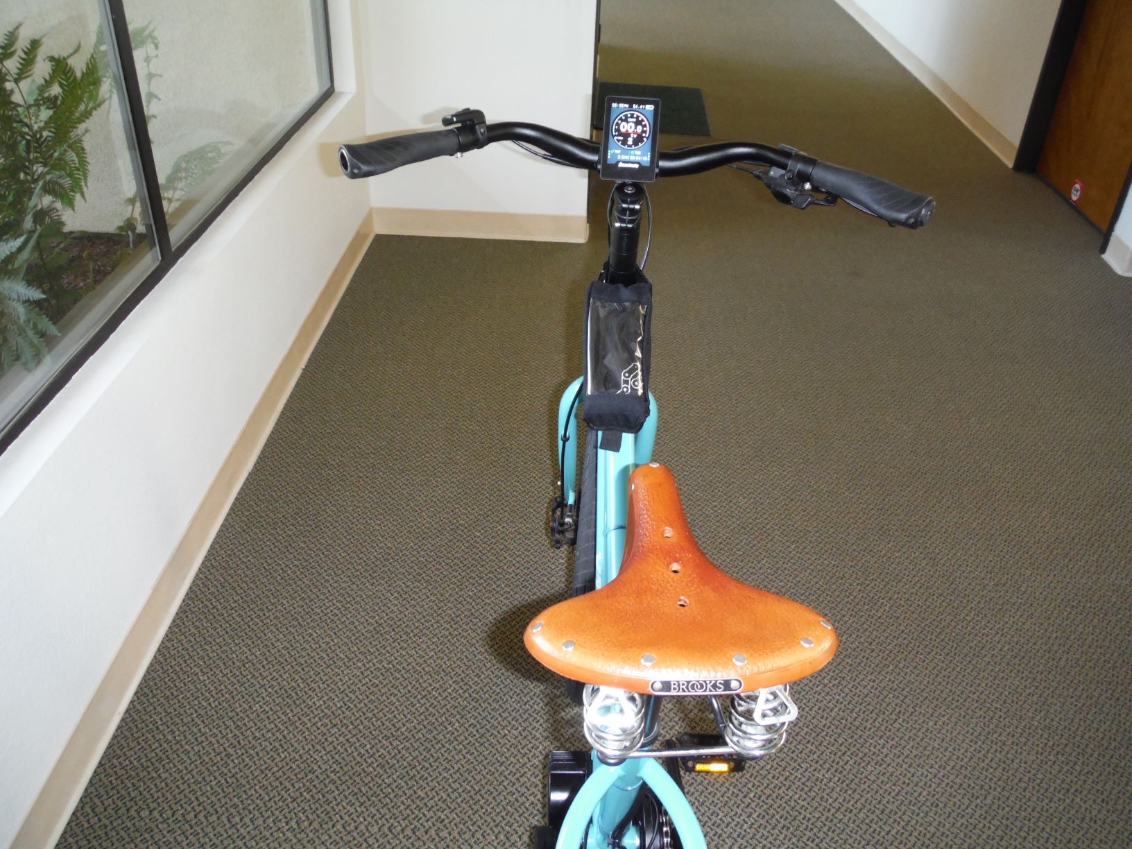

The smaller display the better. The less wires the better. I used to install bricks. In truth you never look at the display when riding. Just like you don't look to see what gear you are in, riding by feel. Want more power? You feel for the up button with your thumb while looking ahead. Even the SO2 is kind of clunky and lacks feel. The good ones, kits, measure pedal pressure or torque, not just cadence. Your input like and acoustic electric guitar is matched and amplified. Smooth, powerful. Intuitive. Still you. Just more.

An example of BBSxx programming files.
