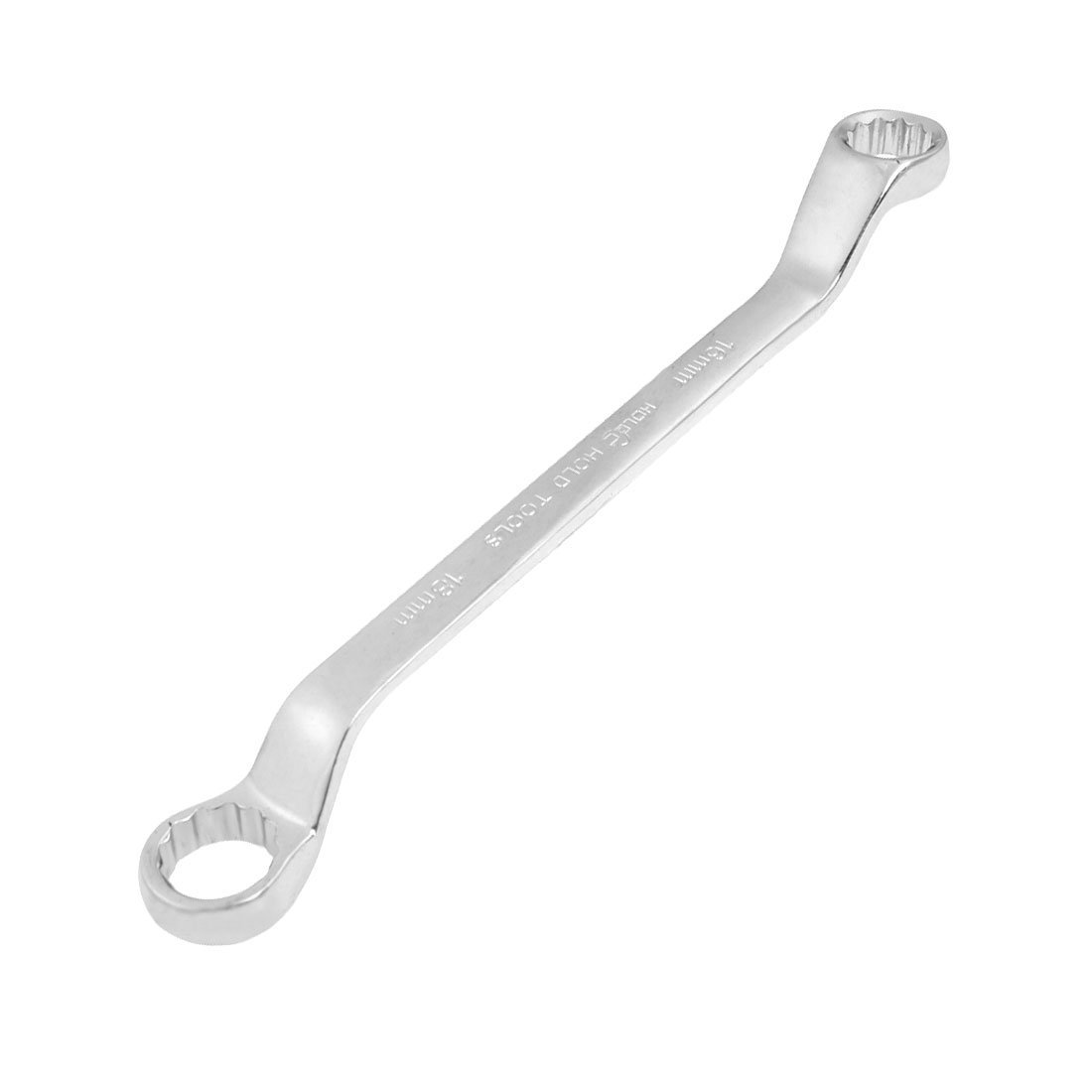

On the Juiced site they sell a toolkit for working on their bikes. I already have all of the tools in the kit except for the lug wrench with a cutout to allow the motor cable to pass through. Is this wrench absolutely necessary to remove the rear wheel, or can I get by with an open-end or adjustable wrench? Is that specific wrench available elsewhere? Thanks.
This or similar
works supremely well after grinding for clearance.
It really needs to be done with a bench grinder or similar while near the bike so you can check the fit as it gets closer.
It must be a full body fit or flats will be rounded.
There are other ways: get the Juiced special wrench or a set of pass-through, external drive sockets that includes an 18mm.
This or similar
i used the exact same offset wrench but didn’t have to grind anything. The tool worked perfectly fine as is for me.

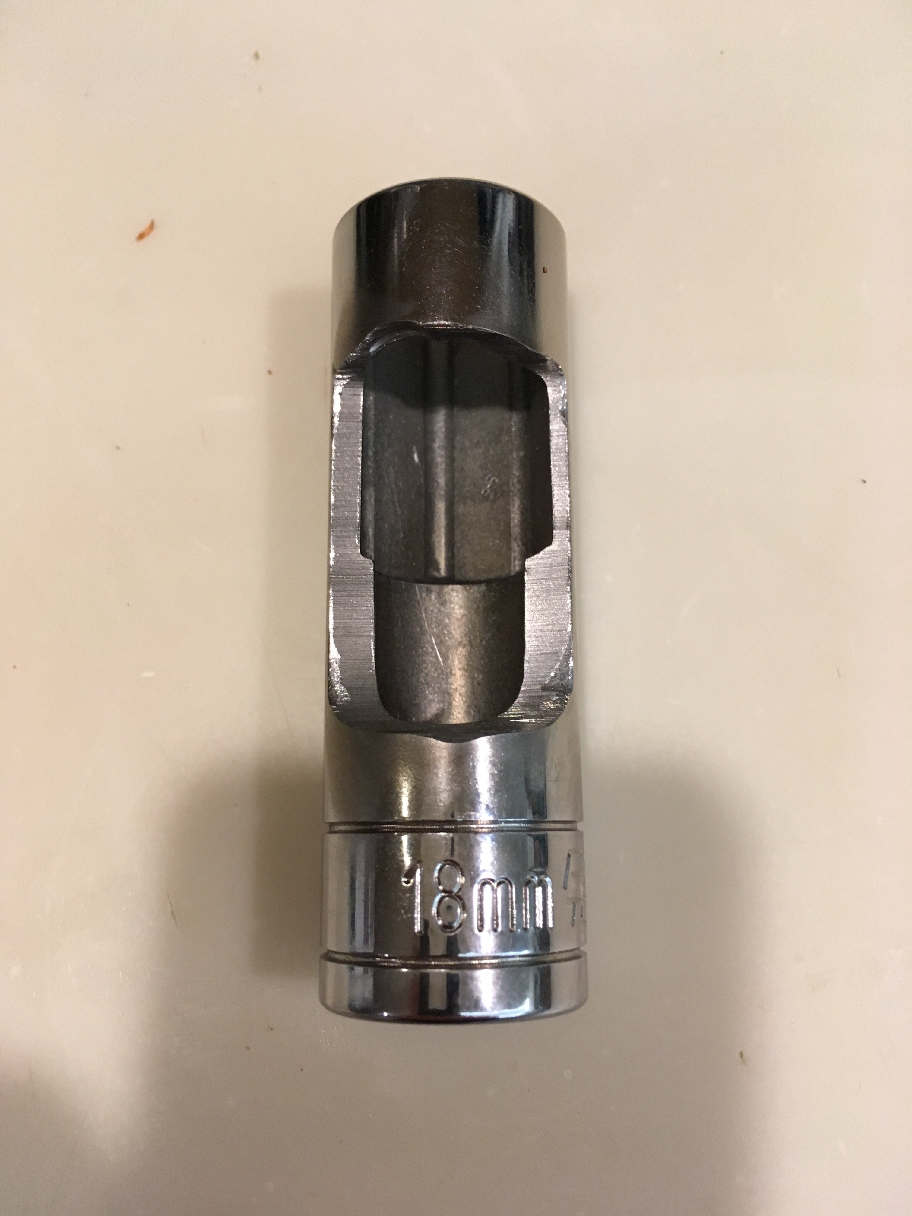

I bought a deep socket and used a bench grinder to open up the side of the socket. This allows me to use my torque wrench to meet JB’S SPEC OF 45 NM.
Juiced has been out of stock every time I've checked for months, on the relevant tools.
