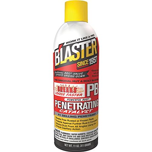

A tough bolt requires patience... A little penetrating oil, time and then a heat gun works wonders.
People bring me bikes that have frozen bottom brackets. You are exactly correct. Heat it up and when it contracts the oil goes in.
