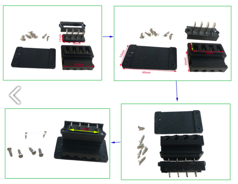

Yup, I have looked at most of the sites you recommended. I did not see the https://www.ebikes.ca/shop/electric-bicycle-parts/connectors/con-dt-5pin.html site which shows a 5 pin Blade connector that looks simular to the one in the XP, but without any dimensional information the only way to know for sure will be to order one and see what I get. It looks like the blades are longer then the OEM but that can be dealt with, so this is a possibility.
I have attached a photo of the Lectric XP frame side of the battery connector as you suggested.
tnx for your help

Interesting. My Pedego batteries use the 4 prong version of that same connector type. This is the female battery side:
43115
I also have had no luck finding a suitable connector. If you come across one, let me know.
I've been using simple crimp-on spade connectors for my battery projects:
43116
I build up the face of the male connector with solder and open the jaws of the female to accept the thicker lugs on the battery box.
Not a great solution since each connection has to be made separately and the correct polarity observed.

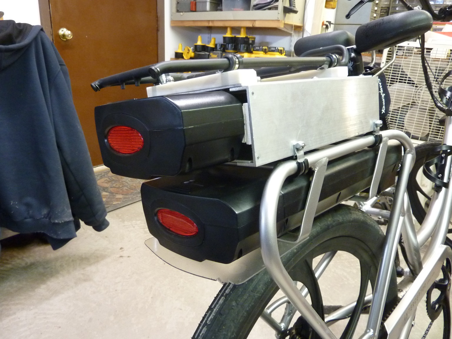

George, I like the spade lug option, on a Y-cable to the bike connector. This allows you to put the battery in the bike and use it normally (insulating the spade ends of the Y-cable, of course) or use it mounted on the rear rack.
Another possibility with that option is to carry a SPARE battery on the rear rack, in parallel with the main battery (although this doesn't solve your charging issue), essentially giving you twice the range. During my tests of the battery voltages it appeared that the three middle pins aren't connected to anything. They certainly aren't during charging; perhaps they are temperature sensors of similar for the bike...?)
I've built a carrier for my spare battery, originally intended to simply have it with me on long rides in the event I run the primary battery down, but after reading your post I think I'll cobble up the Y-cable and be able to actually run the bike from it. With the battery containing it's own on-off switch it'd allow you to select either the main, spare, or both.
I put a hole on the bottom plate, which is .100" aluminum to allow the battery to be locked into the carrier. The top is .032" 2024-T3 aircraft aluminum, but if I were to do it again I'd use .025" - the .32 was too hard to bend with my el cheapo Harbor Freight metal brake! I flush-riveted the top to the bottom so there'd be no protrusions on the bottom surface of the carrier, but it could be bolted together with 4-40 hardware.
439584395943960
The carrier is zip-tied to the rear rack - until I can come up with a more permanent mounting arrangement. Now a 2-conductor 10- or 12-ga. cable with spade lugs connected into the bike's battery connector will allow me to use the spare battery without having to swap it with the main...

I did something similar with an aluminum battery box attached to my rear rack:
43963 43964 43965
I cut up an old rear rack and mounted it to the top of the box so I could use my trunk bag:
43966
I used these insulated cable clamps to attach it to the bike. They are easily removable and don't mar the finish:
43962 43961
Rather than alter the bike wiring harness, I just swap batteries when necessary.
