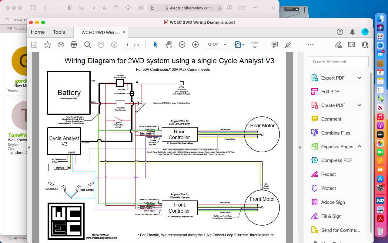

The short answer is "yes". You will need two separate motor controllers, and yes you can use separate batteries, or combine your batteries safely by using a "reputable" parallel battery adapter similar to this: (make sure you know what you are doing running batteries in DIY parallel)

If you are asking how it will affect your ride and handling, there is some anecdotal data on that around these forums and on YouTube. Take a look at at this dual front and rear hub configuration from Eunorau.

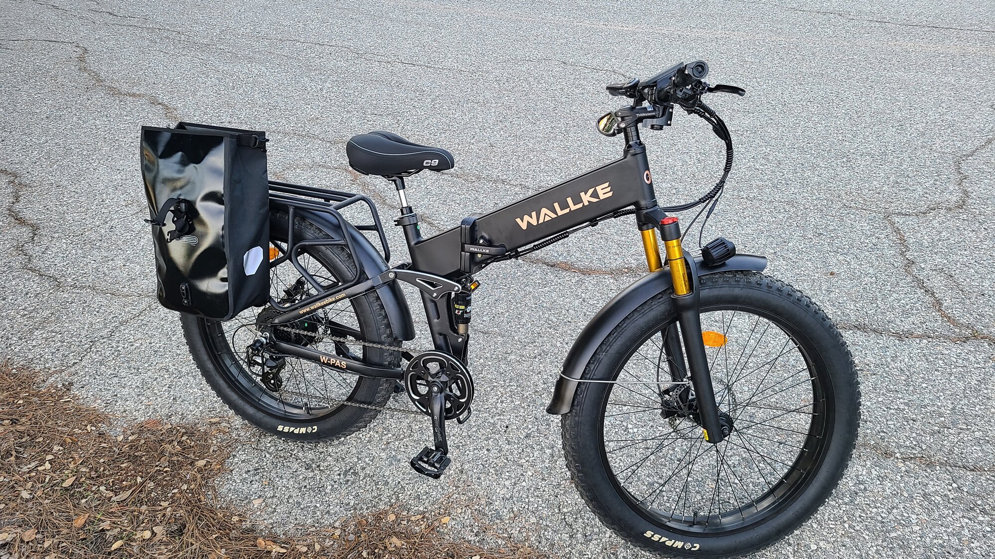

I made the mistake of buying my first ebike without thoroughly doing the research. Now I am stuck with a ebike that lacks power. Now I can sell the bike and start fresh or add on to it and make it a more capable bike that can do everything I want. My goal is to climb steep dirt roads or trails and be able to pull a hundred pound bike trailer for bike camping like the Burley flat bed trailer.

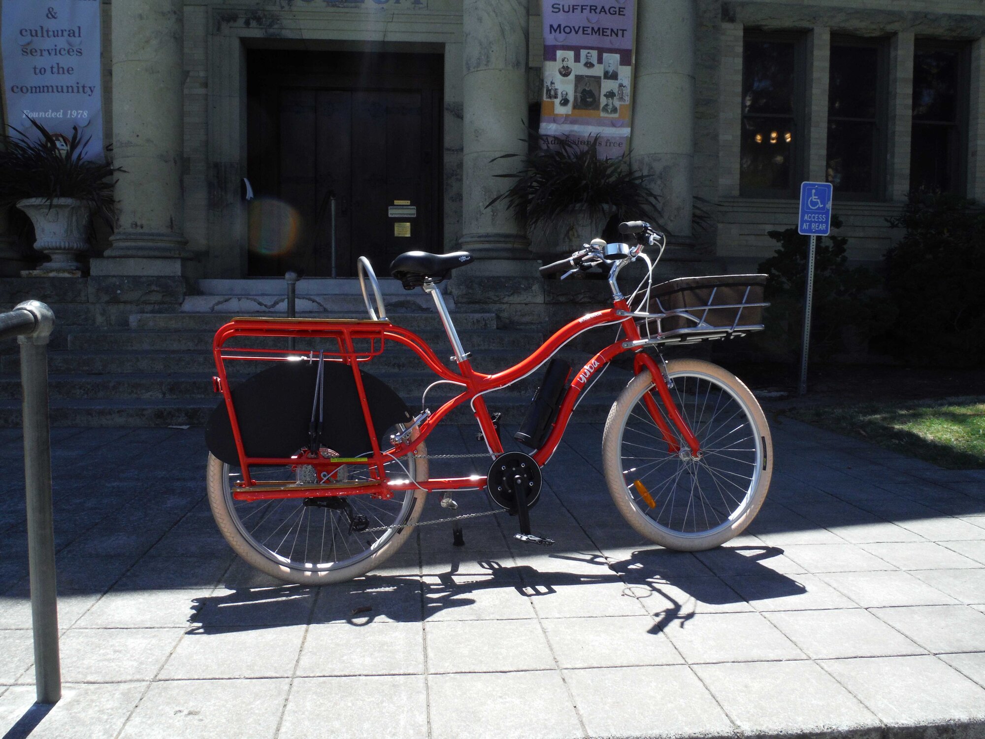

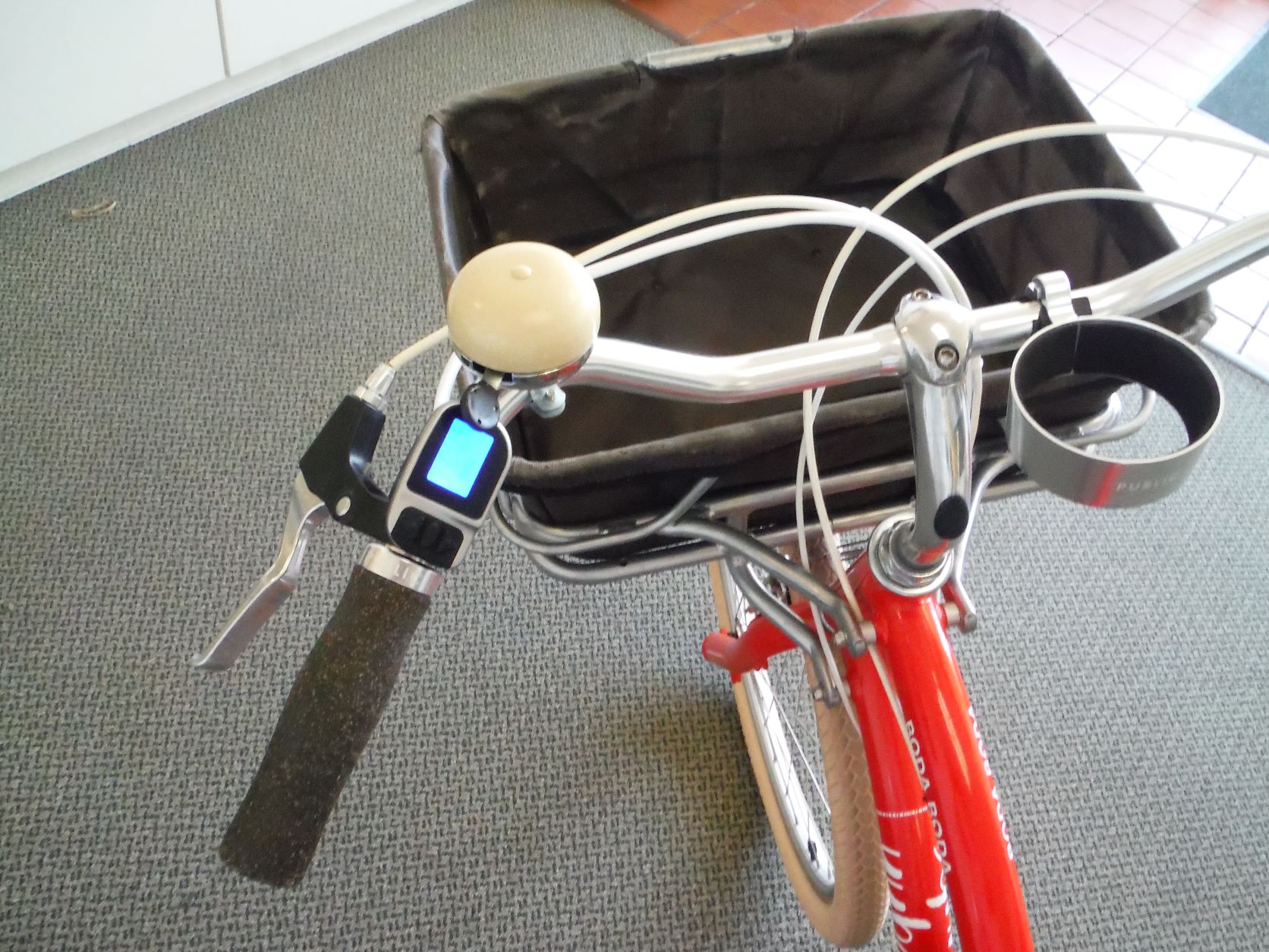

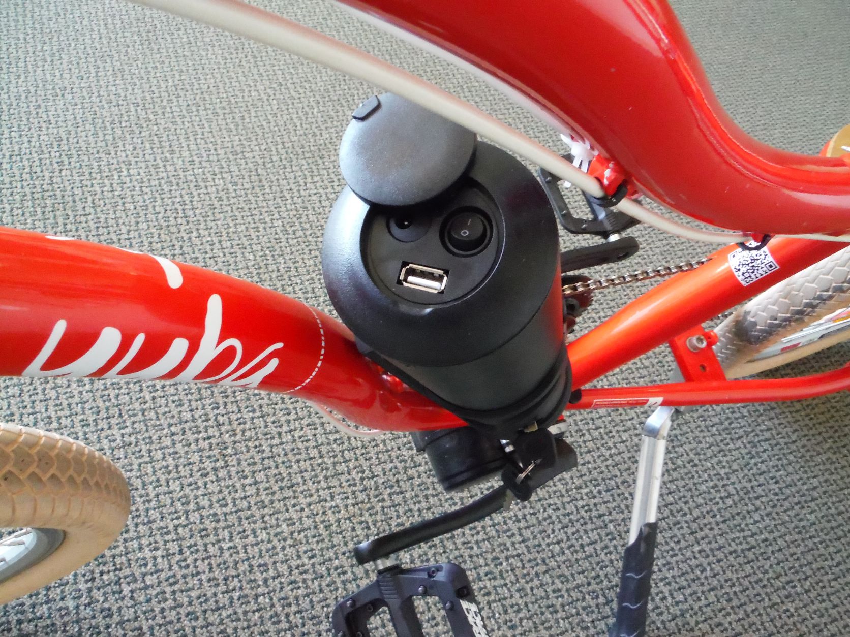

Got it. Sell it stock. It is worth more that way. Get a good bike from Craigslist. Something like a Boda Boda. Install a mid-drive. These bikes have extra-strong wheels. You will also want to upgrade the tires. Super Moto-X goes just about everywhere, or something more off road by Schwalbe. You likely will not need the trailer. The running boards and rack hold something North of 200 pounds. Use an ebike chain from KMC. A Nuvinci CVT cargo hub would be nice but is not necessary if you install an 11-42 with a long cage clutch derailleur. It also looks better when you remove the ugly extra wires and connectors.

I am currently into this ebike for 2 grand and adding a mid drive is another 1500 ish. So at the end I end up with, I agree a heavier bike but will have two bikes in one for 3500. I will post more if I go through with it. But in the mean time I would appreciate more helpful thoughts or advice that anyone might have.

what brand/model of bike did you purchase?

This bike needs more power as I am not able to climb steep hills or steep dirt roads. Also I would like to pull a bike trailer like the Burley flat bed. I am not in it to go fast or to tearing down public roads but more torque. More off road capability.

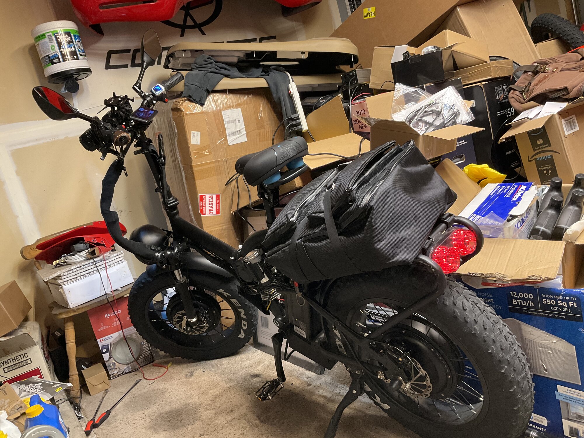

I put a 2000w hub on the front along with a 2000w rear hub motor..tons of fun 👍👍
