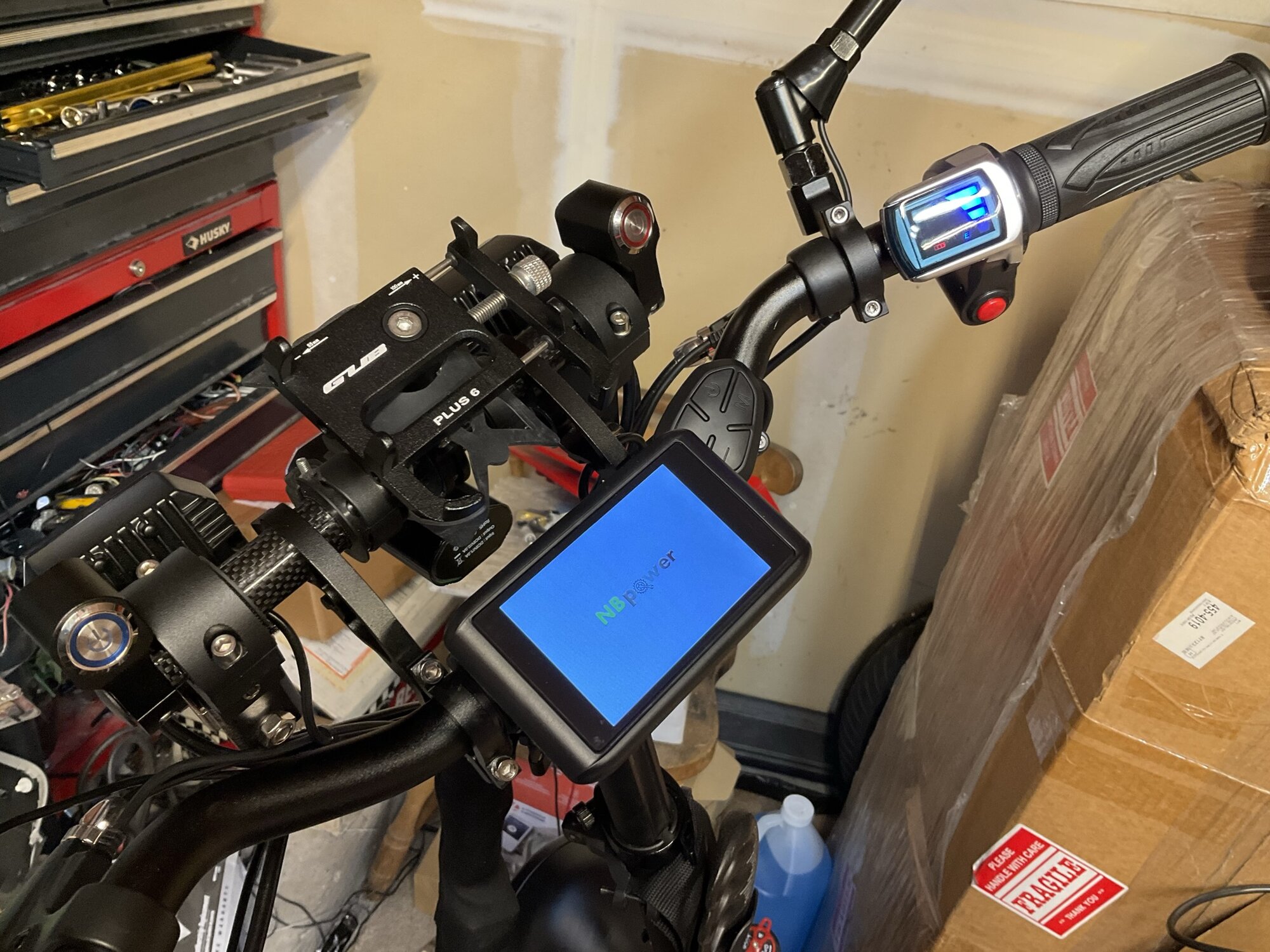

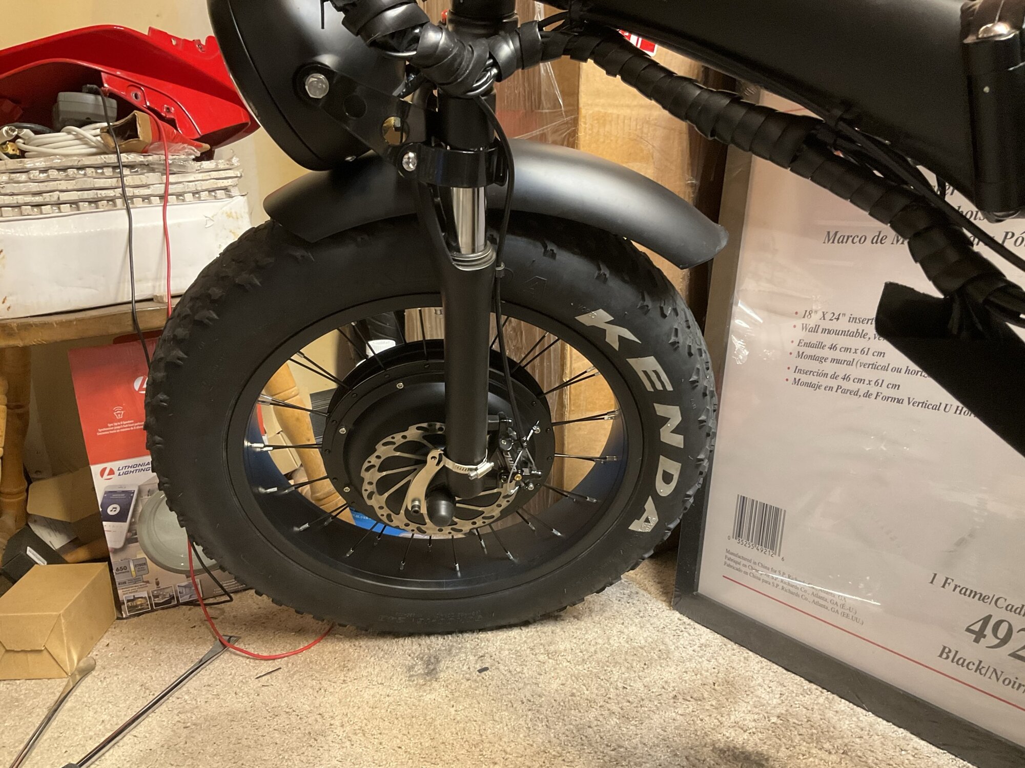

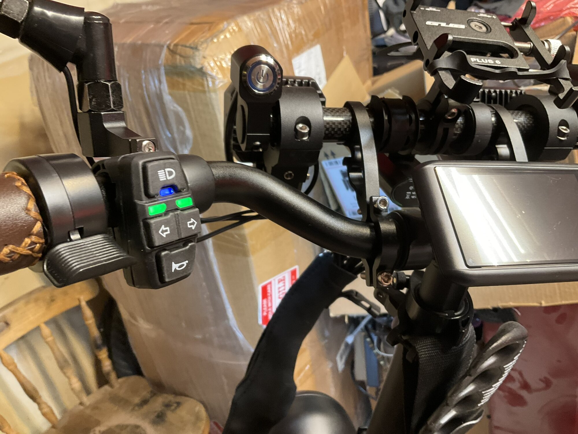

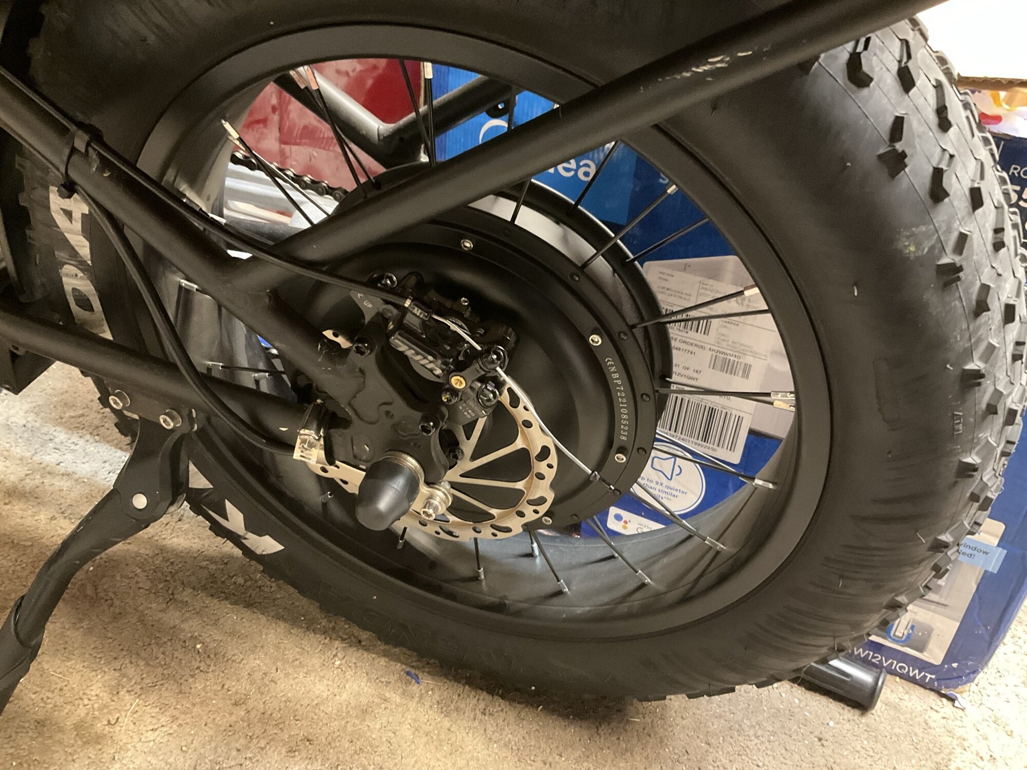

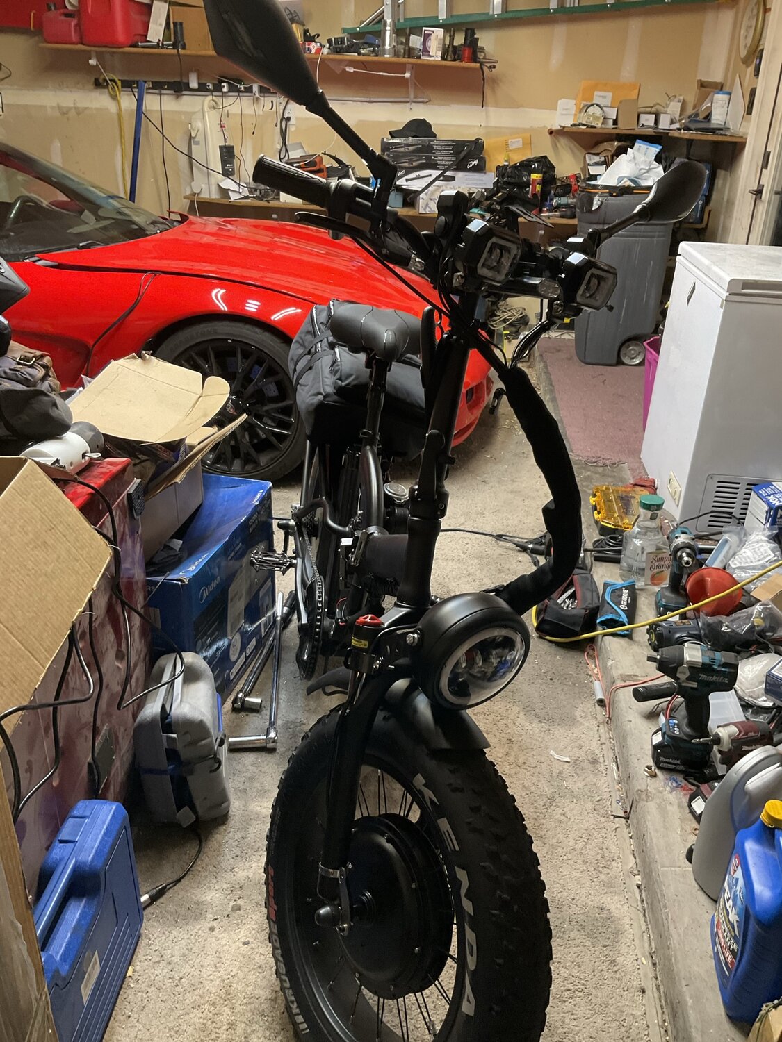

I put a 2000w hub on the front along with a 2000w rear hub motor..tons of fun 👍👍
Who weights more: you or the ebike😉 ? i'm guessing 135 pounds for the ebike...
Can u share some info about the 2 controllers you used and wht AH battery ? 220mm rotors ?
203mm F/R
Not going to lie, it's a heavy bugger but still scoots to ~40mph
My rear motor battery is a 72v 20AH & front is 48v 20AH
The rear is controlled with a left hand thumb throttle/sabovoton controller & front controlled by a 48v twist throttle controller
Added lighting, horn and F/R turn signals and was able to use it as a work commuter all last summer. Use motorcycle helmet and jacket while commuting. Looking forward to riding it to work again as soon as it warms up a little more.
Some additional pics (203s not pictured)
