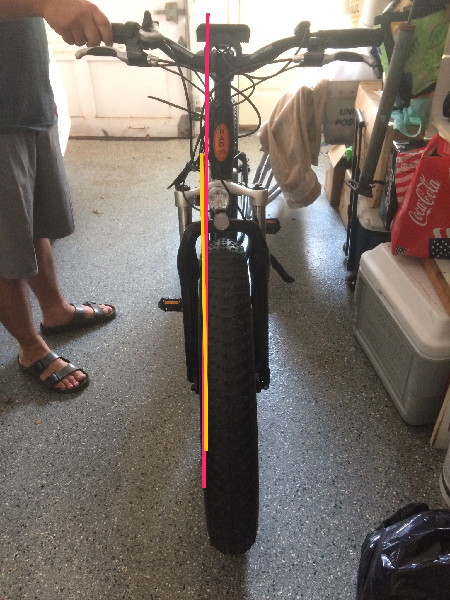

Issue resolved...With some help from a few expierenced riders it was determined that the fork tube was off axis with the fork. This caused the fork to be 1 - 2 degrees off which made for the hard right turn. It appeared that the tube was welded wrong onto the fork rather than bent or damaged in shipping but with the attached photo the RadRover Customer Service rep sent out a new fork and the bike has a drastically different ride.... it rides great and tracks straight!
Looks like another issue caused by poor packaging during shipping. :mad:
View attachment 17718 Issue resolved...With some help from a few expierenced riders it was determined that the fork tube was off axis with the fork. This caused the fork to be 1 - 2 degrees off which made for the hard right turn. It appeared that the tube was welded wrong onto the fork rather than bent or damaged in shipping but with the attached photo the RadRover Customer Service rep sent out a new fork and the bike has a drastically different ride.... it rides great and tracks straight!
Jon, could you explain the procedure taken to determine the off-axis fork? It could be useful to some others, as 1-2 degrees is hard to spot visually.
With help we put at old fashioned yard stick on the top and bottom of the tire and it would accentuate the angle enough that you could visually see it at the steering tube. I can see it in the picture above. The bike rides great now.
