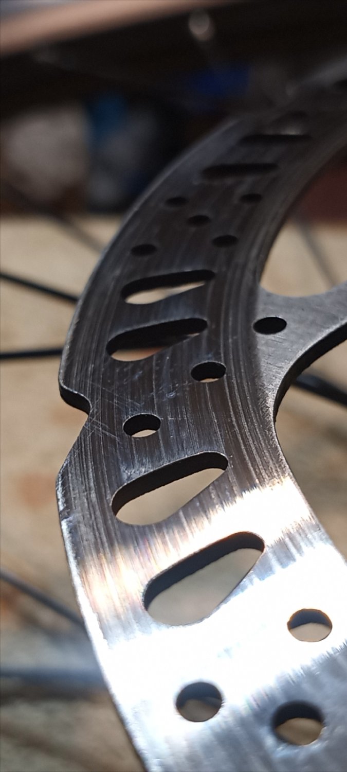

Oh, Tektro E10.11! That explains it. They've got stuff added to make them last longer. If you buy pads that don't last as long, that could solve your problem!
I thought that they were "soft" pads because they're not metal pads ?
I've wondered about grit. Maybe in damp weather, it could stick to the rotor, than get stuck in the pad.
This s*it is like multi-grit grinding paste,..
Even airborne dust and grit gets tossed up into the grinding/chopping blades of the rotor. 😂

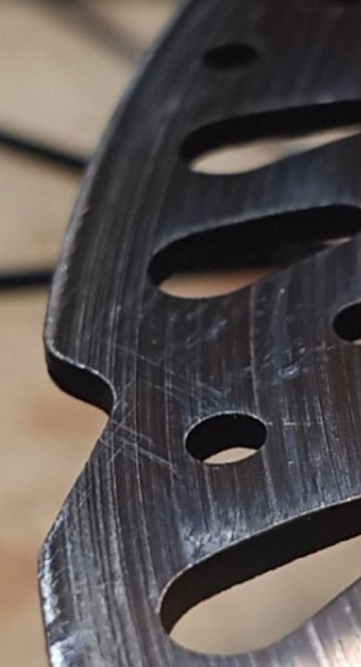

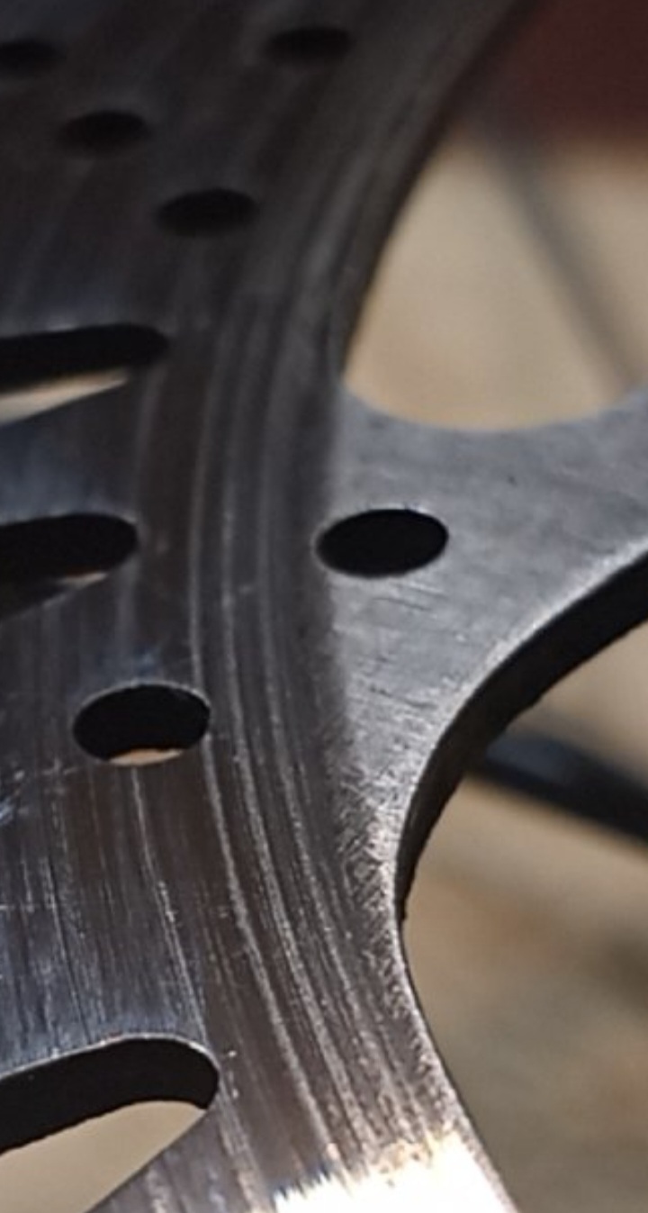

I see the wear on your rotor extends to the edge on the right bit is a couple of mm short on the left.
Yeah the pad isn't centered properly and is extending past the braking surface and into the spokes,..
Ohh,.. for reference sake, the rotor is ~1.8mm thick.
I've got my camera all zoomed in so the lip looks huge.
Suppose a squealing sound wakens you at 3 AM,.. it's your extended life Tektro pads.

You've got to get those pads out
It looks like you've got the same rotor as I'm getting, and the same caliper too ?
What brake pads are you using ?
From what I gather regular pads are dirt cheap but wear out fast.
I don't care about that, I just don't want to wreck my new rotor.
That box with 4 sets of pads and tools is eleven bucks now, but it's got chunks of ropes, and metal in them, maybe tree bark too ? 😂

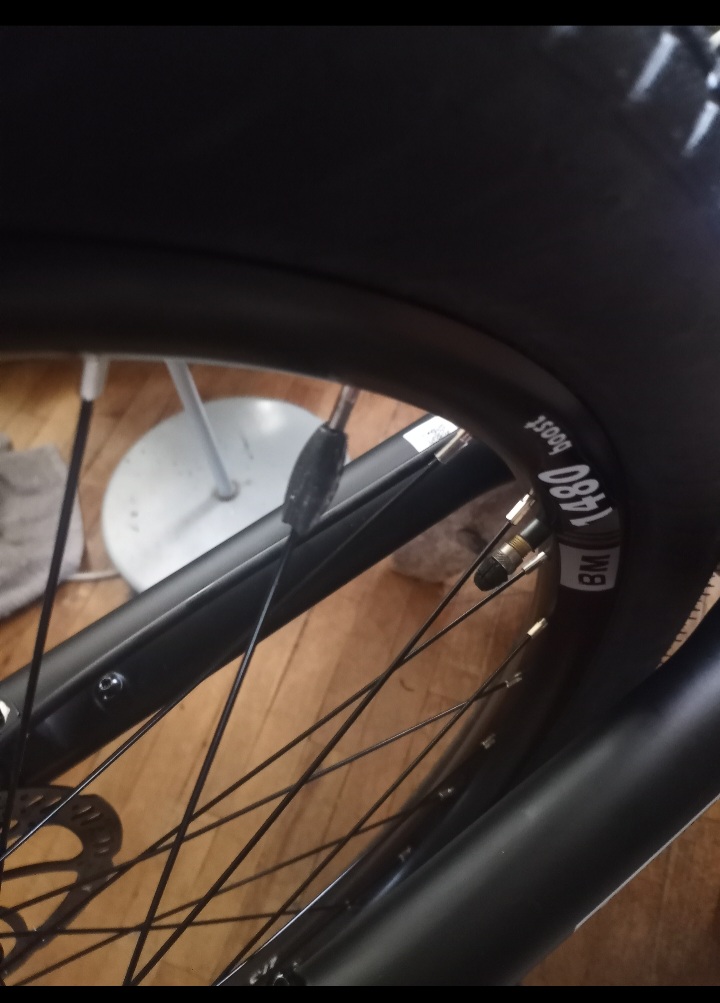

Okay, gotta ask. What is with the wound wire on the spokes?
Wheel balancing weight.
@PedalUma and I like to get all dorked out and true our tires using pastels and grease pencils.

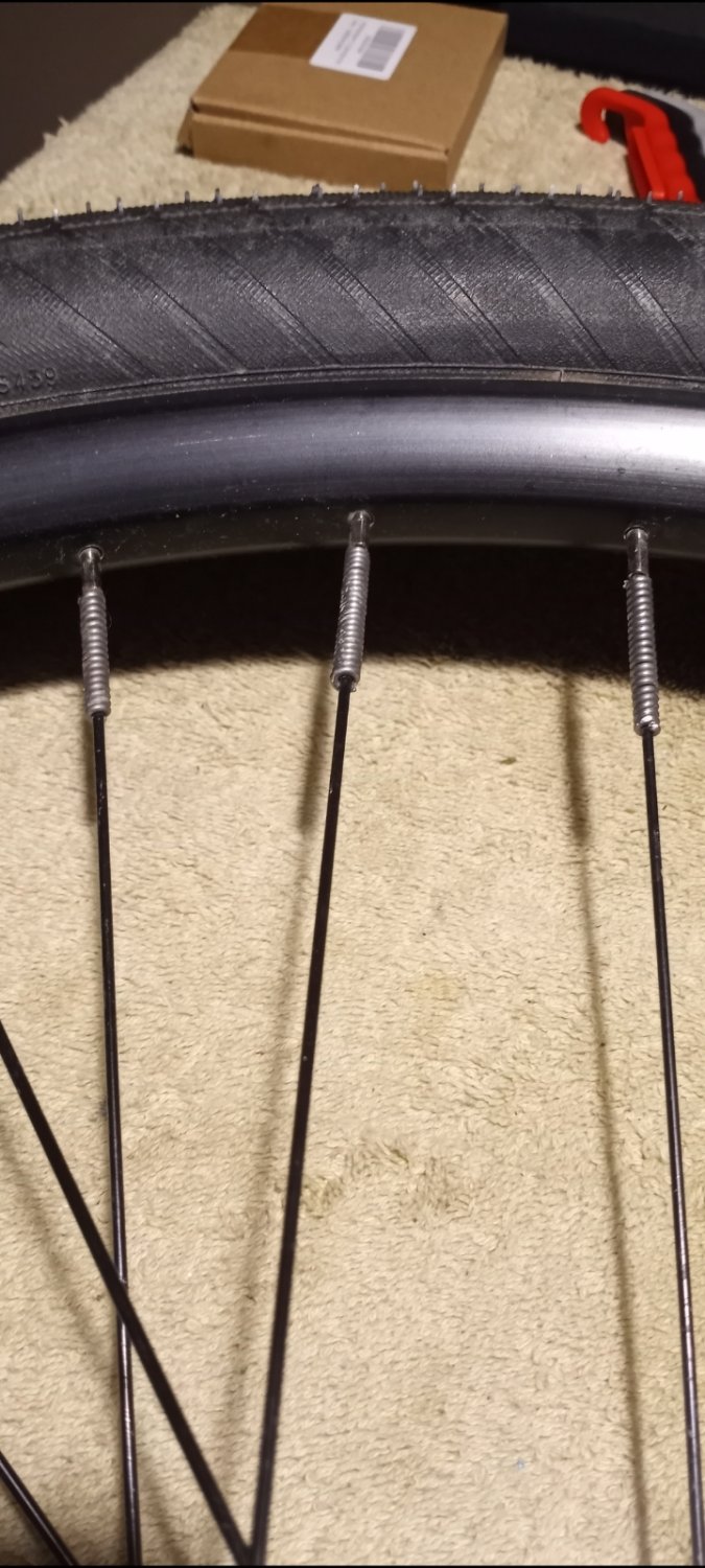

I took it a step further and balanced my wheels as well.
I tried fishing weights, but they were too hard to work with.
The solder is really easy to roll around the spoke, and to add or remove some.
To fix a warped rotor, I just find where the rotor is rubbing then grab a nearby spoke and rotate the wheel holding the spoke noting where the bend is relative to the spoke.
I haven't spat on my tires yet.
Maybe I'll give that a try ? 😂
But I'd end up with spit all over the wheel while I was chasing a warp around in circles. 😂
I see the wear on your rotor extends to the edge on the right bit is a couple of mm short on the left. If you used Bicycle Rider spacers to move the caliper left, You'd have a lip on the right.
I don't need to move my caliper left or right. My rotor is centered between the pads.
I need to raise my caliper up to raise the pads about 2mm.
This direction,..
Cardboard spacers wouldn't work much better than cardboard pads and rotors. 😂
This direction,.
I was talking about left and right in your photo of your disc. That seemed the least confusing way to put it. If your spacer arrow points up, what you call moving the caliper up is what I call moving it aft.
Hmmm.... no cardboard. I don't see how any genuine bicycle rider could do without Bicycle Rider Spacers. I used them to center my pads left to right.
I think I see what you're doing wrong. If you're like me, you're concerned with the danger of inadvertently locking your brakes on wet ice. Rolling, you get a coefficient of friction of .05, but if your brake locks, it's virtually nothing, and that could impair control. To ensure that I can brake with a delicate touch, I spray pads and rotors with silicone spray rated at 400 F or 200 C.
When I happen to ride through a pile of carborundum grit, this miracle coating keeps it from sticking to my rotor or pads. If you would do the same, you would no longer have to worry about rotor wear.

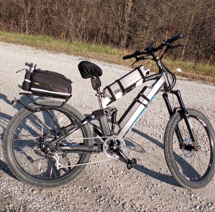

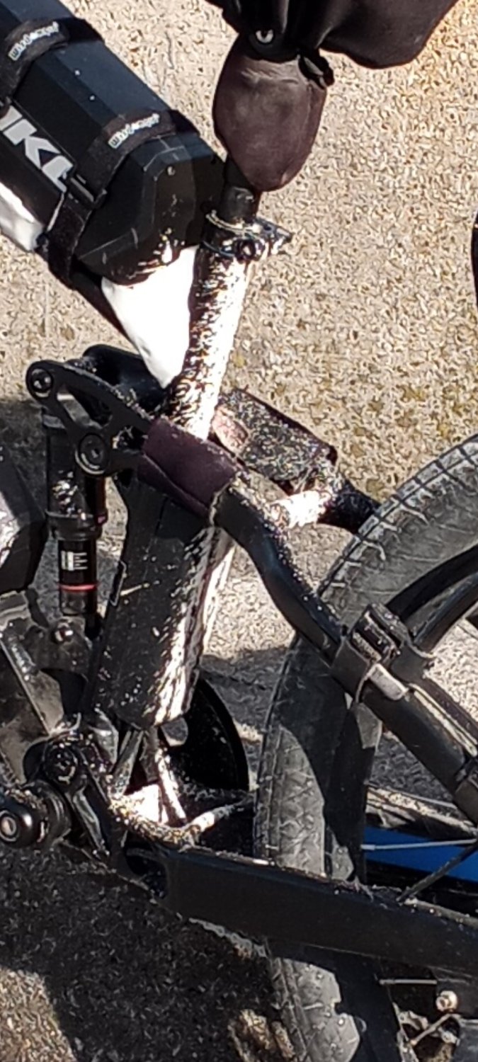

I like to ride no-hands and everything was fine until I strapped a second battery to my rear rack then I started getting a shimmy that would go out of control and crash my e-bike if I didn't grab the handlebars.
I spent months trying to stop the shimmy, including truing and balancing my wheels/tires.
(If I leaned my e-bike over on the side stand and spun up the rear wheel, the e-bike would shake.)
After my rear rack broke off the e-bike, I managed to attach the second battery to my top tube (using polymorph plastic) and the shimmy was gone.
I replaced my rear rack with a Topeak rack and bag, but I still can't put any weight in it.

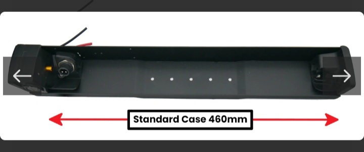

There is a battery bracket available but it would make the battery about an inch taller and four inches longer, I didn't have the space for it, and I'd still have to attach the bracket securely to the top tube somehow?
Now I can ride no-hands through 2" deep potholes and just float right through them.
My e-bike only goes 20 mph, but I'm sure I could spin up my wheels to 200 mph and they wouldn't shake. 😂

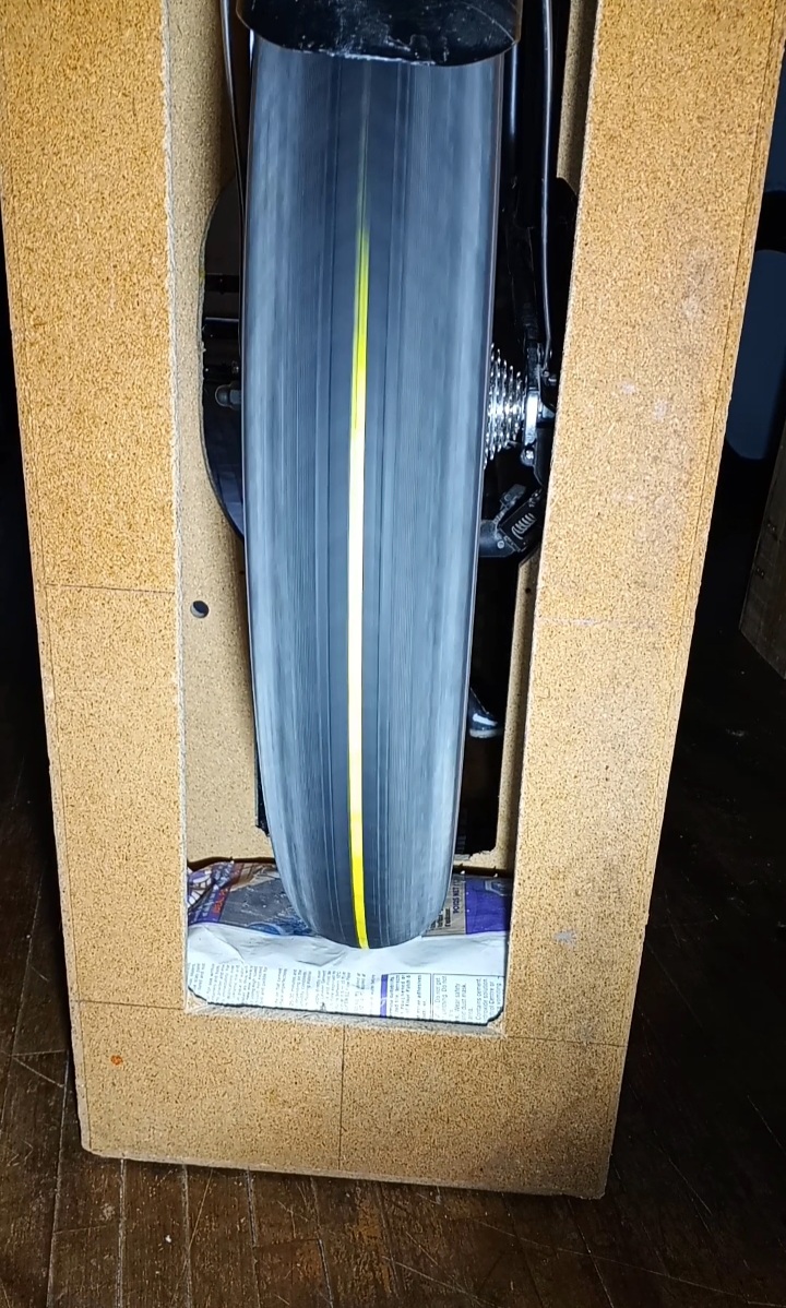

That front wheel turned out to be way out of balance.

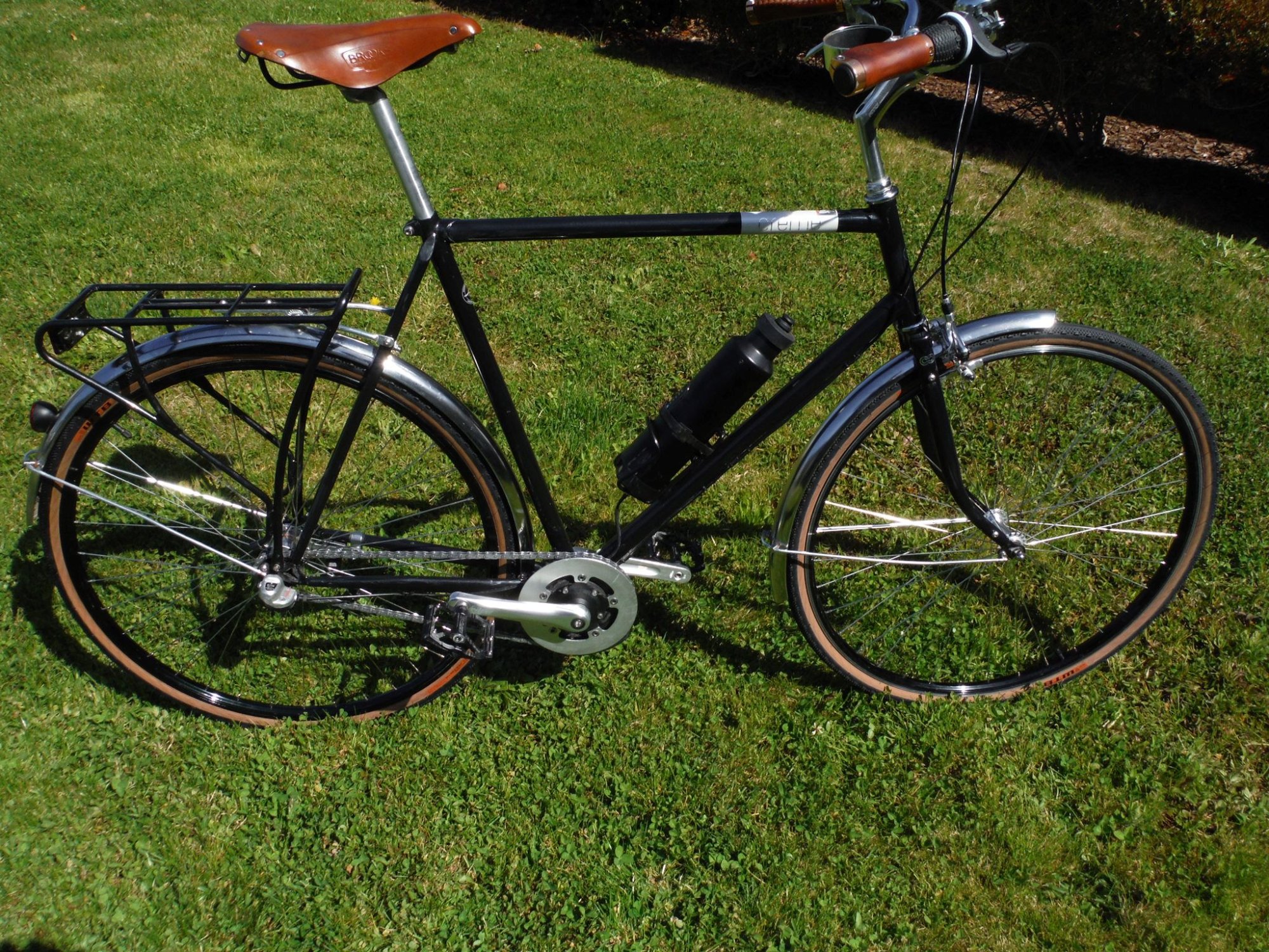

Dutch style bikes have a fork that extends way out and also a lot of space between the seat tube and the rear wheel. Road bikes do not. They are more like fighter planes than land yachts. One of my eBikes has a curved fork like you mention. It also has a coaster brake. The wire from the water bottle provides the mid-drive its juice. I gave a woman a beautiful custom classic Dutch mid-drive with an IGH. She gave it back and it sold yesterday to a Google engineer for $2300. Before restoration and conversion I had purchased it for $100. I love bikes with classic lines.

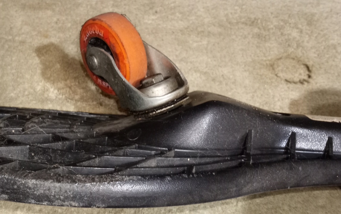

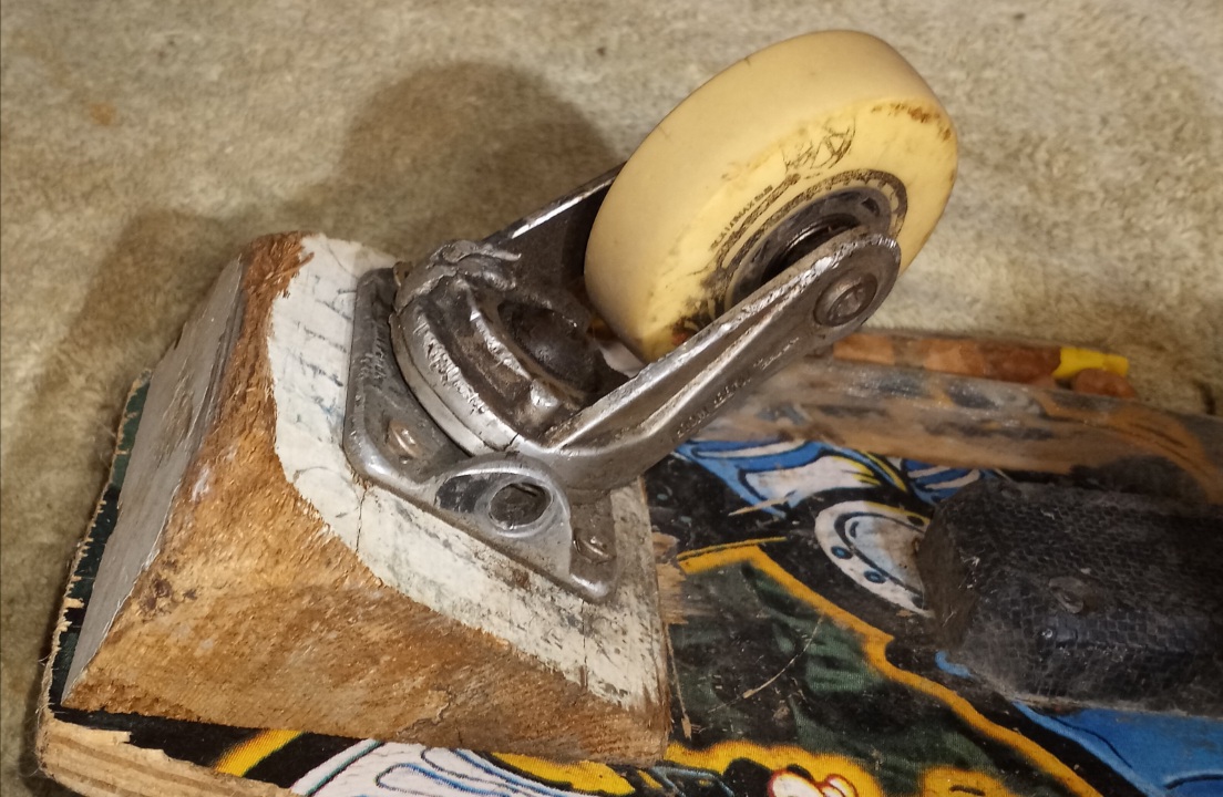

I used to smoke Vados and wobble around on my two-wheeled skateboards thinking about caster angles and such. 😂
The Ripstick is a two-wheeled skateboard that pivots in the middle.
The two wheels are on casters but the casters are mounted at an angle.
This is a similar Waveboard where the casters are mounted at a lesser angle than the Ripstick,..
It's pretty cool the way it works.
When the caster moves to either side, it pushs the board up which gets turned into forward motion if you have the front half of the board tipping one way while the back half tips the other and your wheels are casting about in the right way at the right time.
The Waveboard turned out to be slower with its shallow angle and the board had to swing way out with lots of lean to get going fast.
It was like being stuck in first gear on a bicycle and your cadence can't keep up.
So I made my own high speed caster angle ,..
I kept breaking stuff and had to weld my trucks back together a few times.
