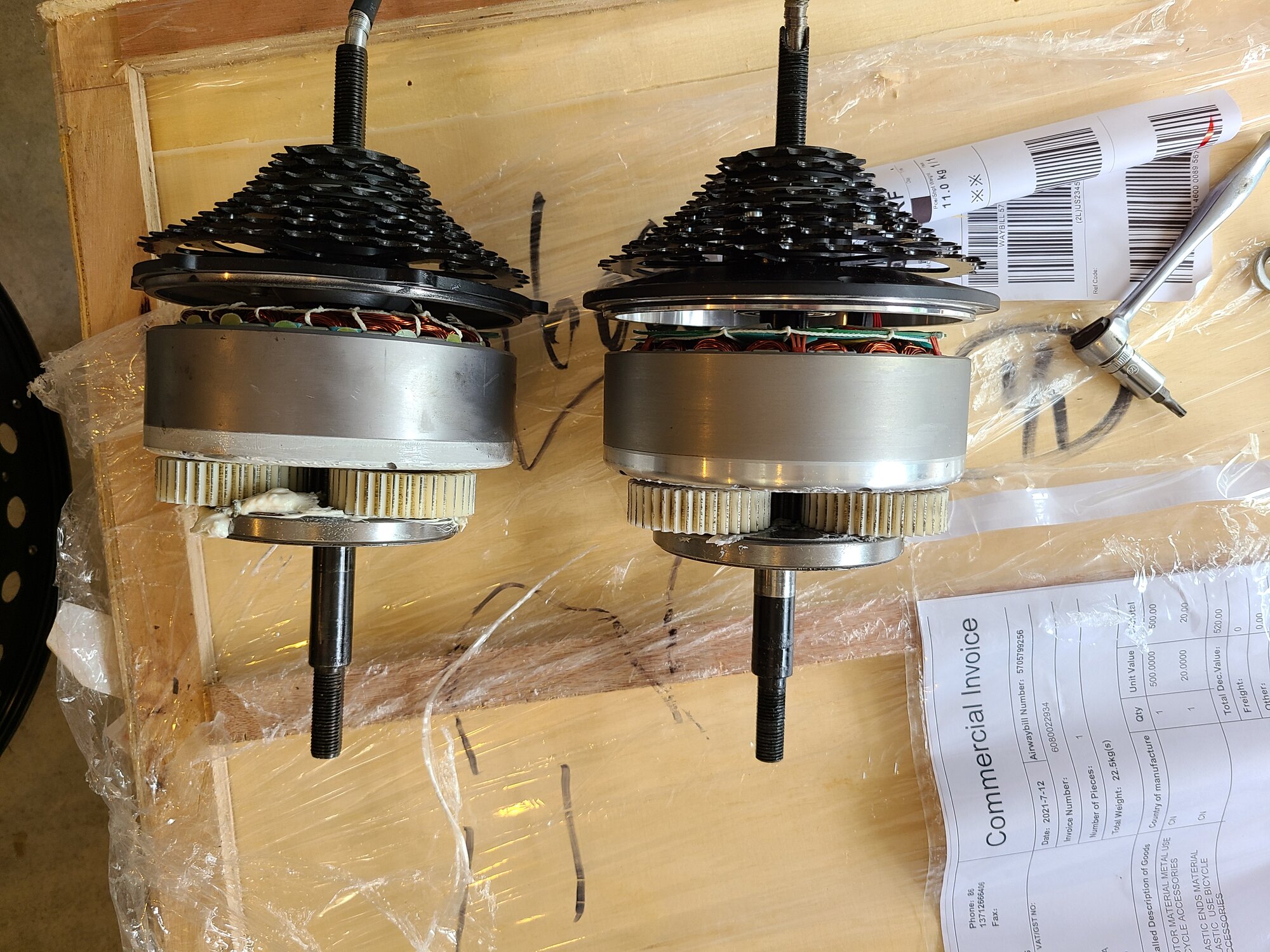

My wife's bike with new motor goes 28 mph on 22 diameter setting and matches my gps when testing. I'm 250 lbs. They just shipped the 2nd motor for my 2nd bike. Here's one thing I noticed different in the way I did it from you. I never removed the 8t sprockets from my motors. Left them on from swapping and wondering if the new motor has a slightly different one? Also, my new motor looked slightly bigger than old. I feel like they shipped you the old motor again. Here's a pic and you can see my new one(on right) is slightly bigger. I wish I would have weighed and measured it.

My wife's bike with new motor goes 28 mph on 22 diameter setting and matches my gps when testing. I'm 250 lbs. They just shipped the 2nd motor for my 2nd bike. Here's one thing I noticed different in the way I did it from you. I never removed the 8t sprockets from my motors. Left them on from swapping and wondering if the new motor has a slightly different one? Also, my new motor looked slightly bigger than old. I feel like they shipped you the old motor again. Here's a pic and you can see my new one(on right) is slightly bigger. I wish I would have weighed and measured it.View attachment 95579
I do see the slight differerence. I swapped the entire wheel and motor. May have to pull them apart and check them. Hope to get out and find a flat area big enough to do some video tomorrow so wolf can see.
