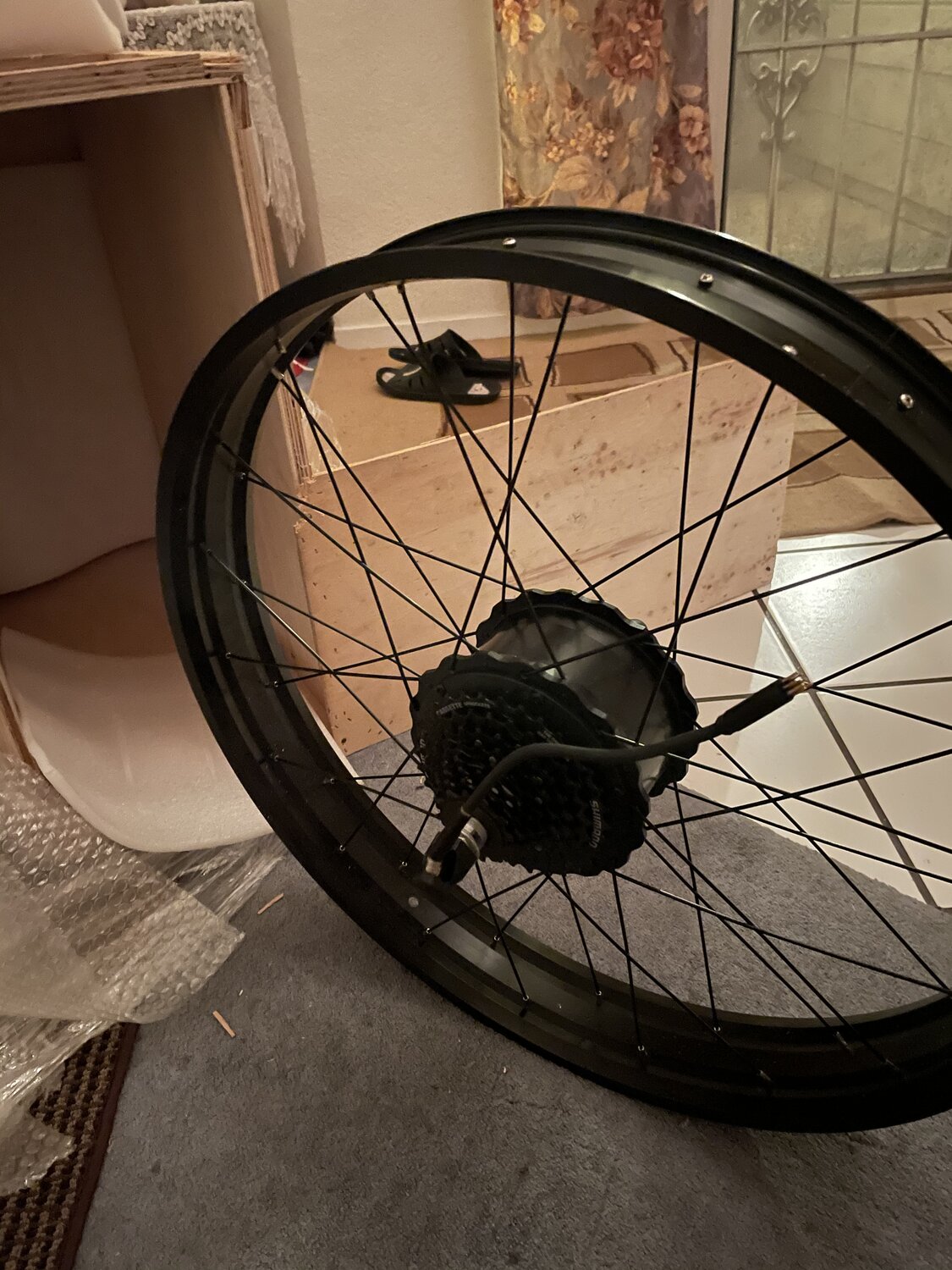

Haven’t opened it yet but wallke said it does come with the wheel plus the box is quite big.
If you can, please provide pictures of the unboxing and the printed label on the motor itself. I'm curious if it matches the ones already sent. Thanks.

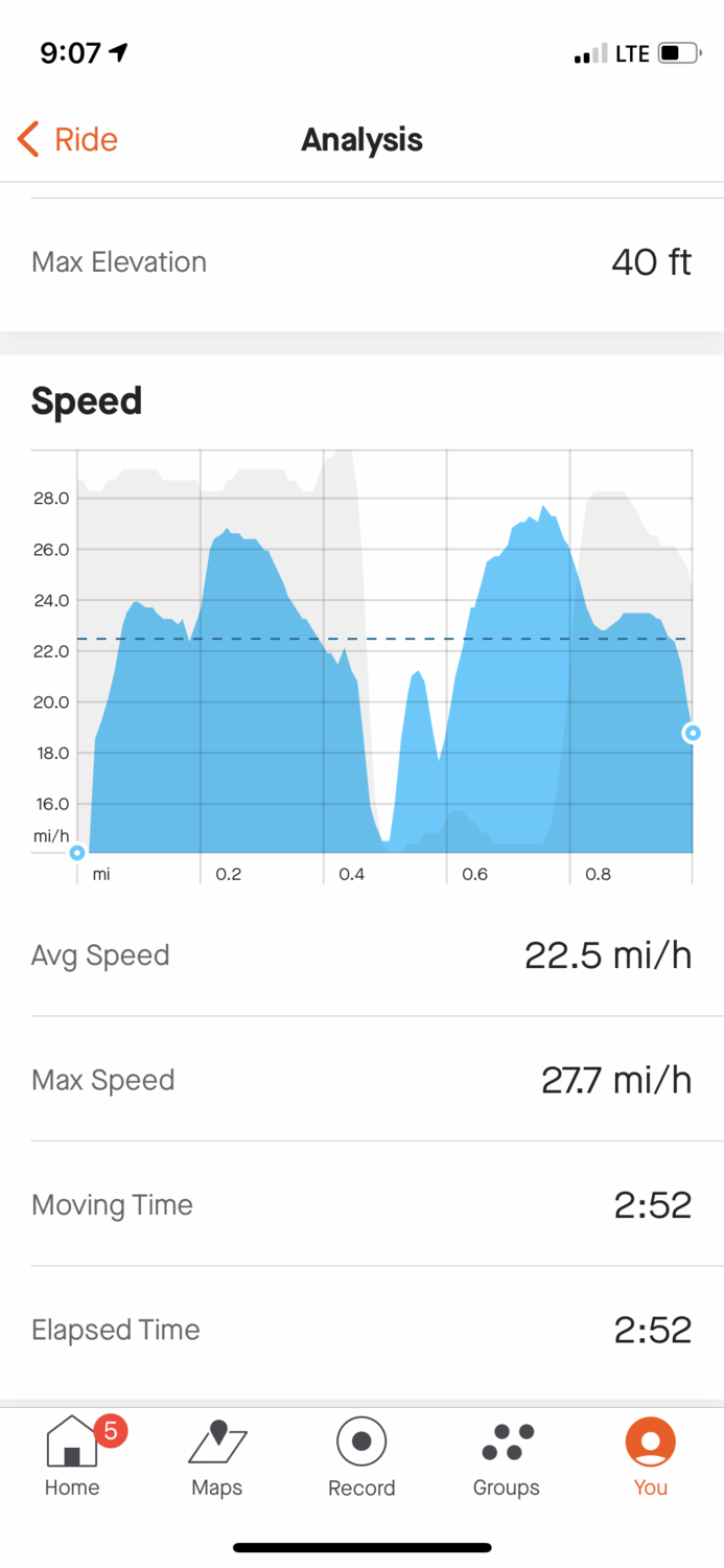

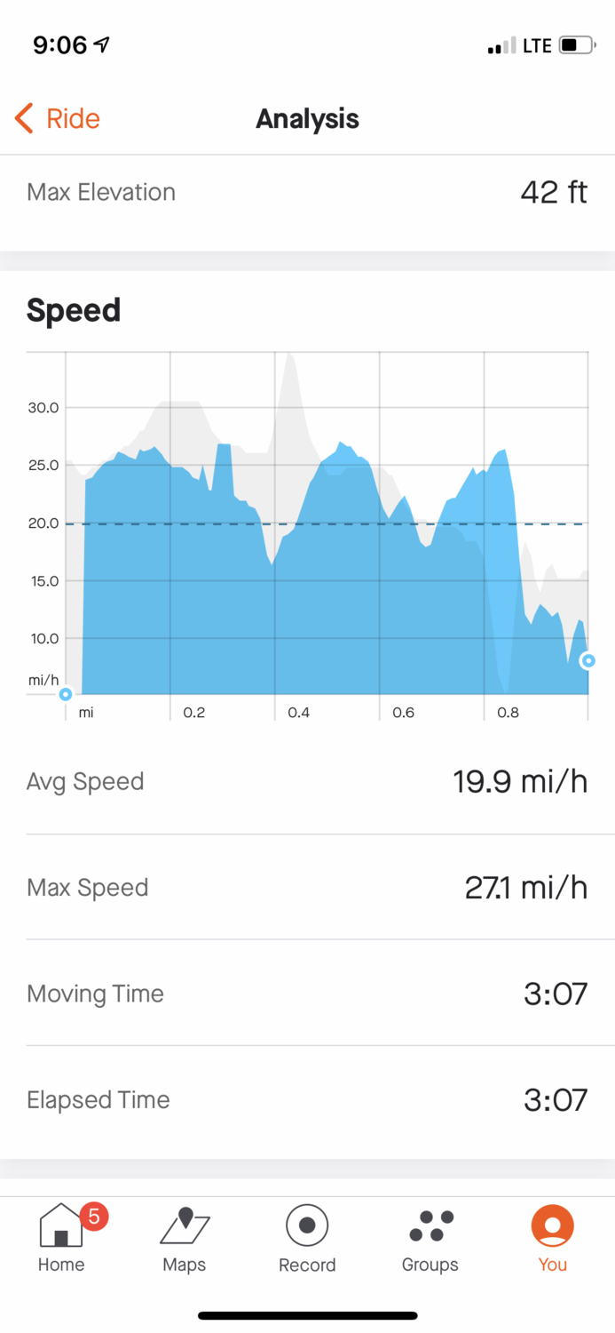

Update:
Ok I just installed this new motor and had a thorough test ride. It’s a weird one I have to say but the added power and speed were definitely noticeable. However, the display still doesn’t show the coasting speed and the speedometer is still way off, basically same as before.
What’s different this time around is that the speed isn’t capped at 30mph anymore (actual speed 22.5 mph). At one point, I was able to hit 40+mph on the display but it just happened one time. Top speed seems to be at 36-38 mph (28 mph on Strava). The funny thing is that it’ll only last for about 30 seconds and it’ll drop down to 30mph (22 mph on Strava) if you continue to peddle. But if you stop peddling for a split second and then you peddle hard again, it’ll let you have another 30 seconds of the top speed.
Edits: change your wheel size to 22 to fix the speedo and slow downs!!!
Yea it’s kinda weird but overall I’m not mad at it because I don’t like to cruise at top speed anyways and this new motor really does feel a lot more powerful. Though I do wish I could’ve requested what Slick Silver had asked for with the new controller so then I can have a correct speedometer reading as well. But oh well. I don’t think I want to spend anymore mental energy on this messup. Here are some screen shots

Update:
Ok I just installed this new motor and had a thorough test ride. It’s a weird one I have to say but the added power and speed were definitely noticeable. First, the display still doesn’t show the coasting speed and the speedometer is still way off, basically same as before.
Yea it’s kinda weird but overall I’m not mad at it because I don’t like to cruise at top speed anyways and this new motor really does feel a lot more powerful. Though I do wish I could’ve requested what Slick Silver had asked for with the new controller so then I can have a correct speedometer reading as well. But oh well. I don’t think I want to spend anymore mental energy on this messup. Here are some screen shots.View attachment 93573View attachment 93574
Try dropping the wheel size in the settings, to sync to your gps.
May help.
May help.
Good point. Maybe the speed is getting too high and it's throttling back? Using 22" tire size seems to put it close to real GPS speed.
thanks Curcutie for testing for us.
