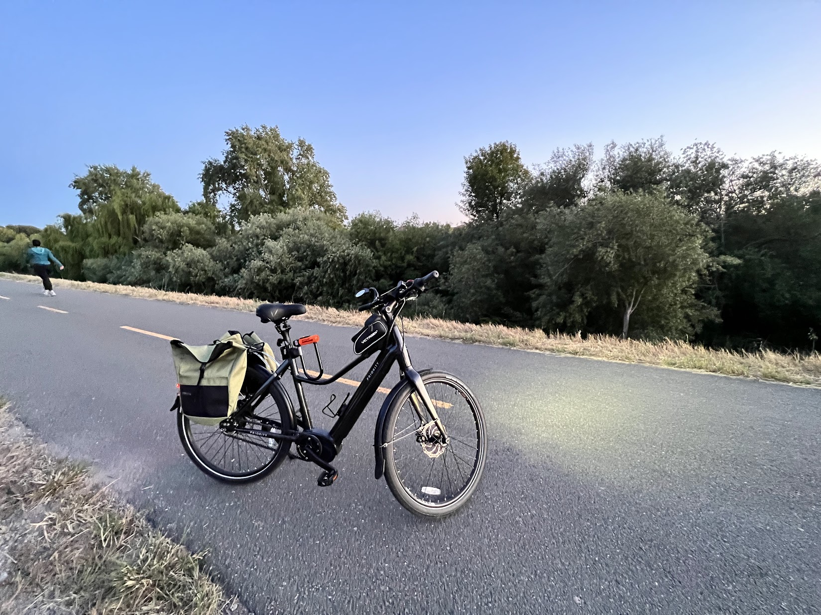

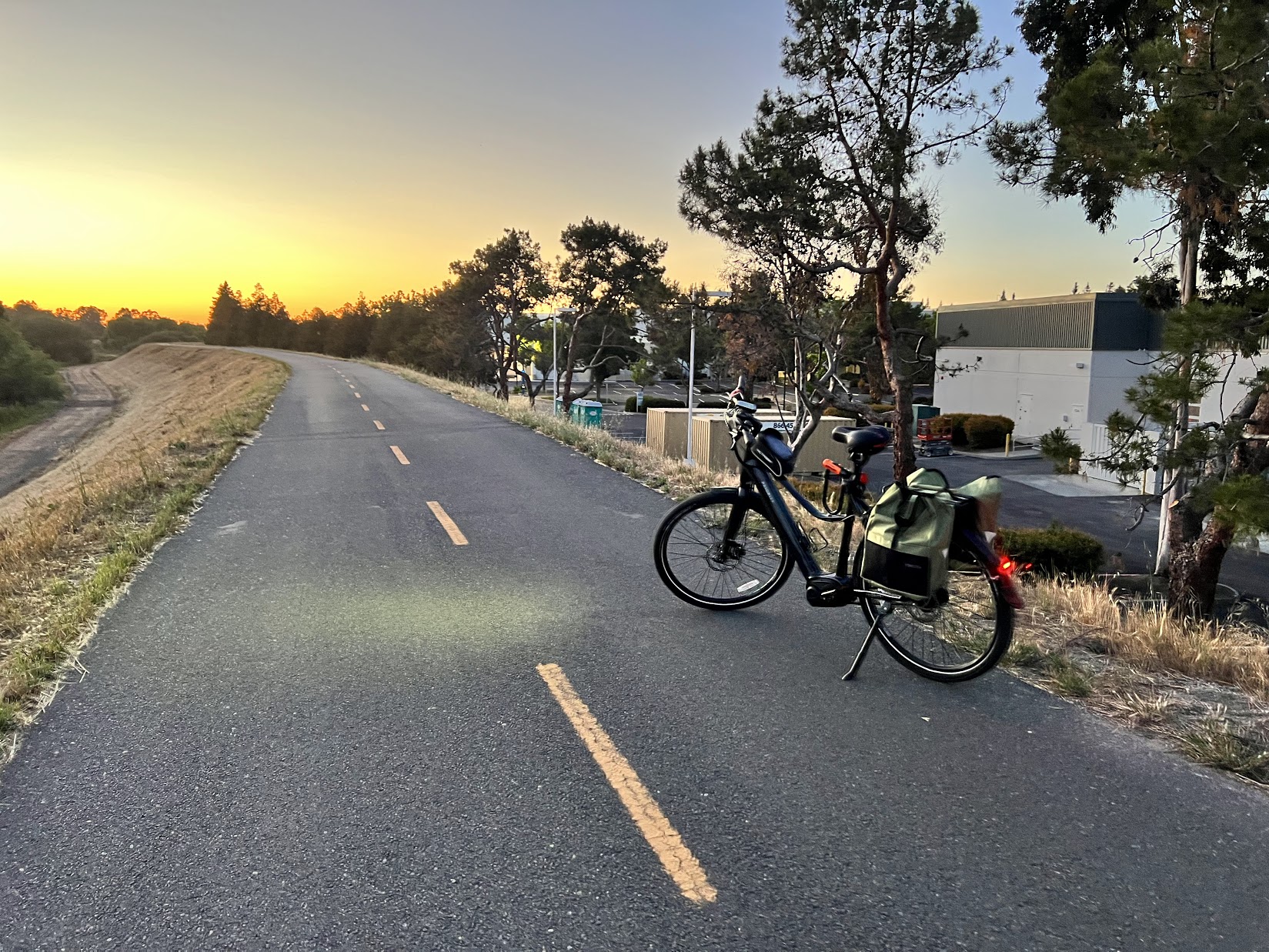

Some pics from sunset time on today's 5 mile grocery roundtrip to safeway. The panniers sure come in handy. I am running 50PSI, but with the seatpost, I am thinking of trying 60 now.

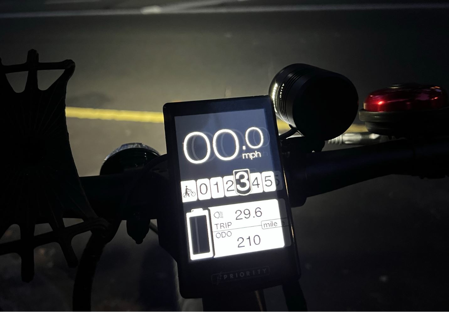

Okay now I have done more than 200 miles on the bike and also did a range test at level "3". I decided to stick to level "3" and run the battery down to blinking.
29.6 miles, with about 9 miles with lights on. From 1 bar to blinking it tool more than 6 miles. Looks like there is indeed some power reserve. After blinking started I was able to go 2 miles home without bike dying (headlights on)
So with level 3 level ground, you definitely have 30 miles of range, which is impressive. Level 3 allows me to pedal at 20 miles/hour without headwinds, but with the Bay area winds up nowadays, I do normally 16-18mph against the wind. The suspension seatpost was the best investment, and now I can ride for 1.5 hours without getting sore.
Level 2 is now my "exercise" level when I want to do 15 mile rides just for fun. Aim to go to level "1" once I build up stamina.
No more battery tests now though. I intend to charge the bike when I see 4 bars on the display.
