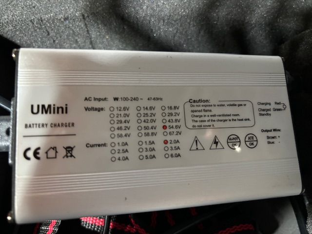

This might help. It is the charger with description.
This is what Bafang gave?

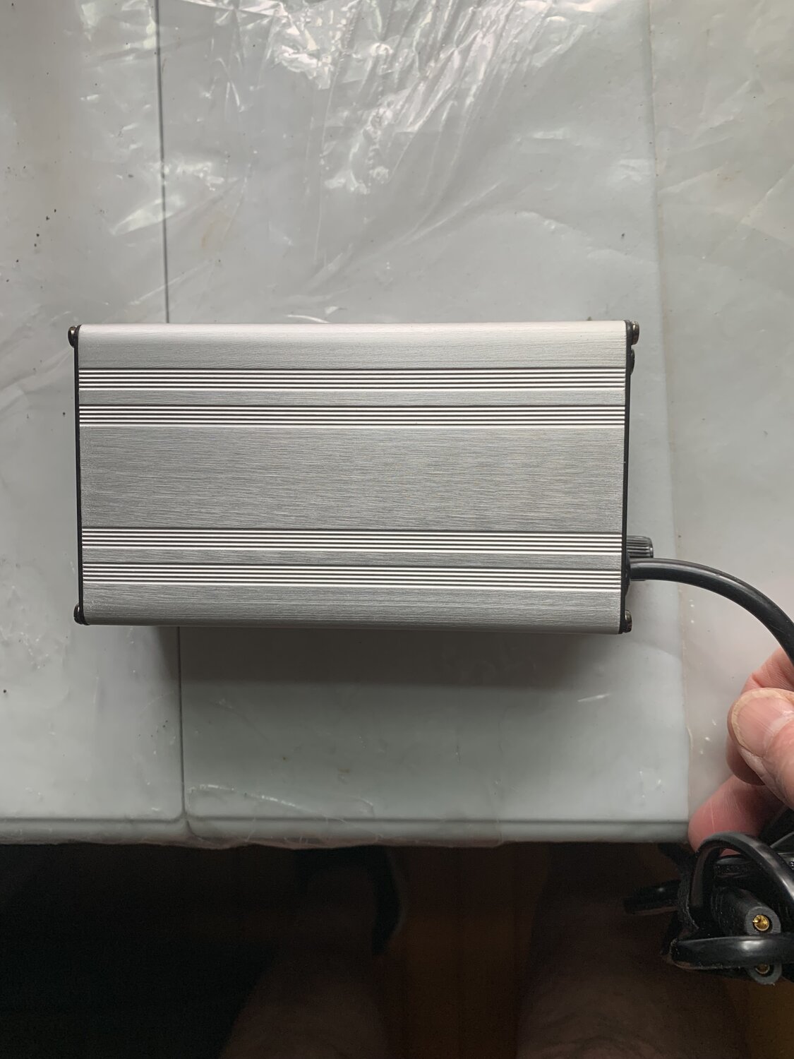

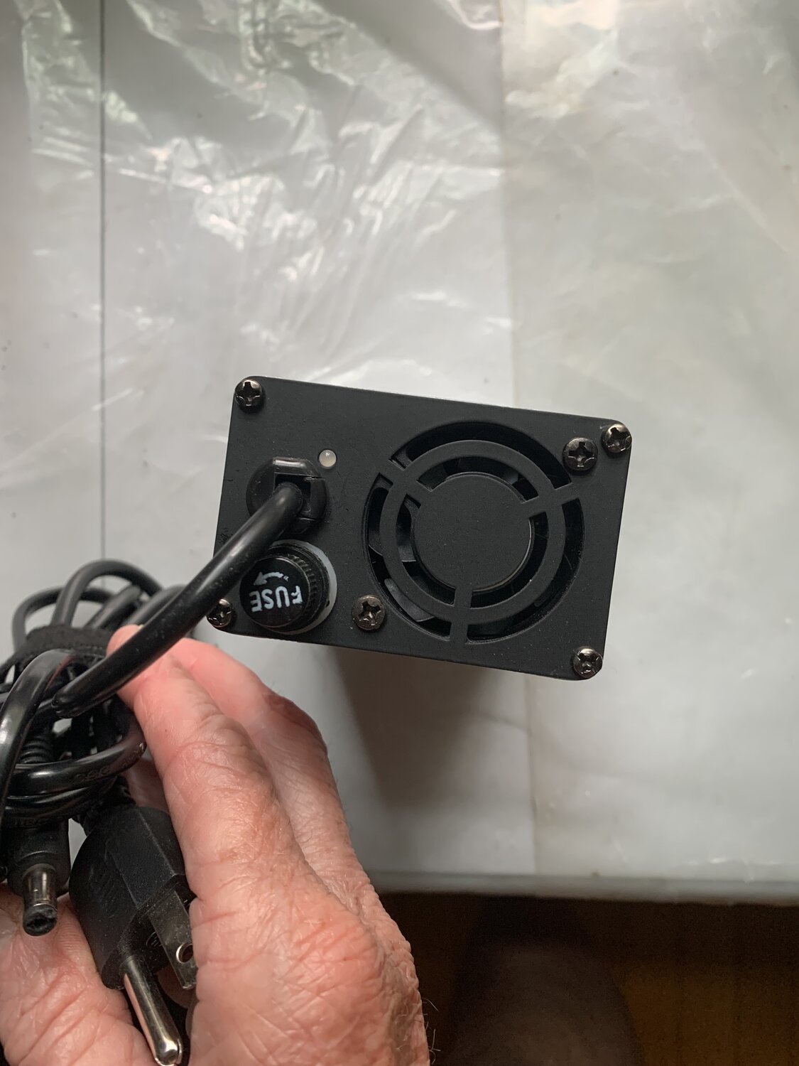

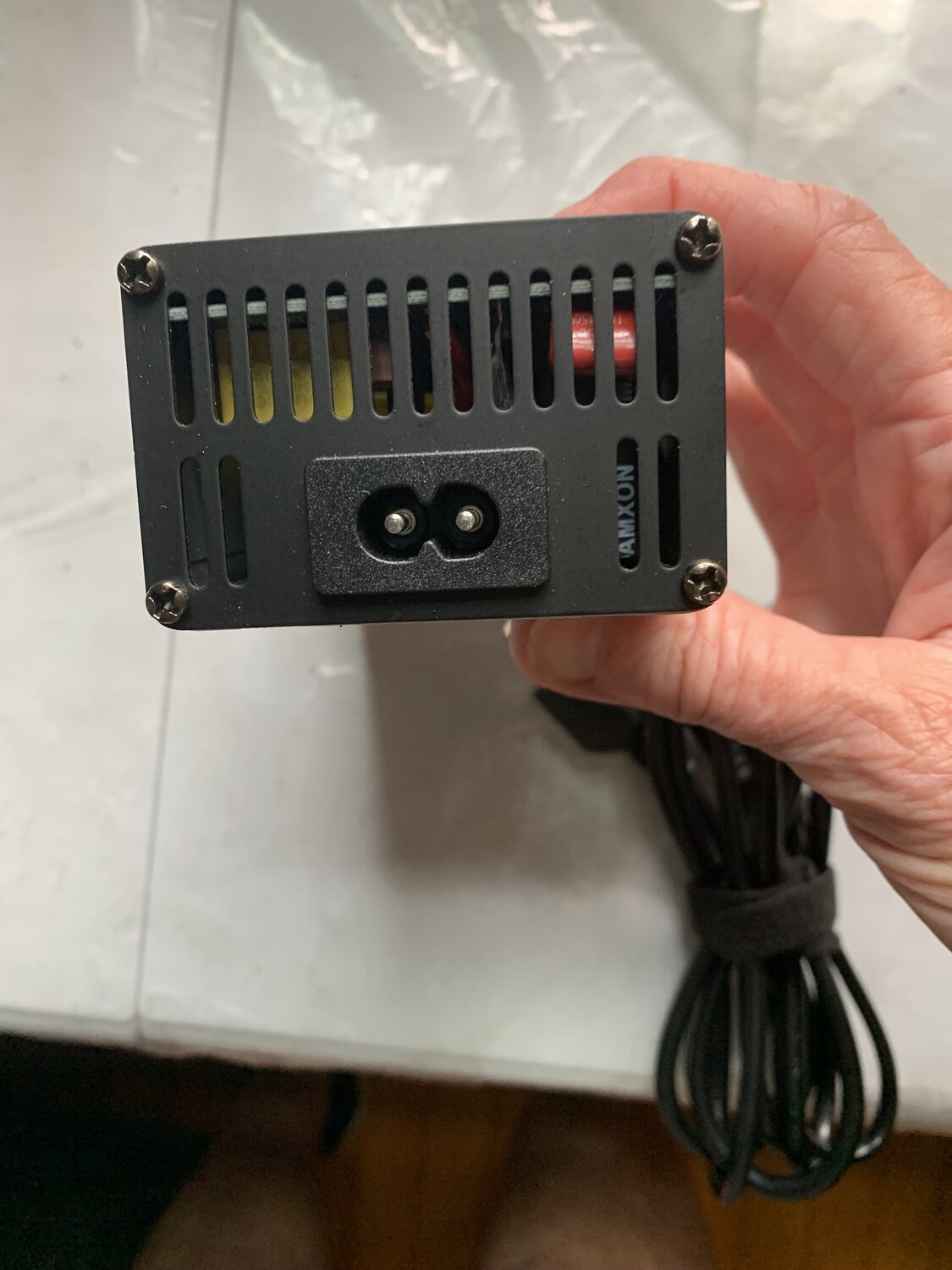

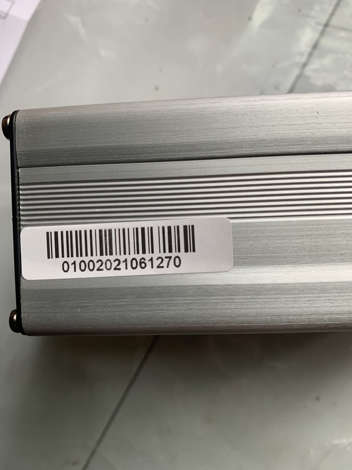

Can you take a photo of any other markings on the other side of the charger?
All the markings in the photo sent are self-declared and not issued by an independent 3rd party. If there is no safety certification of the charger, recommend that you do not use it.
Sorry, that is what we got from bafang.
