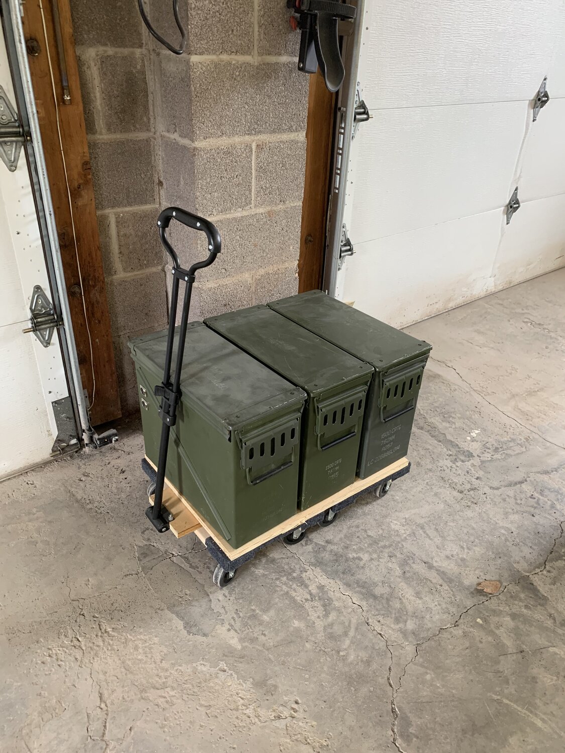

I did something similar. I got a truck bed tool box and mounted wheels to the bottom. It sits outside and is weather proof. I have a heavy duty power strip mounted inside with the cord going out through a grommeted hole in the back.I store & charge in ammo cans on a cart under a smoke detector using a timer and always supervised.
Should the smoke detector go off, I'm hoping I have enough time to push or pull the cart outside with a garden rake.

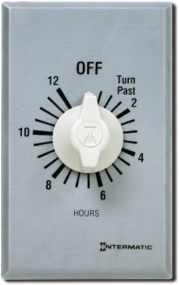

I use this mechanical DPDT twist timer
It's a double pole switch which disconnects AC from the charger as well as DC from the battery to avoid backward discharge. That way, the charger and battery are both isolated.
I don't trust electronic timers. I've had issues in the past with unexpected results caused by the frequent power outages, blips & surges we get here.
