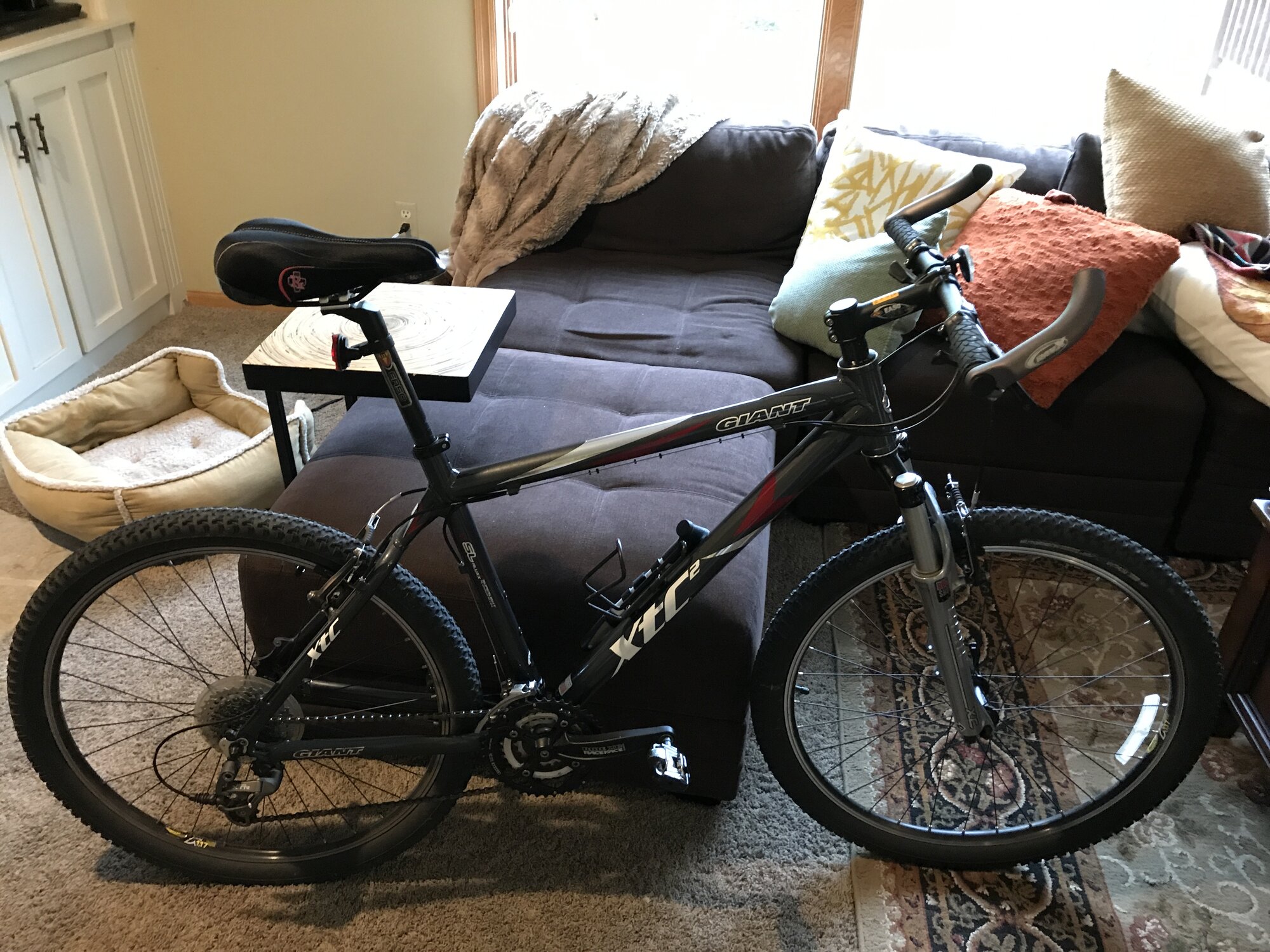

Damn, that is a nice bike Nomad! I don't think I saw that earlier--and owning a Giant XTC hardtail it is definitely worth a look. Will be tricky to find a local store with one but will be on the lookout as this could be an option. Thanks for the link.

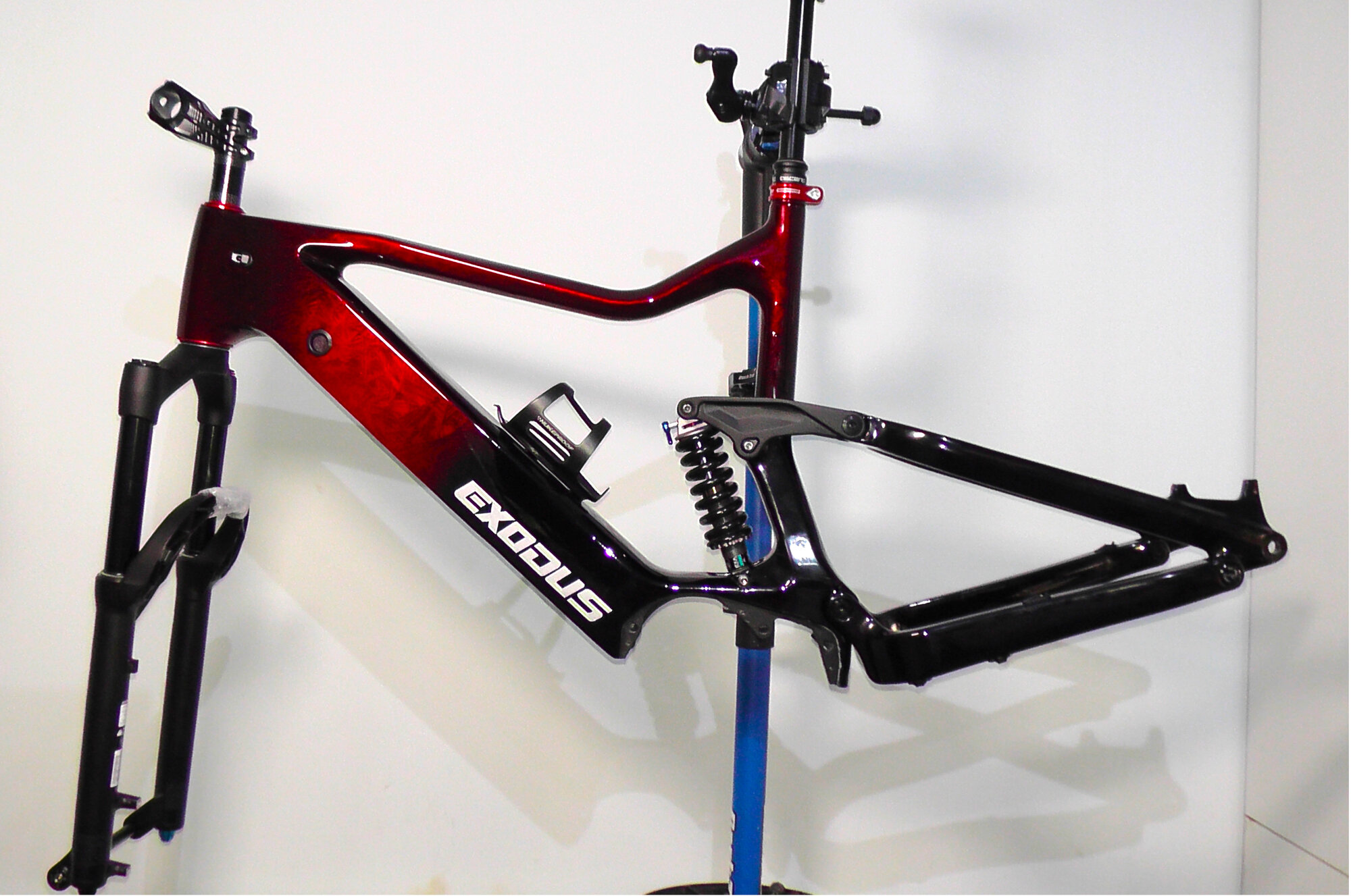

This is my E06, which is the same front triangle as the E05.
Despite what the hater may say these are serious EMTBs and if you choose the DIY route 100% custom and unique.
You should also ask about the E22 which is an updated version of the E10 (Hydra frame) which can have M600, M800, M620 or Shimano mount.
If there's anything you want to know just ask and if there is no answer here try emtbforums.
