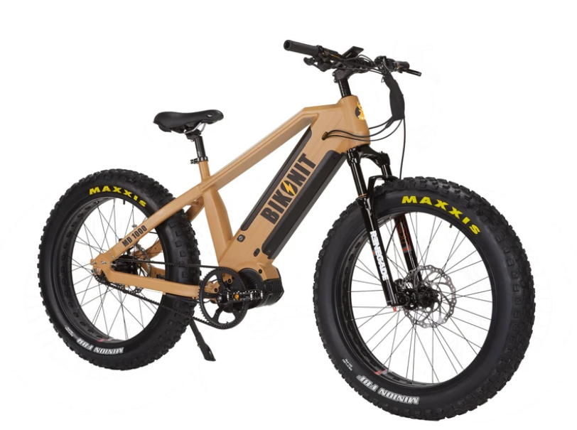

Check out this bad-boy:
80 lb monster no rear suspension 5 grand no thanks. The tires look like they weight 20 lbs apiece!
I see that there is a MD-750 ebike that shows the Bafang G510 750W motor. There is the same bike called the MD-1000 which also shows the Bafang G510 motor but claims it is 1000 watts.
Question: is the difference in the controller/programming or is there a difference physically with the 750W vs. the 1000W Bafang G510?
I think it's 80lbs because of the dual batteries. I've changed the tires on my fatty, and was surprised they were as light as they are.
