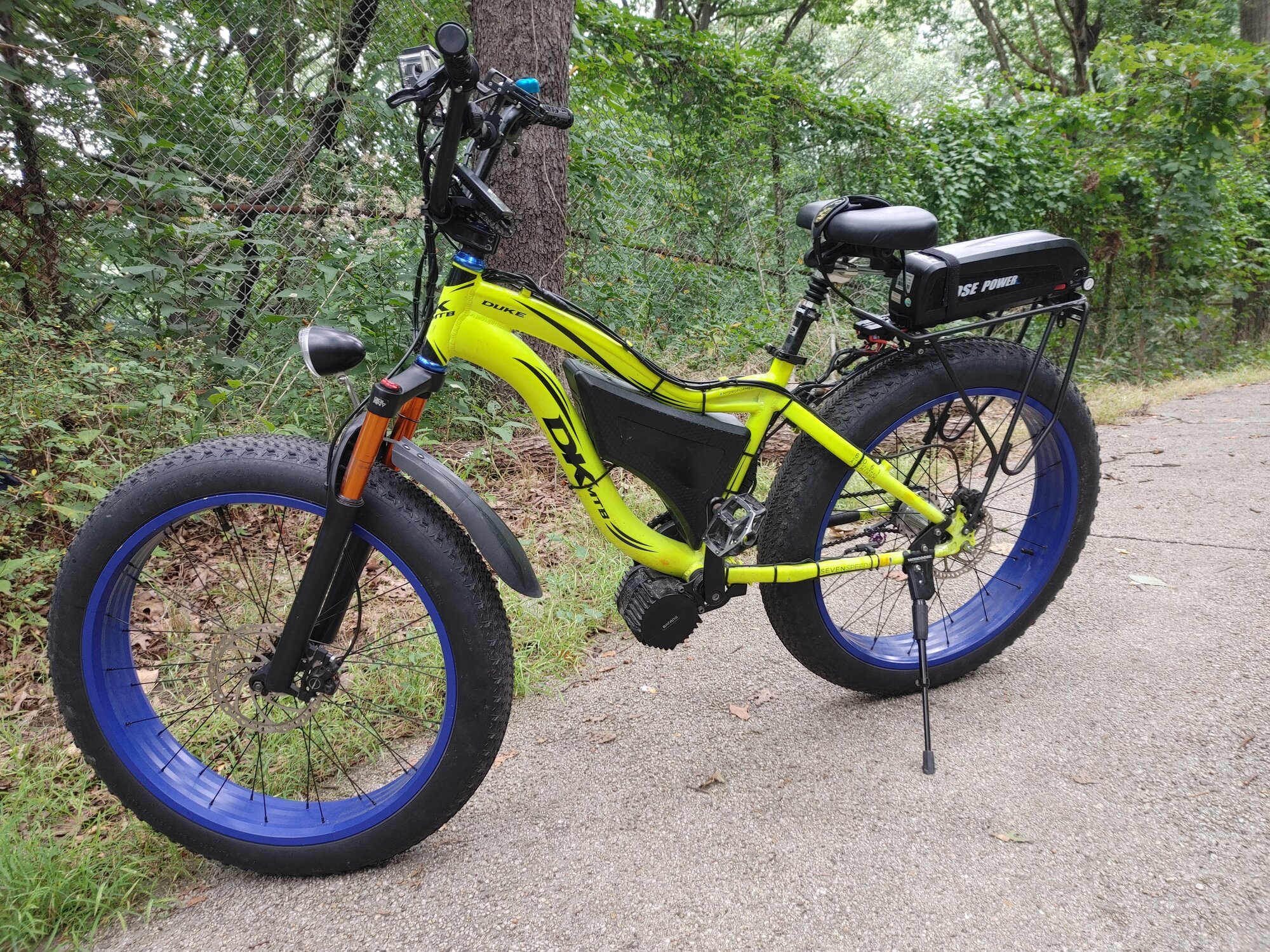

My posting ID picture is a DK Bicycle with the BBSHD on it .

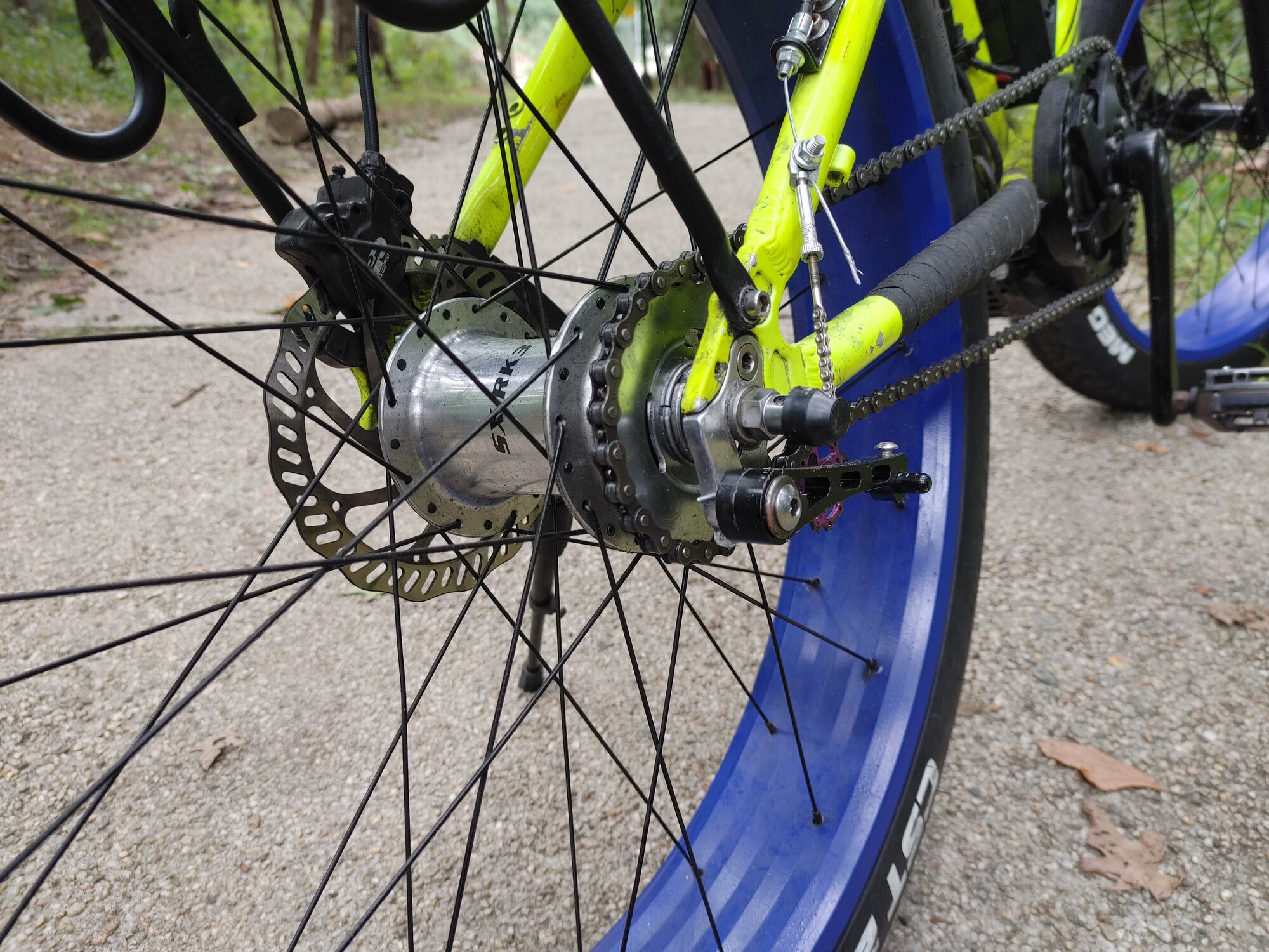

The bike is about 8 years old now and I installedf the BBSHD about 4 years ago and I still have the original nylon gear in it and over 5000 miles on it . I have went through rear gears and decided to switch to the Sturmey Archer SX-RK3 because i was wearing out rear cassettes every 3 months or so I ride about 50-70 miles a day and I still love it .
Its setup with Dual battery's now and I can go for much longer distances right around 160 miles I tested once and when got home had 8% battery left. Here are the specs of the whole bike.
Sturmey-Archer Internal Gear Hub 3-Speed Cogs 18t x 1/8" 3-Spline (Dished Stock)
Sturmey-Archer SLS30 R3T 3spd Thumb Shifter 45263-105179
Sturmey-Archer SX-RK3 170mm Disc Hub
DK-Bicycle
BBSHD--30 tooth narrow/wide and 24 tooth on Sturmey Archer SX-RK3
3 Speed 31mph no load 28mph with me riding
Battery samsung 48V 17ah & yose power 48V 12.5ah ( dual battery setup using Watt wagon Micro Chip)
TekTro HD-500 Hose Length Front: 900 mm / Rear: 1500 mm
Sunlite Seatpost Shim 27.2 Id 30.2 Od Alloy
EVO Cushy Suspension seatpost Travel: 40mm 27.2mm
Easy Seat II

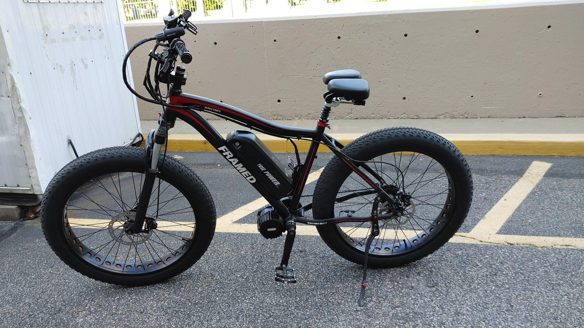

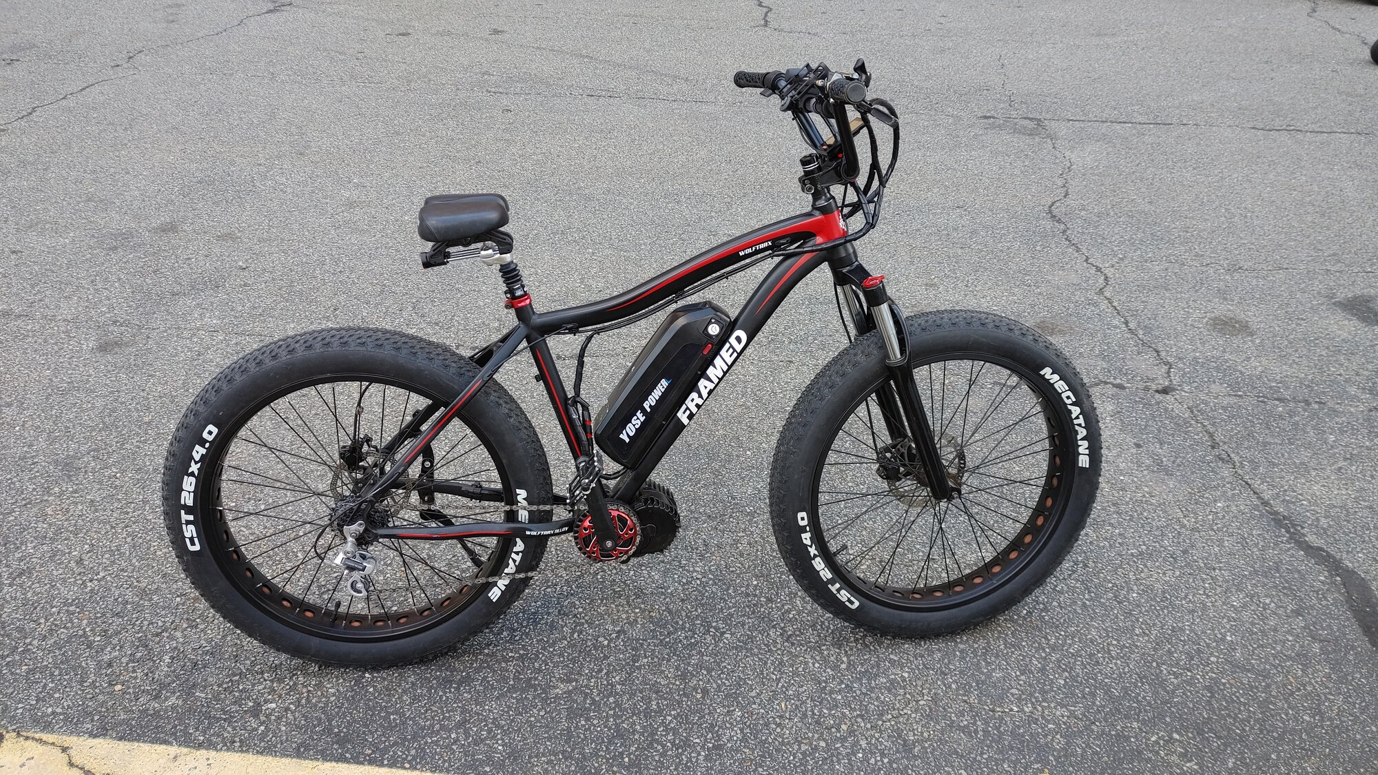

I have a Framed wolftrax 3.0 I just built with the BBSHD but the hall sensors are giving me problem when its rains or high humidity so i have to take it apart and re solider the hall sensor board this is what i have read is the problem with mine.
But since i will have this BBSHD off the Framed bike I am thinking about trying the CYC stealth X1 on the bike .
Do you know any one that has this cyc kit and if so how good is it all i have heard its much noisier than the bafang motors

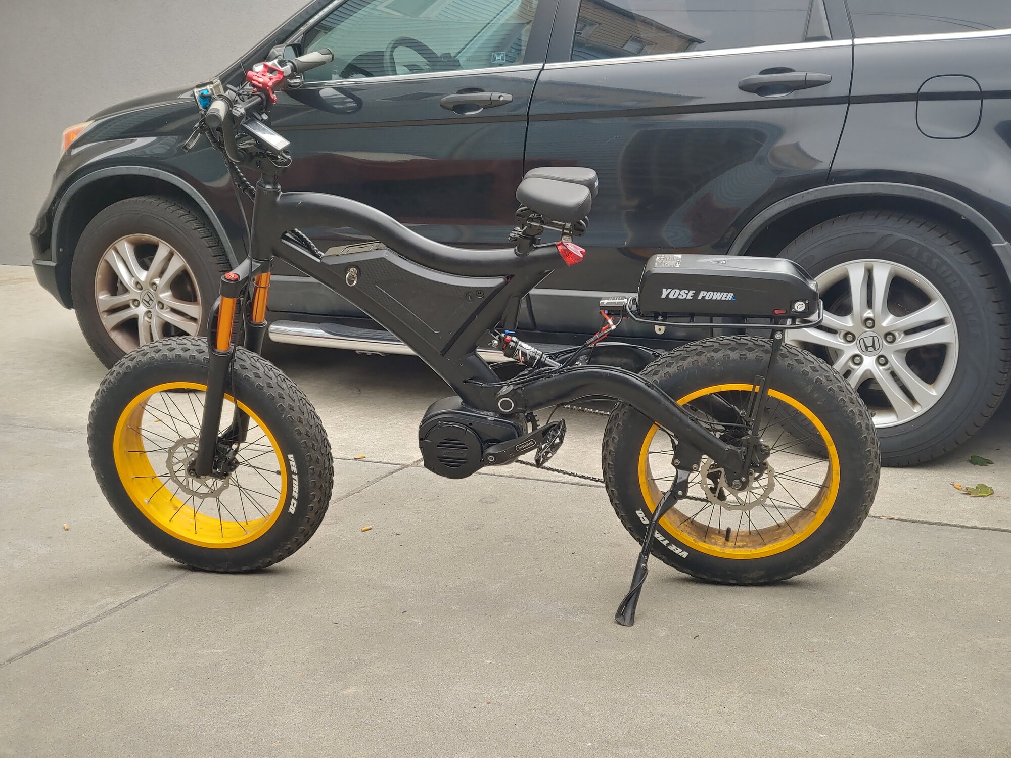

here are all 3 of my bikes 2 BBSHD 1 Ultra G510
