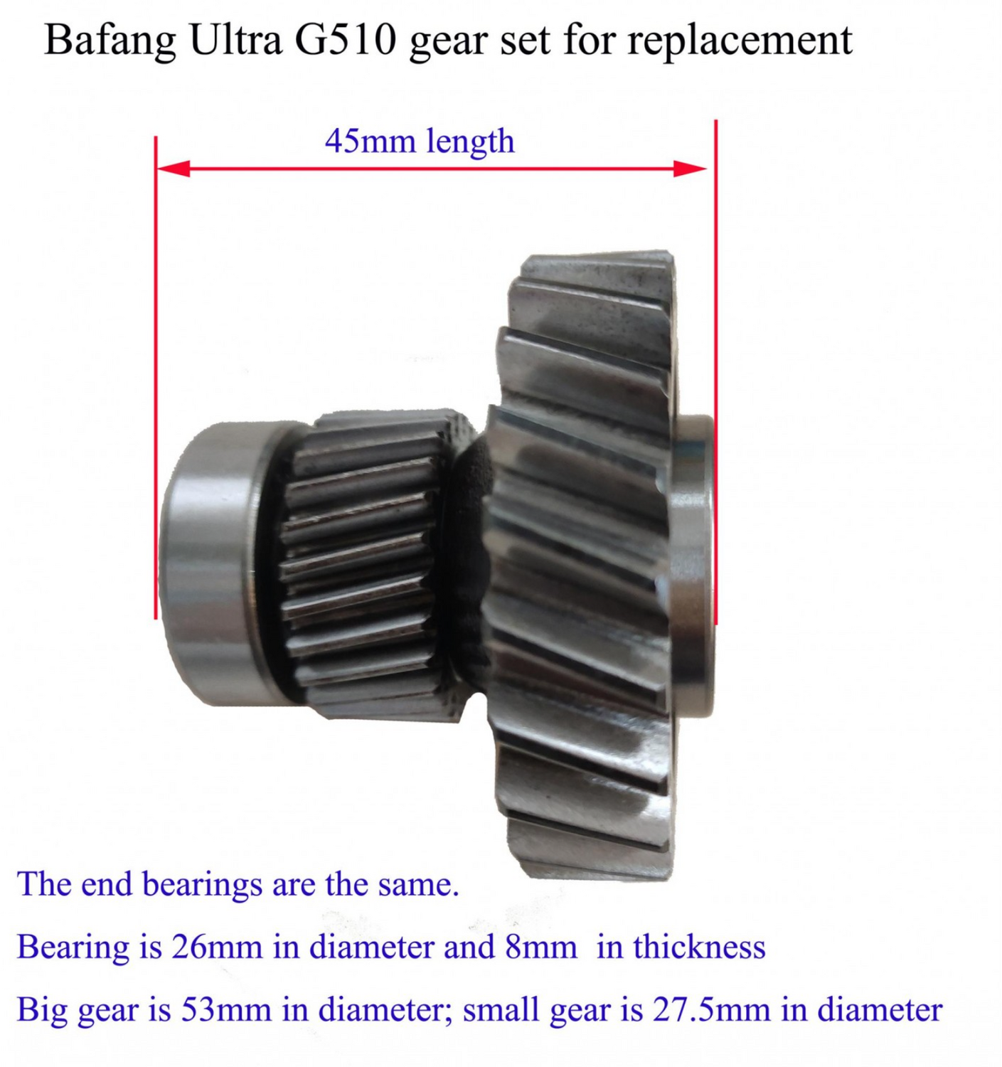

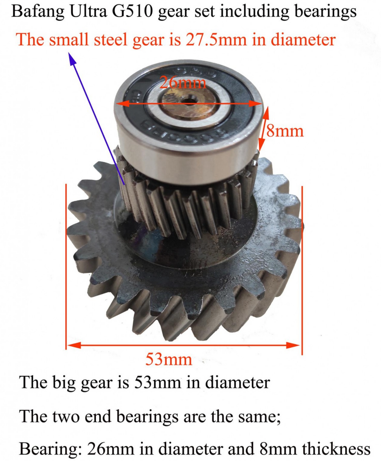

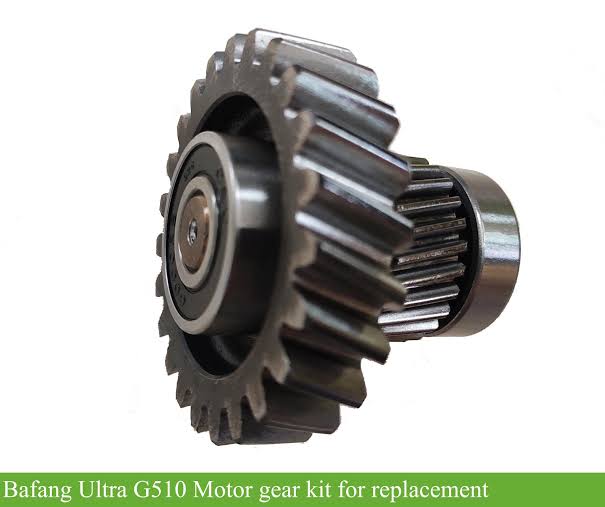

Can someone please post pictures of the required gear? In the oil and gas industry PEEK is widely used as seat material so it's readily available as rod material.
Is it the larger gear of this kit?
Yeah that is the one, since both gears come into contact with metal you would need to do them both to really make it silient, Bafang used to use a nylon gear on the bigger one but it's metal now, I think Luna was killing them when they first came out so they went to all metal.
Anyways I know a guy who has all the tools to machine these, I have reached out to see if he could maybe make a prototype.
If he can I will need to get a real sample first, then sourcing the best raw PEEK material, but it's not cheap look at this
