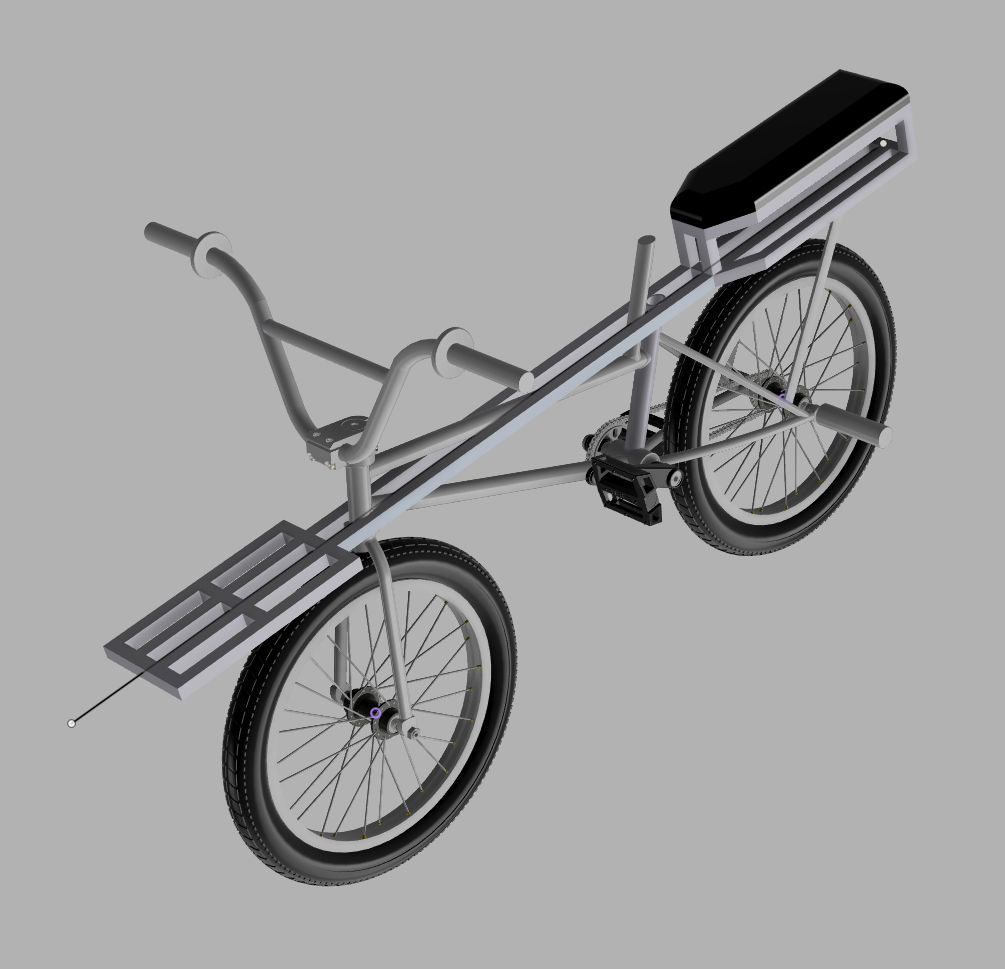

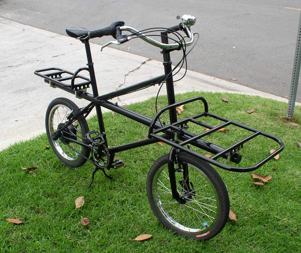

- diy: i've been workshopping this frame design with a friend, we want to convert a BMX into a mini cargo bike. it started out as a silly project but the more i think on it the more i think it could work. we've both done e bike conversions before so we have experience with that, and i have experience welding. i'm just not sure if it would be worth giving up the marginal support you get from a company like Rad and the potential headache from insurance if i try to file a claim on a very expensive hunk of steel that someone in Amsterdam decided to take. i'll include pictures of the early design, and the bike i saw that inspired me.
any suggestions would be appreciated, i know this isn't a completely new question but after spending a few hours searching on the forum i still can't seem to make up my mind :)

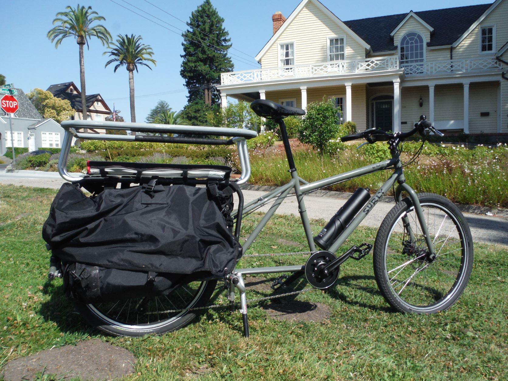

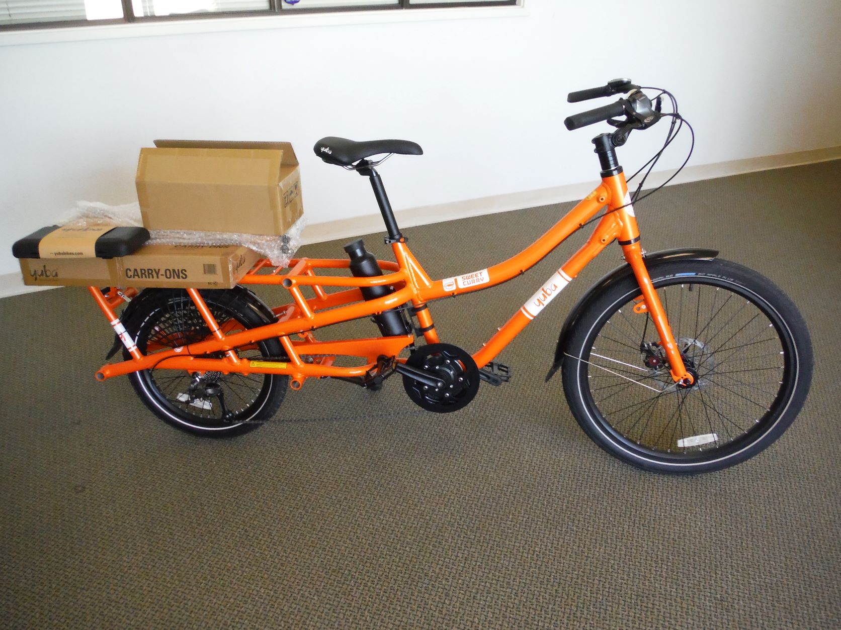

I personally ride a Yuba Spicy Curry AT with the Bosch Cargo Line motor. I like it a lot, usually carrying heavy photographic equipment with me. I would not hesitate to carry a passenger on it. However, Yuba is as expensive as Tern.

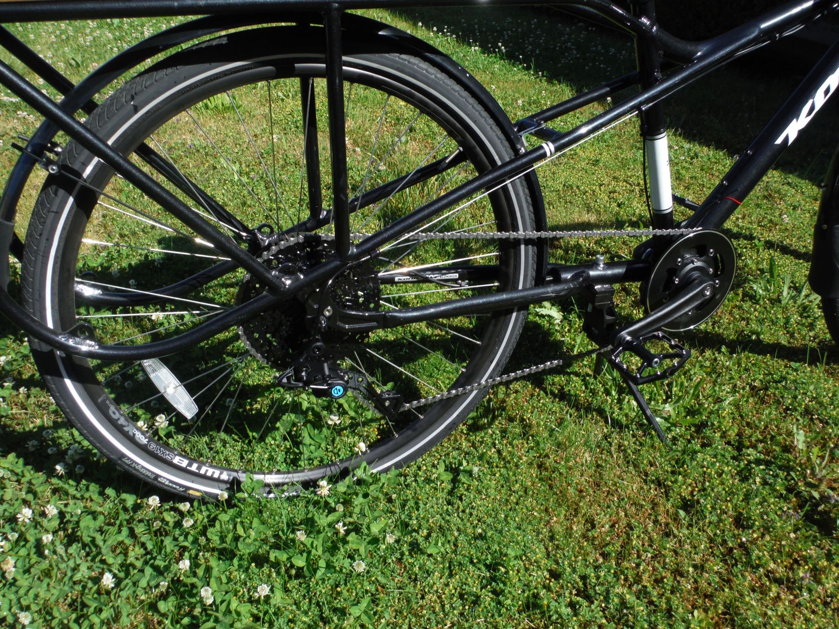

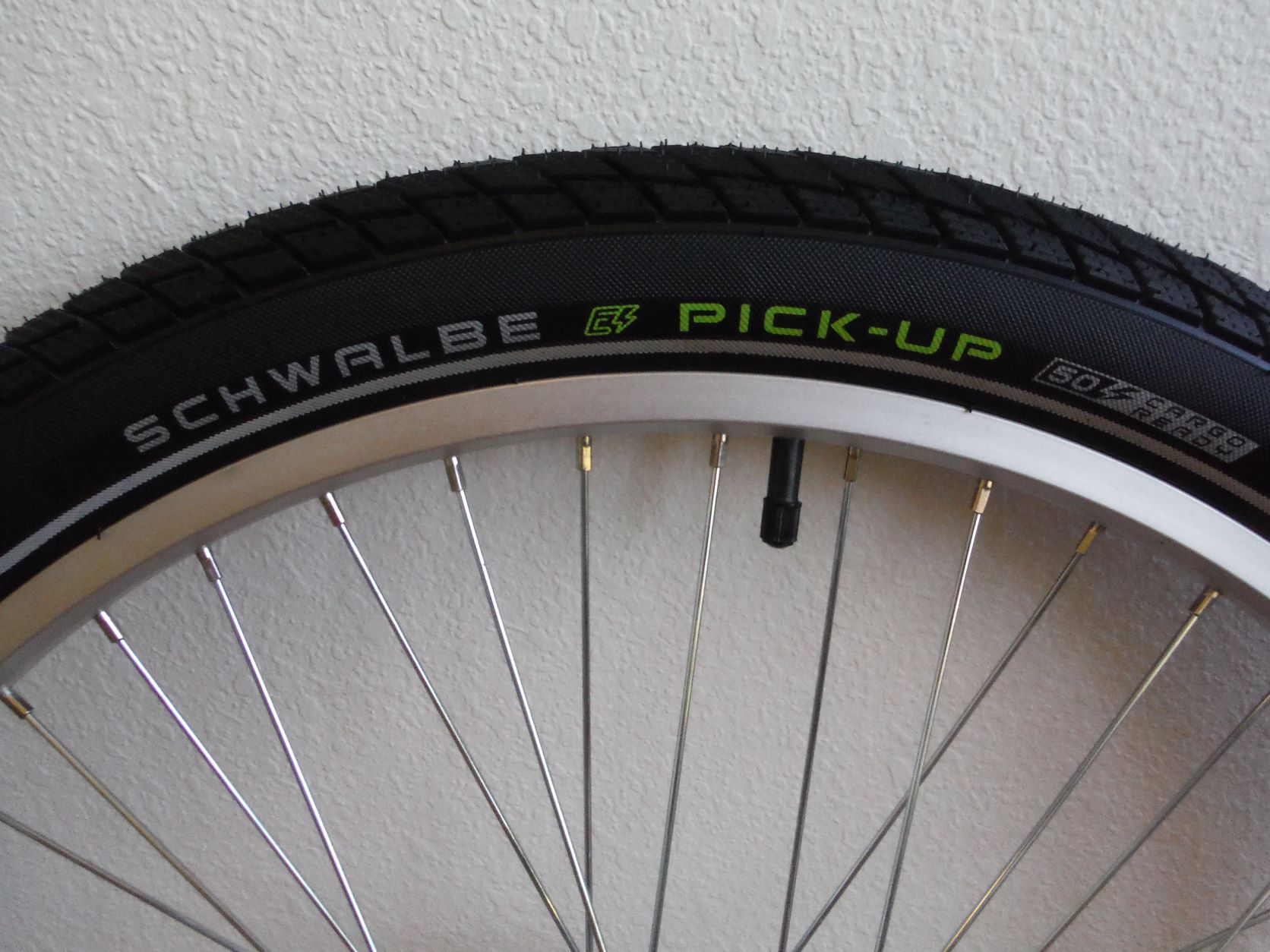

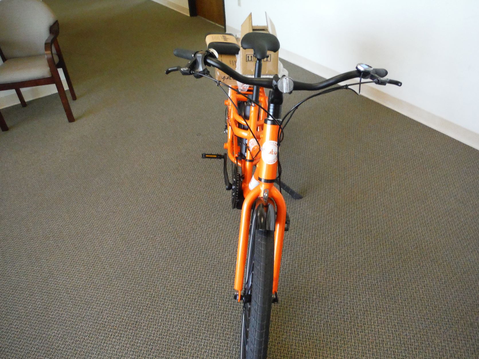

With the help of a friend, I just sold this one. It will be used to take two kids to school and shopping. It will also have a removable infant to four-year-old seat for a little one. The cassette is 11-46 and it has 90Nm.

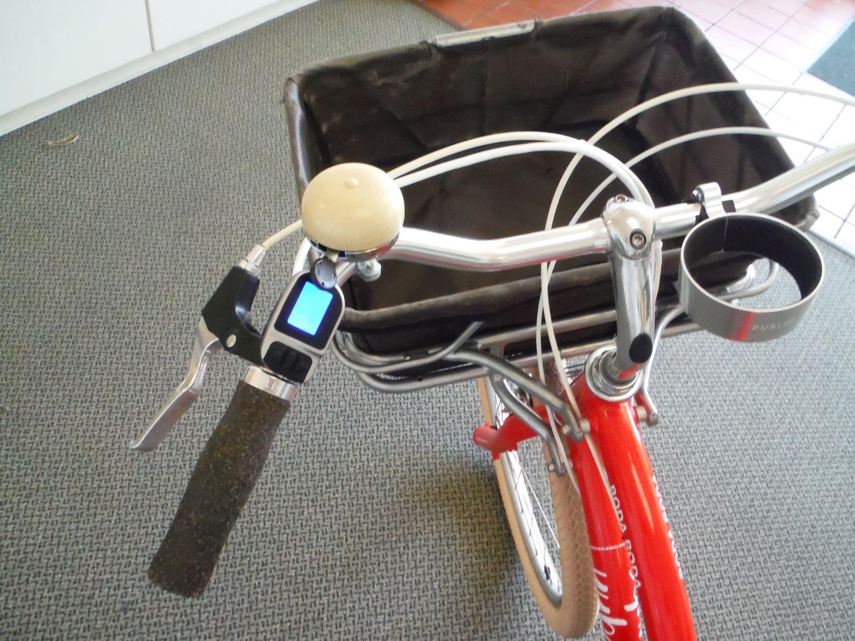

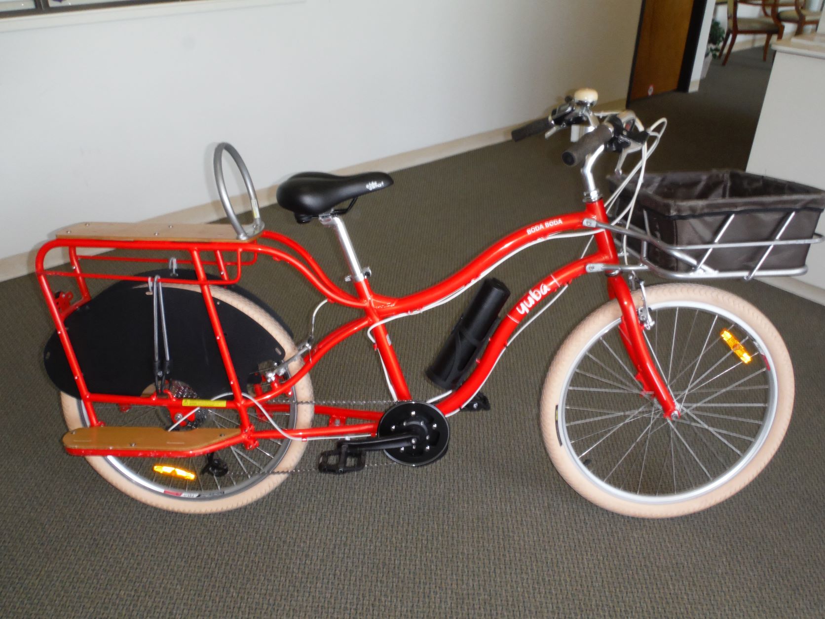

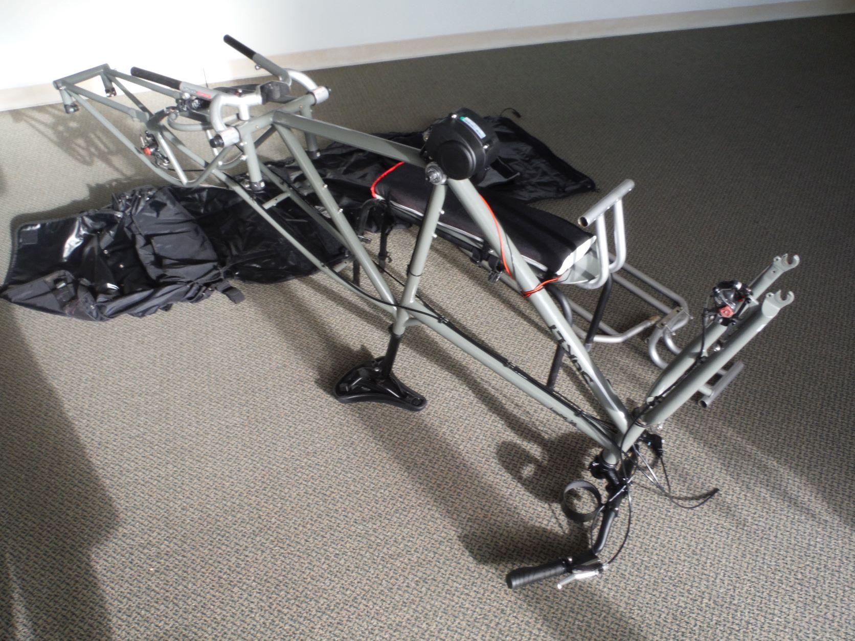

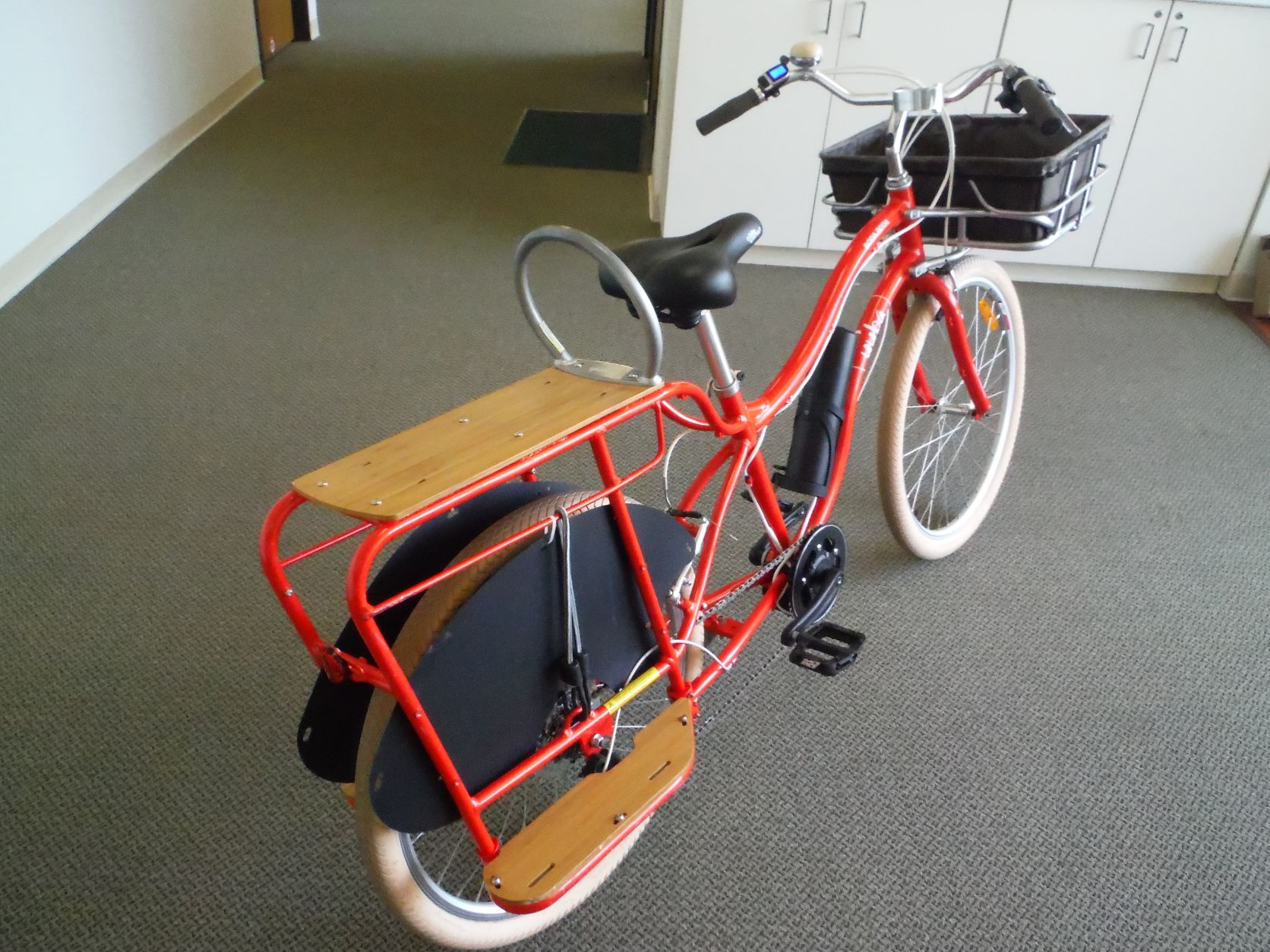

I really like the Yuba Boda Boda's characteristics. Dutch riding position, light aluminum frame, mid-step, mid-sized. I do not know if anything like it is available in Europe. It is also curvey. Here is one with a 90Nm 750W motor. This one has an optional ring for a passenger. The person who commissioned it has a wife that crushes regular wheels. Here in California we use the term 'taco,' as in she tacos wheels. His strategy worked. The bike got her away from the TV, couch and refrigerator for hours each day. The front basket holds 24 bottles of beer in case you start to get thirsty on a long ride.
this is really nice. the Yuba lineup is a bit smaller in Europe and sadly there isn't a version of this available. i did notice that their non electric models are almost in the affordable range, and i think i could convert one for cheaper than a new tern or a spicy curry.

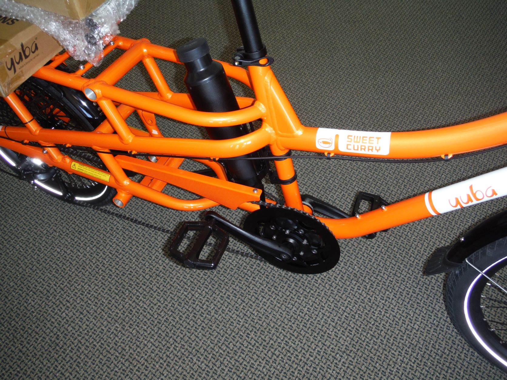

There are some that are less than useless because they have a obsolete and super heavy direct drive rear hub motor and a dead battery. No one can pedal it like that, let alone carry other people. Look locally for 'BionX Cargo' and you could find one. Then it is a matter of buying a cargo wheel and doing the mid-motor conversion. 36V, 350W is fine as long as you have a wide range of gears. Yuba was based in my town until they moved 700km last year to Southern California. I purchased a new Sweet Curry from an employee who got the employee discount. Then I made it Spicy. Now it lives on a hill in San Francisco. That bike had never been ridden.
The DIY design you showcased looks a lot like the Rodford Billy from a small frame builder in Bristol, UK. Like your idea the frame can accommodate a Bafang mid-drive.
i actually saw theirs in another post on here! yea the frame design seems to be a super common sort of diy build, which is why i wanted to take a crack at it as it's seemed to work out well for other people. there's an instructables somewhere from some guy in Haiti who made one out of a kids bike and some scrap metal and then used it to make deliveries.

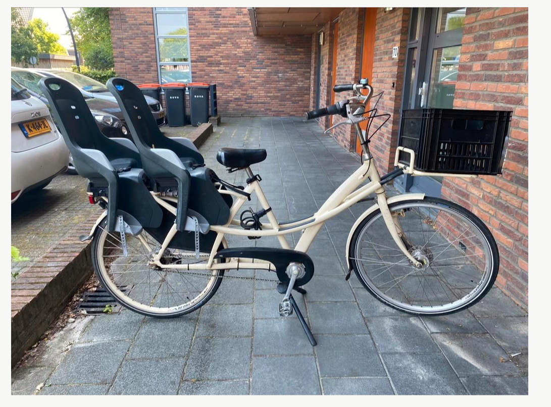

i came across this style of bike which is readily available here called a tweelingfiets. it's simply a bike for carrying multiple children but seems to be more popular here than mid or even long tail cargo bikes. the only thing i don't like is that they usually have 26" or 28" wheels which would probably be a bit sketchy stability wise. they usually have 3 or 5 speed nexus IGHs which is nice, and drum brakes which i'm not super experienced with but from talking to people here it seems like they perform fine under heavy load. i'm assuming the frame geometry could accommodate 1 small adult on the rack if it was designed to safely carry multiple children? a full mid drive conversion on one of these would be around 1500 (the used bikes go for between 250 and 400), whereas converting a new yuba would put me out 2300 (not including the IGH upgrade).
