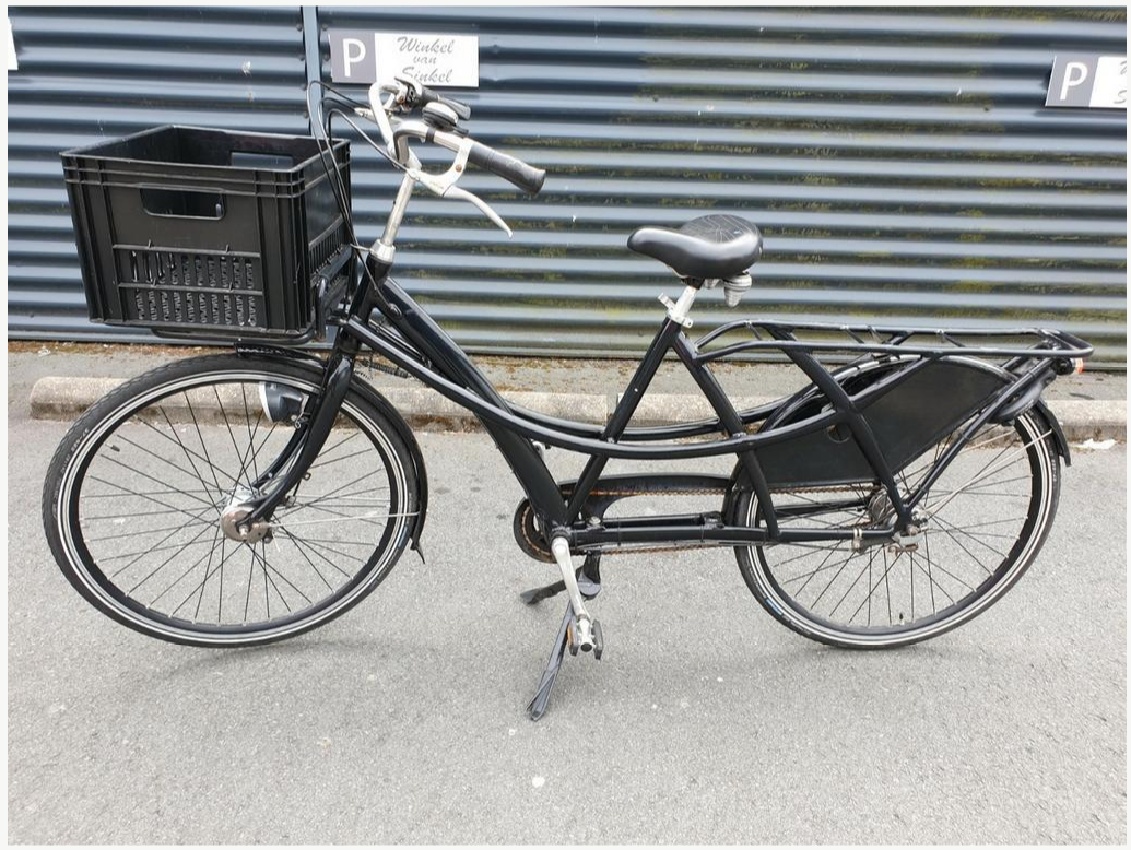

I looked up that frame style on the Azor website, good to see there are used Tweeling bikes for sale. That style of chain guard might not fit a Bafang mid-drive so you might want to fit a Hebie chain glider. I did that on my bike with an IGH.

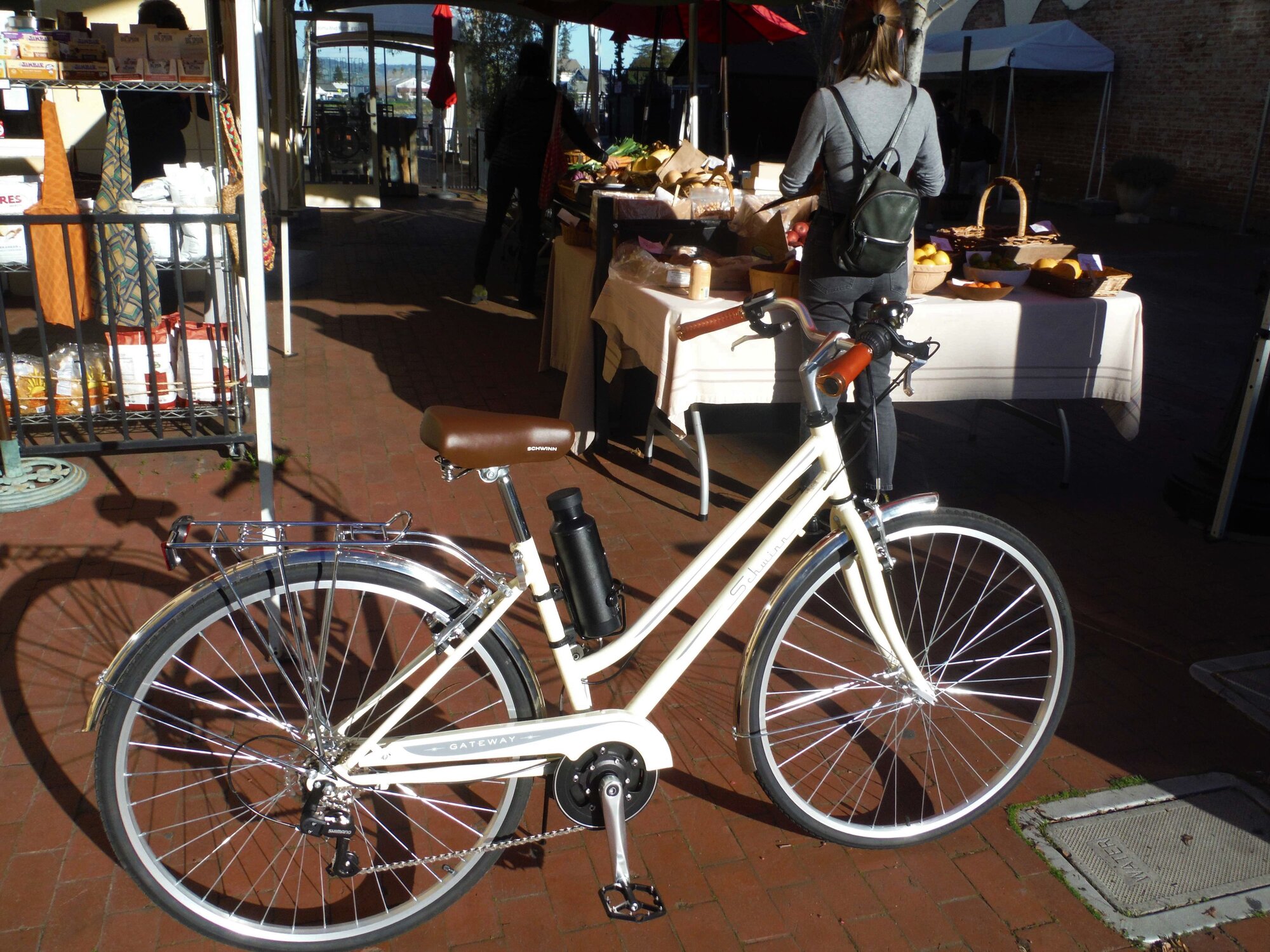

Re: drum brake, I had my shop fit a 90mm Sturmey drum brake on the front wheel of my bike and find it performs reliably stopping in the rain. The photo shows a Shimano Roller brake on the front of the Tweeling. Roller brakes are commonly fitted on bikeshare bikes here in the US, because they are an easy to replace bolt-on service item, but the front brake needs to have the Shimano brake power modulators fitted as well, otherwise they can lock up. Roller brakes fade after heavy braking down hill but shouldn’t be a problem in the flat Netherlands. The reaction arm of both the Shimano Roller brake and Sturmey drum brakes fits in a tab on the fork, so I imported and had my shop fit to my bike an Azor fork to hold my drum brake arm in place because I found the fork clip Sturmey provides would break after a few months of braking.

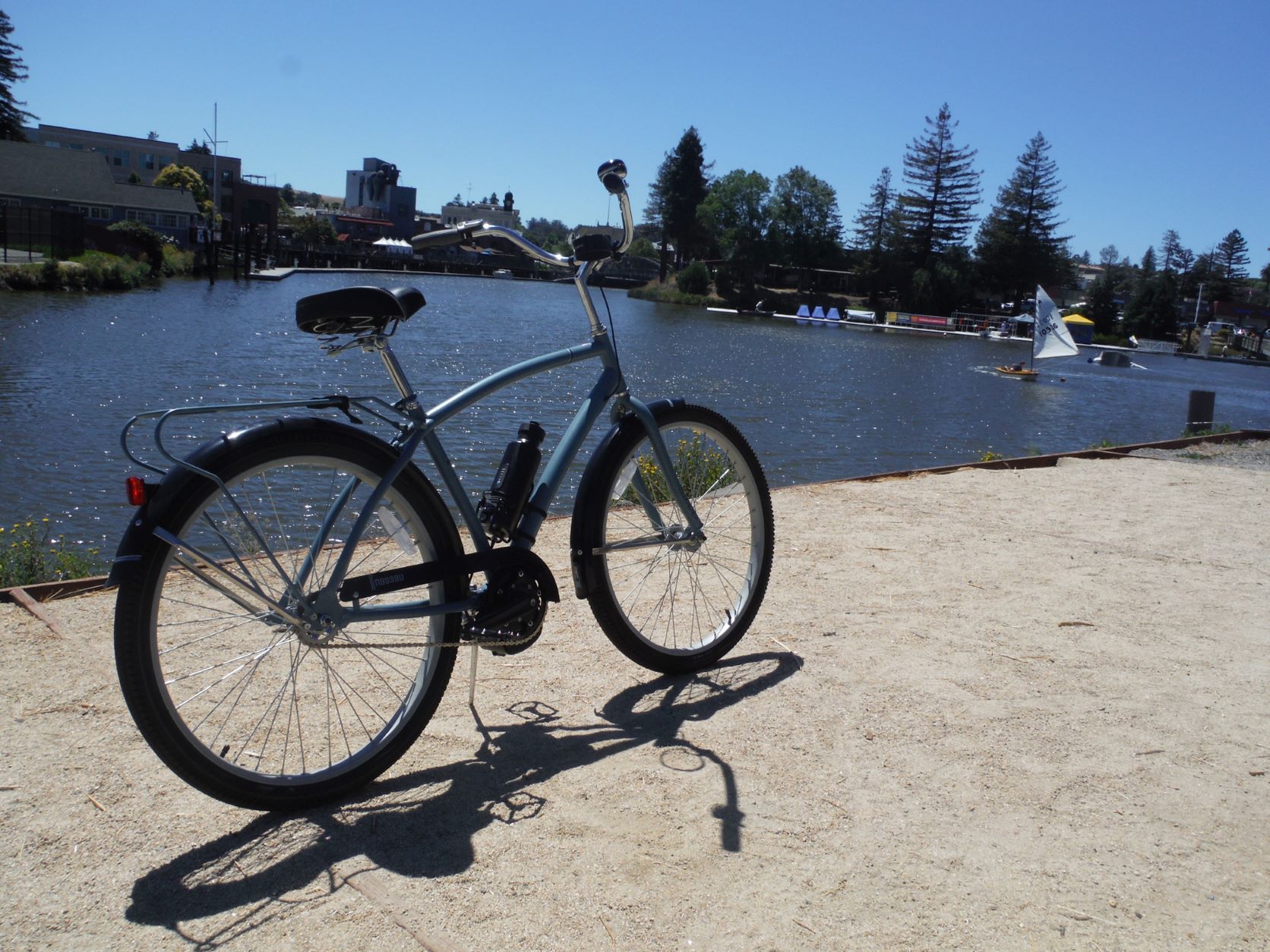

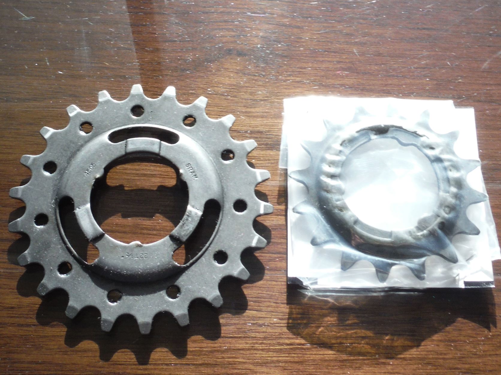

Just some thoughts. Put the rear passenger ahead of the rear axle. The pad should stop there. Install a bar just ahead of the rear wheel as a foot rest. I ride a Nexus 3 but be carful. The manual says that you cannot pedal it in a standing position, meaning it cannot that that kind of torque. Maybe drop the cog to 24-t and or use a 36-t narrow wide chainring. I killed a Nexus once because I rode it hard for two years on a 16-t cog. They are cheap, so I just laced in a new hub using the same spokes so I could abuse it more. That one was fun. I called it Union Jack because it had a flag on the top tube and looked like an early 1940's British bike.
all good thoughts lol. i will definitely get the passenger setup ahead of the axle, maybe even put a little back rest to make it hard to scoot too far backwards. i put a bid in on that azor bike i sent the picture of but the seller didn't list what hub was in there. i will be careful with it but i'm assuming it's probably not a bottom of the barrel hub considering these bikes are designed to have 3+ children on them. also if i burn it up it will be easier to lace a new hub into a bike that already had one to begin with vs converting a cassette setup into an IGH

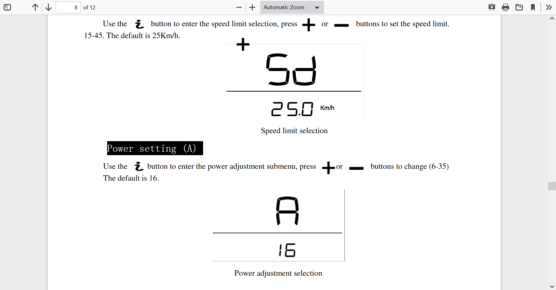

Did you say "The Netherlands"? Did you read the European and the Dutch e-bike law (both are basically the same)?
of course, and i will be able to make the same setting in the software of the motor controller that manufacturers make to limit the motor output to 250W and the speed to 25km/h.
So why to use the heavier and more expensive motor on that e-bike?
@m@Robertson does this all the time. It is overkill on robustness for cargo. Big motor, down-tuned. It will last and last, trouble free. I am getting some 52V motors today with extra-strong double clutches and extra-strong bearings for cargo. I will run 48V to take down the load by 8+%.
On decent bikes the user owns it. And as owner can do what they want, the way that they want, because it is theirs. Here is how you can take down the speed limit to EU standards and down tune the Amps to limit the Watts to EU standards, while retaining a more robust set-up than bikes from retailers that you really do not own because you can't control them the way you want. Would you own a dog that someone else commands?
this is exactly it. running a motor at well below it's full capacity while hauling heavy loads vs redlining a smaller motor day after day. it's definitely overkill but the price difference is negligible, and so is the added weight.
Programing Amps is easy. V x A = W. For the EU do for example, 36V x 7A to get 250W. No judge would bust you for having a robust cargo that is EU legal in all regards +- 5%. That said, I put wheel size at 100mm diameter on a 29'er regularly, and remove all governors for improved feel with no lag or surge. Because it is my bike that I command; It is mine! I feel sorry with those stuck with 'owning' a bike they are not the master of. Someone else commands it. They are master of 'your' dog. And it could turn on you anytime on their command. Being left high & dry by a big corporation calling the shots would suck. It is like it will only work with their cartridge for their printer at a 420.5% premium and that takes 12-weeks to deliver and only within their service network. You would be screwed over time. Liberation is so much better. Right to Repair. Don't be a sucker at the whims of big enterprises that only seek maximal profits.

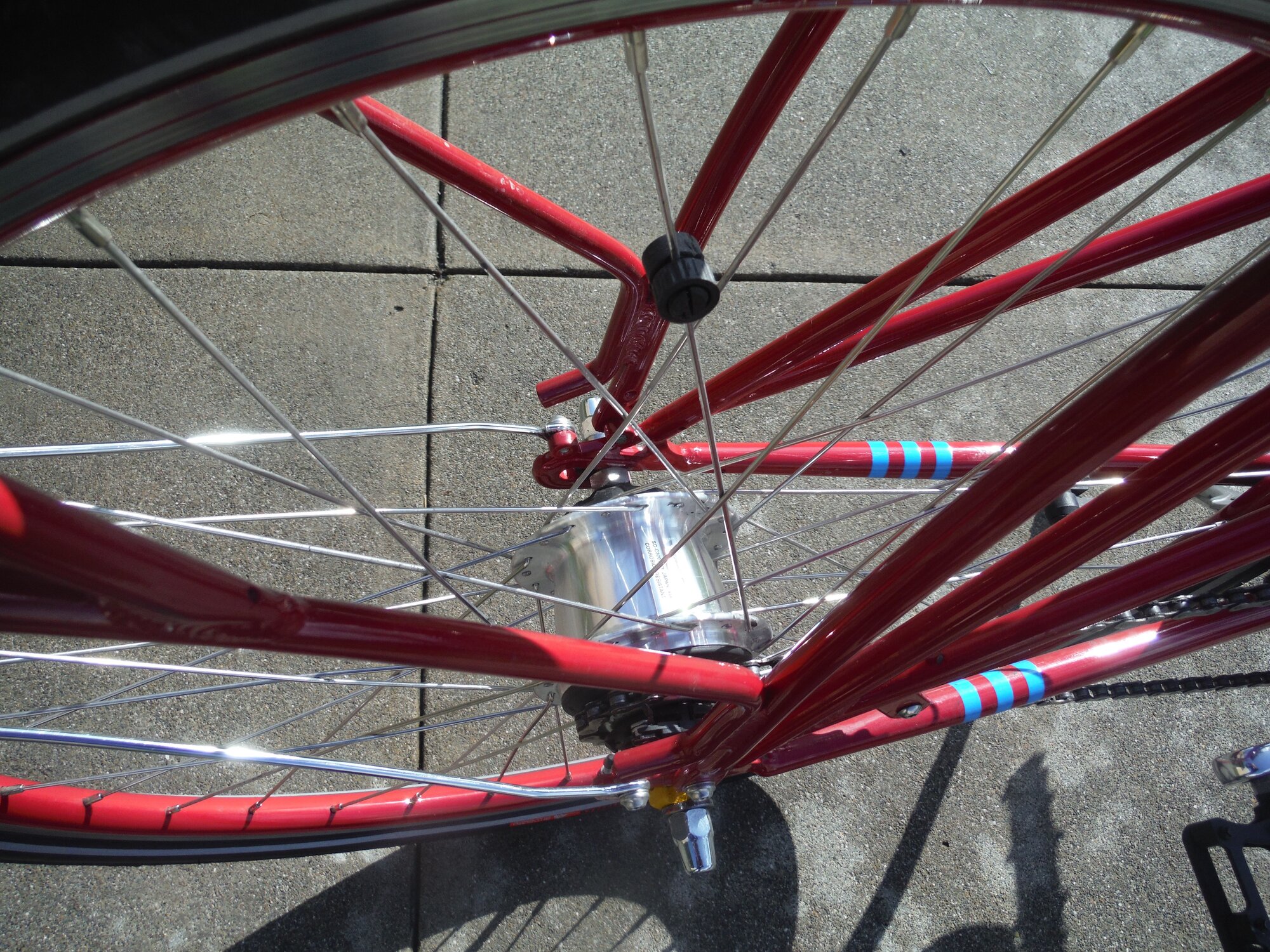

bought this azor from a bike shop today. i will probably make another thread in the custom builds section so i can get help with any issues that pop up along the way. thanks y'all!
What is the hub. Is that a S.A. 5-sp? I do not recognize it.
i think it's a nexus 7 speed, i'll confirm when the shop drops it off to me but that's what azor puts stock in their bikes. not the toughest but all the shops here can rebuild them for cheap and it ought to work with the bbs02 well enough for starters.

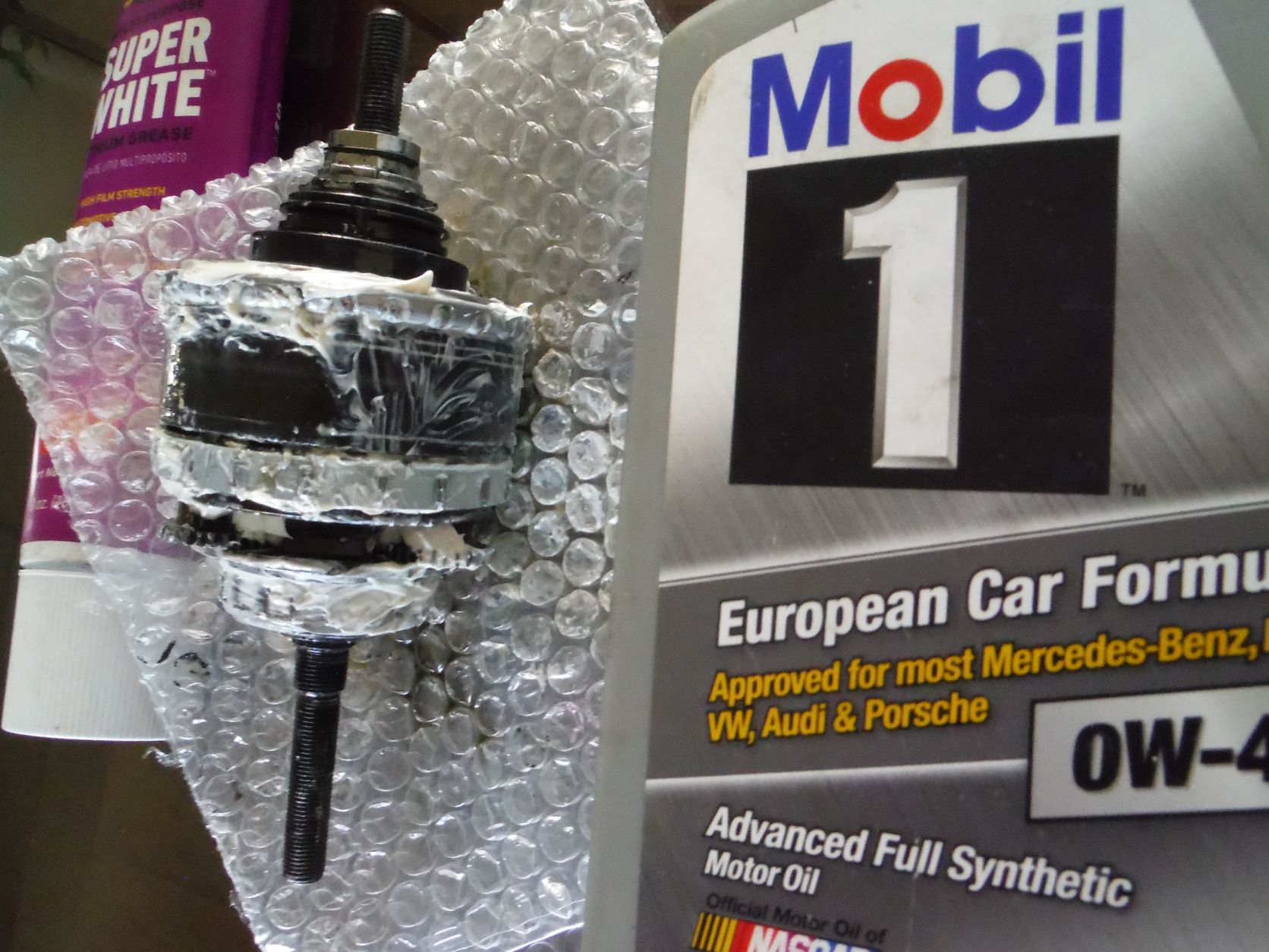

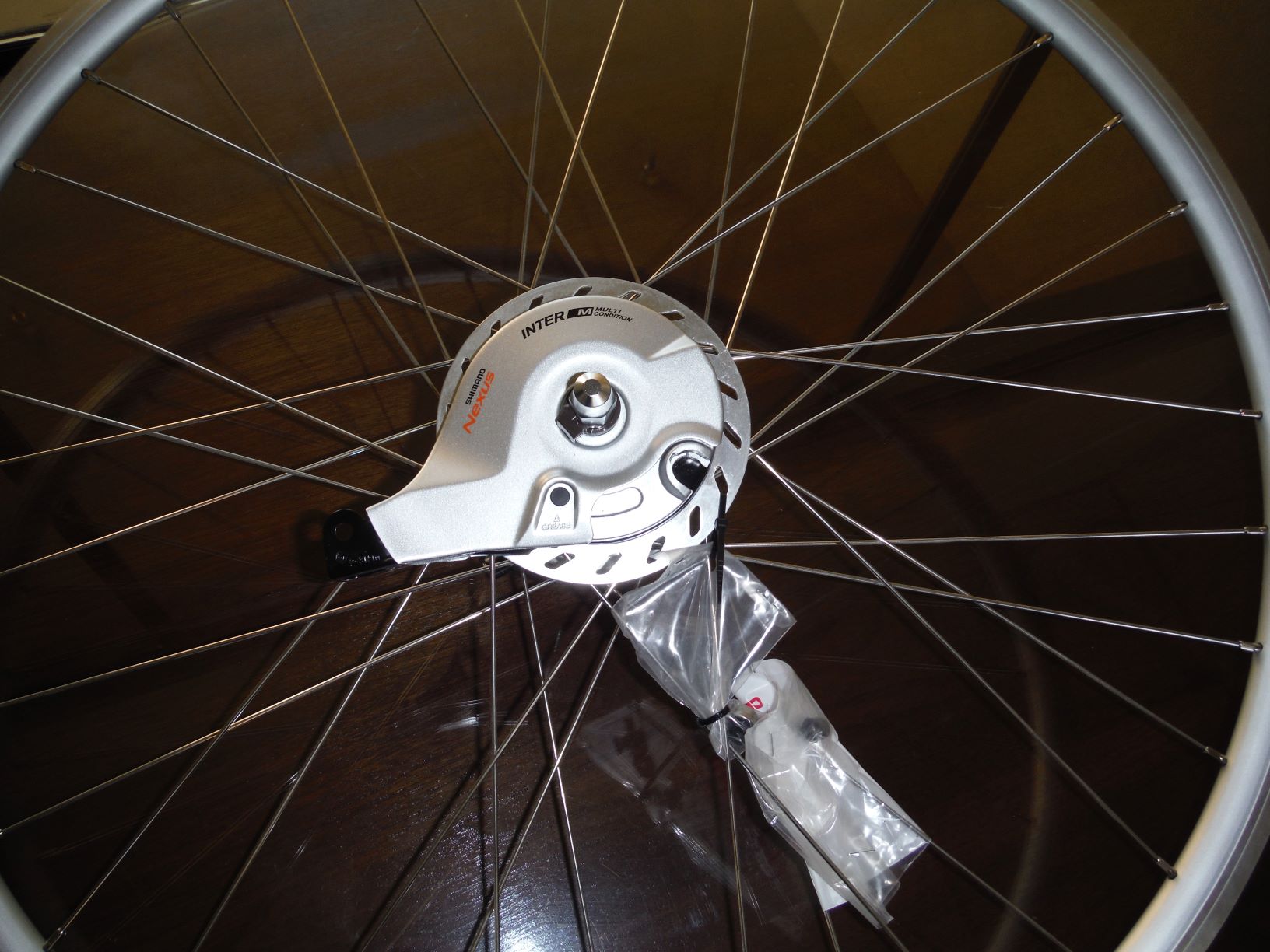

The Nexus 7 works great with 350W. I was thrown off by the roller brake. I soak the internal transmission in Mobile 1 every once in a while, drain and repack with lithium grease. That makes them supper smooth. As the guy said, there is nothing as smooth as a lubed tranny. I like the Microshift trigger for Nexus, between twist shift bikes I sometimes get confused about which way to twist. The Microshift is perfectly indexed and prevents that confusion.
