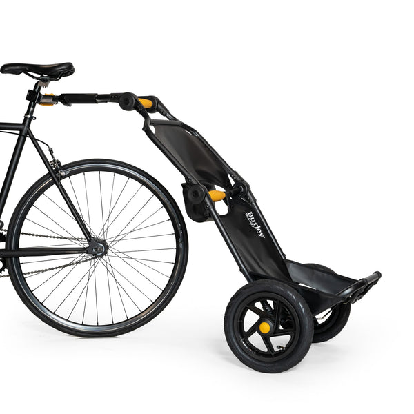

You might get the Burley Travoy to work for you:
If your rear axle is normal or semi-normal you might look at one of the Burley trailers use their hitch system, which is, um burly:
Note that the Burley trailers are expensive. On the other hand you can probably then get away with regular camping gear which you might have or can borrow.

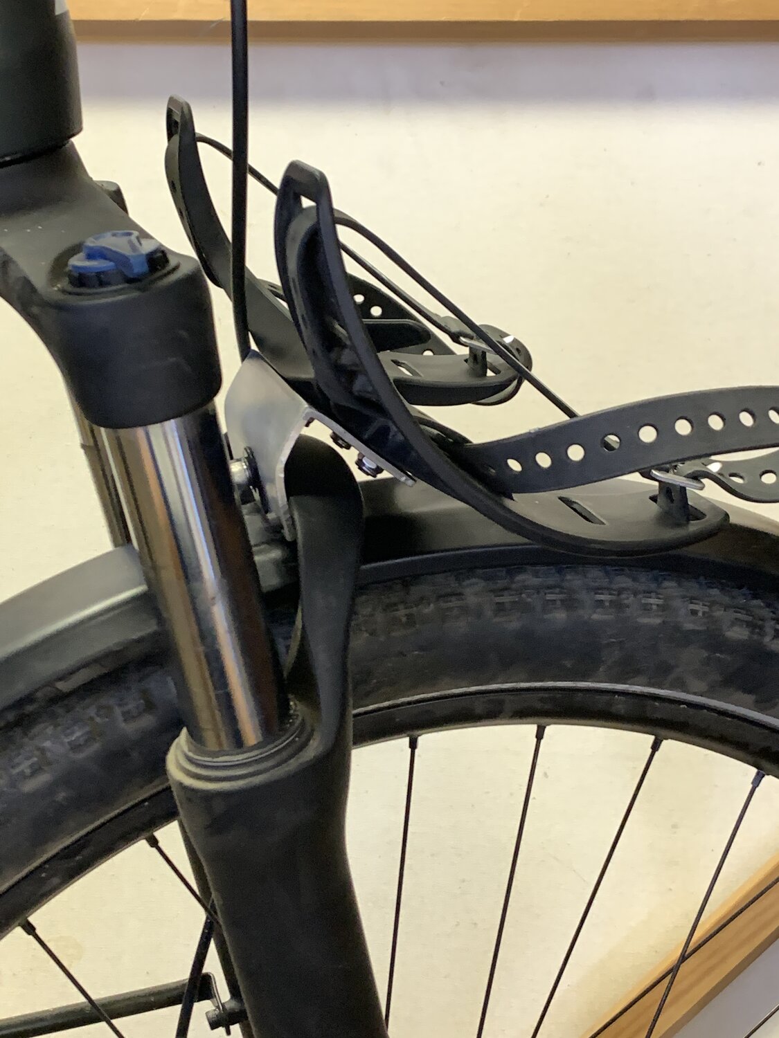

Large handlebar bags or roll bag cradles sometimes work, depending on your cable routing. They never worked for me, unless you have extra long cables that looped over and in front of the bag. Most of these bags end up pressing and sometimes kinking the cables against the head tube. I use small handlebar bags, just large enough for my phone, keys, and a couple of energy bars.
But since I like to carry gear at the front I had to resort to a DIY solution for carrying my 20 liter compression roll bag on my suspension fork. I bought a cradle and fabricated a mount out of 1/8” aluminum angle stock. It’s rock solid and carries my front bag securely. That front bag contains my hammock or tent, poles, and my sleep system.
