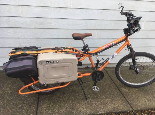

How about increasing the battery capacity like this one? I saw this advertised today in the SF Bay area.
"This is a custom built high-performance electric cargo bike it runs on Nissan leaf electric car batteries with an operating voltage between 72 and 85 V. It has a 100 amp controller which means it’s 7500 W or 10 hp. If you’re interested please send an email with your phone number no test drives you can ride at all you like after you buy it comes with a charger. Goes about 45 mph and has a 45-60 mile range."

Next we’ll see the Prius Traveller ebike! 100 miles per charge!

Eyesore. CN

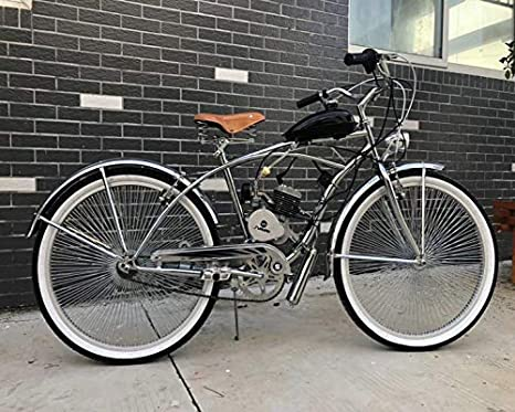

Just stick a gas motor on the bike. Why futz around with electric drive? It adds a lot of inefficiency and weight. Kits are cheap through Amazon, but no guarantees of quality.
You do realize this is an eBike forum? Cheap and much more complex. Noisy stink pots. Every one I’ve seen disappears after 1 maybe 2 seasons.

I don't think so. Imagine cooling such a motor! The fact that the controller can provide that power level doesn't mean the motor can handle, or draw, that much.

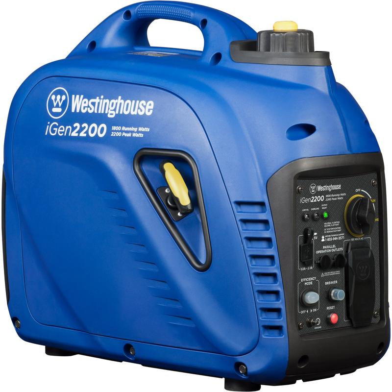

I want to put a generator system on my eBike (will this actually happen? Probably not, but I still wanna get some opinions on it).
The two options I have are this:

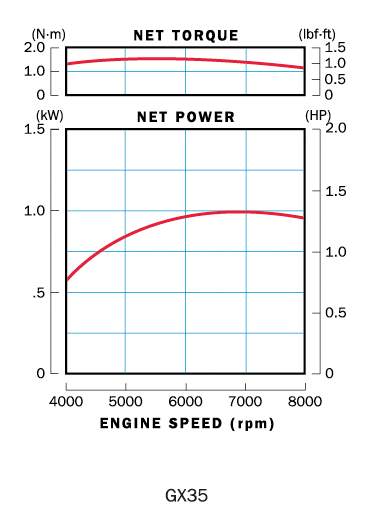

1) Buy a Honda GX35 engine, it only weighs 7.6 lbs, and then find a way to generate power from the rotational output (probably have to generate a high amperage 12V power and then use a boost converter to take it to the 42V I need). It has a 1 kW mechanical output, which if we have (I’m guessing) 50% mechanical efficiency from shaft to charge, gives us about 500 watts, which is more than what I need (I probably could get by with 250W, so I could run the generator at half throttle?)
Additional info
.63 litre fuel tank
1.0 kW @ 7,000 rpm
1.6 Nm @ 5,500 rpm
0.71l/hr at full throttle

2) I own THIS
So what if I put it on one of THESE!
In theory, this would work, since it weighs 46 lbs, and a lot of these bike racks claim to be able to hold up to 60 lbs.
This thing is as quiet as “52 dBA” and can last “up to 12 hours” on a 1.2gal tank.
Advantages-
-Quieter
-More efficiency from fuel to battery
-Can always upgrade the charger if needed
-USB ports (my bike HAD a USB port, but now it doesn’t...)
-Cheaper (in my case, but only because I already own the generator)
Disadvantages
-Substantially heavier
-Messes up weight distribution
-Might break the mount if I’m not careful
So if you were to build a generator for your eBike, which one would you do?
46 added pounds makes the idea a non starter. However you could add two batteries and a quality charger like a Satiator for a total weight of around 20 pounds. Put one battery in each pannier to get the weight lower in the frame.
It would give you triple the range and not require any wiring. If you have a 40 mile range now that would go up to 120 miles probably more than your butt can take. When you stop to eat or sleep you can charge your battery. Add a trailer with a large solar panel and you never have to stop to charge.

They are cheap (2-stroke engine kits). They are quite simple to install though. I still don't recommend them. They are fun machines but are not ridable in the same way as an ebike. They are 100% throttle driven, you don't pedal at all. You CAN pedal with the clutch in (yeah it has a clutch lever) but you're still turning a second (heavier) chain and front sprocket when pedaling. I enjoy riding my son's motorized bike but it's a different experience

Ok if you're planning to run it while biking to power the bike that's a different kettle of fish. You'll likely want an inverter generator for that at minimum. I've not used an inverter generator but the typical AVR generators (the normal ones most people buy) struggle to supply a consistent constant voltage when the loads are variable. They don't spool up or down very instantly and you end up with surges and sags in voltage. They also inherently generate AC voltages so getting them to be 48v DC will require more electronics. ProTip: Generators with a 12v DC supplementary output can only usually push a couple amps through the 12v circuit (like 30-50watts). I was assuming you were going to run a 120v charger with it while stopped or at worst maybe had an extra battery already so would be charging one while using one.
I think you'll find using a generator to directly power your ebike motor (or attempting to charge/supplement your battery while it's in circuit) will be un-even and require more engineering/parts than you figure to smooth out the loads and voltages. Towing a genny to recharge batteries while stopped seems very practical to me and only requires one of those small 900w generators. On a trailer you might even be able to charge a battery while biking if you have a spare (based on your pics I think you do have at least 2 already and just need even more power). Lol.
Can't see any chance in recharging it as you're riding it. No charger can charge faster than the battery can output, so you'll still deplete the battery. Plus I'd say the battery wouldn't last very long either.
To directly power the motor, skipping the battery, your bike would need a generator capable of around 50 amps output to sustain a steady 25-30amp supply (running it around 50% of available rpm)....These are not small and not light, and use a lot of fuel.
Its more something like this.... Its a good two man carry. Even if you had a Bafang M620, you wouldn't want to lump this weight around with you...
