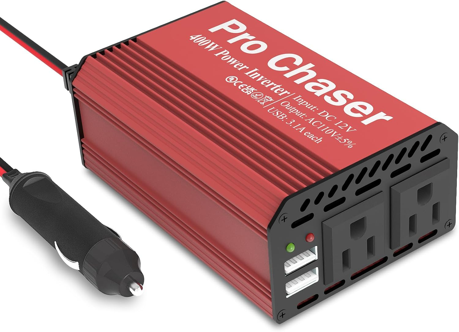

Why not use an inverter to charge your bike battery while you drive? My truck has a built in 450W inverter that I use with my ebike charger. I usually carry several batteries, and charge them while driving between riding destinations.
Inverters that plug into a cigarette lighter socket, like this one, are considerably cheaper than a solar generator:
If you want to charge while the vehicle is parked, then the solar generator would be an option.
