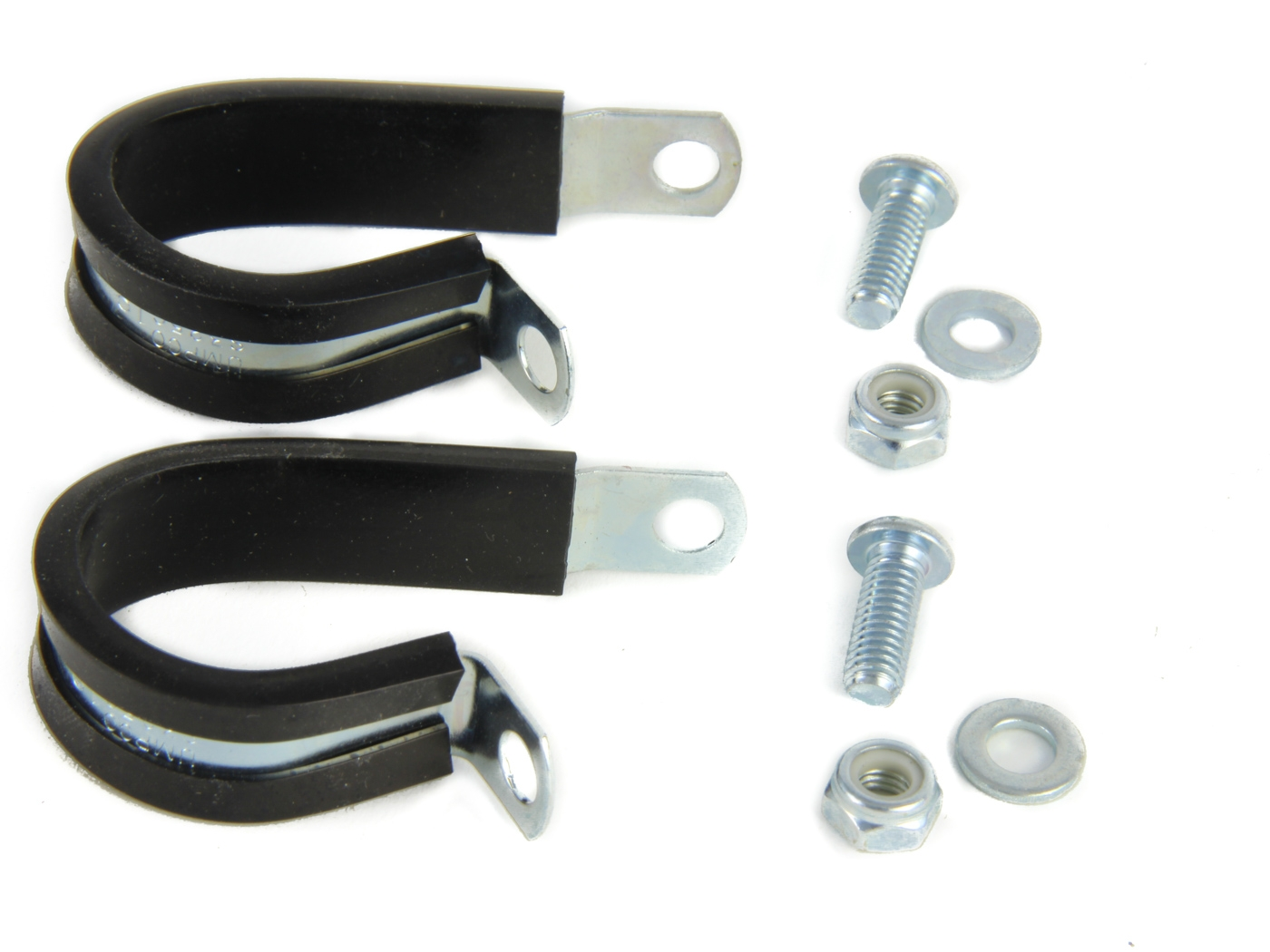

Have you thought about using clamps like this?
I did consider those. They are designed to attach to round objects so they are a much better application for attaching to the front forks but not much better than the pucks for the triangular shaped swing arms. Also there is no clearance to route your brake and shift cables.
And for a rack that is this expensive and requires a replacement axle, you would think that OMM would offer a choice of mounting brackets or mounting systems specific to the bike. Considering these bikes probably average $5k each it seems odd that they want me to mount a $200 rack plus the cost of my panniers (not to mention the value of their contents) with a 10 cent bracket?
For me I am looking for a rack and mounting system consistent with the quality and design of the bike I’m mounting it on. So far the OMM is the only rack I found that comes close to doing it right for a full suspension bike, but they came up a little short with the swing arm mounting system.
