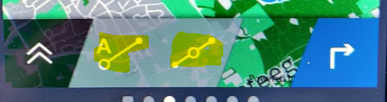

I've asked this in another thread but that got burried somehow - does anyone of you know what these icons do/mean when starting a route? I haven't found anything in a manual yet...
Thanks!
Thanks!
The left one with an A starts the planned route from the beginning. So if the route was from A to B, and you are at C, it will route you to A, and then B. The right one navigates from your current position C directly to B. So for me, the right one is what I want 99% of the time.
