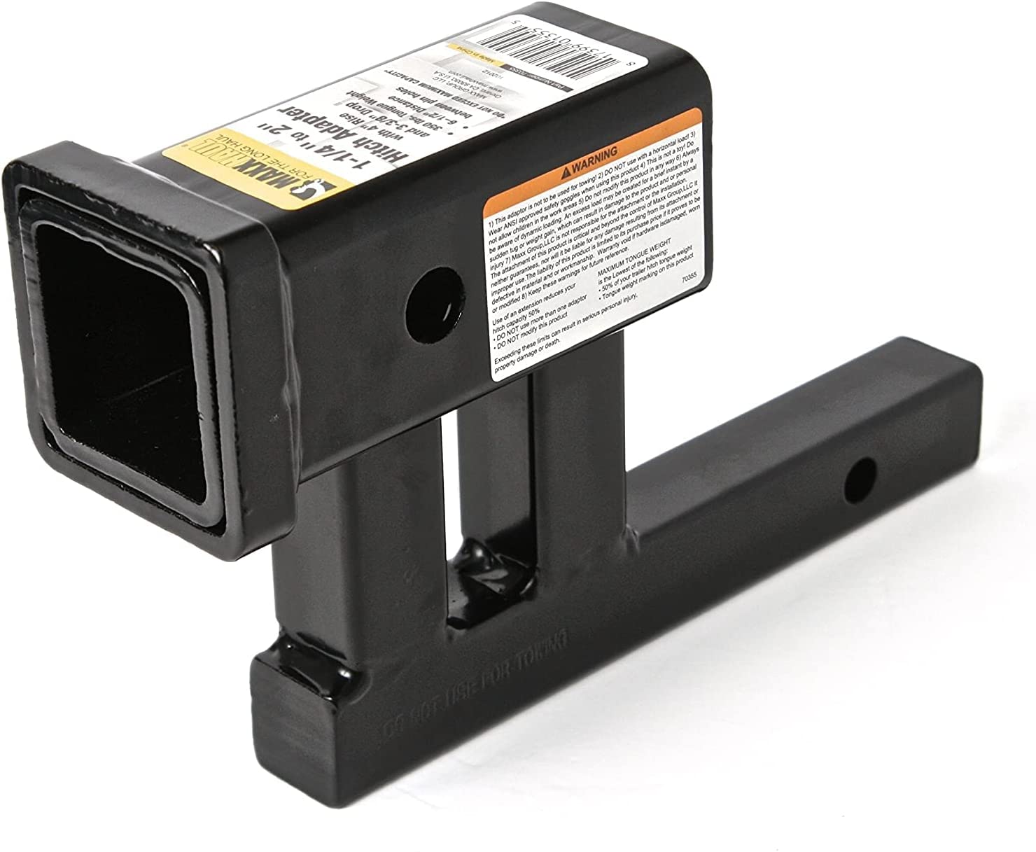

I expect if she did that she would need to buy a pickup or big SUV. There are 2" adapters for 1&1/4 receivers and those receivers are rated for 200lb tongue weight which is enough to handle 2 bikes plus a rack.
2” adapters lengthen the moment arm which increases the force on the hitch and frame. They are generally an inferior remedy.
Fair point. I know little about adapters since I’ve never wanted a receiver smaller than 2”. My Tesla has one, as did several SUVs of course.
Maybe but they do work and are a whole lot cheaper than buying a big vehicle that you don't need in the first place.
Typically when using a 1 1/2" to 2" extension you have to halve the tongue weight. The adapter should have this printed in a warning label on one of its sides. Even if it doesn't, the rule still applies.
I had to use one of these on my last Mercedes SUV and I ended up with a 130-lb tongue weight, which was fine. Also, I used a 4" riser which solved another problem these adapters cause: they stick out too far and even a mild driveway causes the rack to scrape on the ground.
Zoom in on the pic below and on the bottom right corner of the label you can read the (generic) rules.
