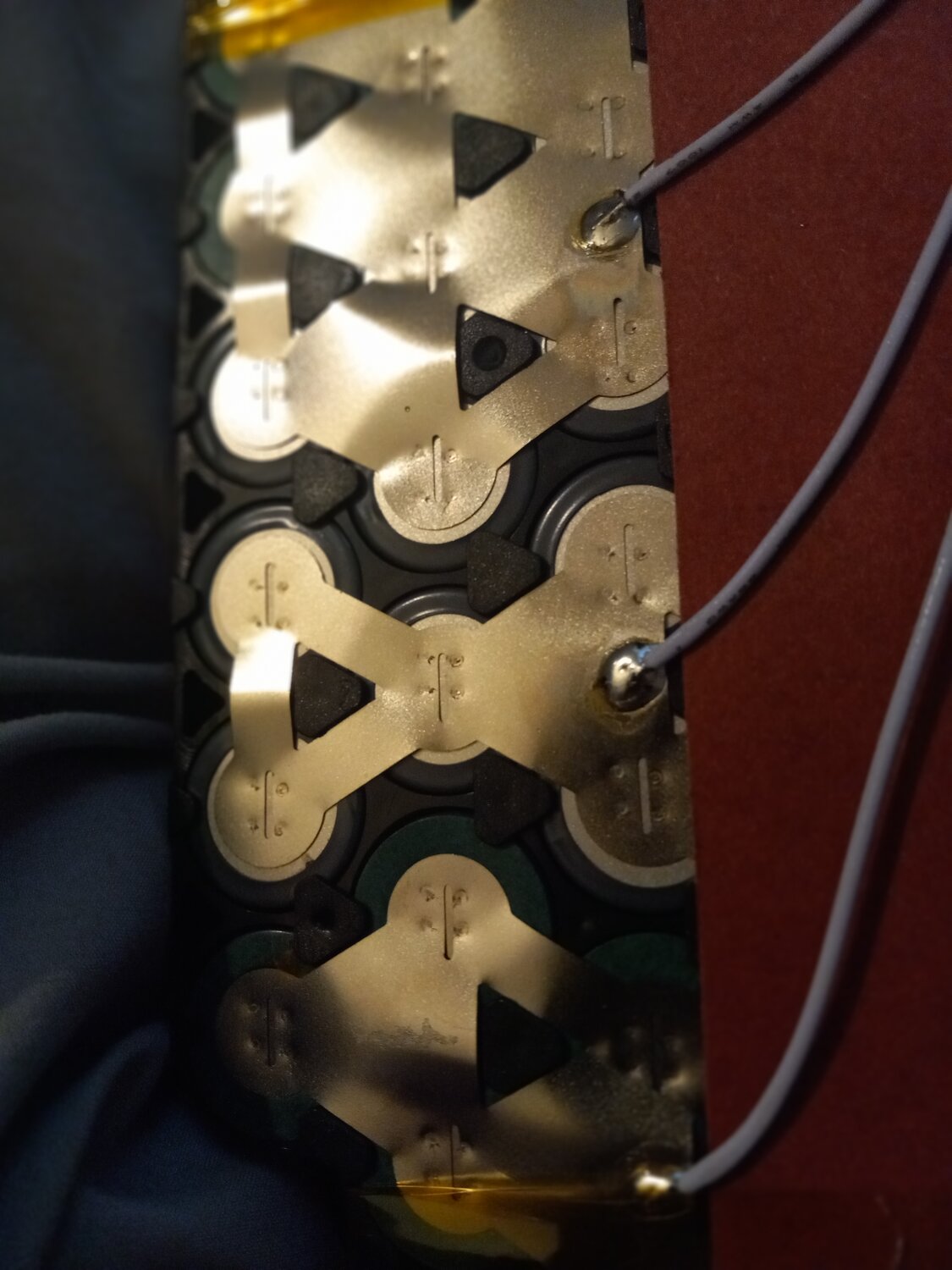

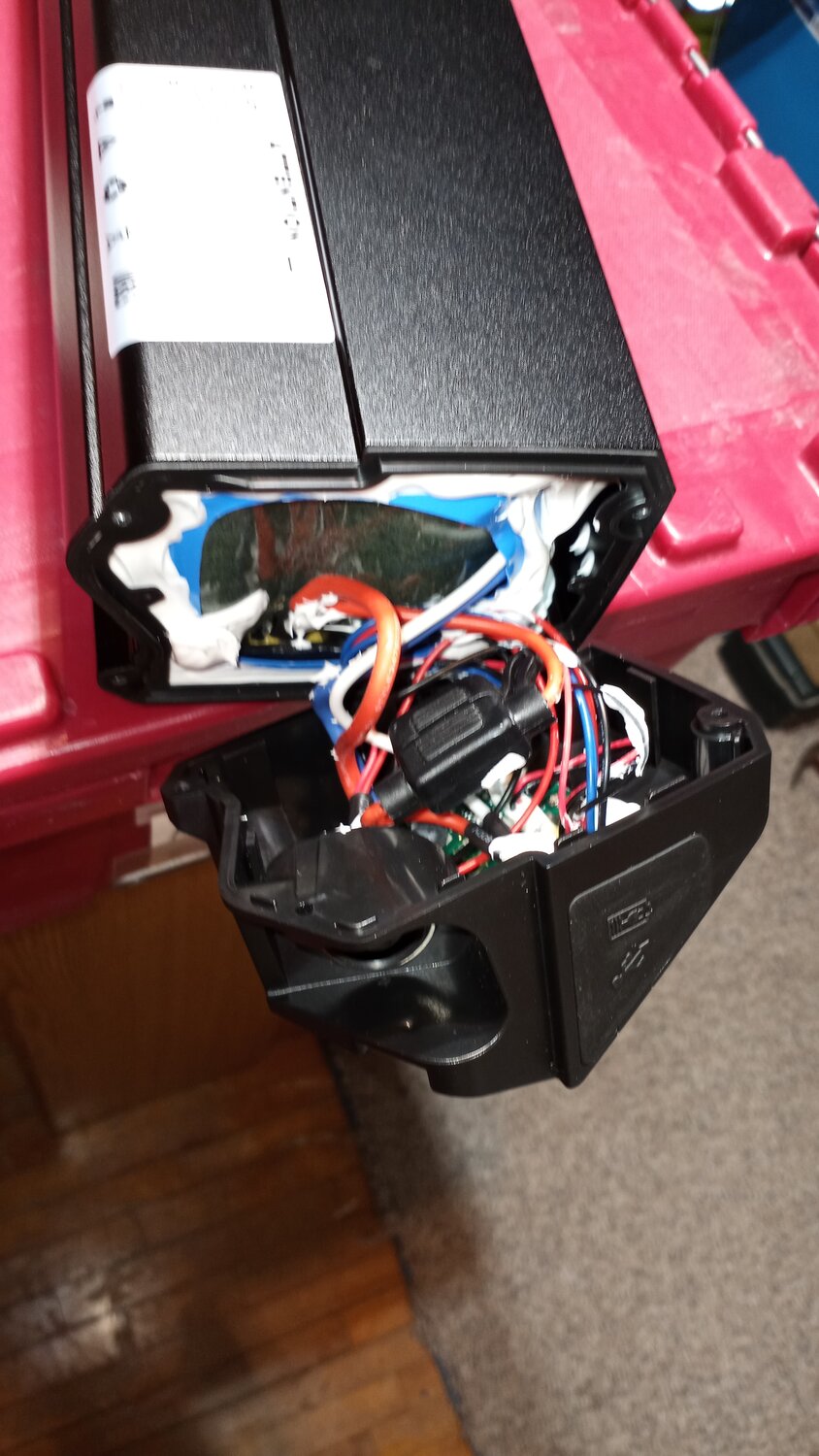

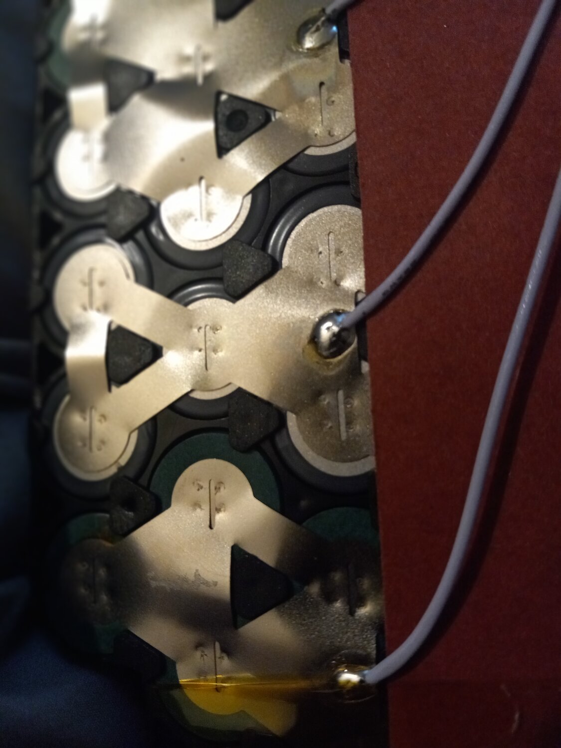

Alright so it didn't take me long to check into that. Everything looks pretty good. Only thing I don't like is it only uses 1 plate of nickel that is .34mm thick. It's apart and I am very pleased with what I found inside. You get what you pay for. I paid close to $500 for the battery. It is expensive because the cells in it cost a lot more. Buy a Chinese battery and you get what you get.
Anyway Im gonna post up photos of my teardown but it don't belong here so look for my new post about the battery in the DIY Ebike section

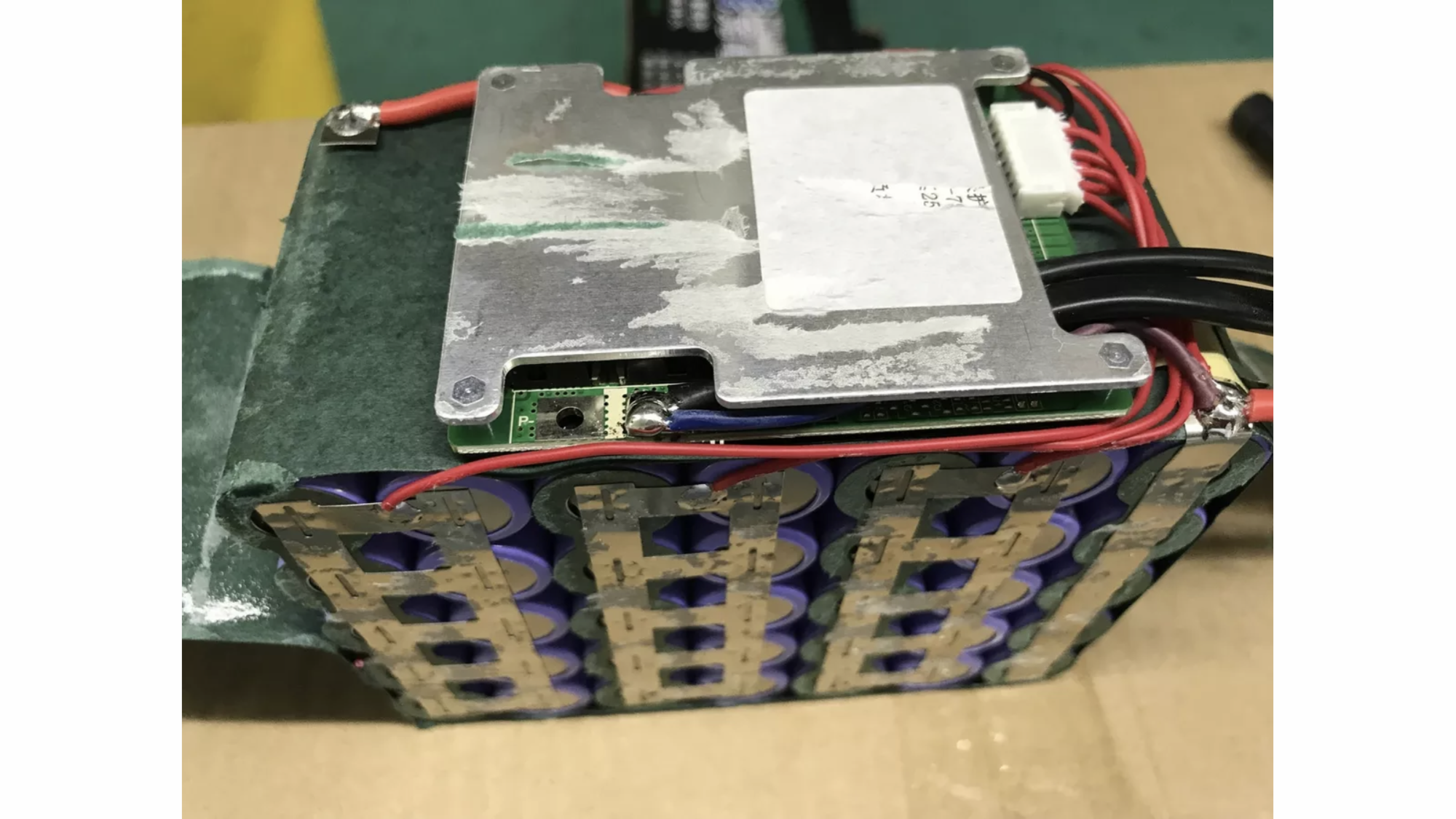

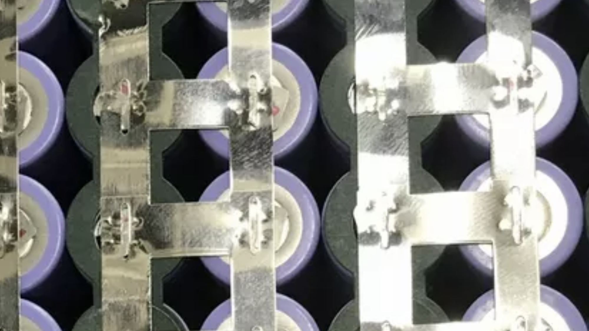

This is my speculation about how bad welds are causing fires,..
The tack welds that weld the nickel plated steel ribbon to the cells break free or the ribbon itself breaks.
Or they didn't use the little circular stick on insulators on the positive side of the cell.
The bare metal ribbon can rub through to the bare metal negative ground cell casing that's 2mm away from positive at the top of the cell.
So if a single cell "disconnects" from its associated cell group, it is either overcharged or undercharged.
Then you go over a bump, or the battery gets warm or whatever, and that disconnected cell reconnects causing a HUGE Current dump into or out of its cell group causing sparks.
It may continue to arc and spark and disconnect reconnect until you got a 🔥
Or the shitty weld has enough resistance across it that it gets hot enough to start on fire.

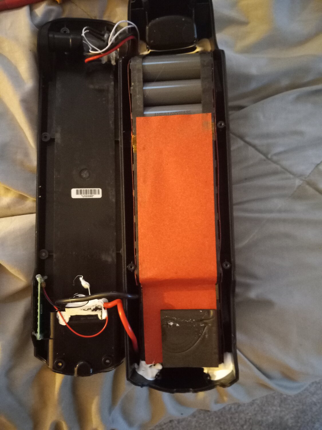

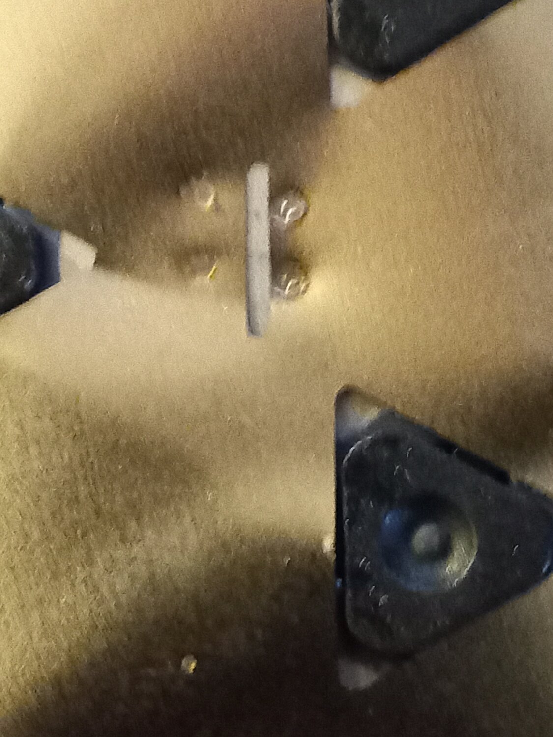

My battery has trays on both sides. They locate and isolate the cells. The whole pack was siliconed into the case. There are several pcs of foam but most aren't glued. The welds look not bad but not great either. The good thing is they didn't damage anything by welding to hot. It is looking like some welds aren't through.thats maybe not good. And there is only one layer of nickel. .34mm thick.
I think before I try to pull crazy amps out of this I'm gonna add 1 layer of nickel and weld it with 8 spots. They have 4 spots now and it's machine welded for sure.

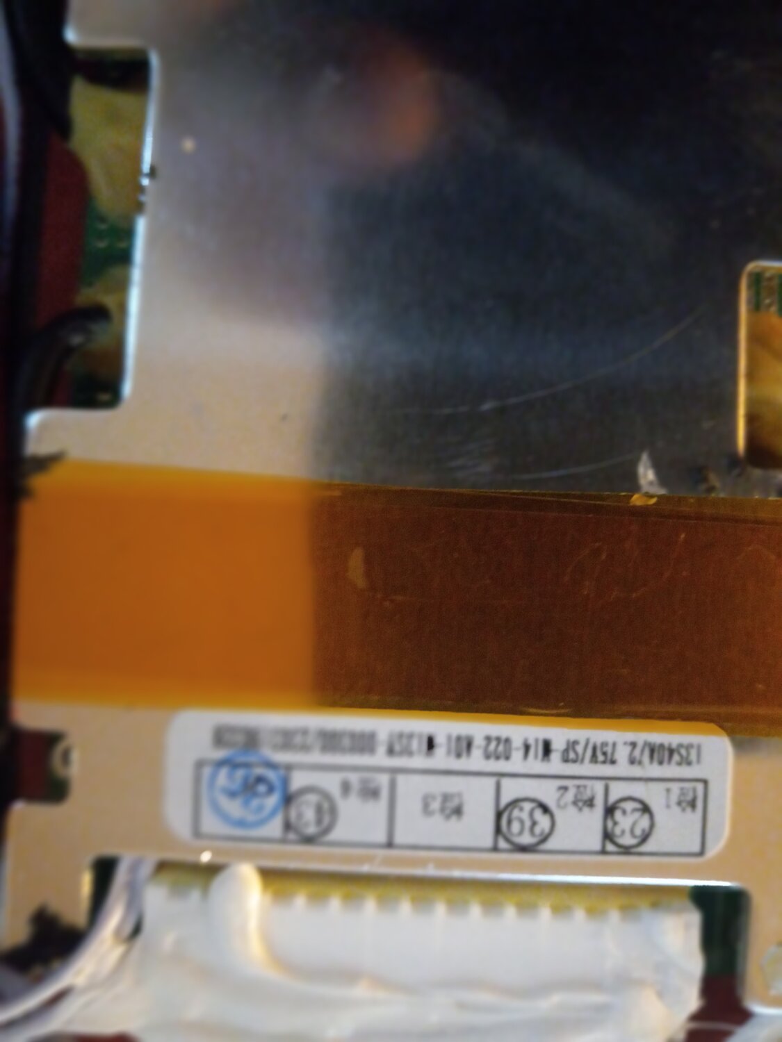

The cells are real. You can tell by the part numbers. I didn't get the cells advertised. I actually lucked out and got the Higher Grade LG21700 M48F. It has a higher C rating. I think it's cause there cramming 24AH in a 20AH configuration by using higher capacity batteries. I would agree it needs a good going over but if treated appropriately them cells rock.

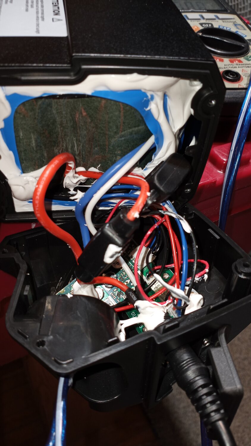

Here's some photos of the battery.
Hummmmm....
One thing to add. You notice that that ground tab is bent. When my rack broke my battery fell and it must have moved inside the case. I think when im done i will machine my own aluminum case for it and pot the whole pack in the case. That would be really safe but a pita if you ever gotta repair it.

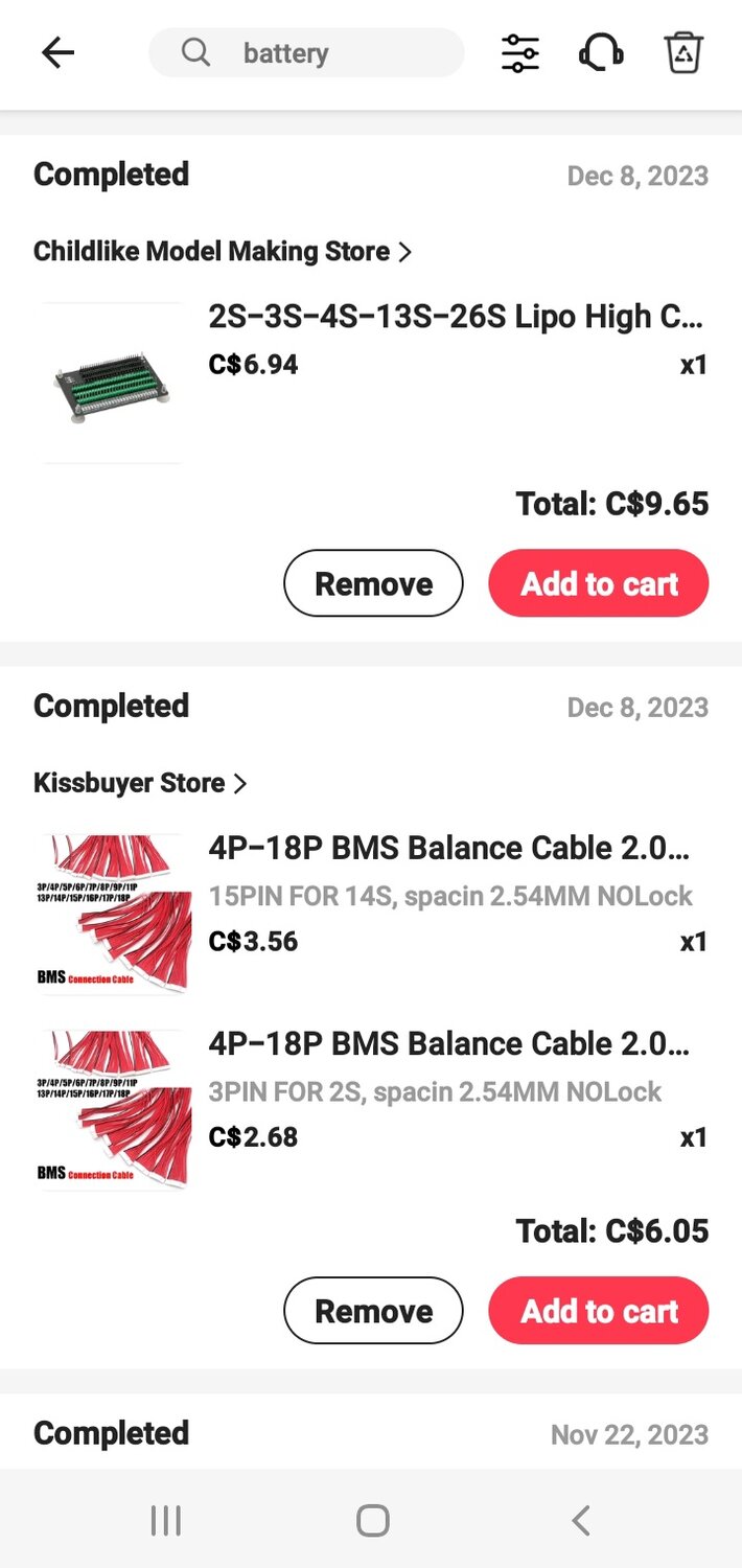

I bought a BMS pinout and Balance Cables so that I could monitor the voltage of each cell group and balance my own battery, but I didn't realize that my BMS was buried inside the sealed up aluminum case, so I never did hook it up.

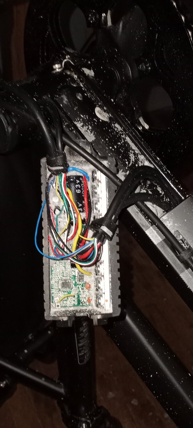

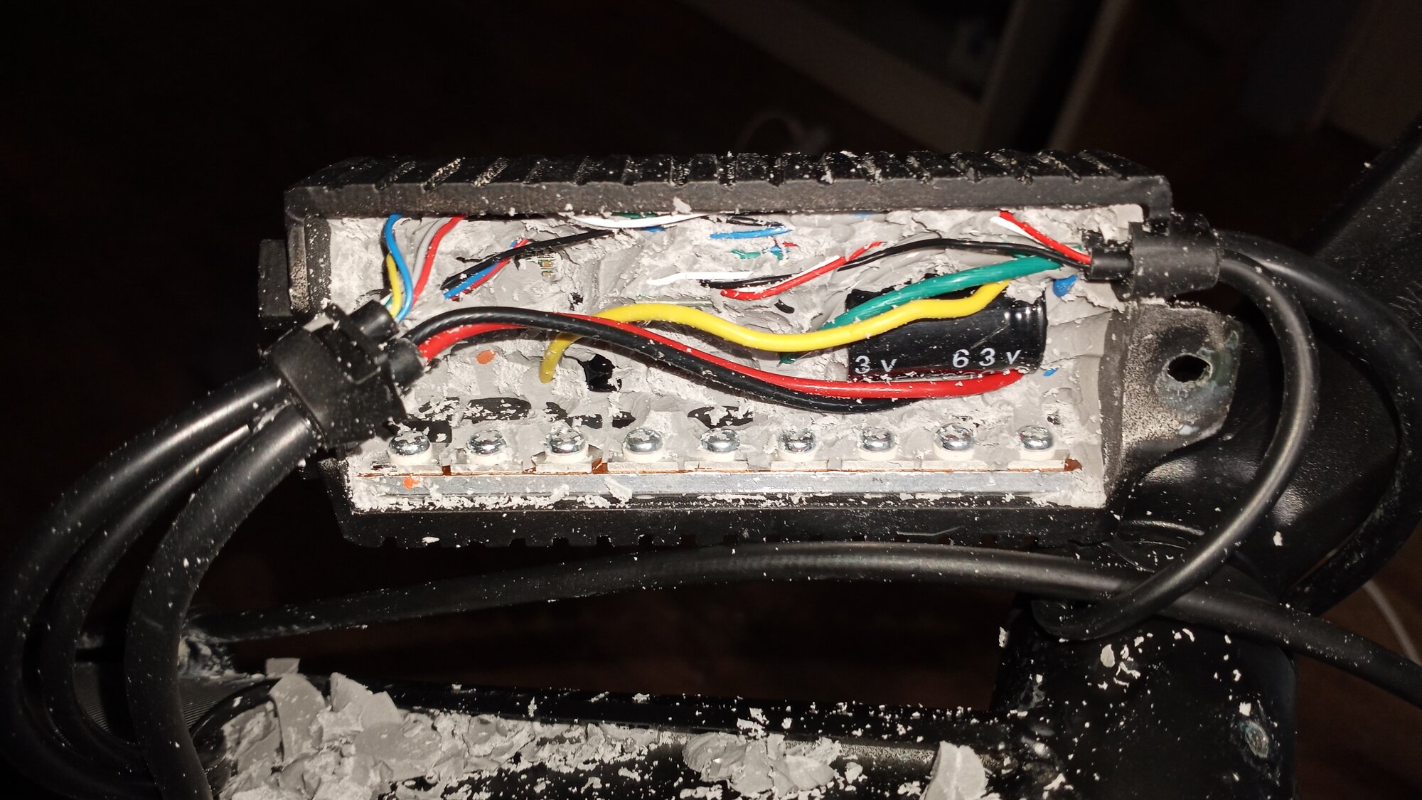

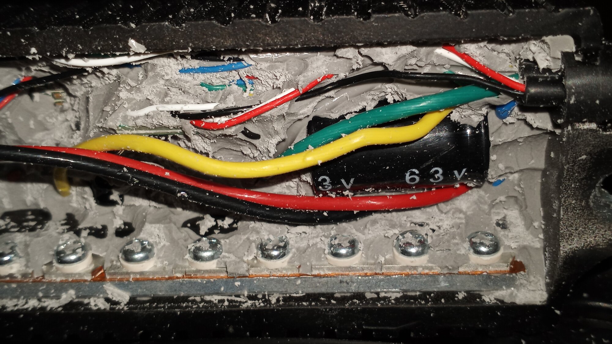

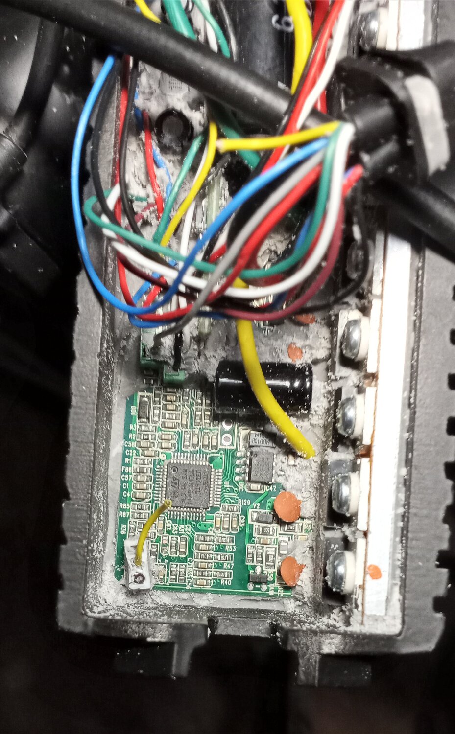

Then after the fault is located, the area needs to be exposed. Re-entering potted material that wasn’t meant to be re-entered is very difficult.
I depotted my controller, and it wasn't that bad.
It was a little soft like acrylic caulking and it didn't "bond" to anything.
I just had to pick away slowly with reading glasses, a dental pick, and tweezers for the tight spots.
I didn't damage anything.
