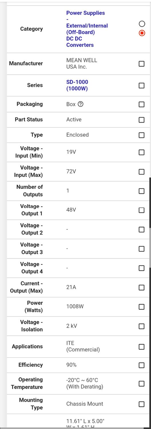

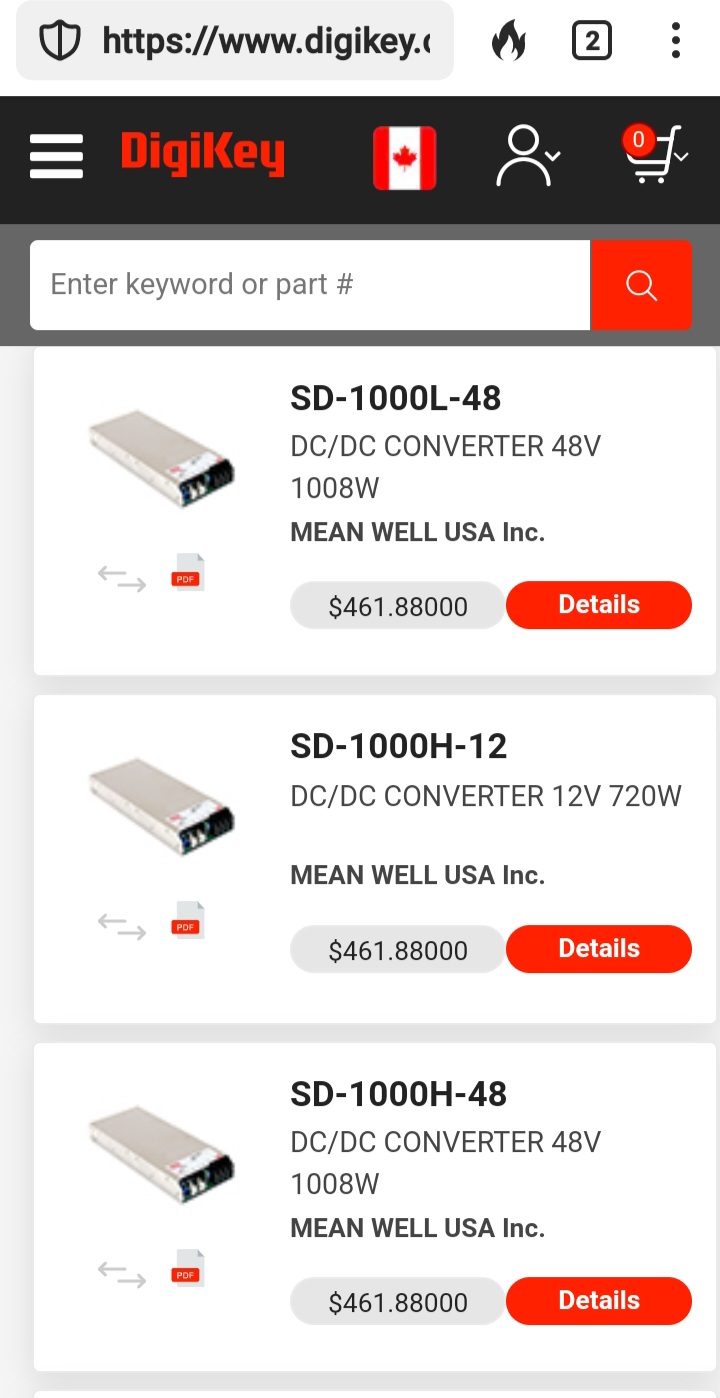

Yeah, MeanWell makes one too.
Don't go cheap with a DC-DC converter, they're inefficient, get hot and burn up.
I never run anything from China at more than half power if I can help it.
90% efficiency at 1000 Watts=100 Watts of heat and waste.
And it's vented with a fan I think?
Not really suited to bolted to an e-bike getting bounced around and wet.
Maybe there is something available for the automotive EV industry?
I remember looking into it before and I couldn't find anything with a high enough voltage output, but I'm sure there must be something out there.

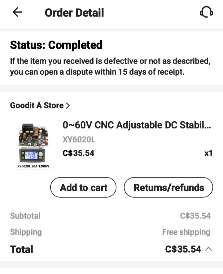

I've got a 1200 Watt 20 amp dc-dc converter.
1200 Watts, my Ass.
I'm sure it would make a great heater, or maybe I'll make some toast with it. 😂
