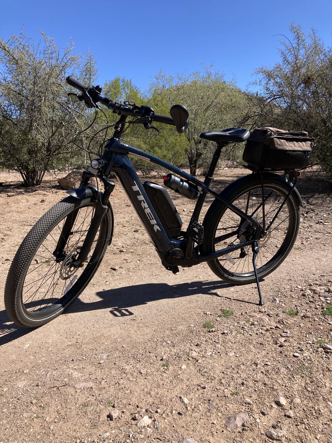

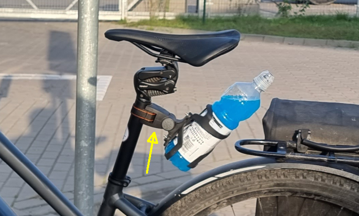

Just regarding the water bottle:
SKS makes a very good seat-post water-bottle mount. You only need to provide your own water-bottle-cage. It is a very good product: I'm often riding in rough terrain, and the mount holds!
